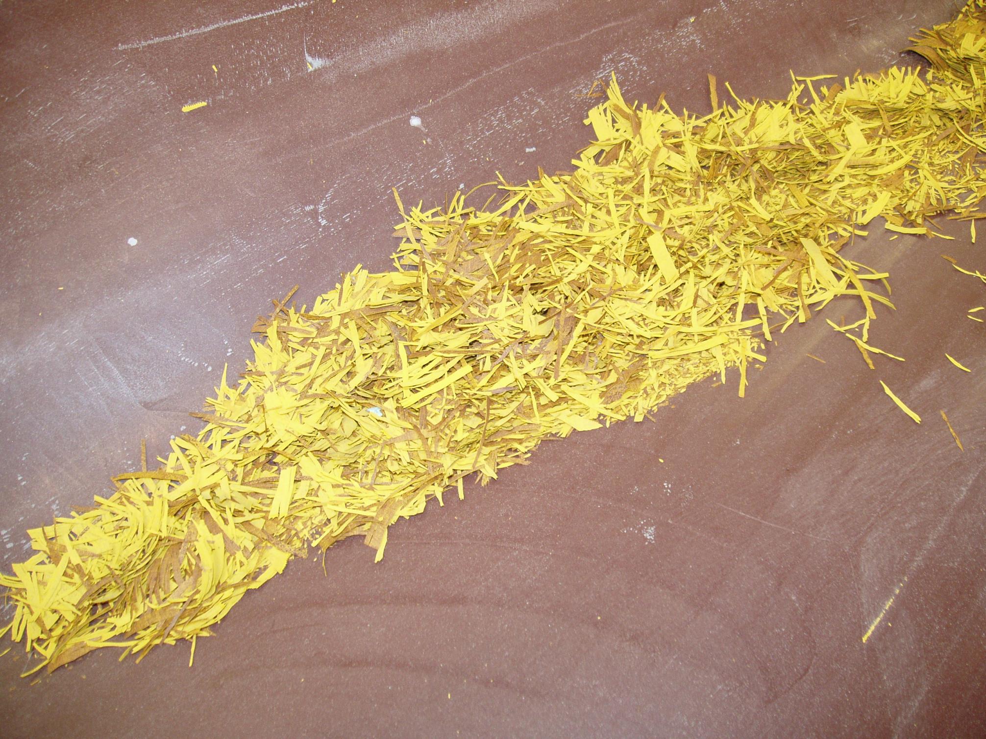

    I love the razor blade method, use it all the time. No dust, no mask, and I can listen to the radio. Peels paint off to the primer. Then hit the primer with a DA.

    I don't have the pictures loaded yet but I also used razor blades to recently strip a Buick GS, the paint was coming off in sheets. I would just use the razor like a snow plow and kept making p***es one right after the other. The car owner watched me strip a door on sawhorses in about 10 minutes!

    The 55 I did in the picure is red oxide and it peeled fine. I actually think it's more about the paint quality itself, new paint in good shape is easiest, as the blade has something to get under. On the Buick which was base coat/clear coat and less than 10 years old, it was a breeze. Cars that have the finish baked out and faded, not so much.
