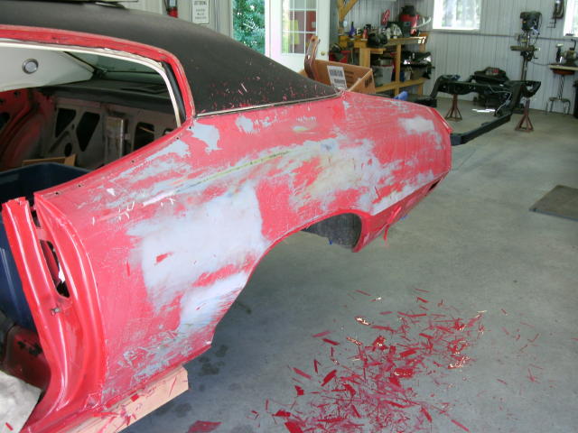

    Here's a picture of the result of a 30 minutes with a razor blade. I also use a Hyde s****er that you can find at a home center in the wallpaper removal area. They have about a three inch blade. On the right paint, you can go smokin' fast! Notice the paint pieces on the floor.

    I can't see anything, so it must have really taken it all off!

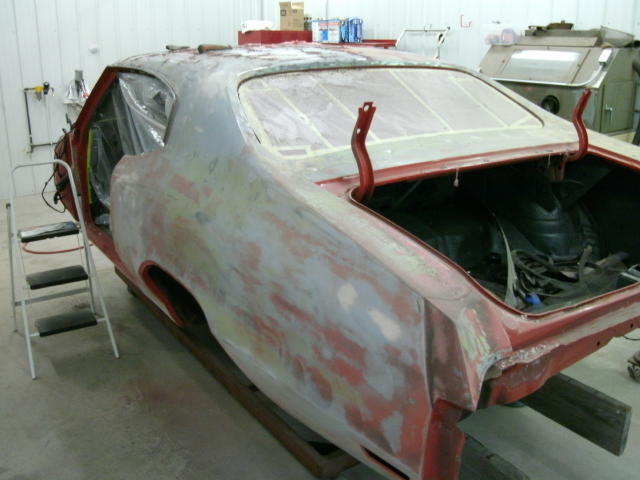

    Here's the same car several days later. All paint removed with blades of one sort or another. Vinyl top is gone also.

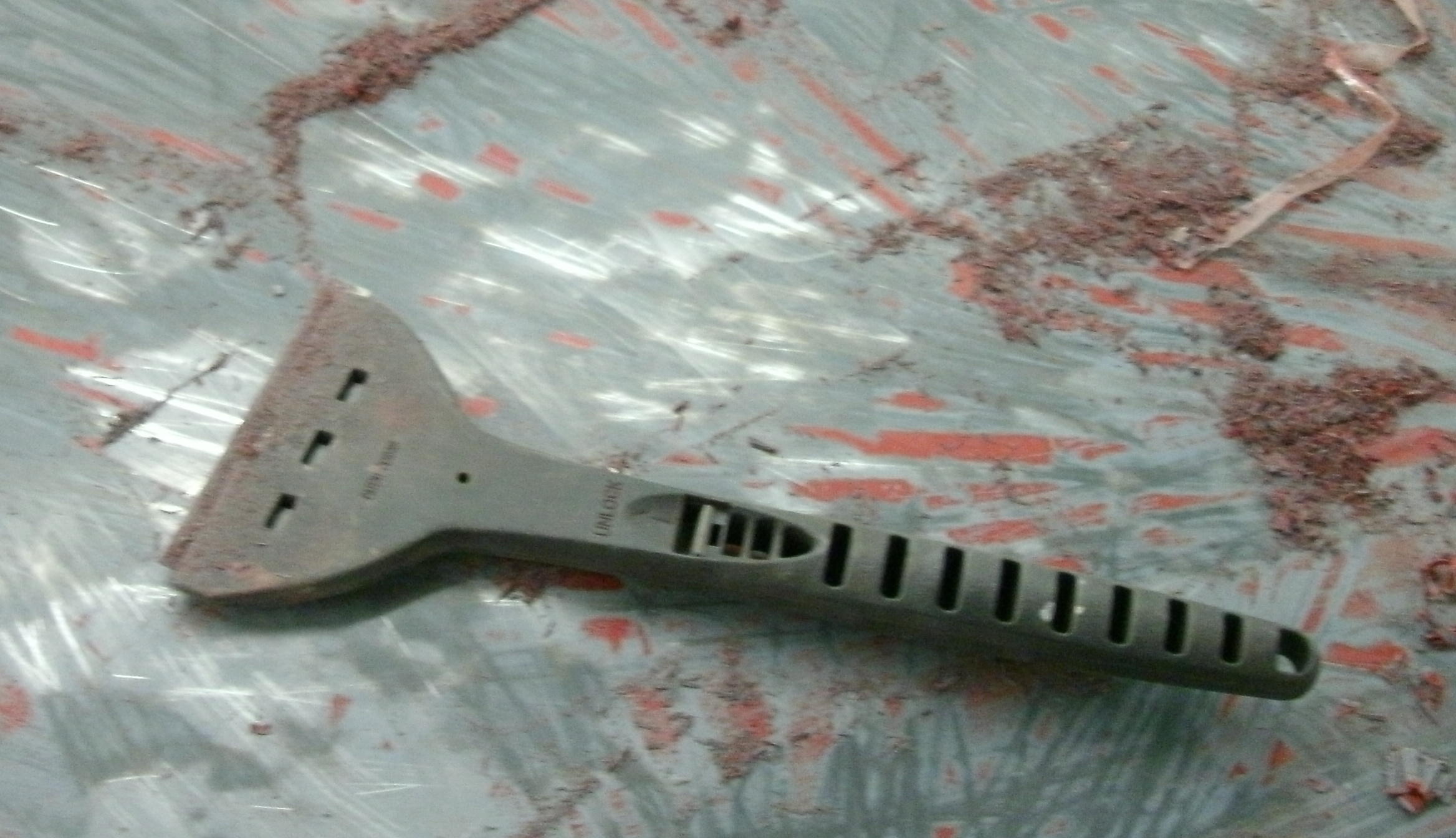

    Here's one of my favorite s****ers for large areas. I think the brand is Hyde.

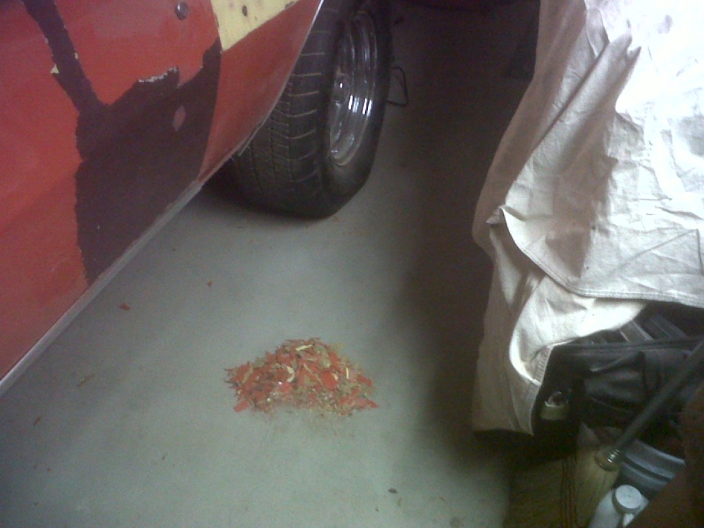

    Learn a lot of things on the HAMB. Once I read this I ran downstairs at 11:30 PM and tried it out. It worked great. Went to Home Depot and got $18.00 of blades, holders and a s****er. Here's a picture of some of the work.
