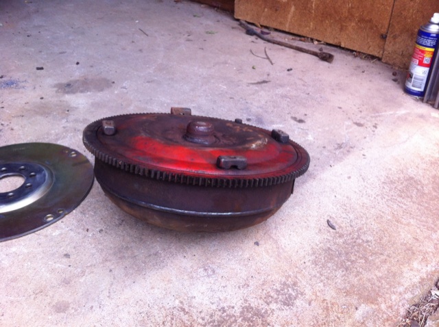

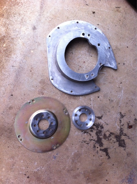

  5. There is no instructions, bolts, holes are not tapped in the bell or anything else I can use for reference.
    It's most likely the first Model A 904 adaptor in Australia. I guess it's not even common in the states.
    I would love to be proven wrong and if anyone has experience in fitting one of these kits I would love to here from you.
    I was going to purchase the kit that used the T350/400/700 autos that included everything including instructions but after a "interesting" reply to a email question I sent to the manufacture, I have no intention of ever purchasing from that company.
    Will keep working with this $500usd kit and make it work :)

  12. I have the instructions for that kit somewhere's, if I can locate I will send to you . If not I will send you a contact for the individual that makes a kit.
