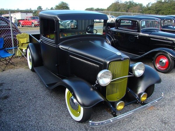

    Here's my driveway painted shop truck, which was done with Blitz Black. One of the nice things is that you can get it in rattle cans, too. This shot was probably taken about six years ago & the paint has really held up well. I used the truck today to haul a pile brush to the muncher.
