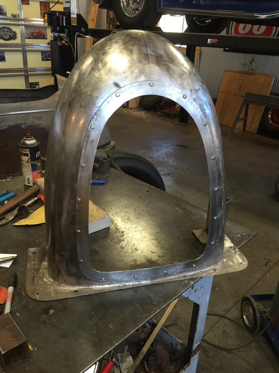

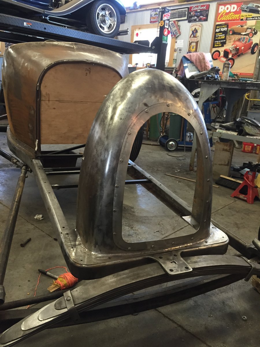

    Made a stainless grill surround the other day. Cut it out, started shaping and quickly realized my skills bending metal are really limited so I had my metal wizard buddy mess with it for about 15-20 minutes and Bam it fits. My thought was to get the bars in and polish it but now I'm thinking it will get a scotchbrite finish. IMG_2610.JPG IMG_2611.JPG IMG_2612.JPG

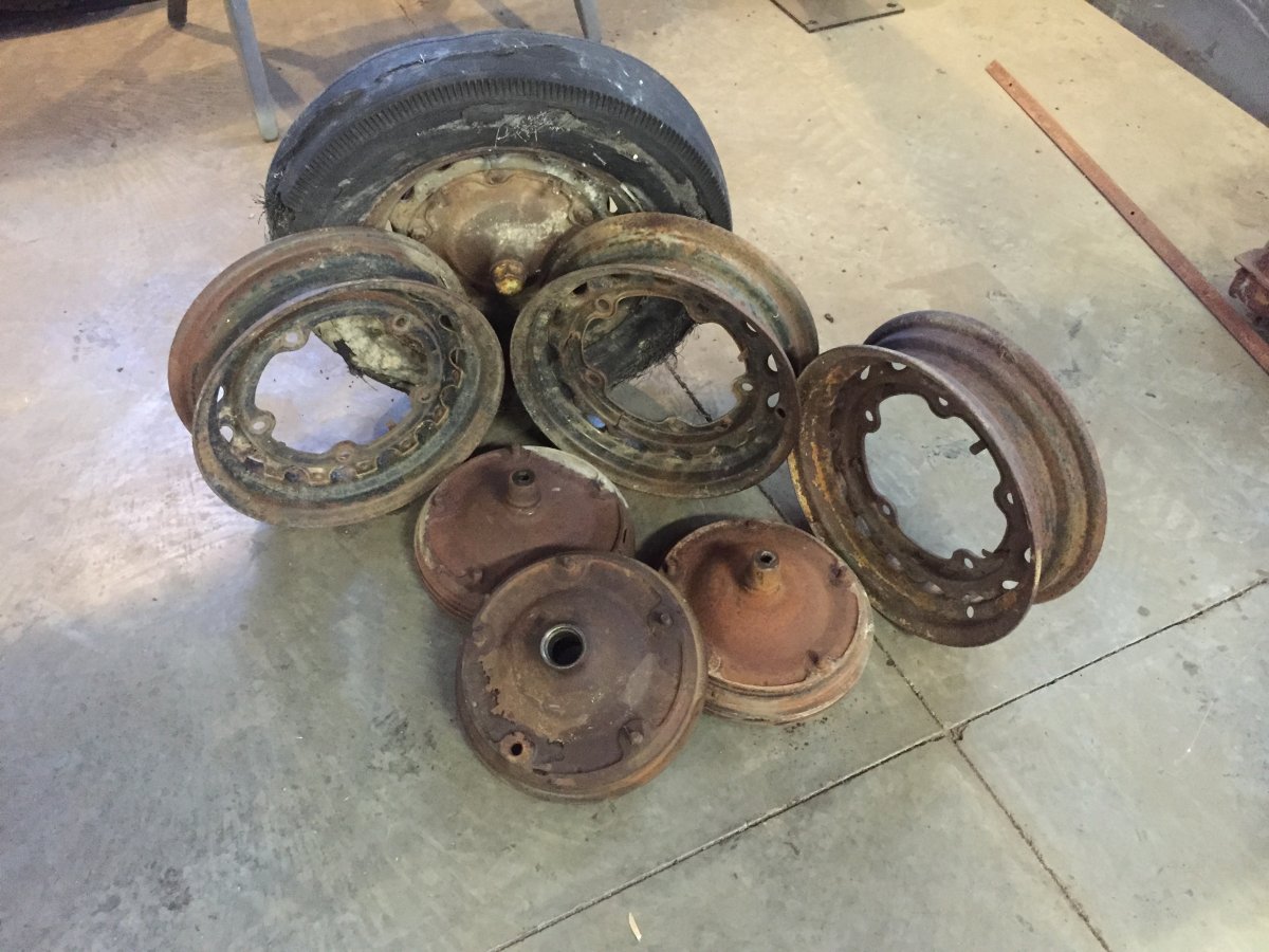

    Going a different route on my wheel selection. I was able to source 4 wide 5 rims, two 39 rear drums and two 37-8 front drums. All for the grand total of $25!!

    I was telling my pops that I thought it would look Kool with wide fives. He says an old buddy had just given him three wide five front drums and backing plates and he had 5 wheels pac ratted away that I didnt know he had. This morning we went and got a 39 banjo for $50 pops wants the rear and I want the drums. So the whole deal was $25.

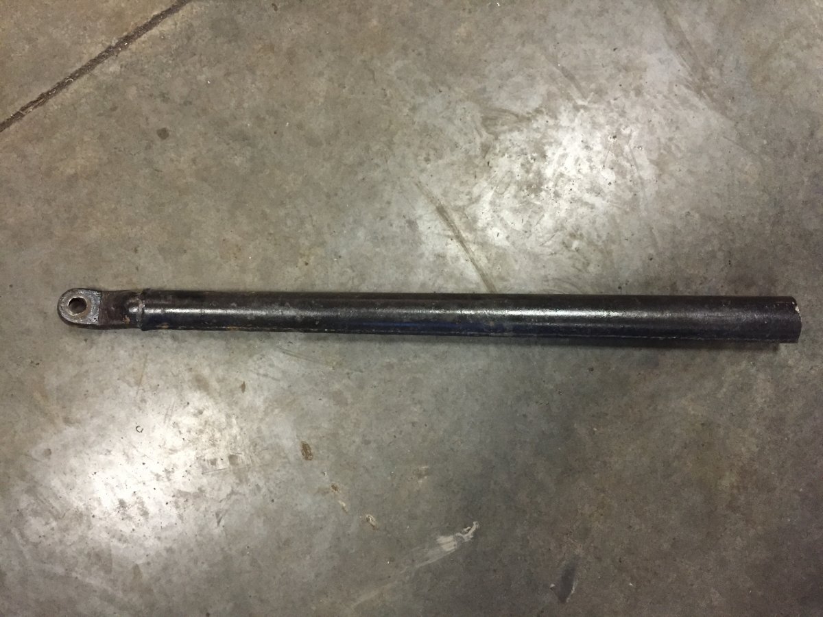

    So I had started another thread about torque arms on a banjo rearend. I figured out that just isnt going to work in my situation. So I had the cut offs from splitting my rear bones and this is what I came up with. IMG_2638.JPG IMG_2639.JPG IMG_2641.JPG IMG_2642.JPG IMG_2643.JPG At this point its just tacked together

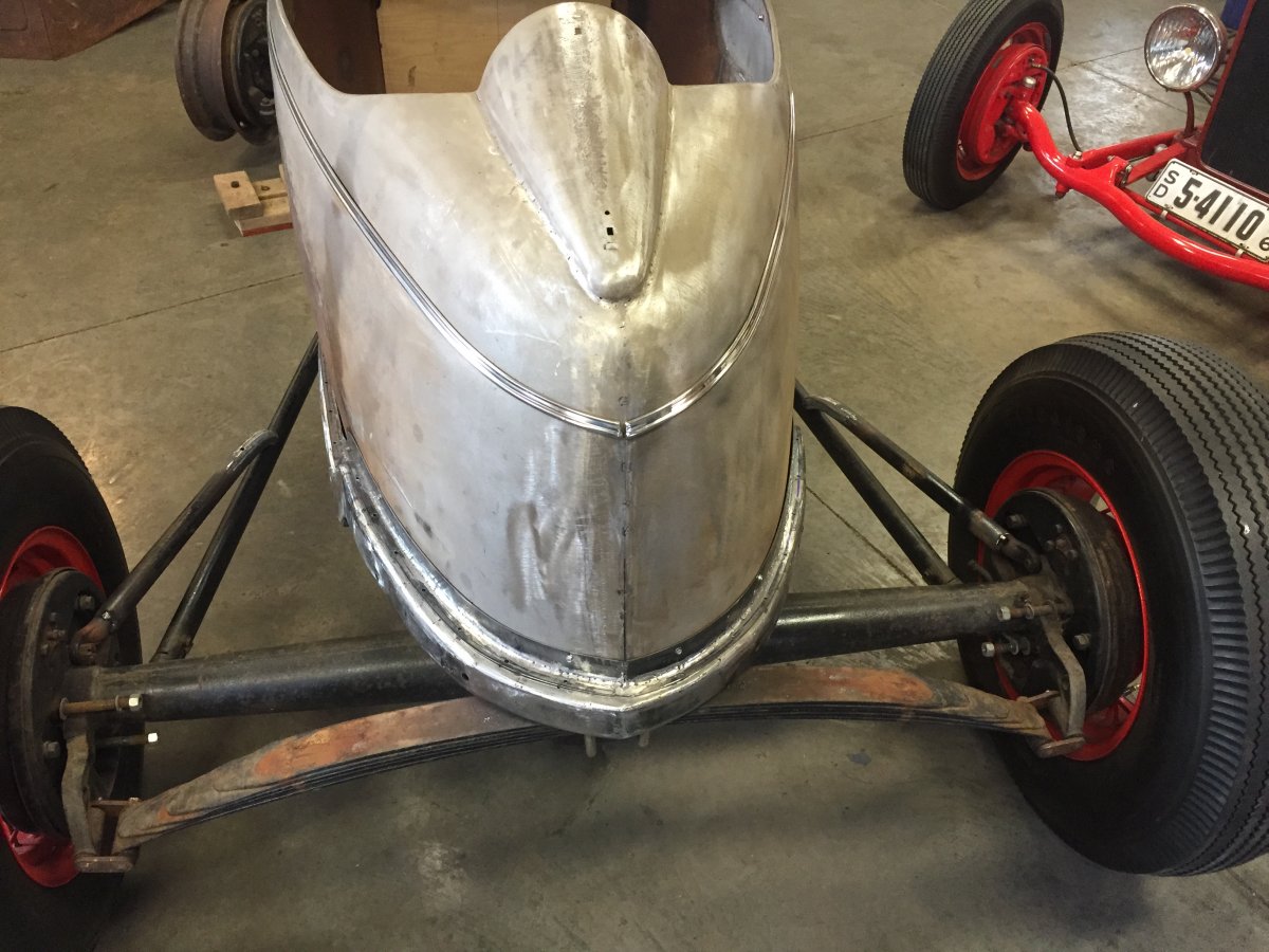

    Built a grill insert the last few days. Using 3/8ths stainless steel rod rolled thru my 3 in1, still need to add two more bars. It didnt turn out to bad for this build but it aint no Dan Fink!! IMG_2682.JPG IMG_2683.JPG IMG_2684.JPG
