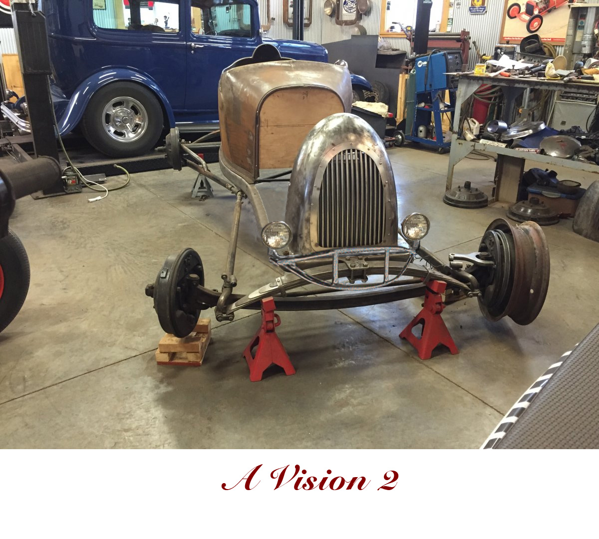

    If those are our choices; big.
  2. phat rat
    Joined: Mar 18, 2001
    Posts: 5,080
    phat rat
    Then keep looking. Your opinion is the one that matters
  3. rusty rocket
    Joined: Oct 30, 2011
    Posts: 5,254
    rusty rocket
    I dont like them because the car looks so kool with out lights. But I have to put something on it.
    Peanut 1959 likes this.
  4. graveyardsledder
    Joined: Oct 30, 2006
    Posts: 294
    graveyardsledder
    I lean more to the smaller ones, I think the bigger ones stick out like sore thumb. But that’s just me throwing in my two cents.
  5. Fabber McGee
    Joined: Nov 22, 2013
    Posts: 1,451
    Fabber McGee
    You could make them easily detachable so in the daytime you can take them off and tuck them behind the seat or someplace they don't show. Driving in the daytime most cops probably wouldn't notice that you don't have headlights. If they do, just pull them out and install them in front of him. Most of the late 60's Mercs had disappearing headlights, seems about the same to me. They had headlights, but they didn't show til the driver needed them and turned them on.

    Big looks more period correct.

    Just for fun, you might consider fab-ing up something like these Alfa Romeo GP / GT car mounts (but a little lower!) that allow the lights to be turned 90 to the inside, to keep their lenses clean and free of rock damage when not in use. I doubt there was any aero advantage, but they look racy to me. I still might do a pair for my Model A, whenever that gets started. Or not. Gary

    The big ones, mounted lower like stogy photo shopped them looks pretty cool.

    I'm sure that the folks who say the bigs look more period correct are right. However, that said, I think that big looks out of place on a race oriented car which should (imo) strive to be minimalistic. I think that the lights should come as close to disappearing as is physically possible.

    FWIW - big lights seem right to me

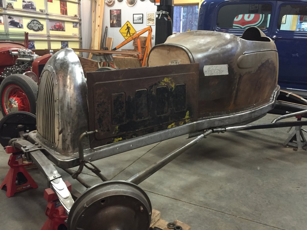

    ****ed around and cut down a 29 Packard eight side curtain I had found at a ranch years ago. I think its going to look *****in. I only have the one side but being that the car is going to have a six in it I think being asymmetrical will look alrite. IMG_2765.JPG IMG_2766.JPG IMG_2767.JPG IMG_2768.JPG

    Side curtain looks great! What about only one of the big lights, Centered?

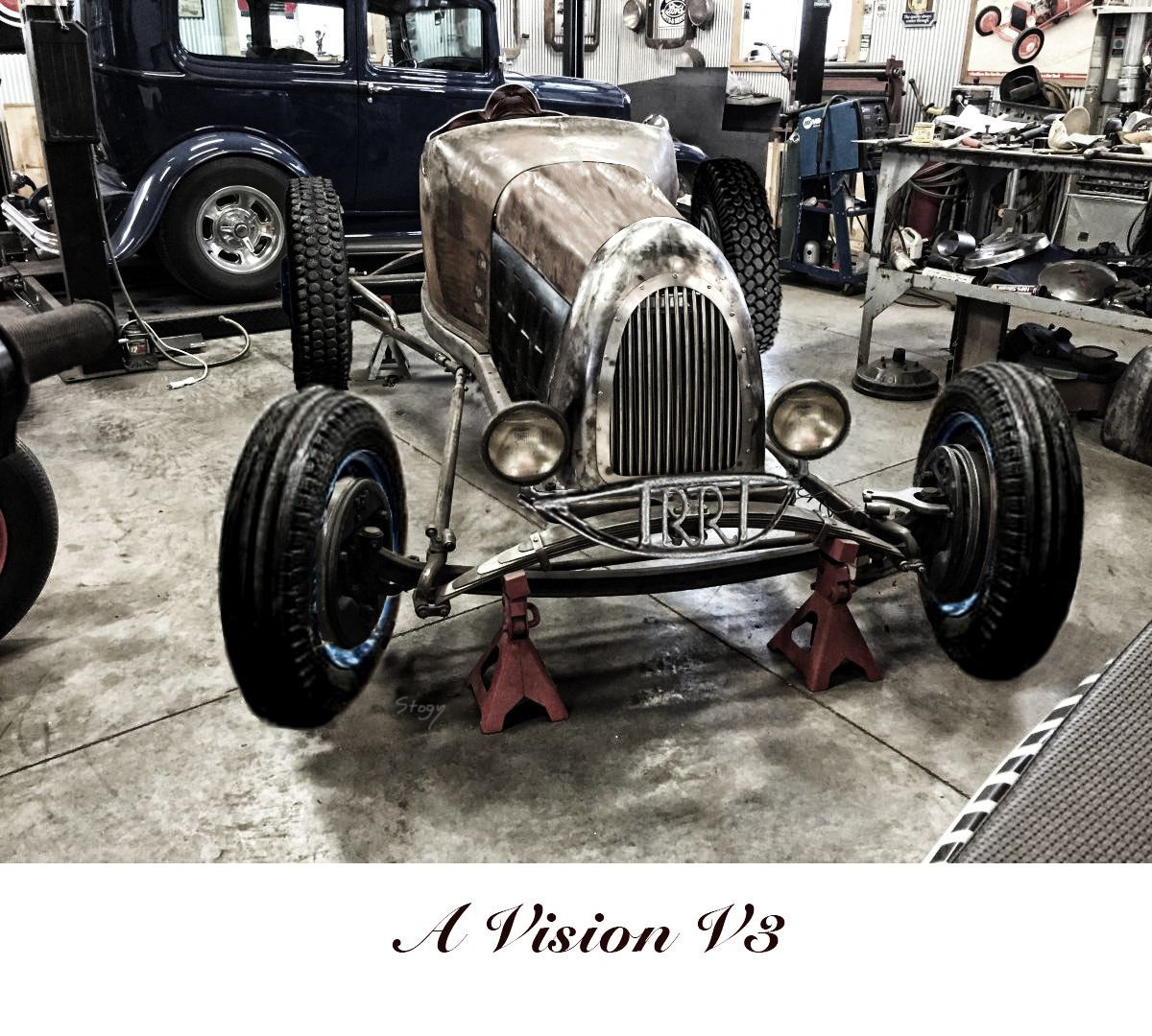

    Ha Ha stog, Did I mention that is the exact tire choice I want to run or did you read my mind? I would have to go back a few pages to see if I had mentioned that.

    You did mention the choice in a previous post and I figured at least the back ones were correct...these are dirt tires I understand and they look quite fitting on this Racer.
    Quite often initials were applied the the guards used as well. Finding suitable doners for the photo experience is a challenge. If the angle is off you can only distort it so much without losing reality.
    Hope this all helps make decisions down the road.

    I think that hood side would be just fine. Then run the same bead around the edge of the other side, and have the car-length chrome pipe poke right out of the middle.

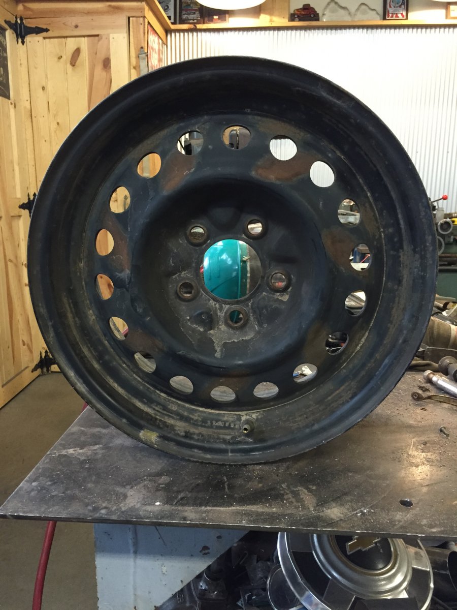

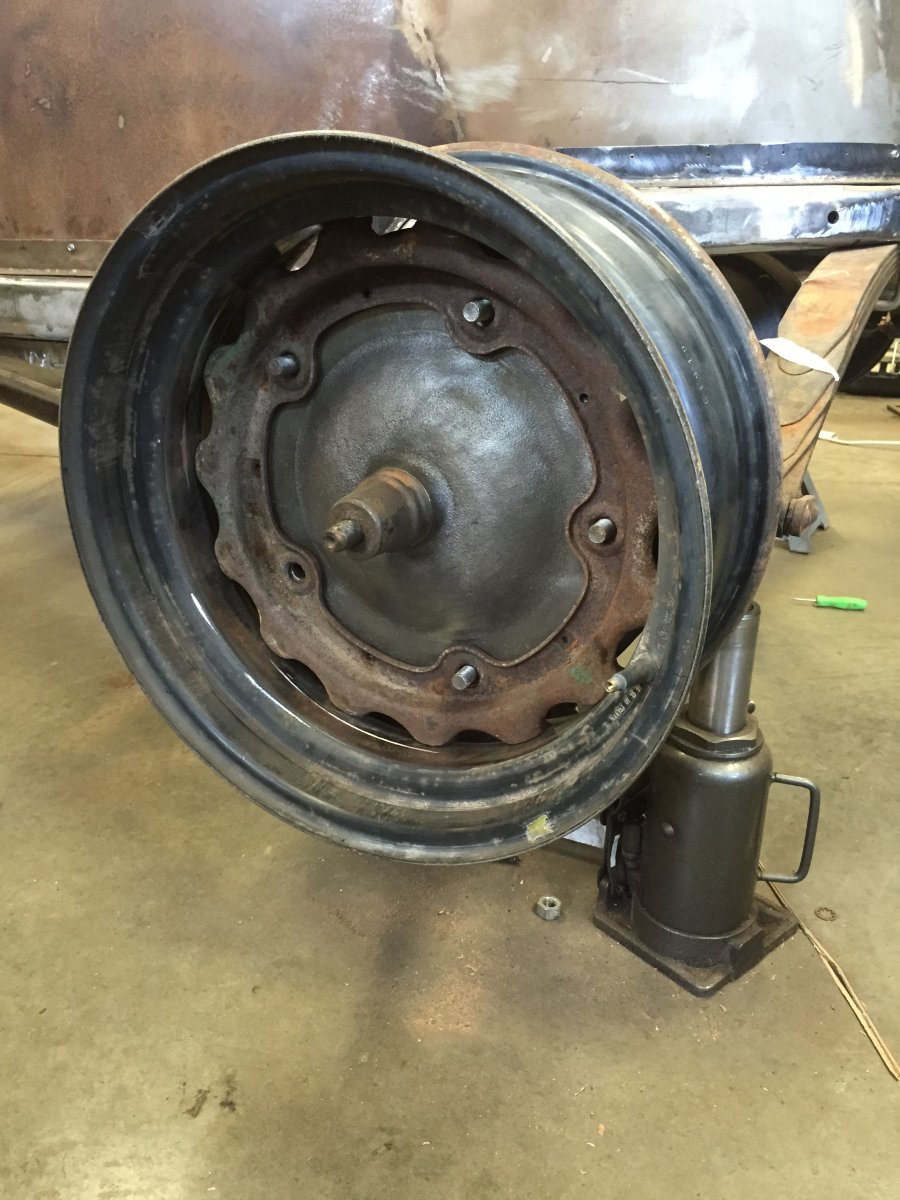

    I like the look of a wider wheel in the rear so I have been building a set of wide 5 wheels. I found a pair of Dodge intrepid 16x6 1/2" steel wheels(in the pic it says its a Ford wheel but it is not), the wide 5 centers fit like a glove. IMG_2769.JPG IMG_2771.jpg IMG_2772.JPG IMG_2773.JPG IMG_2774.JPG IMG_2775.JPG

    Very cool mod! Did you set the run-out and weld them yourself?
  24. rusty rocket
    Posts: 5,254
    rusty rocket
    I did. Every thing turned out good on the first wheel. Had about 10,000th on my homebuilt wheel stuck a stock wheel on and it had about 50,000th. so I think I did ok.

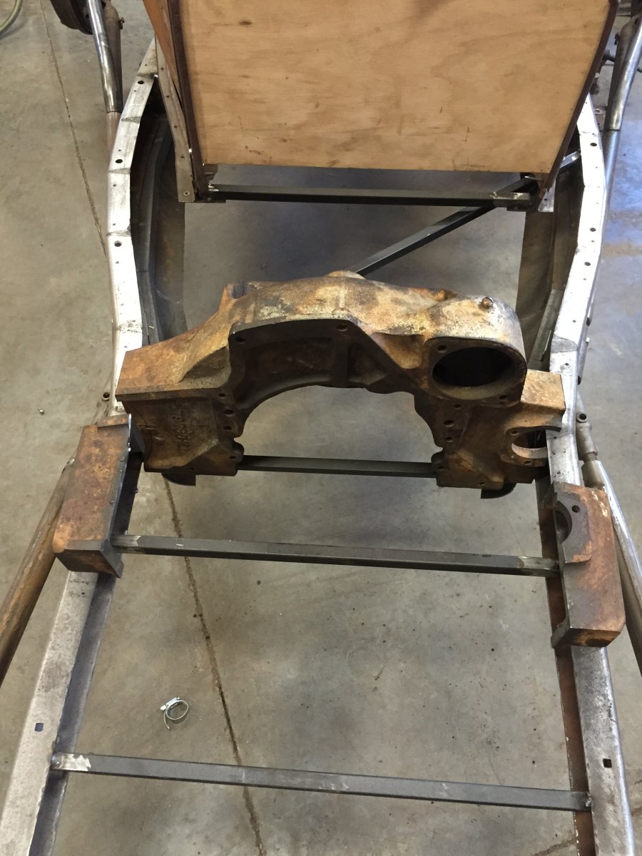

    Havent done **** on the project. Today after work I cut down my Dodge truck bell housing to fit between the frame rails. I still need to figure out how I'm going to mount the motor and trans. I think I,m leaning towards mounting it solid(like a real race car) IMG_2817.jpg IMG_2820.jpg IMG_2821.JPG IMG_2822.JPG

    Still looks mighty heavy. If you're not going to use it for mounting to the frame, you can take a hell of a lot more. Could even Swiss cheese it. Looks almost as heavy as the engine block, haha.

    Its still heavy as hell but until I have the motor and trans bolted to it I'm not cutting any more off it. And yes It might get some lighting holes in it.
