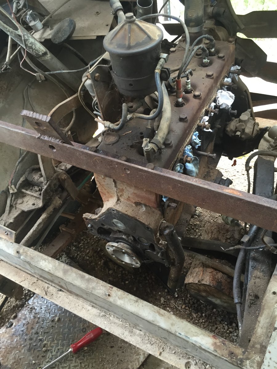

    IMG_2850.JPG IMG_2851.JPG One step closer to getting the motor out of the cube van. Seems like a never ending project due to weather, work, yard work, kid events,ect,ect. Trans is now laying on the ground and the motor is loose and ready to yank.

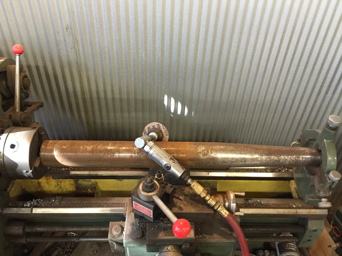

    Messed around with my 35/6 drive shaft that I'm going to use as an exhaust pipe. Man this thing is in really ****y condition. Cut it in half and chucked it up in my lathe so I can sand out some pits. Going too get some of the pits out but some are just to deep. I guess it fits the build. IMG_2847.JPG IMG_2849.JPG

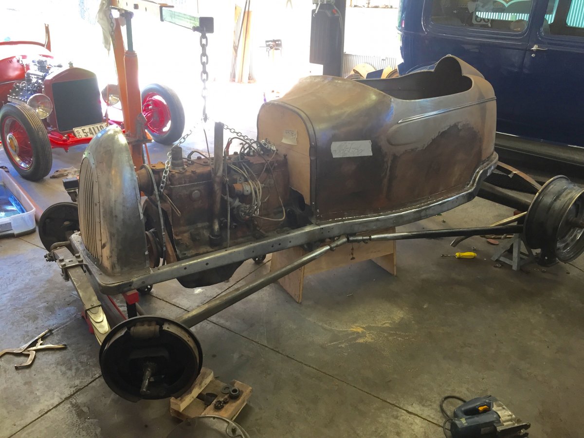

    It has a motor! Well sort of, just sitting on a box. I can see what its going to look like if I squint real hard. IMG_2857.jpg IMG_2859.JPG IMG_2860.JPG

    It sure does. I think everything should work pretty good except the fan. It runs off the water pump which is the highest part of the motor. I'm going to have to come up with a fan carrier to lower it. 8ba ford flatheads run a carrier so that might be an option.

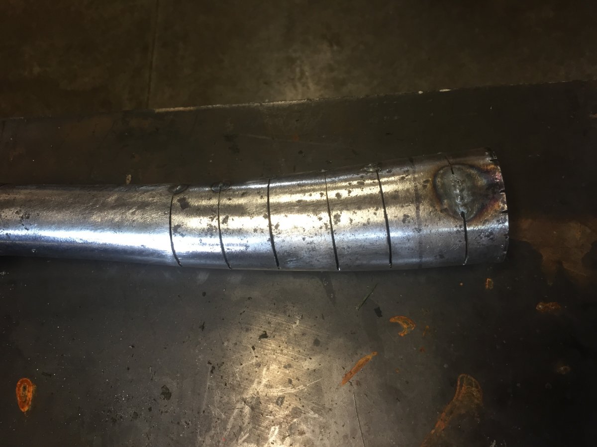

    I did a bit of cutting this weekend on the exhaust pipe. I was going to pack it with sand, heat and bend it but decided to cut the pipe almost all the way thru every 2" and then pipe clamp it back together and tack it. Up front the pipe needed more bend so I cut every 1". I also did the cuts on the 35 drive shaft cone to get a bend in it as well.
    Lots of welding and metal finishing but I have nothing but time. IMG_2891.JPG IMG_2892.JPG IMG_2893.JPG IMG_2894.JPG IMG_2895.JPG
