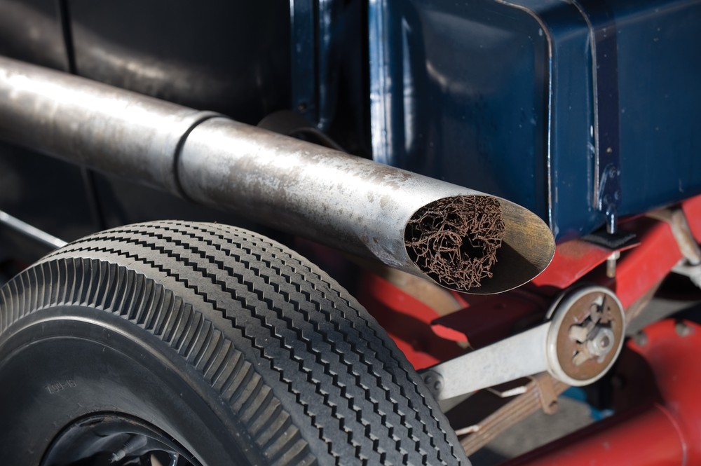

    I always thought this was a traditional solution. Rolled up chicken wire in the Garrick T.
    Greenblade, Flipper, brEad and 5 others like this.
  3. rusty rocket
    Joined: Oct 30, 2011
    Posts: 5,254
    rusty rocket
    Ha Ha, Now thats a way to do it. I will have to keep that in mind.

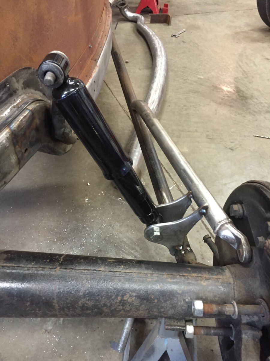

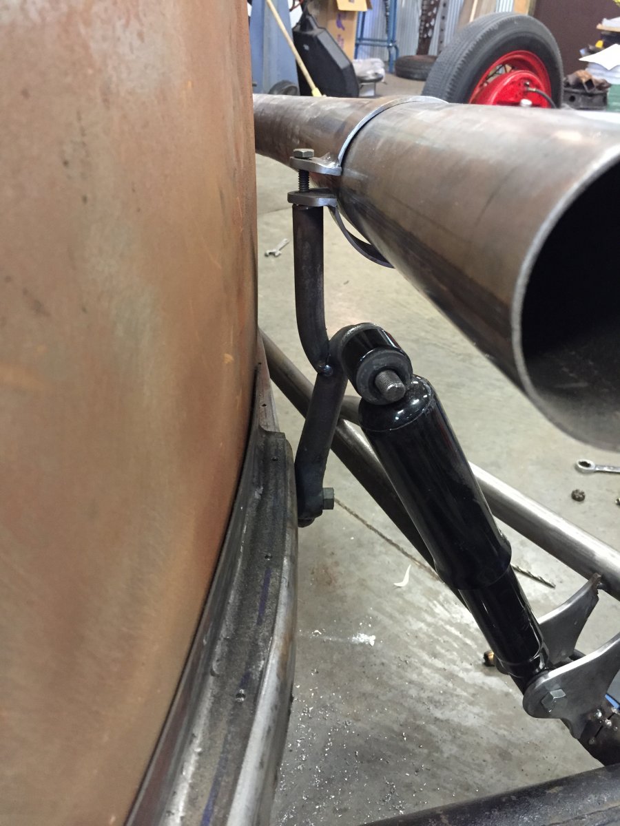

    Have the exhaust ruffed out and built a pipe hanger that will secure the end of the tailpipe. I will make a bracket off the shock mount when my shocks show up and I can get the final placement. Still trying to teach myself how to tig weld I need more practice for sure! IMG_2987.JPG IMG_2988.JPG IMG_2989.JPG IMG_2990.JPG

    Great work Rusty a like doesn't say enough...a very cl***y period in racing and your capturing that essence...it's a pleasure to be able to witness this adventure. Thank you.

    ...are you gonna rubber mount that exhaust clamp so it has some movement?
  22. rusty rocket
    Posts: 5,254
    rusty rocket
    My thought is- I have some black header wrap that I can wrap around the pipe, slide the clamp over it and just snug a bolt and castle nut/cotter key on it. I think it should allow enough movement

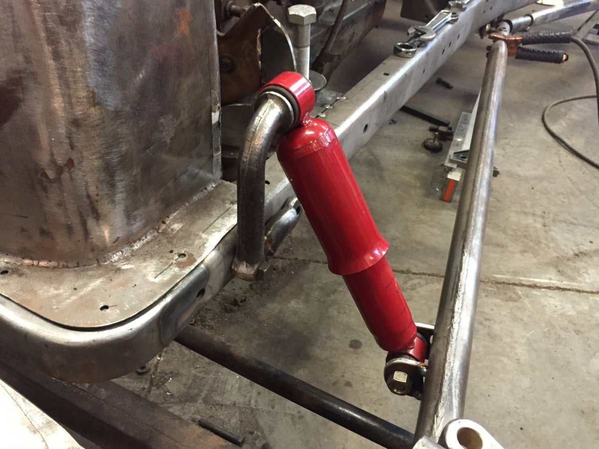

    Have one rear shock mount tacked in, as usual its overkill. I also added a bracket off of the top of the shock mount for my exhaust pipe. IMG_2998.JPG IMG_2999.JPG IMG_3001.JPG

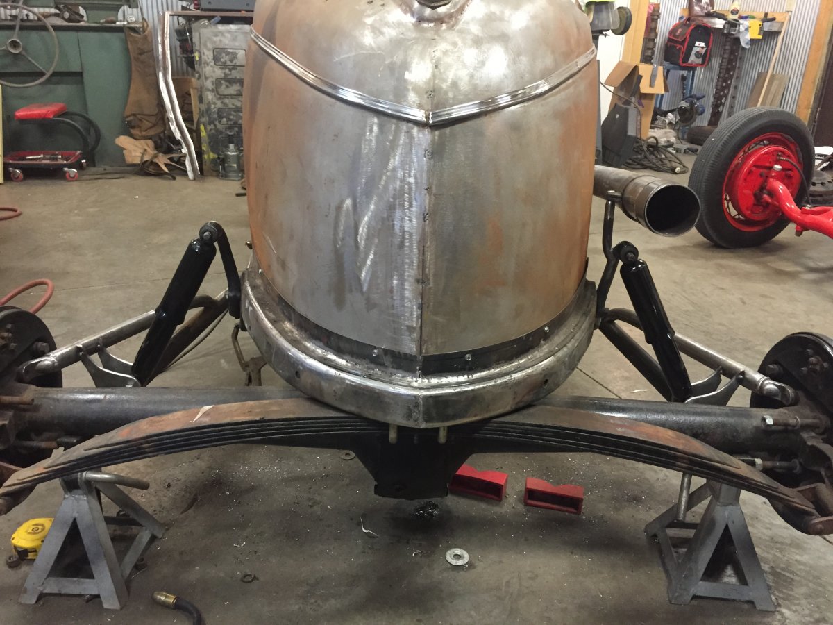

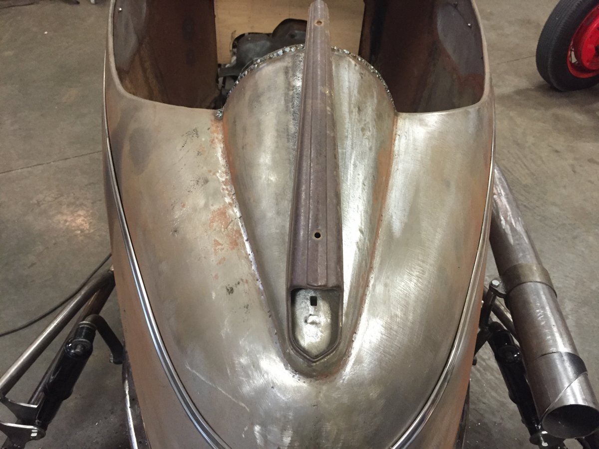

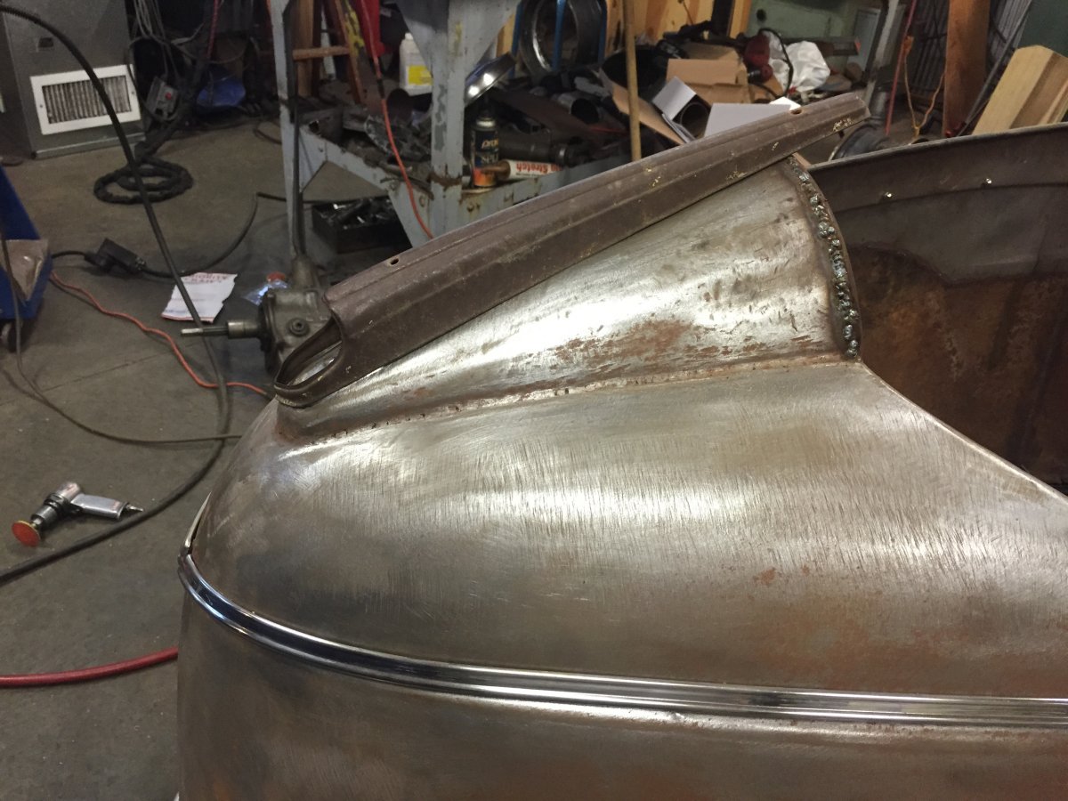

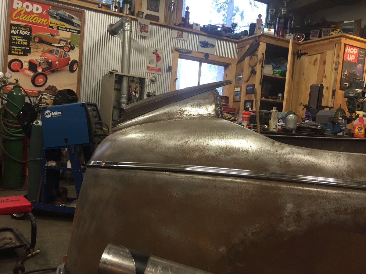

    So I had a thought the other day, My head rest is a 46 Chevy pickup headlight pod when I got the bucket it still had the running light attached to the top. I had taken it off and hung it on the wall but I got to thinking what if I turned it around backwards, shortened it, recontoured it to the head rest and use it for a tail light/brake light? I am going to run a single light under the center of the frame right behind the rear spring also. Thoughts? IMG_3006.JPG
