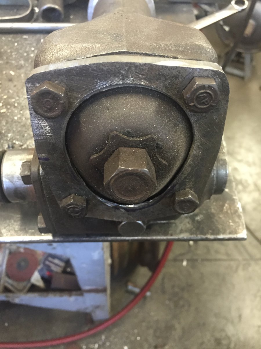

    I,ve been kicking around ideas on how to extend my steering shaft off my 50 merc box. This is what I came up with. IMG_3098.JPG I have a piece of 35 Ford drive shaft left over from my exhaust pipe build so I cut off the small end, chucked it in the lathe and trued it up. IMG_3100.JPG I then cut the arm off the pitman arm and bolted the splined part back on the box, the big end of the drive shaft fits perfectly over the splined piece. The small end is big enough for a socket to p*** thru so I can take the extension on and off. IMG_3101.JPG I have a few ideas on how to attach a pitman arm on the small end but I will think about it a bit more.

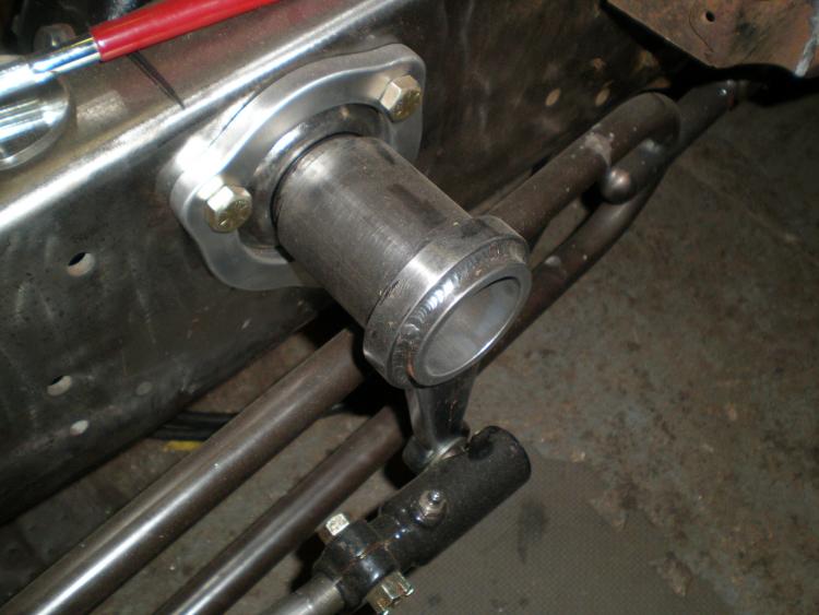

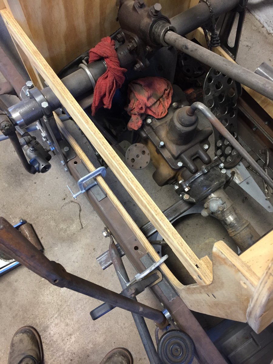

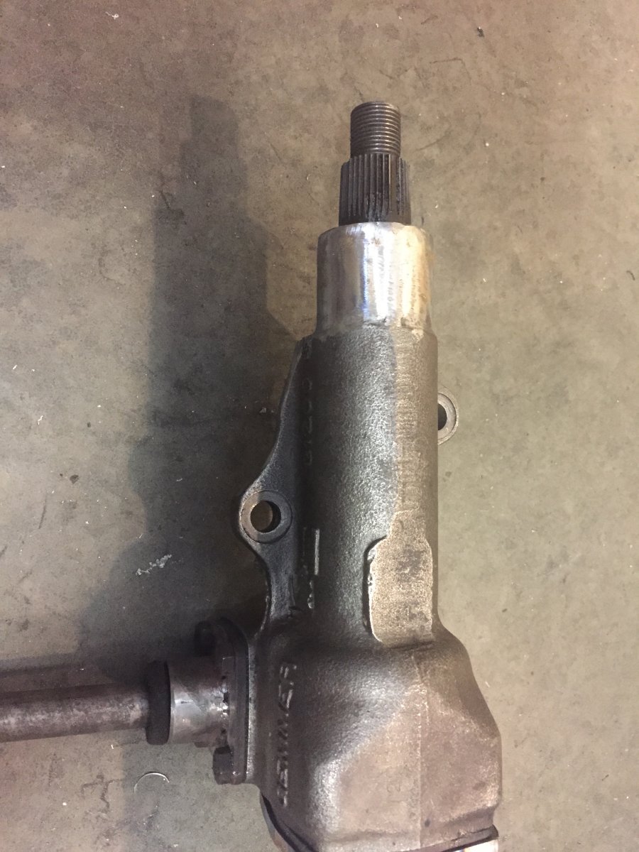

    I came up with a steering box mount. Since this is a use what you have build I used the rest of my 35/6 inner drive shaft to make an old school sprint car box. IMG_3182.JPG I cut off the last mounting tab and ruffed out the end of the box so it is round. IMG_3183.JPG I turned a chunk of alum. for a spacer for my drive shaft to fit on IMG_3181.JPG On the other end I built this plate so I could weld another chunk of drive shaft. IMG_3185.JPG IMG_3187.jpg And this is what it looks like. I need to cut it to length and build a few mounts off the frame.

    Some guys used to mount the Schroeder steering gears in old connecting rods, might look okay in this backyard whatchagot style racer build. Small journal Chevy rods with inserts fit the 2 inch steering box tubes.

    I built the frame mounts today after work for the steering box. I will throw a few gussets on for good measure. IMG_3188.JPG IMG_3189.JPG
