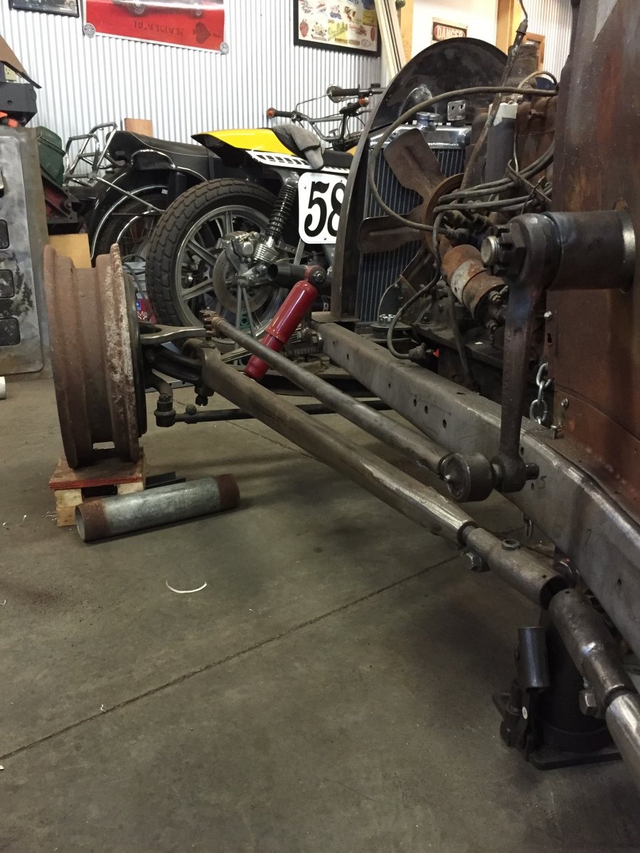

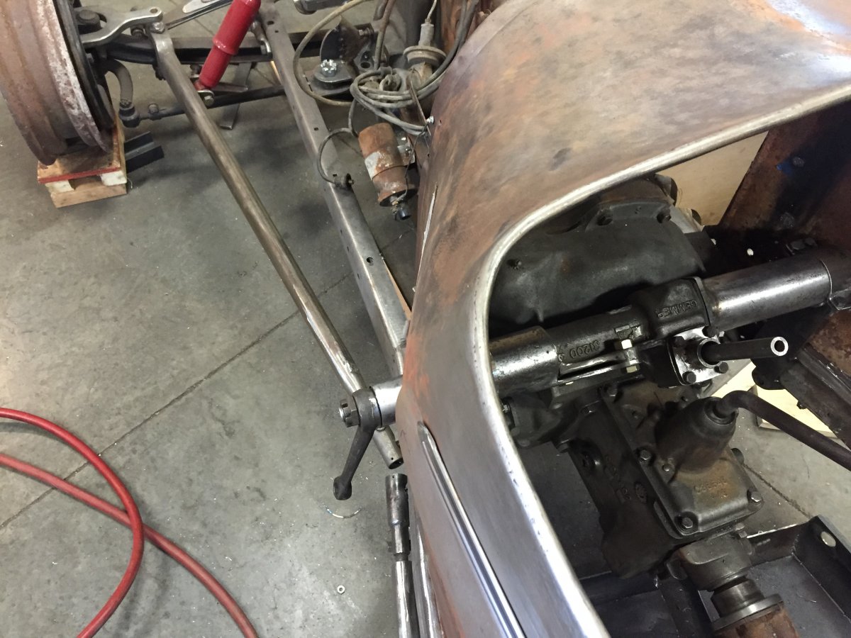

  3. rusty rocket
    Joined: Oct 30, 2011
    Posts: 5,254
    rusty rocket
    I had my buddy tig up my steering box extension so I was able to mount the box and poke a hole thru the cowl. IMG_3194.JPG IMG_3195.JPG IMG_3196.JPG I also started ruffing out a dash so I can mount my steering column to it. IMG_3197.JPG IMG_3198.JPG IMG_3200.JPG

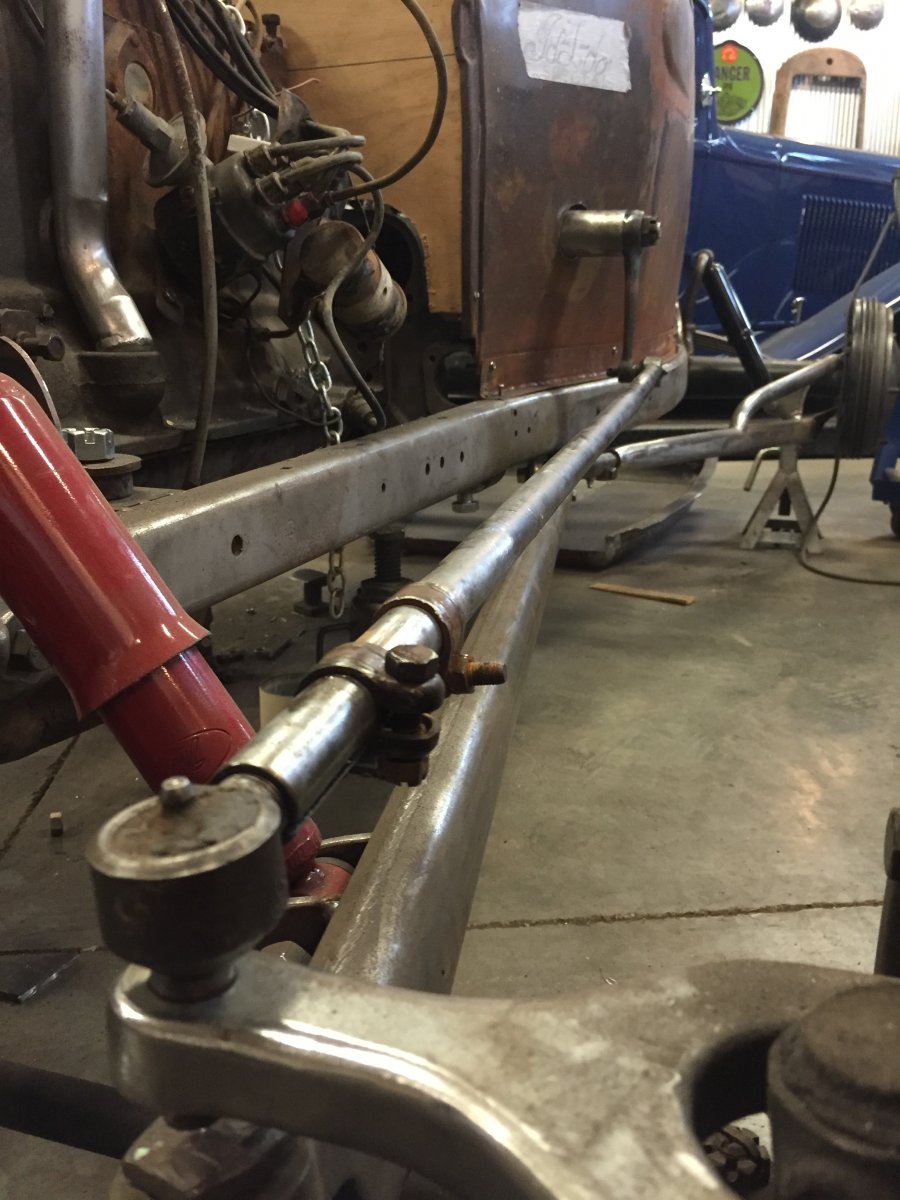

    Had an old tie rod laying around for my drag link but it was three inches to long. I cut it off and borrowed a buddies 11/16 right hand tap. Holy cow what a ***** to tap but I got it. IMG_3209.JPG IMG_3210.JPG

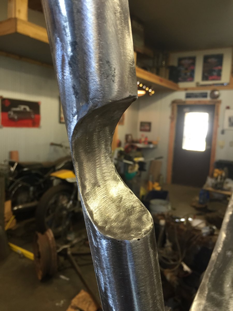

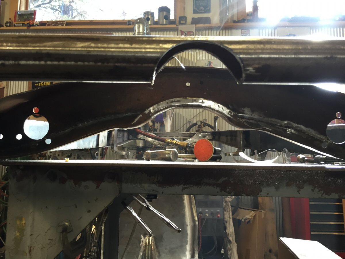

  13. rusty rocket
    Posts: 5,254
    rusty rocket
    I had to make clearance for my driveshaft but couldnt move my seat riser. I used a piece of wood clamped to the pipe to guide the hole saw. IMG_3251.jpg IMG_3253.JPG IMG_3254.JPG IMG_3255.JPG

  14. gdaddy
    Joined: Mar 6, 2010
    Posts: 169
    gdaddy
    from nw fl.
    that is a good ideal , the hole saw and wood for a guide , love the build .

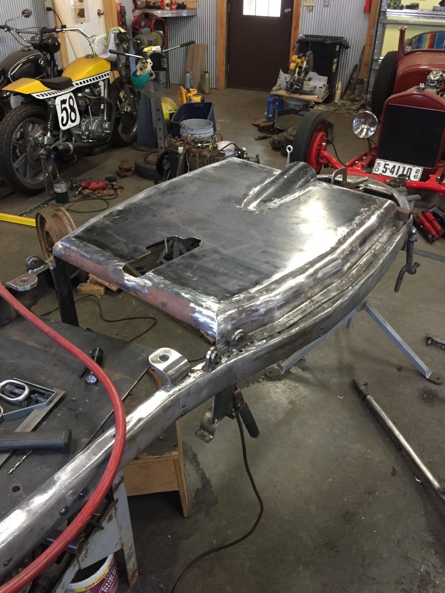

    I got my floorpan/footwell mounted to the bottom side of the frame. I think my last big hurdle will be clutch and brake pedal placement. IMG_3262.JPG IMG_3263.jpg

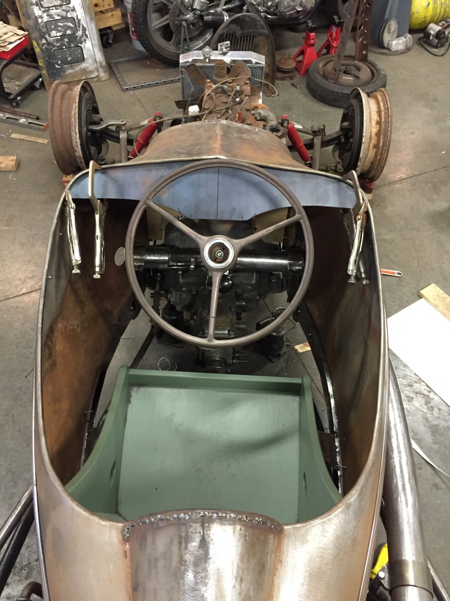

  21. rusty rocket
    Posts: 5,254
    rusty rocket
    I built a set of hinges so I can flip the seat forward to access the back to the tail section. IMG_3270.JPG IMG_3266.JPG IMG_3267.JPG IMG_3268.JPG

  22. Nice! I love that seat man.

    Blues4U
    from So Cal
    Are you going to latch it down some way? I'm going to install new seats in my model A and am thinking of installing a hinge in front so they can flip forward like this, to access behind them, but I'd want them latched when in the down position.
    Stogy likes this.

  25. rusty rocket
    Posts: 5,254
    rusty rocket
    Yes I will come up with some kind of latch for the back, just have to stew on it for a bit and see what I come up with.
    Thanks, its different but fits the build.
