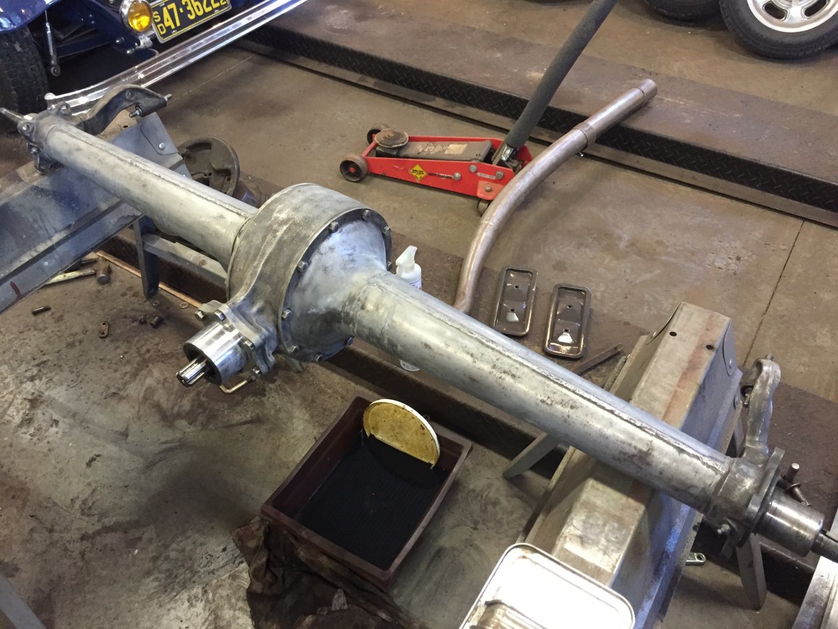

    I have been cleaning the rear end, spring leaves and rear bones. They will all get a coat of Bill Hirsch ch***is paint. I have had good luck with Hirsch engine paint but I have a real problem with there shipping, $22 to ship a box just big enough to fit a quart can from Newark N.J. to South Dakota. And it took eight days from the time I ordered.:mad: IMG_3283.JPG

    Tim_with_a_T
    What are you using to clean parts with? Looks ultra sanitary!

    rusty rocket
    I used a purple scotch brite type disk a wire wheel and a ****load of elbow grease. After I got all the paint and rust off I use some metal prep that neutralizes whats left of the rust and leaves a white hazey finish on the metal. wiped the haze off with some lacquer thinner and then prime and paint.

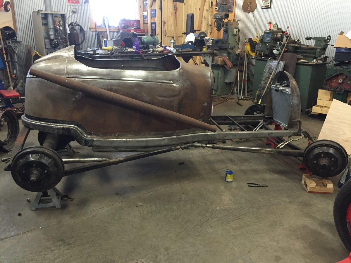

    rusty rocket

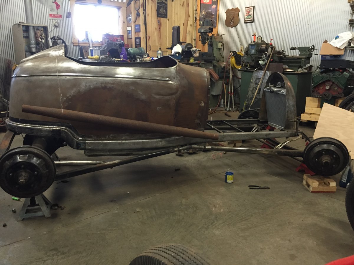

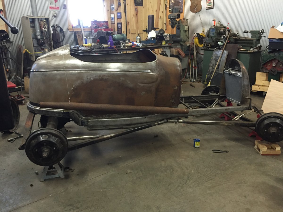

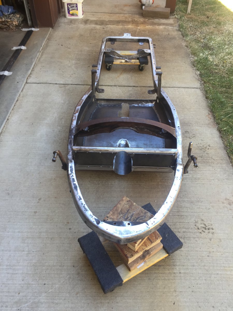

    Rolled the ch***is outside after I got it all boxed so I could stand back and admire. IMG_3307.JPG IMG_3310.JPG IMG_3308.JPG

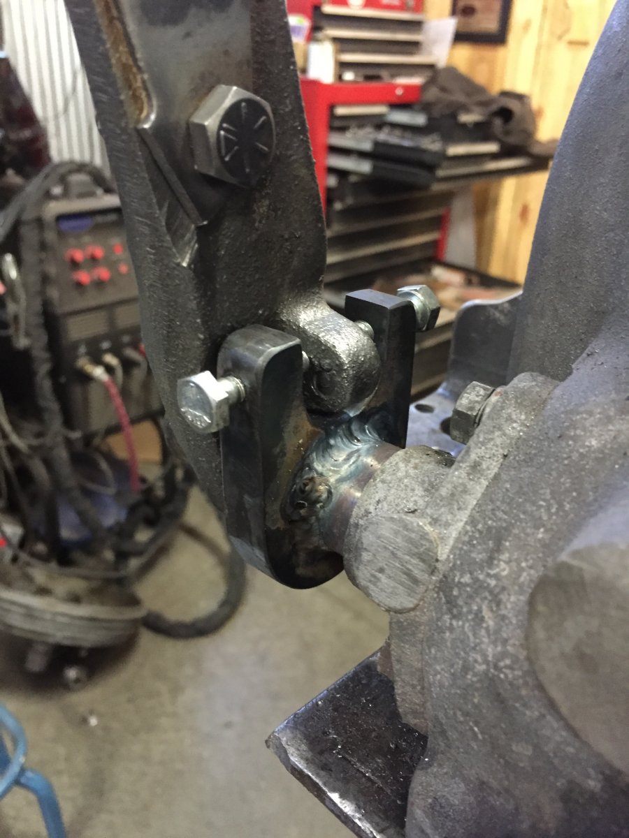

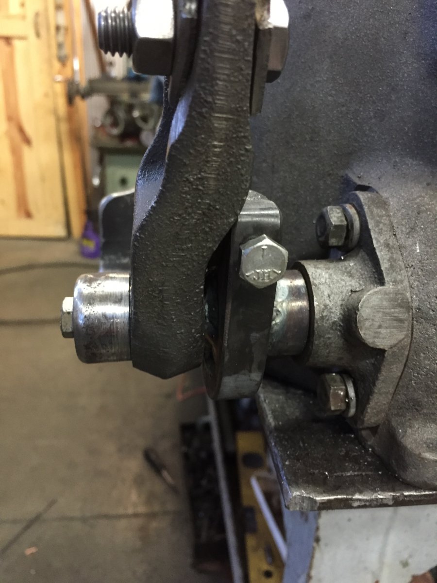

    Did some work making an adjustable bracket to attach my clutch handle to the throw out bearing pivot arm.

    Clutch handle, haha, that's f'n great. Makes me grin. Like everything else on the car, that looks to be a pretty clever piece of fabrication.

    :rolleyes:...I'm sure it will have a learning curve...but that's part of the fun.

    Yes, I think there will be a learning curve for the clutch:). I got everything put together last night and it actually engages and disengages. Should be entertaining hand clutching and shifting while your steering with your knee!

    No problems especially on the curves...:D...I suspect your knees will be quite close to the wheel in that cosey space...so wedging them should be doable.
