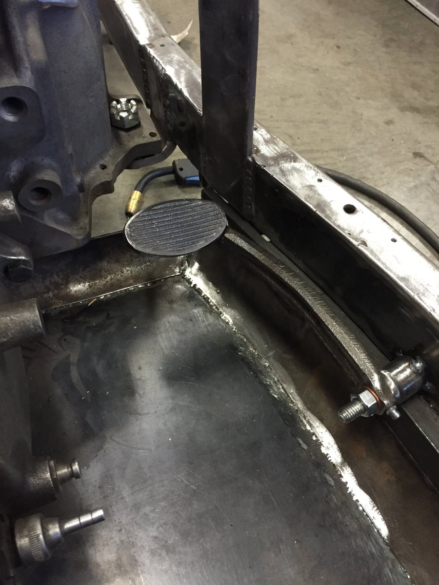

    I've been working on brake and gas pedals. This is what I came up with for the gas pedal. Instead of pushing forward on the pedal you will have to push down on it, sort of like a sprint car. I will weld a tab on the side of the arm for a throttle cable and a big return spring
    This what I started with. IMG_3329.JPG And this is what I ended up with. IMG_3330.JPG

    I got the brake pivot and pedal ruffed in. I used a junk 40 ford arm with a 40 dodge pickup pedal pad grafted to it. I still need to get a few clevises and a rod to attach the pedal to the master. The master will hang out under the seat so a guy will not see to much of it, that suits me since it is one of the only non vintage parts on the build. IMG_3332.JPG IMG_3333.JPG

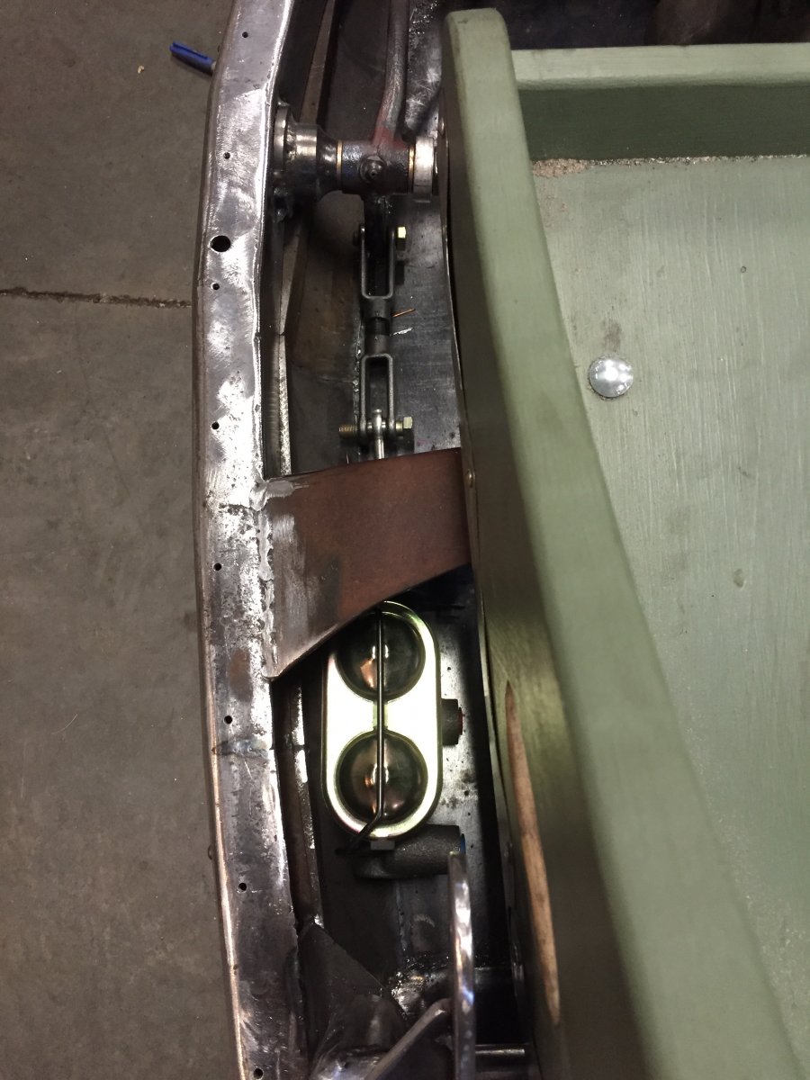

    Since my master cylinder is one of the only new style parts on the car it bugs new that you can see it.
    I had an old 40 ford master cylinder laying around so I cut the top off it and put it over the new style master. The only way I can think about mounting it is the use some strong rare earth magnets between the caps. IMG_3347.JPG IMG_3348.JPG Any thoughts? I know its a fake out but once the bodys on maybe the new master will not jump out as much.
  7. brad2v
    Joined: Jun 29, 2009
    Posts: 1,659
    brad2v
    I'm typically not a fan of fake stuff, but that's pretty neat.
  8. Fabber McGee
    Joined: Nov 22, 2013
    Posts: 1,458
    Fabber McGee
    Is there something to keep the brake linkage from hinging in the middle? Seems like you might want a one piece push rod from the pedal arm to the master cylinder. Maybe I'm missing something here.
    Fitty Toomuch likes this.
  9. rusty rocket
    Joined: Oct 30, 2011
    Posts: 5,262
    rusty rocket
    I wanted some adjustment in the linkage so that is why I used the yokes. it doesnt hinge and I didnt want to cut the pushrod arm. I guess I could make a small bracket to hold the push rod arm.

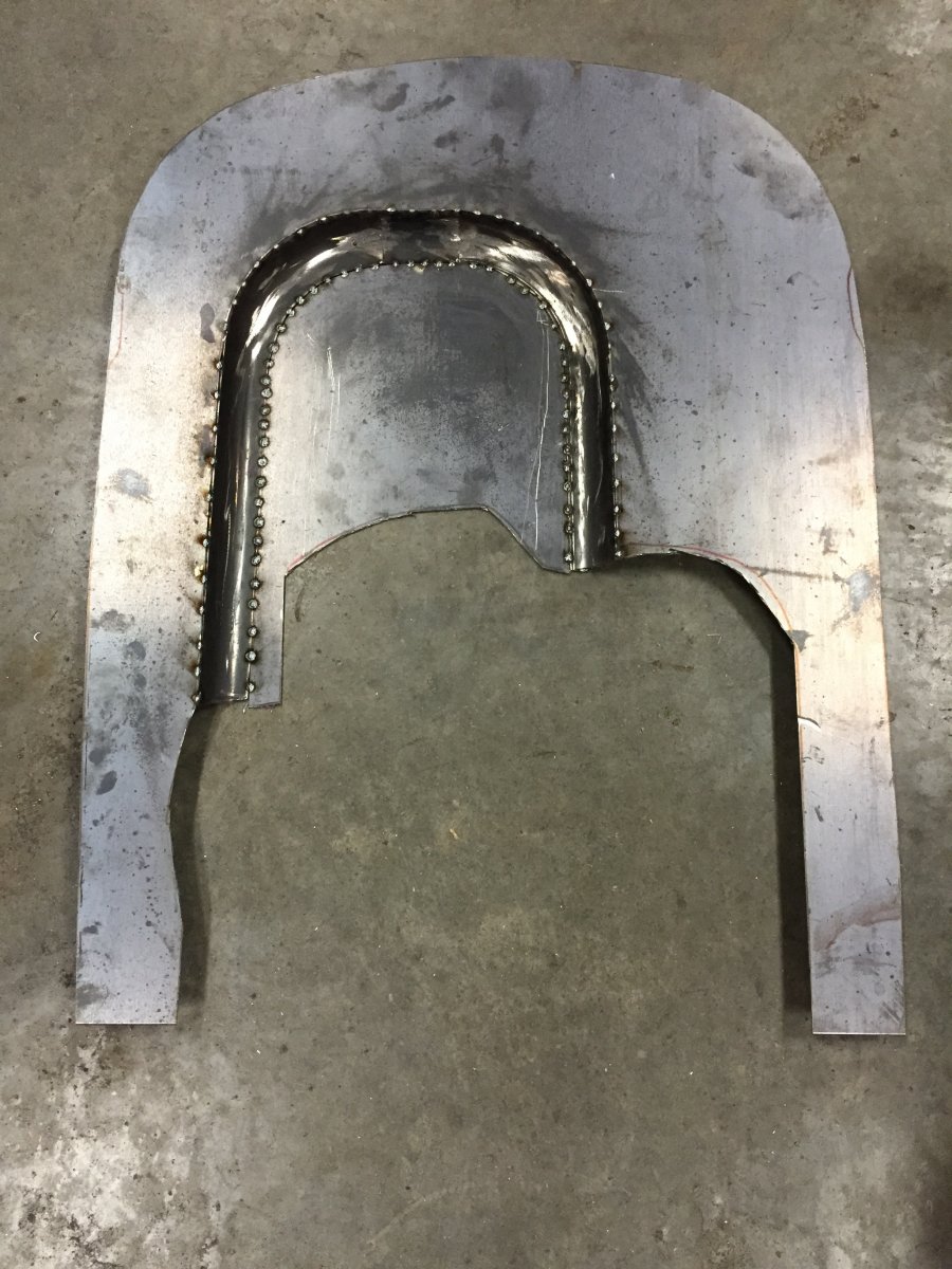

    Been messing around building a firewall. I used some leftover mandrel bent exhaust tubing cut in quarters for the radius of the setback. I bought a sheet of hot rolled 16 gauge by accident(should have got cold rolled) I used an old T shirt soaked with muratic acid to get rid of the mill scale.ATTACH=full]4105542[/ATTACH] image.jpg image.jpg

    image.jpg image.jpg image.jpg image.jpg My buddy asked if i was going to put an interior in the car. My thought was its a race car it doesnt need an interior. I did **** around and made a homegrown dimple die panel. Its really not going to do much but be something to look at.

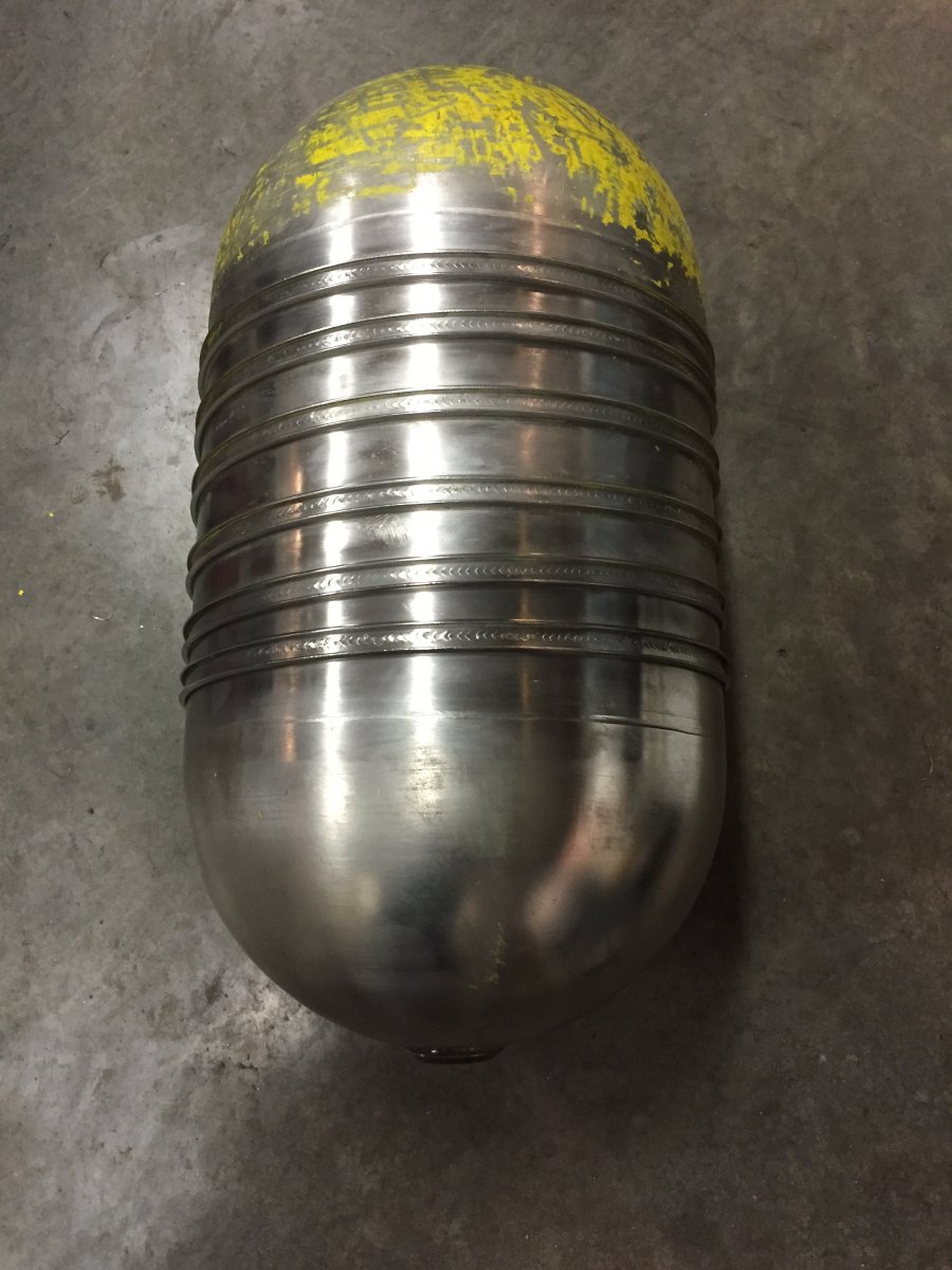

    image.jpg Been messing around with my oxygen bottle/gas tank. Zip stripped the old zinc chromate and now wire wheeling all the nooks and crannys

    Does that tank have baffles? I'm thinking not as Oxygen is a gas correct...:confused:
    The kuku face above is because if it can be liquid I will have exposed my expertise in chemistry...:D
    It is also interesting the segments seem to suggest the tanks were easily modifiable by adding sections to fit whatever application it was used for.

    The tank will have to stand on end at a slight angle in the tail section. To make it fit I have to make a pocket at the bottom to clear the center section of the banjo rear end. I could easily add a baffle when the pocket gets cut in, although I don't know how much the fuel will slosh around with the tank in the upright position.

    I also can't get on board with your current brake master rod. Having that extra hinge point in the middle is dangerous. A new rod with one clevis on the front end is best.
    I will say I am watching all your other fabrications to steal ideas for my narrowed T project.
  25. rusty rocket
    Posts: 5,262
    rusty rocket
    I understand but the rod is so short it doesn't bend in the middle. The push rod fits inside the master and keeps everything in alinement. I want to keep the stock mustang push rod in case I'm somewhere away from my shop and need to change out the master.

    What if you tapped a close-fitting eye-bolt into the frame for that push rod to p*** through? That way it couldn't move vertically and there would be no way for it to kink? Just a thought. I drew a quick and dirty picture.
  27. chickenridgerods
    Joined: Jul 22, 2003
    Posts: 1,550
    chickenridgerods
    from DSM, IA
    I think that you'll find that once you have the hydraulic system filled, bled, and are applying force to the pedal, that you're linkage between the pedal and the M/C piston will deflect. Take the boot off of the M/C and look at how the rod isn't really held in alignment by the M/C.
    You really should eliminate that middle clevis. It's not safe as is.

    To everyone who was concerned about the brake linkage not p***ing muster, thanks for your opinions. I made a small tab that locates the bung and does not allow it to turn. I am still using both cleavis's but now when the rear cleavis is cinched down it cant turn. Thanks again guys. image.jpg image.jpg image.jpg
