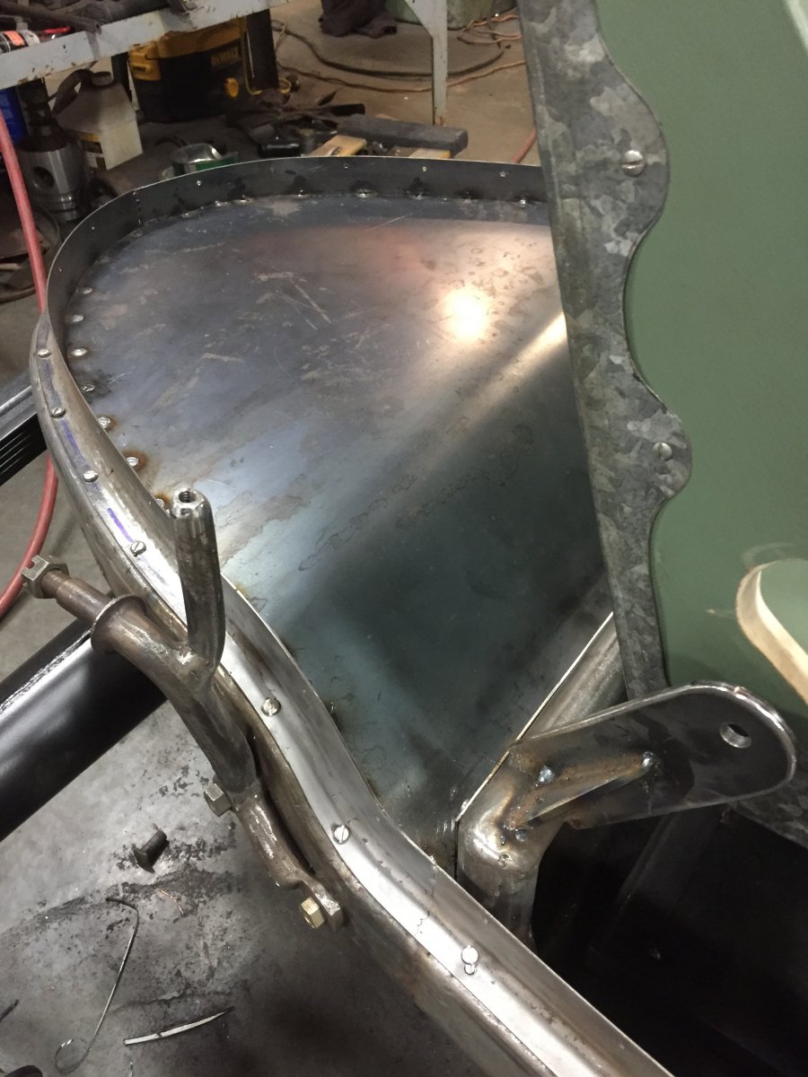

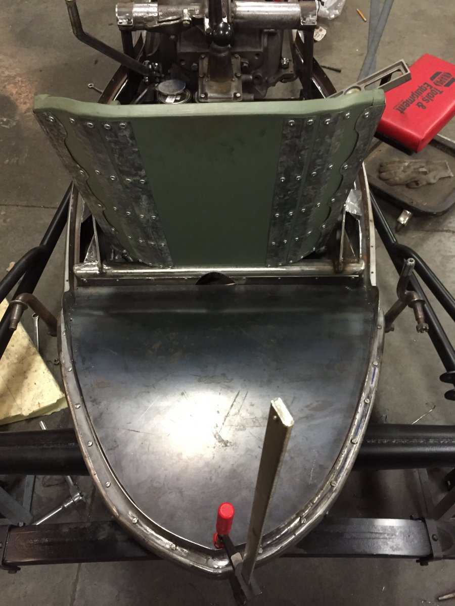

    image.jpg image.jpg Started bending up a floor in the tail section. Been cold and snowy so its a bit tuffer to get motivated.

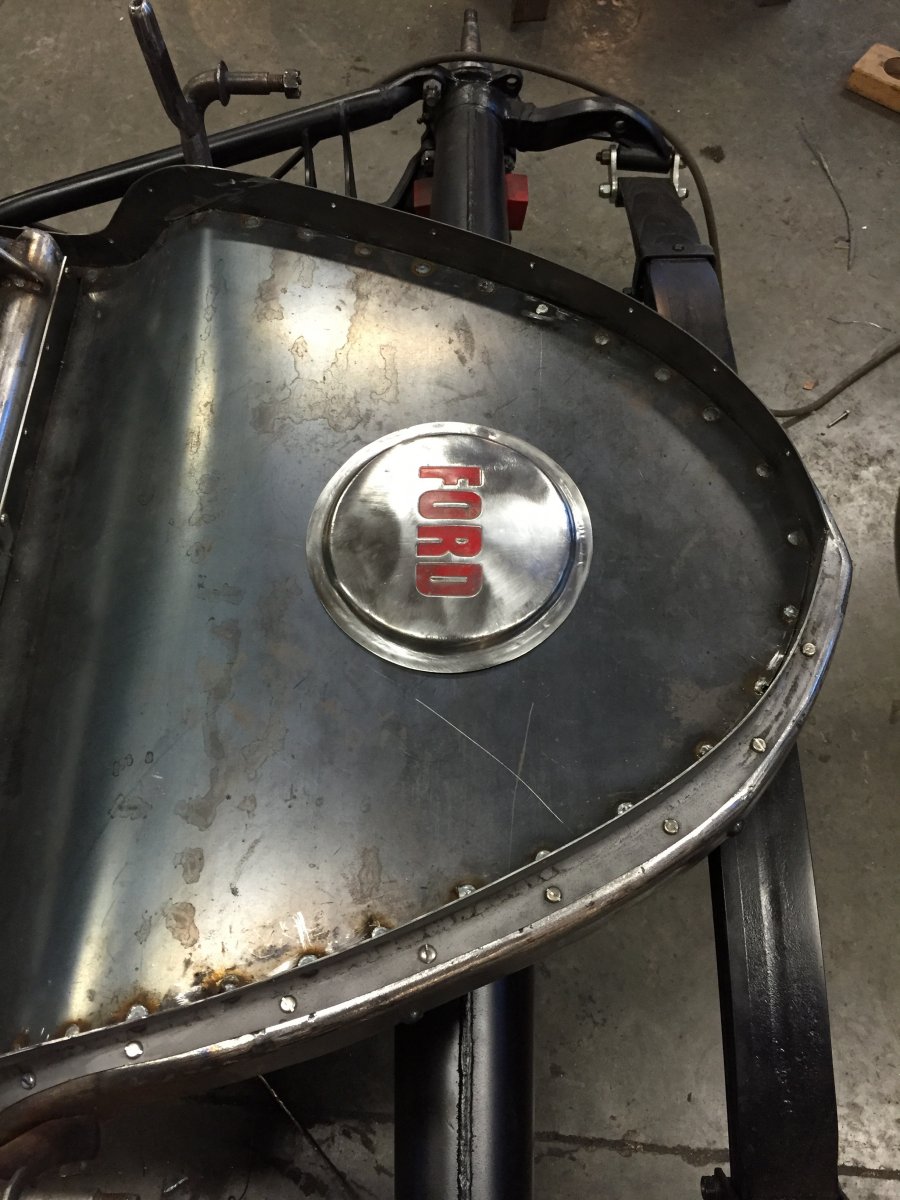

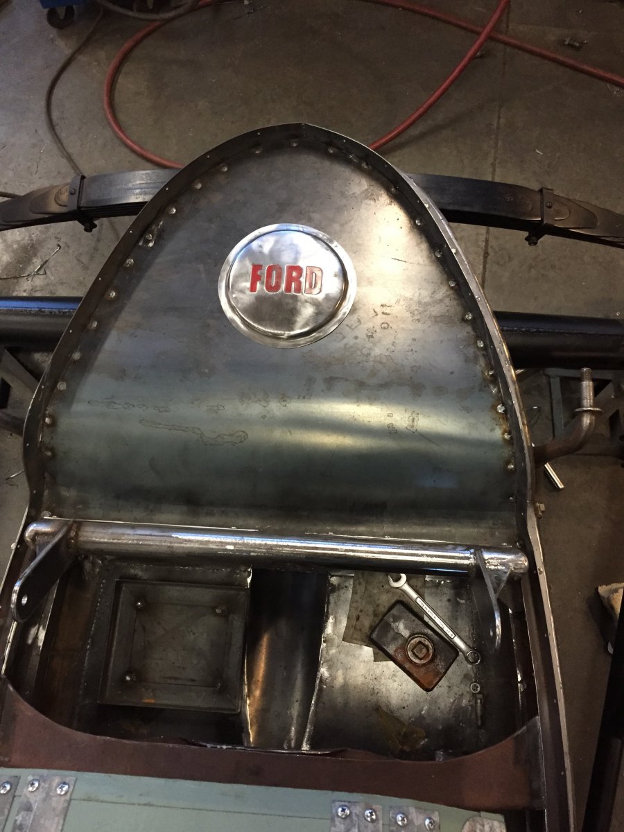

    So I have 3" between the axle tube and the frame and 2-1/2 from the center section to the floor. I had this old ford pickup steel hub cap laying around so I cut the face off of it and it gives me my 1/2". A guy will not even see it being that the gas tank will cover it. image.jpg image.jpg

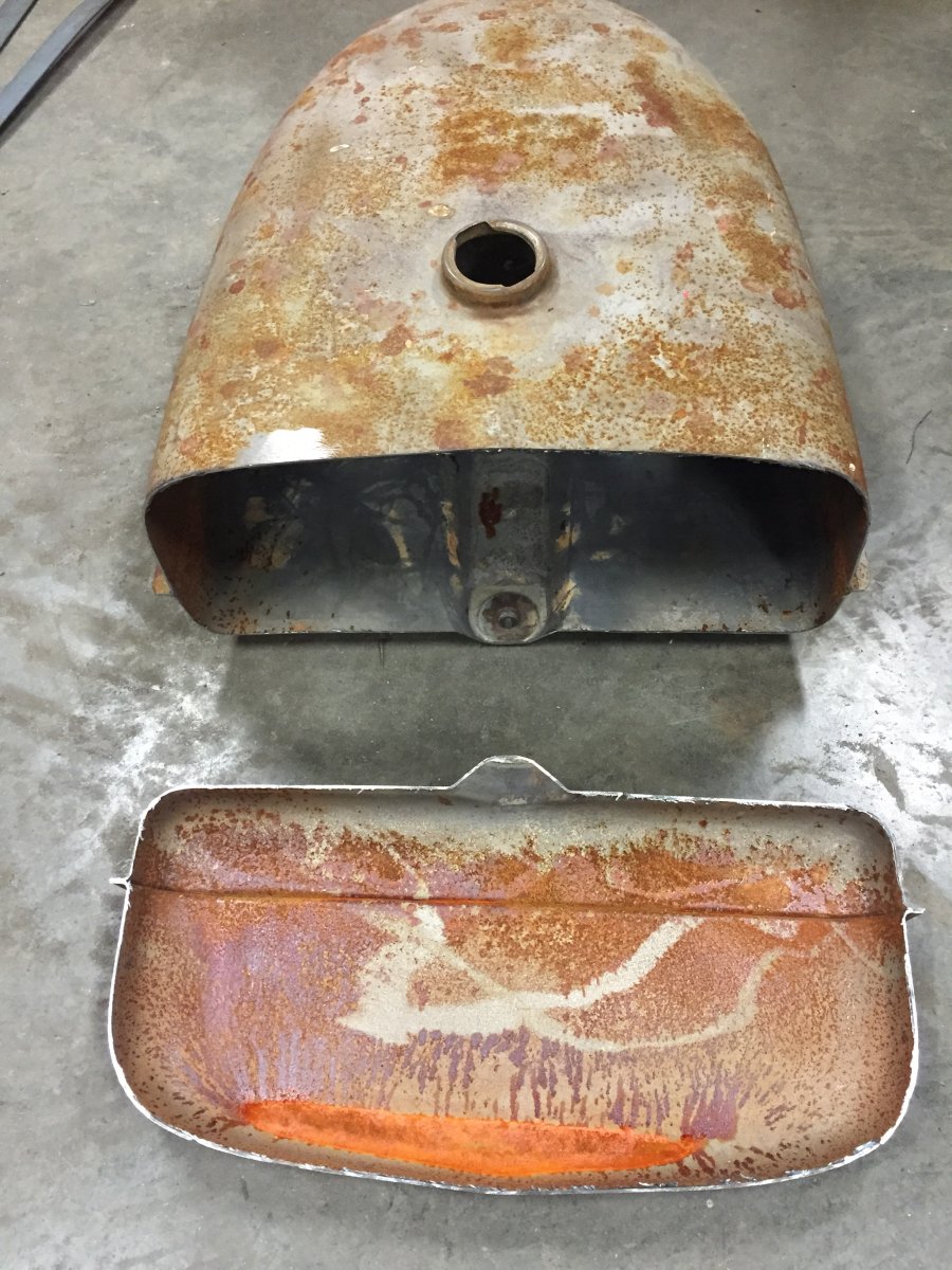

    rusty rocket

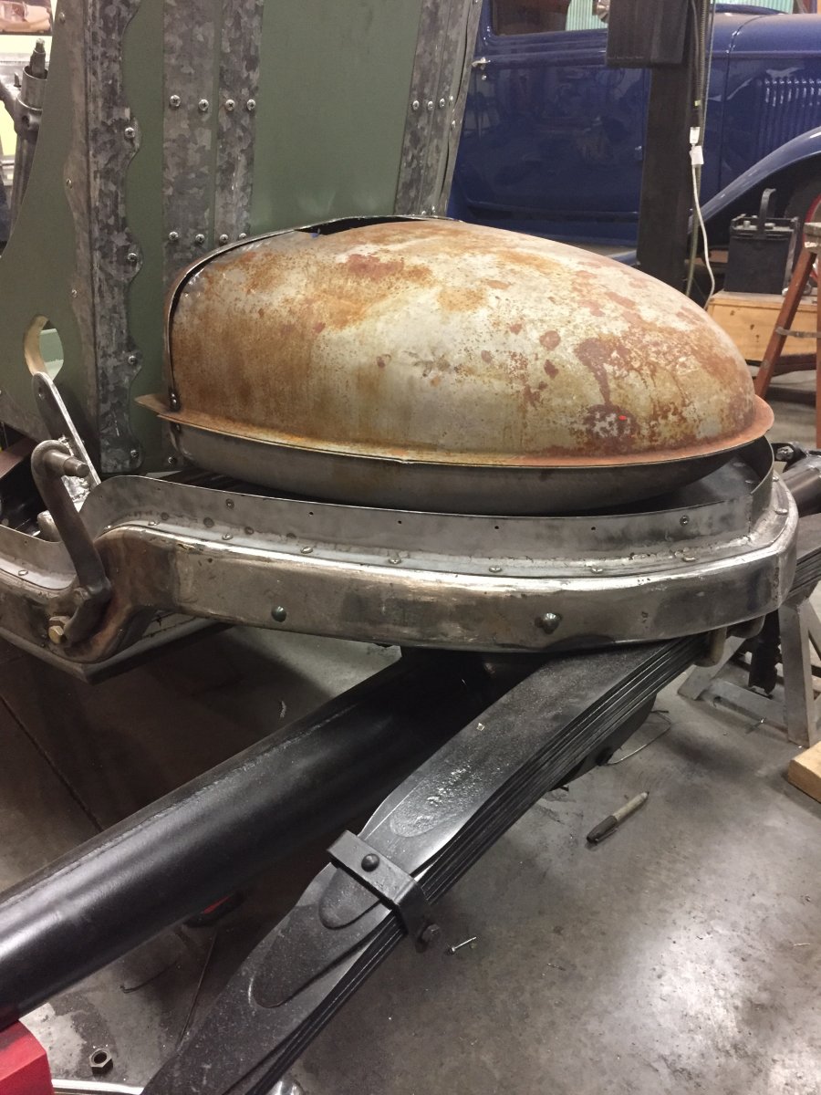

    I scored another farm all tractor gas tank today, for free! I was going to use a wwII airplane oxygen tank for my gas tank but I was going to have to cut the **** out of it to make it fit.
    I would rather cut up an old tractor tank so thats what Im doing now. image.jpg image.jpg image.jpg

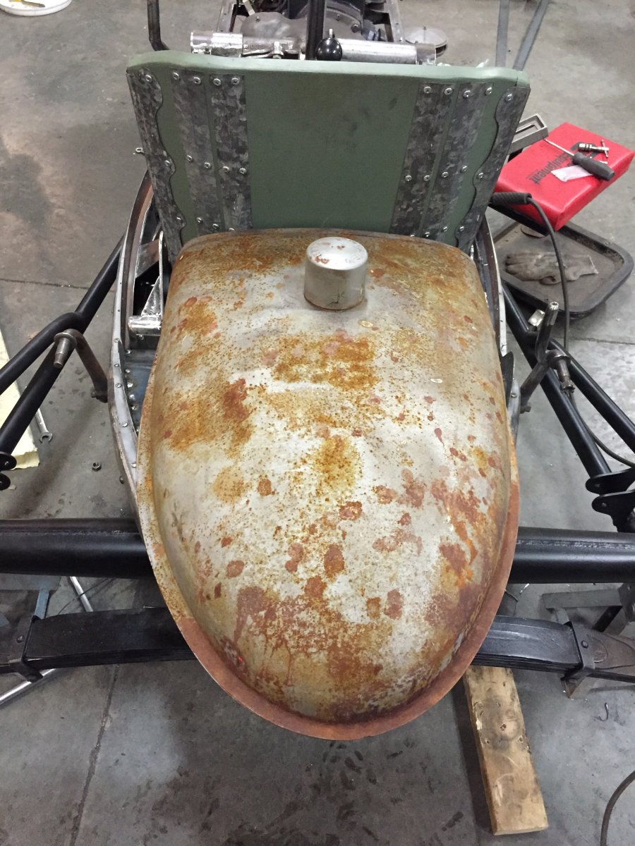

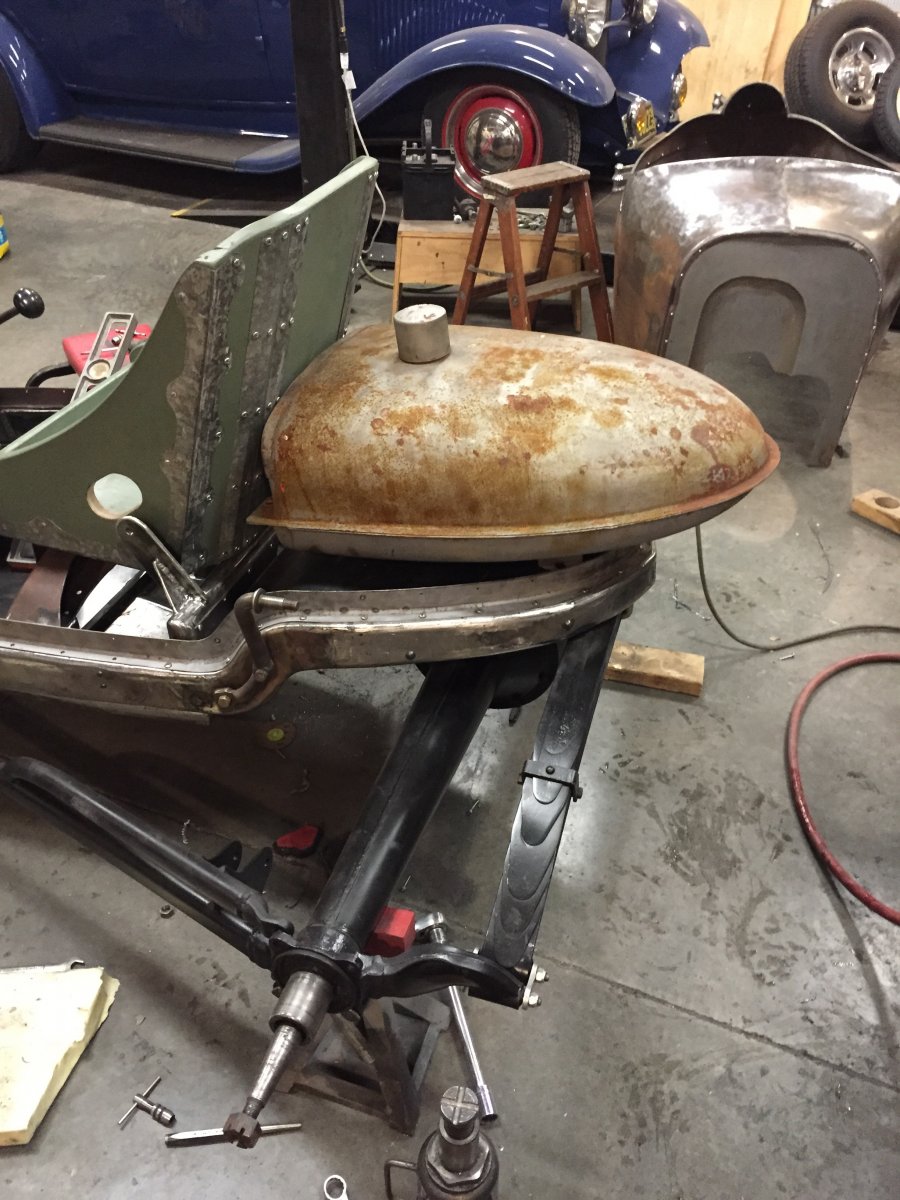

    rusty rocket

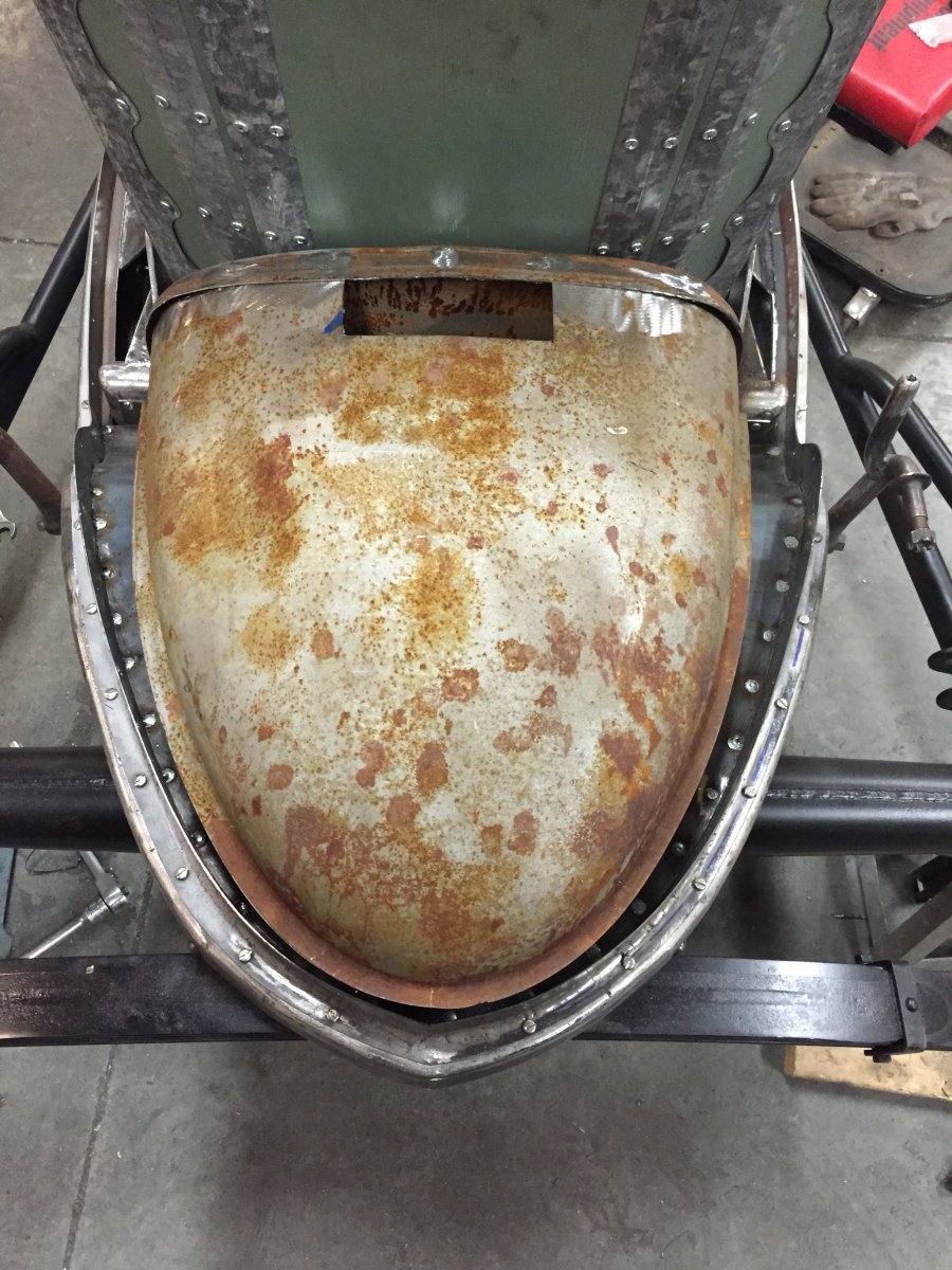

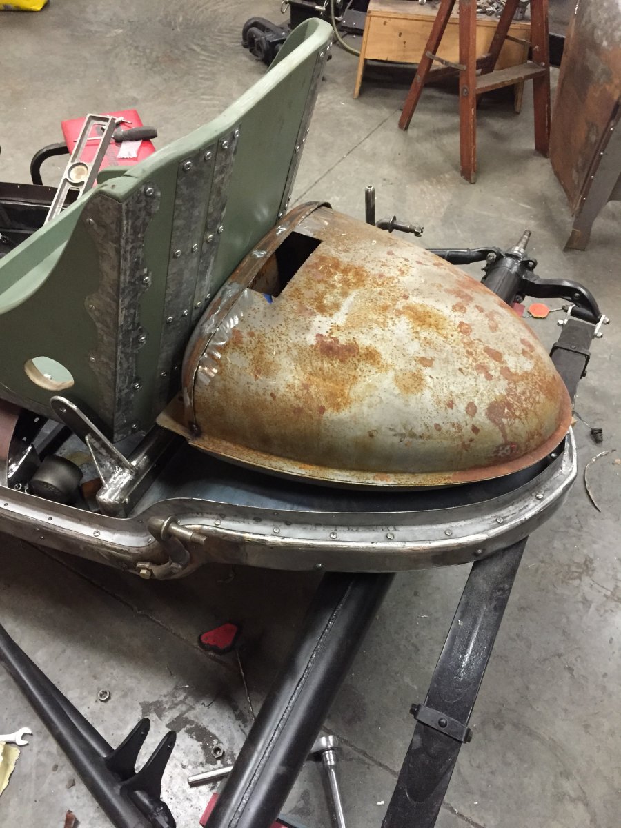

    I have the tank cut down and tacked to test fitment. Lost alot of capacity so i am thinking about a tank on top that will double as a filler neck. Im thinking i can probably pick up and extra gallon or more. image.jpg image.jpg image.jpg
    tb33anda3rd, brEad, Stogy and 2 others like this.

    I'd put a 6 or 8 inch strip in horizontally for more capacity. Put some water in it and see how much it holds. That old 6 will probably go to California on 5 gallons.

    How far do you really think you will drive in one sitting? I'd think a small tank is a good excuse to stretch your legs more often.

    Yes you are correct! But I guess I would like the extra fuel.

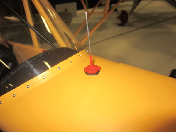

  30. charleyw
    Joined: Aug 5, 2006
    Posts: 2,322
    charleyw
    How about a Cub type? Picture stolen from the net
