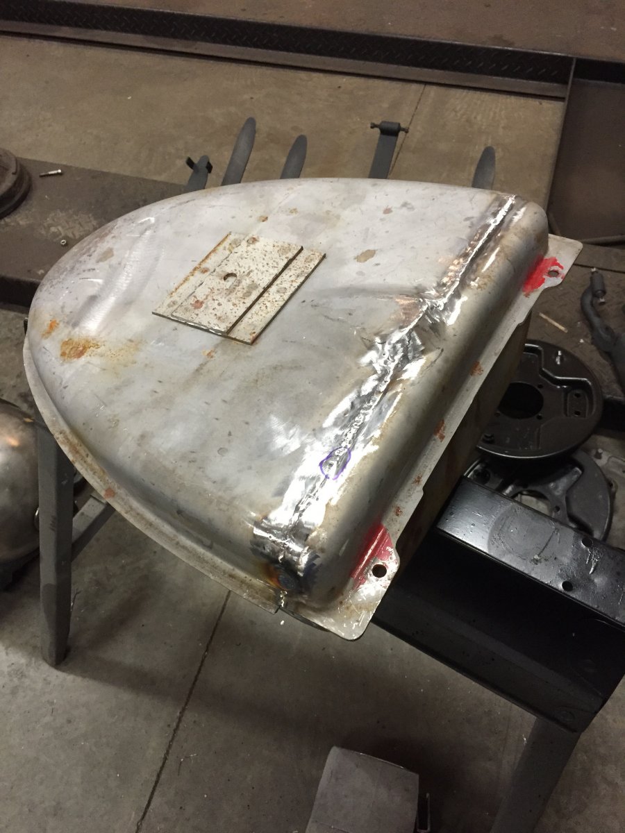

    I have my gas tank Frankinstein welded back together, looks like **** but as long as it doesnt leak I'm happy. I filled it with water and it held 8 gallons I was surprised.I am still going to add a tank/filler on top to hold another gallon plus. image.jpg image.jpg

    That should give you a range of 150 +. But with lack of weight, taller tires and less wind resistance you might get better than the 17 mpg my 230 gets pulling my business coupe around.

    Yeah I was thinking about 15 mpg so with the eight gallons I have now that would get me 120 miles. That should be enough but I'm still going to add the top tank/filler.

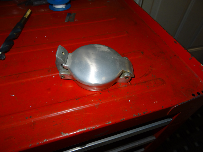

  5. roseville carl
    Joined: Dec 29, 2008
    Posts: 5,213
    roseville carl

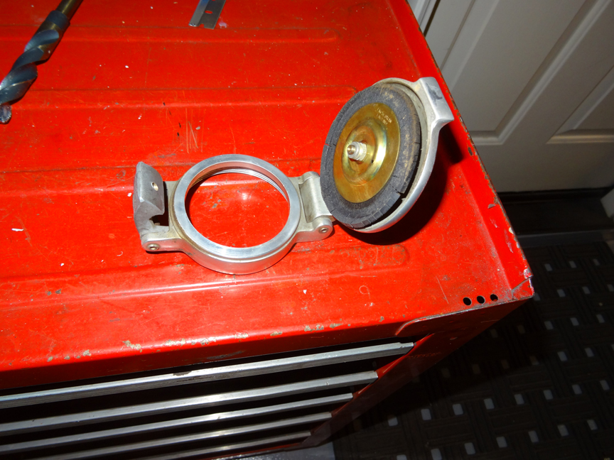

    Wow how did I miss this thread, great job!!! what are you gonna do for a gas cap??? I have this ifn you are interested its off my Moon Tank and not NHRA approved (had to replace it.) anyway a great job so far...........

  6. rusty rocket
    Joined: Oct 30, 2011
    Posts: 5,262
    rusty rocket
    Thanks for the encouragement. I have the stock international farm all gas cap that I will reuse. This is a low buck use what ya have build!:p

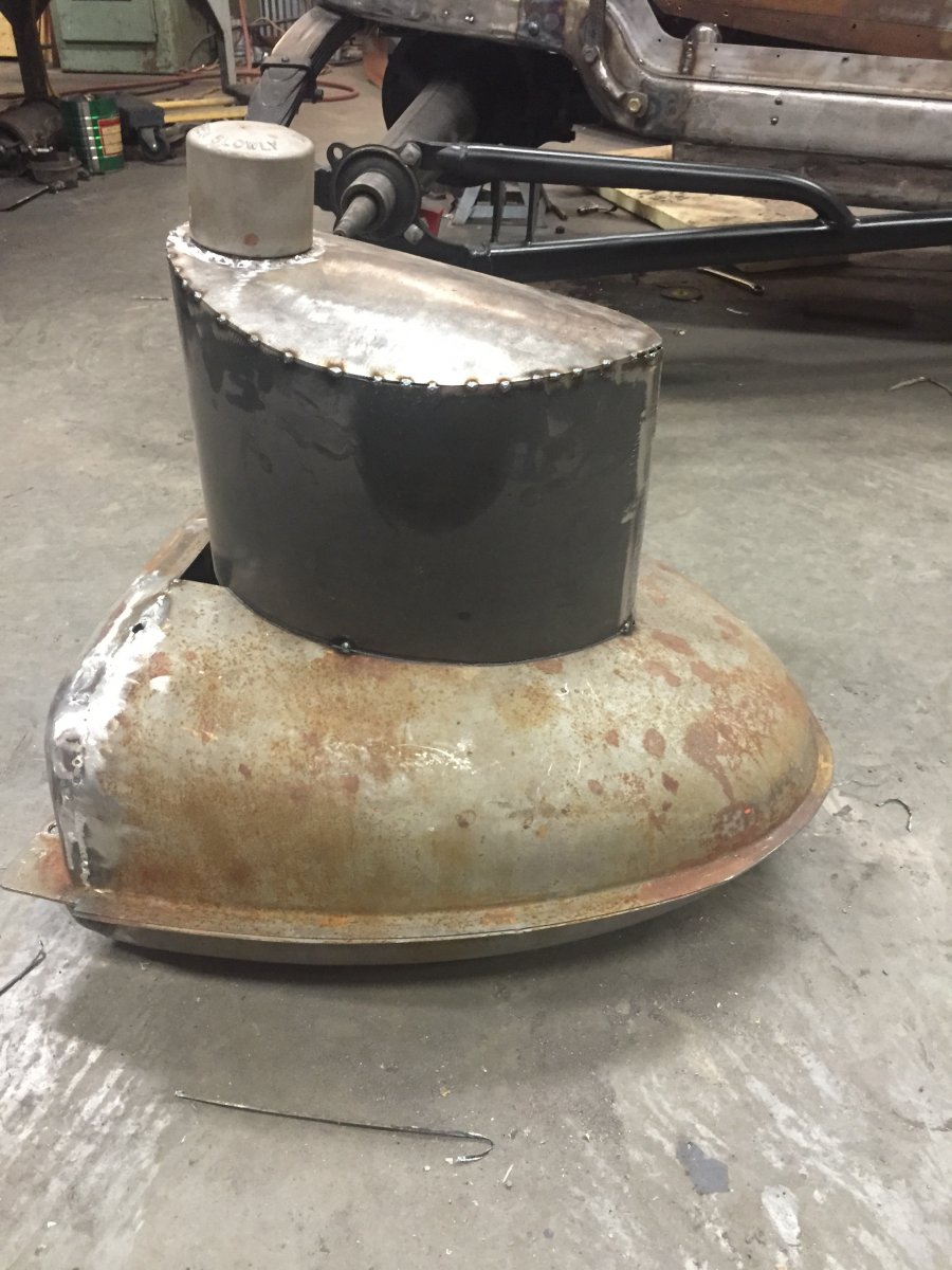

  7. rusty rocket
    Posts: 5,262
    rusty rocket

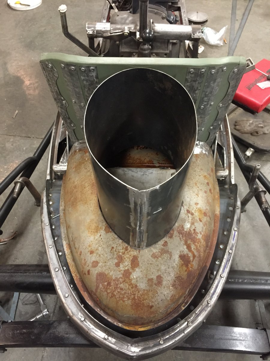

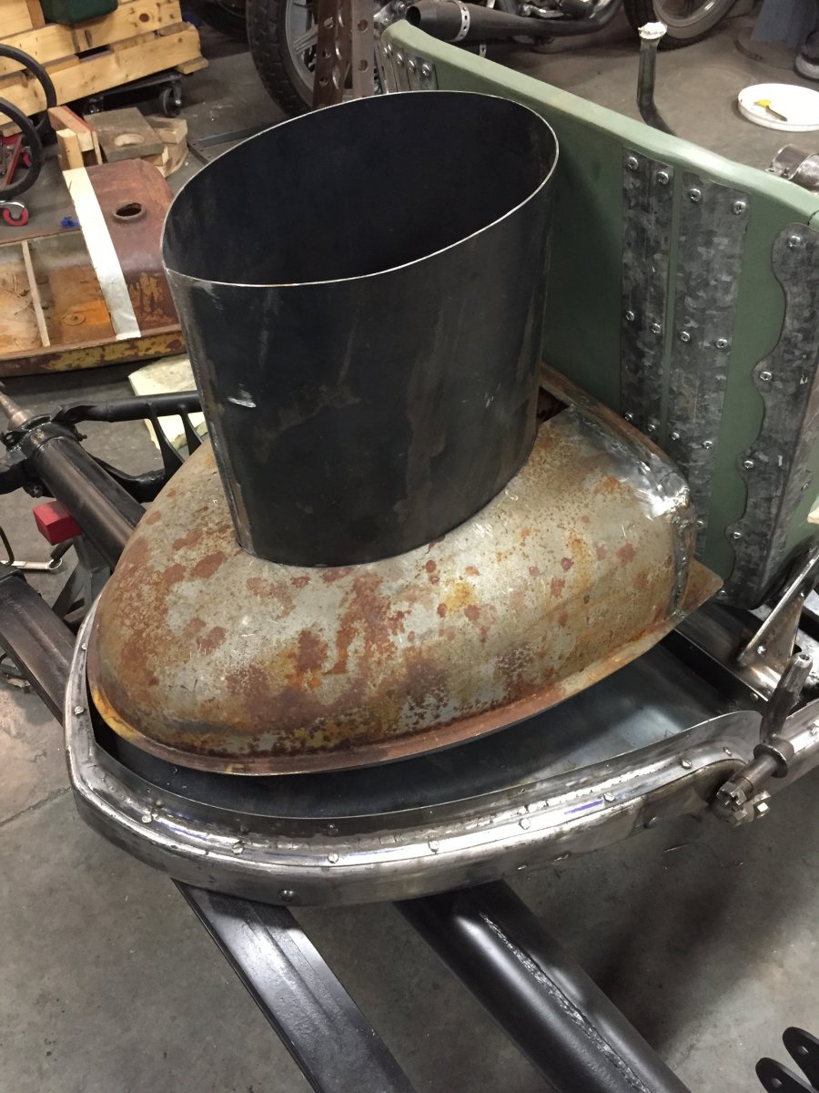

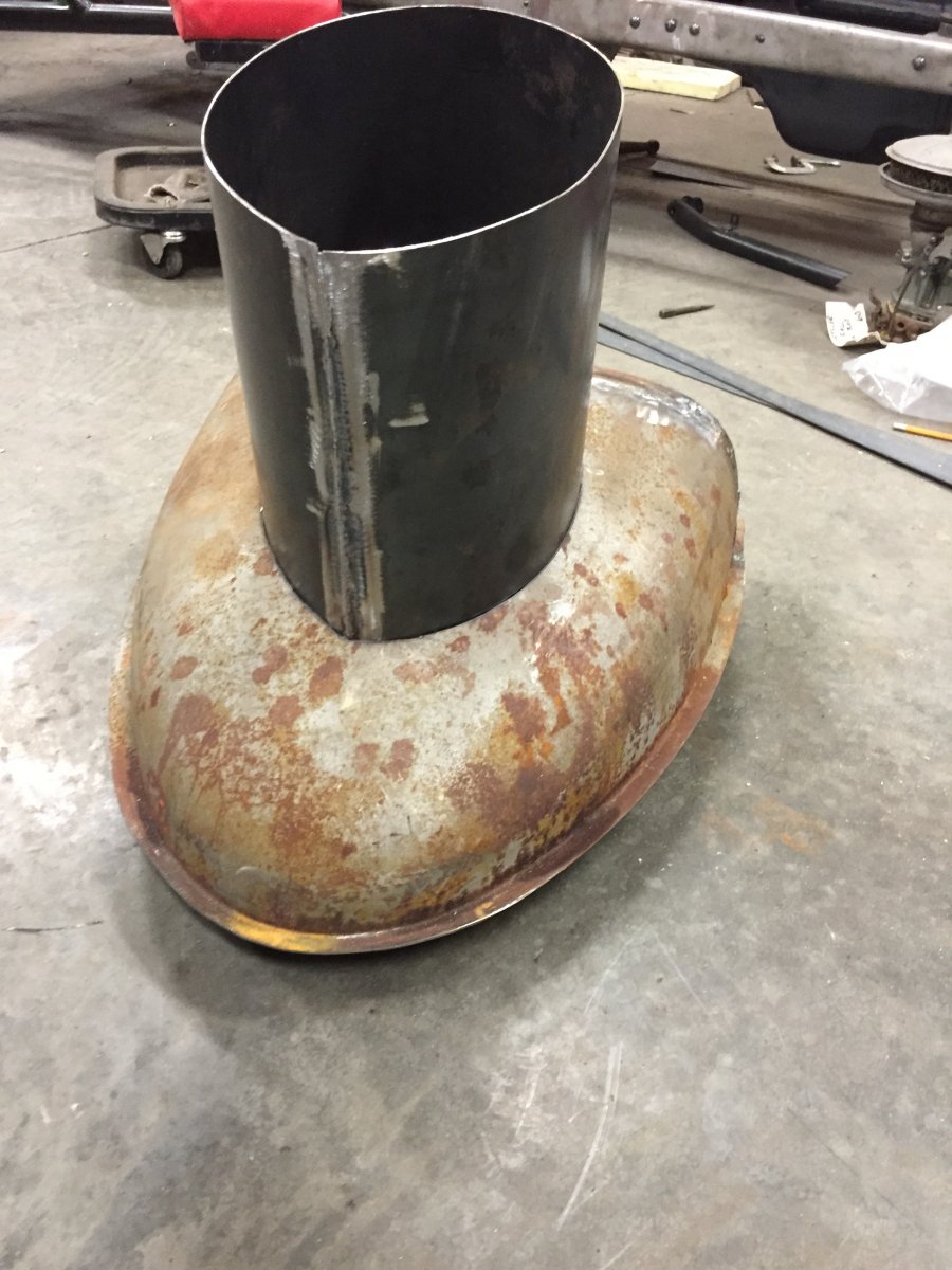

    image.jpg image.jpg image.jpg I rolled out a top tank/fuel filler tonight. Looks like a submarine now! This should give me an extra few gallons .

  8. roseville carl
    Posts: 5,213
    roseville carl
    ok but it was yours for free if you use it and not as a wall hanger...............
  9. brad2v
    Joined: Jun 29, 2009
    Posts: 1,659
    brad2v
    Wow, I was thinking a cheater filler neck ala the Donahue/Penske Sunoco Camaro, not a whole other tank on top, haha. Yup, that should do it.

    I think so! I know it's over kill but that's the way I roll!:p Ha ha!
    It just needs a periscope now!

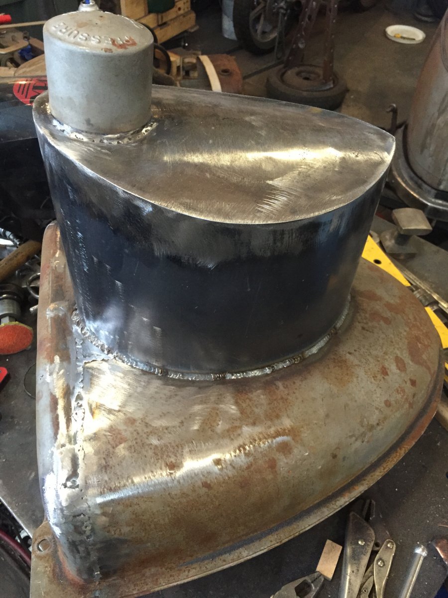

  20. rusty rocket
    Posts: 5,262
    rusty rocket
    Havent had time to work on much but I did get my top tank welded to the bottom and the lid is welded and ground. I will get it all welded and take it to my local radiator shop to test for leaks. image.jpg I picked up some farm-all red paint so it looks like it came off a tractor.

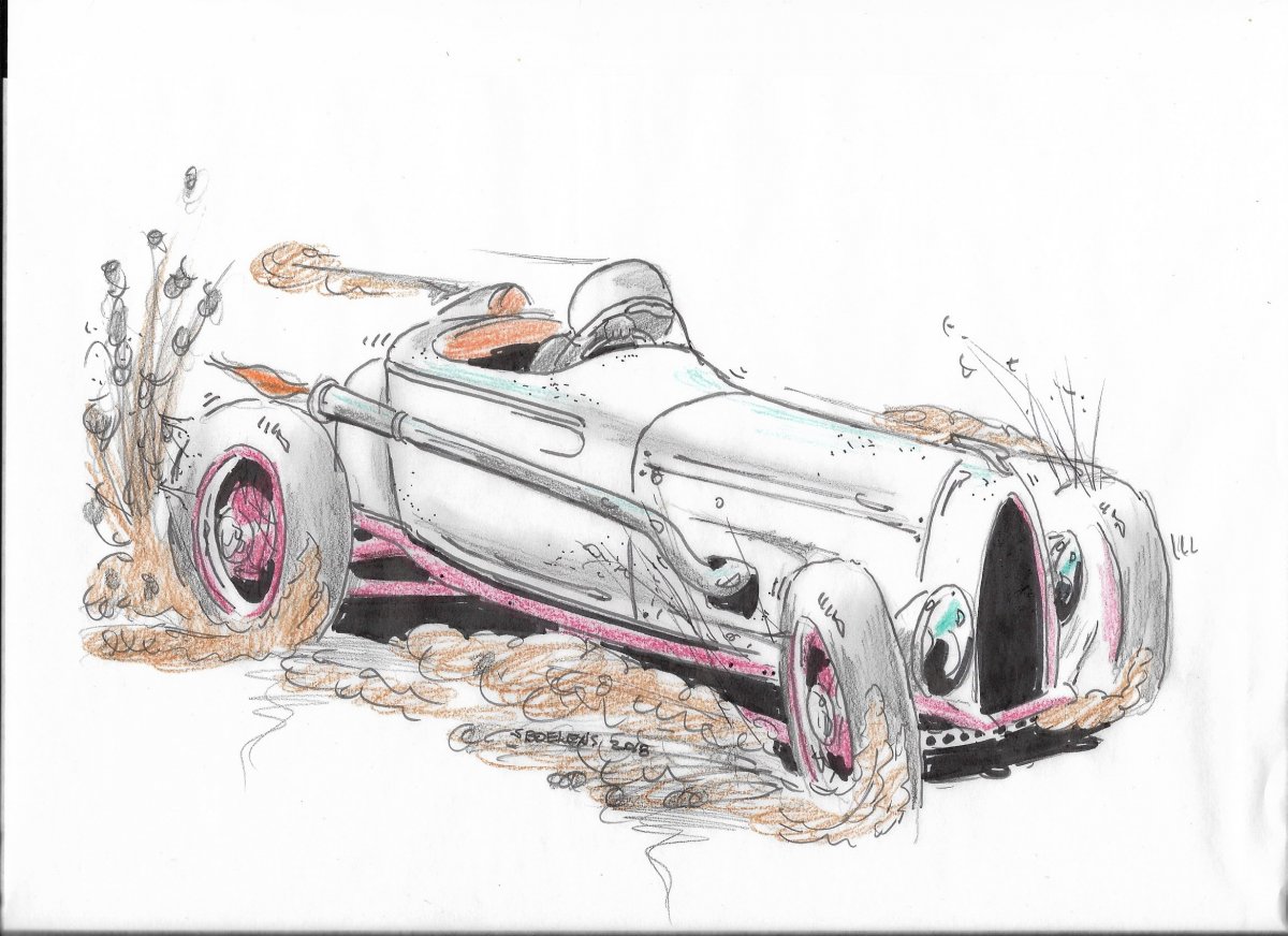

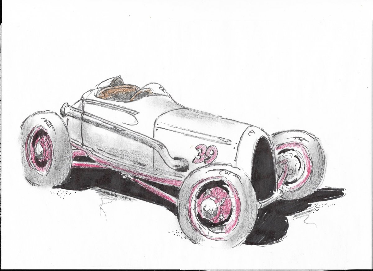

  23. rusty1
    Joined: Nov 25, 2004
    Posts: 13,067
    rusty1
    ...I was too lazy to go back thru the whole thread to find those pics...

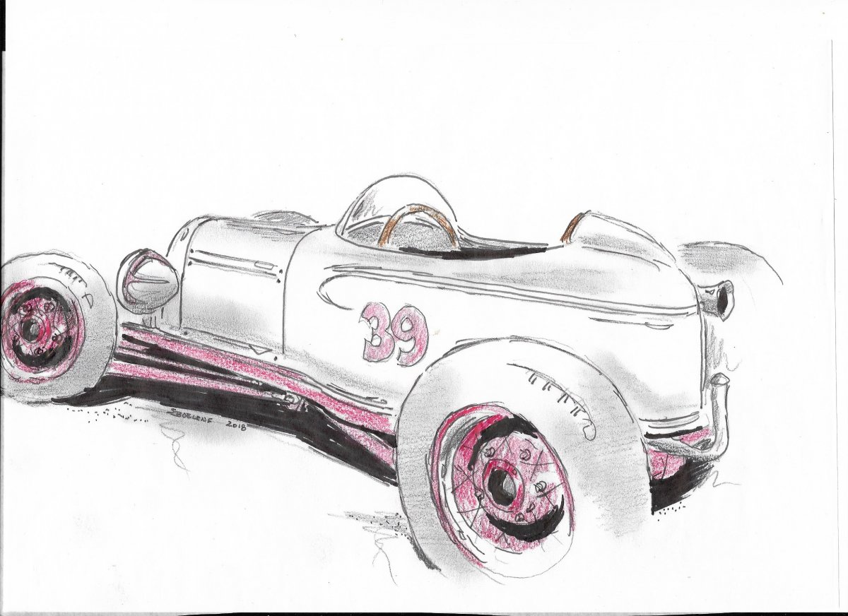

    ...here's a few quik sketches of yer rig...you'll be out throwin dirt before you know it!
    single seat roadster.jpg single seat roadster 004.jpg single seat roadster 005.jpg

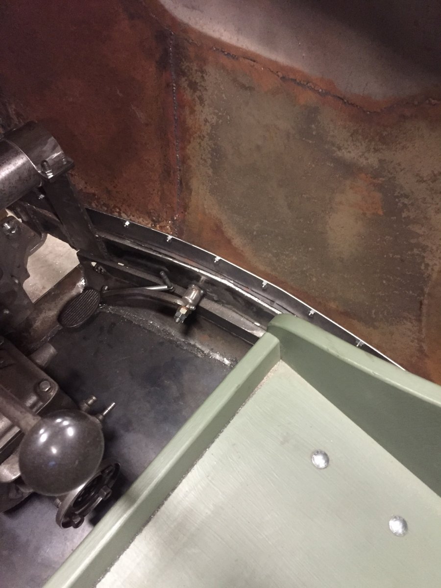

  26. rusty rocket
    Posts: 5,262
    rusty rocket

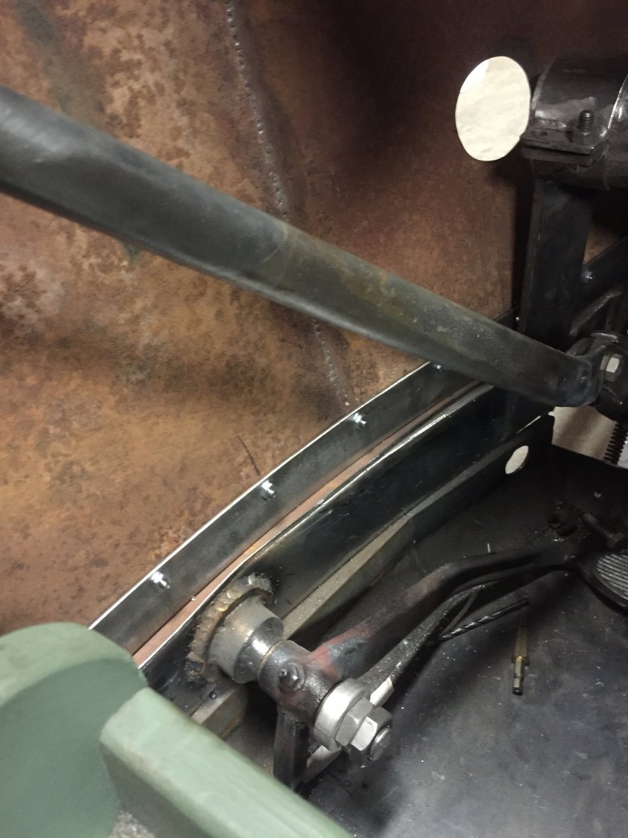

    image.jpg image.jpg image.jpg Doesnt look like much but this was an all afternoon project. I built an inside subrail that will sandwich the body tin. Cutting, fitting, bending, drilling and bolting.

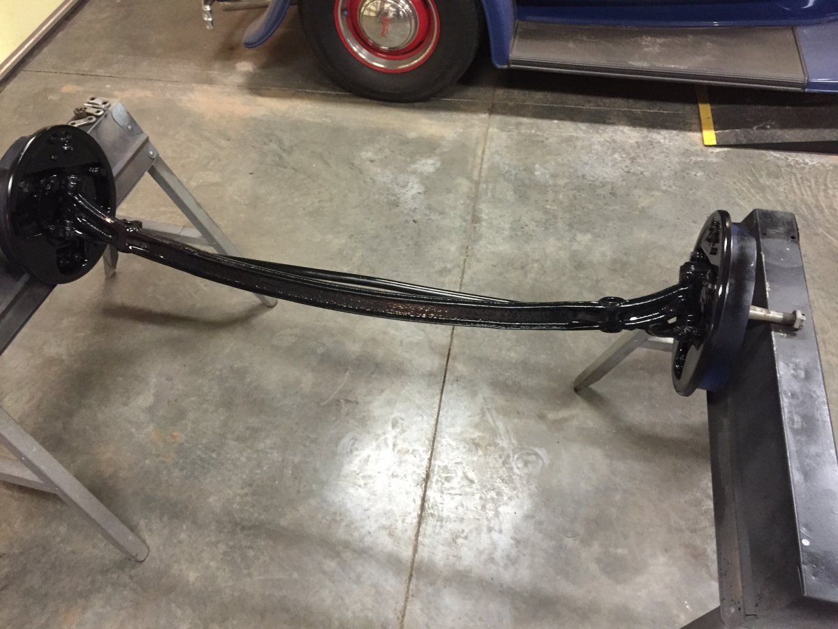

    I have the front wishbones, spring and front end painted. Time to let it cure and then bolt it all back together. image.jpg
