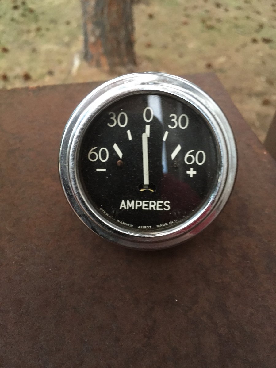

    Got this kool old stewart warner amp gauge today for a local ole hotroder (for free) I know its obsolete but im going to use it! image.jpg

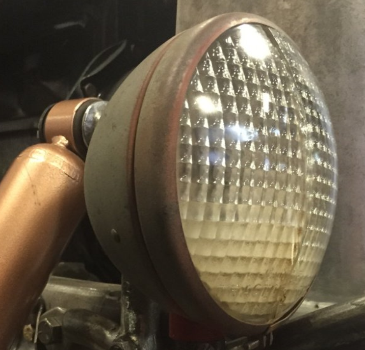

  6. I like what you have going on with the Nerf bars. Any thought of tying the shock mounts and Nerf bars into one ***embly? a short little piece between the 2 would make it look a little more thought out, may even consider eliminating the rear mounting bolt on the shock mount. Just a thought!
  7. those Farmall lights are nice and tidy. Very clean look. One small problem, the lenses for the Farmall lights are designed to illuminate about 15-20 feet in front of your, you will not have a lot of illumination very far in front of you. Automotive lights are designed to create beams of light, so you can see where you are GOING. Implementation lights are designed to help you see where you ARE!

    I think you did a great job on thinking out the placement of the lights along with the nerf bar. It looks great and nothing looks out of place or commands my attention.
    Hell, the whole car is like that!!!! Great job!

    Not sure if you have this figured out already but on my Minneapolis Moline U tractor backhoe I used sealed beam headlight bulbs from I think a 59 Ford or something that had the smaller size twin headlamps. It lights the night. I think those would fit in the Farmall housings also. Stand out job on this car by the way! You've given me many ideas.

    I don't really plan on driving this thing at night so the lights are mainly there so mr. Po po doesn't h***le me. I can get sealed beams thru Steiner tractor but I'm really digging the original lenses.
