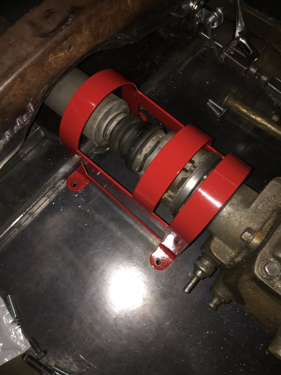

    Have my driveshaft foot gaurd built. Threw some farm-all red paint on it, so it says stay away from spinning parts! image.jpg Probably premature on the paint , it will be all chipped up before I get this turd pile on the road.

  8. Stogy
    Joined: Feb 10, 2007
    Posts: 27,207
    Stogy
    No Jackets or anything with draw-strings allowed...;)
    kiwijeff and brEad like this.

    Nice job on the guard. Why not bend some 18 or 20 gauge over it then you know nothing can get caught in there
  12. rusty rocket
    Joined: Oct 30, 2011
    Posts: 5,254
    rusty rocket
    Yes that would be the thing to do. I sort of dig the scare factor though.
