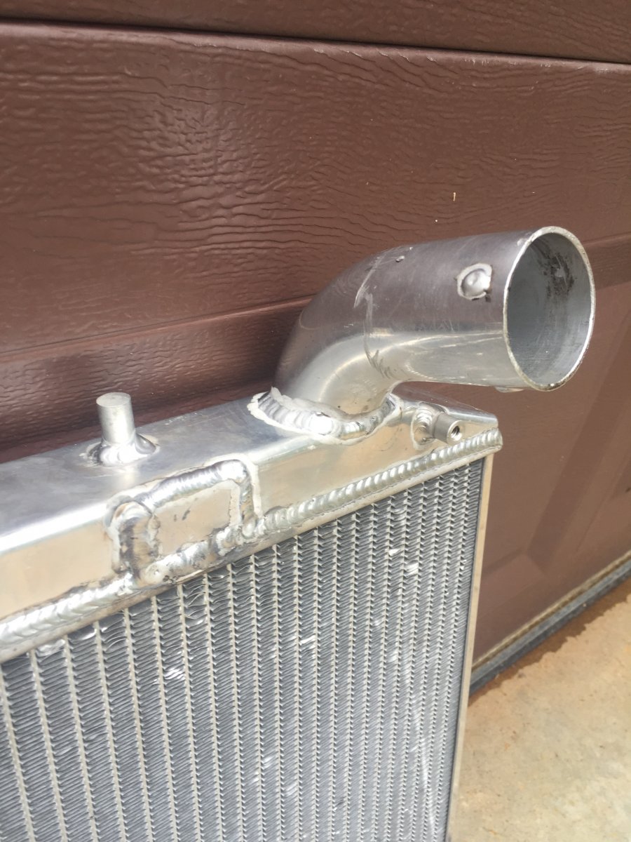

    Nice job, much better lookin' 4 sure. Happy 4th Rocket!
  2. Blues4U
    Joined: Oct 1, 2015
    Posts: 8,068
    Blues4U
    from So Cal

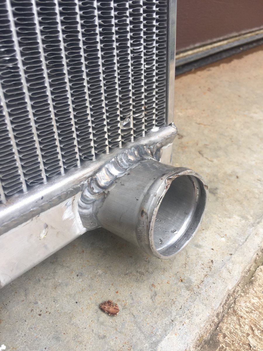

    I did the same thing with the aluminum radiator in my A pickup, black is much better than shiny aluminum.

    That’s some nice aluminum work. I have a question on the radiator.. since you moved the upper neck above the filler are you going to put a fill cap in the upper hose so you don’t get an air pocket?
    Stogy likes this.
  5. rusty rocket
    Joined: Oct 30, 2011
    Posts: 5,262
    rusty rocket
    Yeah I think I will have to.
    Stogy likes this.
  6. Shadow Creek
    Joined: May 14, 2014
    Posts: 306
    Shadow Creek
    I figured it was probably something you had already thought of but I asked anyways. This build is so cool, I always look forward to the updates. Keep up the good work.

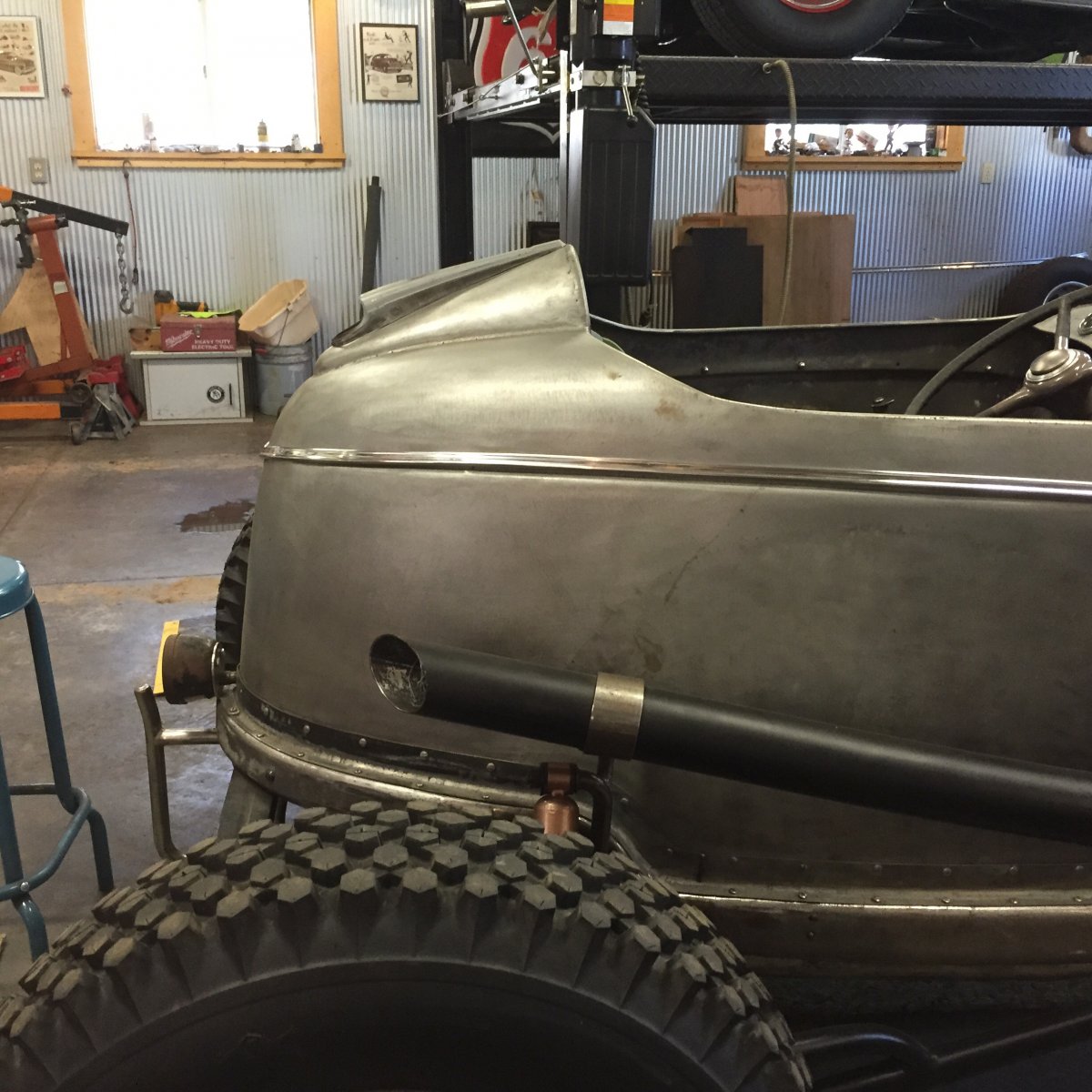

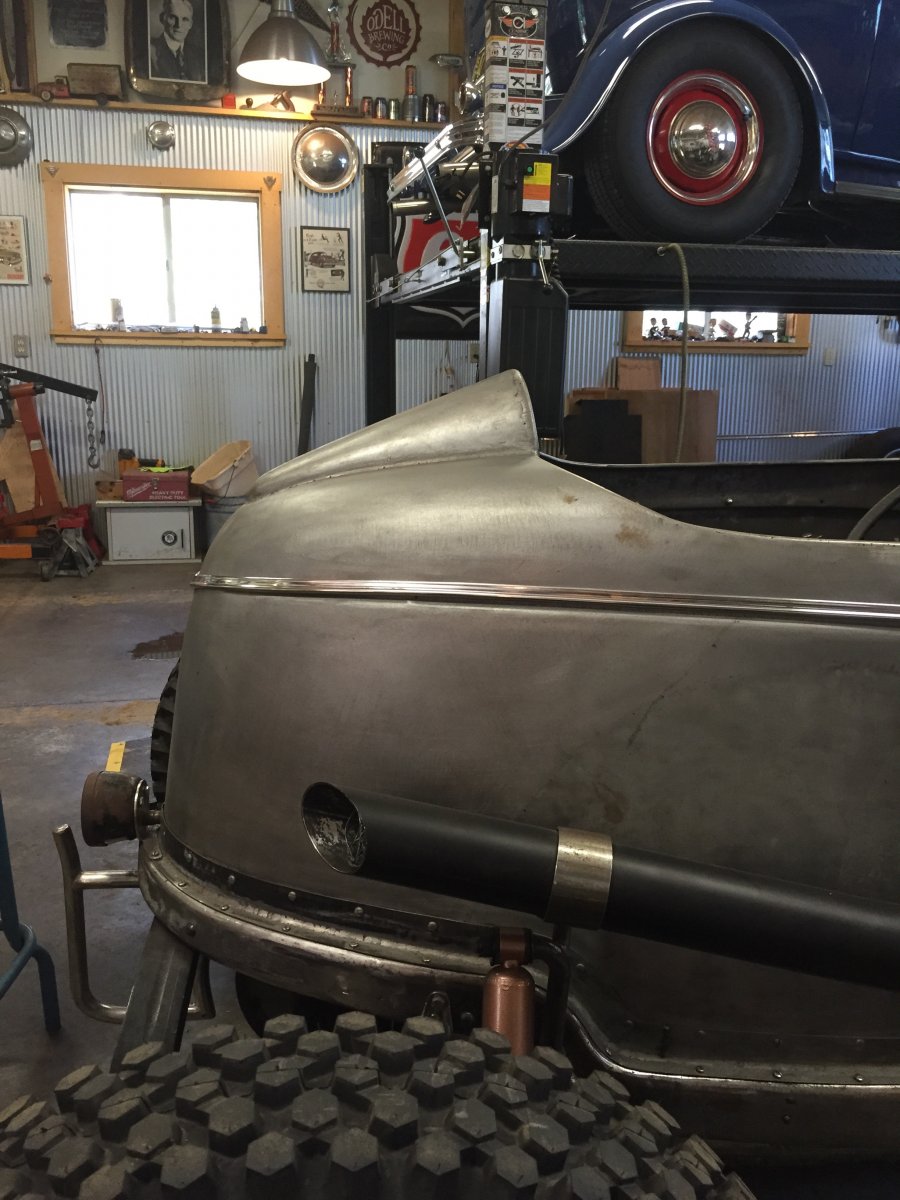

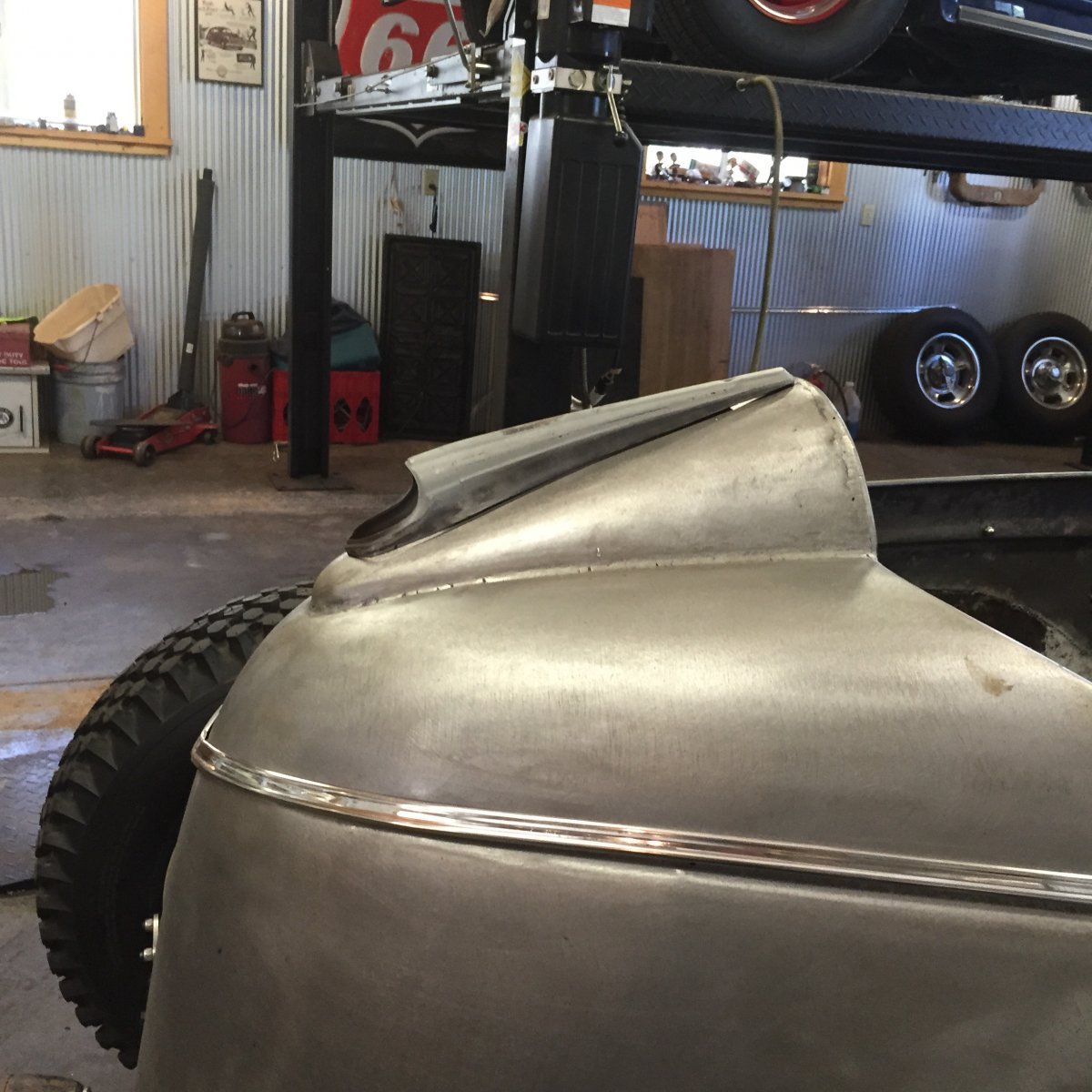

    So awhile back i was tinkering around on a light on the headrest part of the car. The head rest was made from a 46 chevy p.u. Headlight that I cut down. I had an idea to take the parking light section a chunk out of it and turn it around so it faces the back of the car. I have a l.e.d light/ brake that i can hide inside so it gets the light a bit higher so folks can see it.
    Whats you guys thoughts on looks? To me it sort of takes away the drop of the headrest but it also has a funky art deco look. image.jpg image.jpg image.jpg image.jpg

    What if you were to mold just the lens part into the rear tip of the headrest?
  10. rusty rocket
    Posts: 5,262
    rusty rocket
    All the wrong contours to do that.

    Me Likey...:D...Your a crafty Man @rusty rocket...now can you get that lens Red?
  12. rusty rocket
    Posts: 5,262
    rusty rocket
    No but i have some translucent red paint I can airbrush on the inside of the lens.

    I like it with the tail light. Looks good and serves a purpose.

    I like the tail light, also. After seeing it with the tail light it looks a little bare without it. I love this build.

    I definitely like it "with". And a sneaky CHMSL is a really bright idea...pun intended!

    How about combining one of the marker lights you tried earlier with the fender light you have.

    My .02, I like it.
  22. atch
    Joined: Sep 3, 2002
    Posts: 6,422
    atch
    Well; I guess I'm the odd ball here but I like it better without. But opinions are like...

    I think it looks cleaner without, but I love the cleverness of adding the light there.

    I like the look with out also, but I'm leaning towards putting it on more on the safety side.

    Put a bright s.o.b. of an led in the lower light and you'll be seen after dark just as well as any motorcycle. Haha, I doubt you'll have any problems getting noticed during the daylight hours.

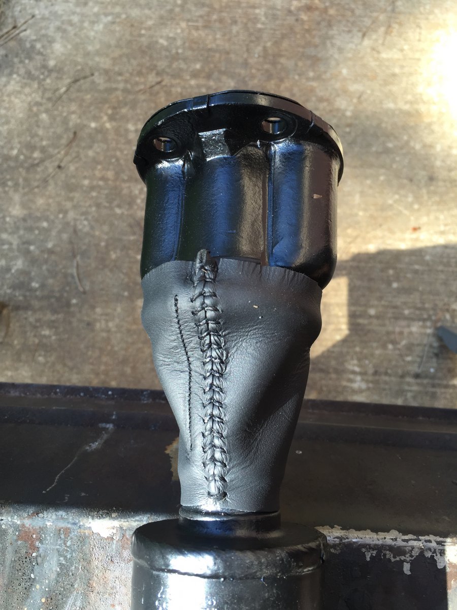

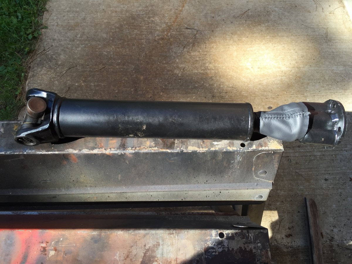

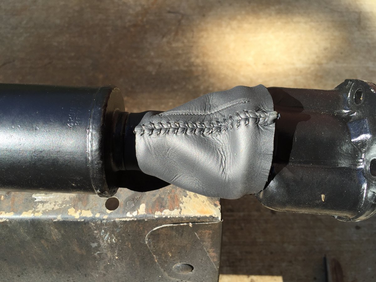

    Just got my drive shaft back from a frind that is a leather worker. He made me a kool *** trunnion joint boot to keep the grease in. image.jpg image.jpg image.jpg

    Double needle baseball s***ch??

    Oh yes! And it has a small leather flap inside,under the s***ch that keeps the grease from the baseball s***ch.
