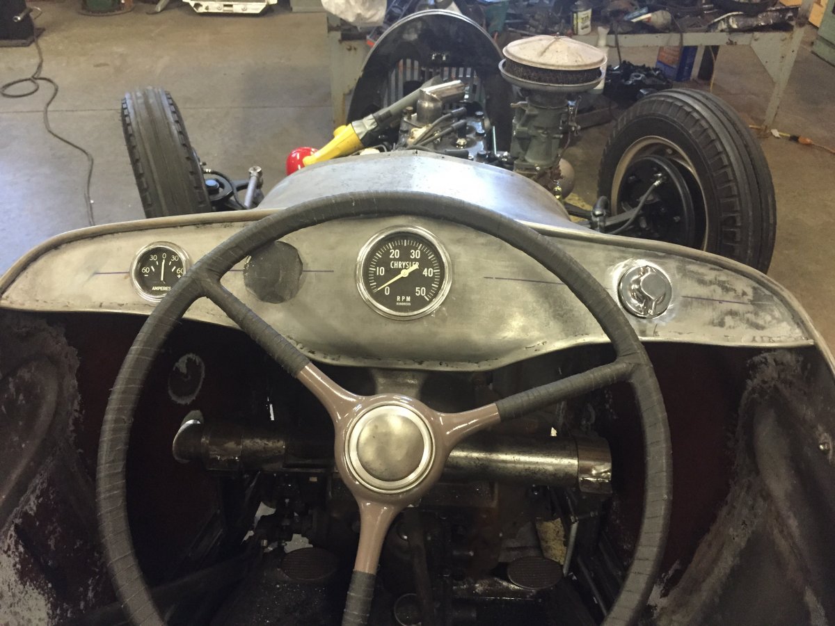

    rusty rocket
    One more gauge found and installed (thanks donald turpin here on the hamb)
    All three of my gauges are stewart warner built but no sw logo, I just need to find a matching h20 temp gauge. With out the logo. If anyone out there has one that doesnt have the logo I would take it off your hands. image.jpg image.jpg

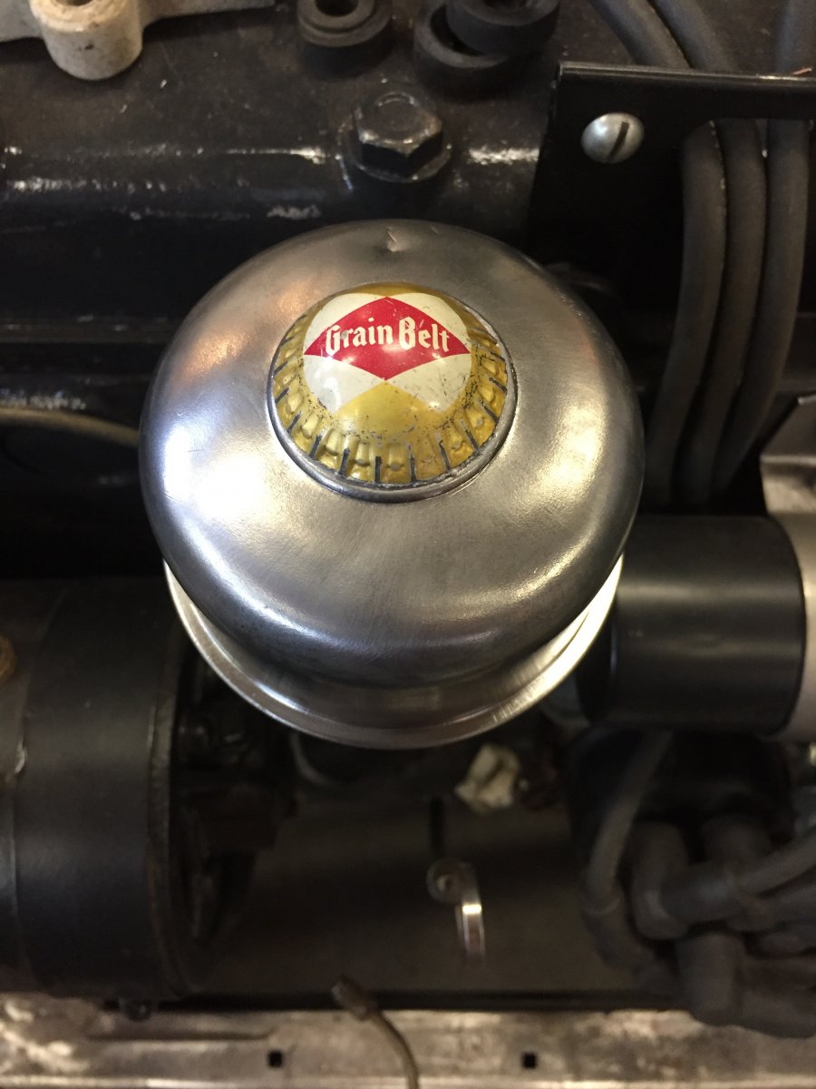

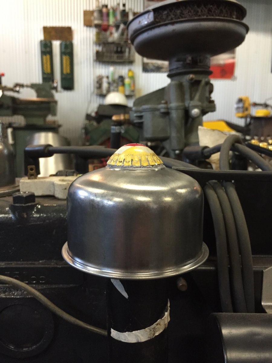

    image.jpg image.jpg I went to a swap meet sunday and the only thing i found was an oil cap. My motor didnt have one on it so the fill tube has been taped up during the build. After cleaning up the cap it had four or five dents right in the center. I cusomized it with a 1950s grainbelt beer cap and some two part epoxy. I hope its not to r@t r&ddy!

    Screw the guys that worry about ratty, if it looks good to you (and me, haha) then it's just right.
    Some of the stuff on those rat rods, although often poorly executed, is pretty darned ingenious and worth some pondering.

    Looks a little like a Von Dutch Eyeball...:D

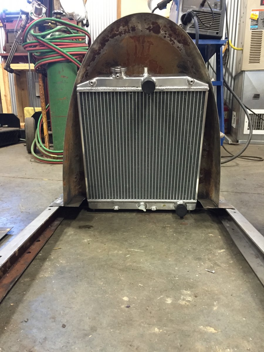

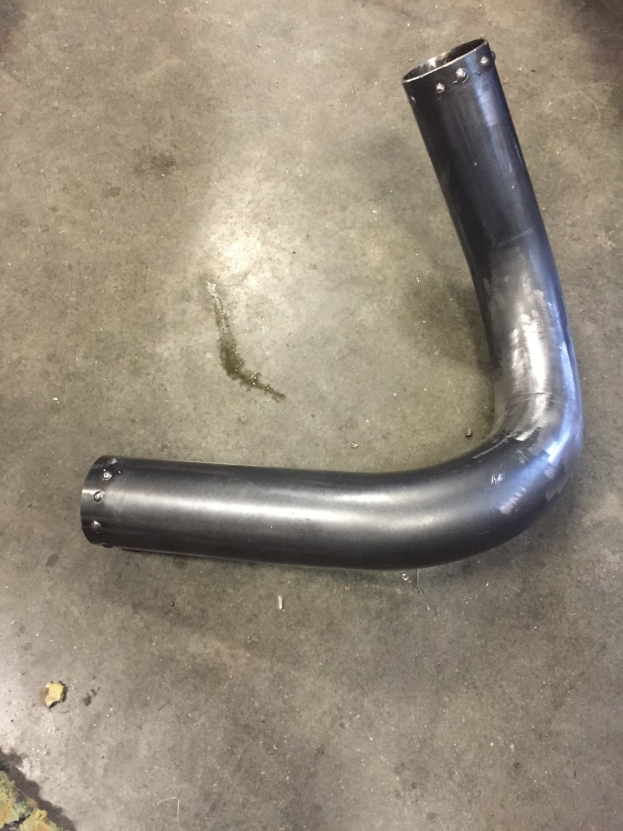

    I figured i would get radiator hoses in line so I made up a chicken wire and masking tape model I then took that to my local parts store and after a few hours of matching hoses to my model nothing was working so now its plan B build a metal one and put rubber ends on it. Probably look better anyway! image.jpg image.jpg image.jpg image.jpg

    Ah plan b was successful. Fould a tight rubber 90* bend to the radiator and a straight piece to the pump.Welded some dots on the metal pipe for the hose clame to seat against. image.jpg image.jpg image.jpg

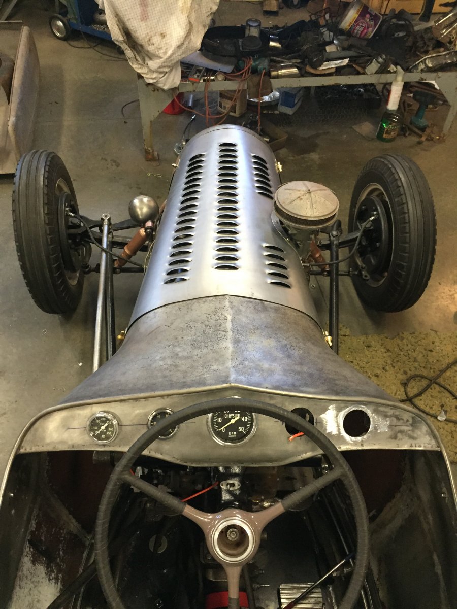

    Been thinking about punching some louvers in the hood for awhile. A buddy of mine has a louver press so I laid out a few lines and we poked a few holes today. image.jpg image.jpg image.jpg image.jpg image.jpg

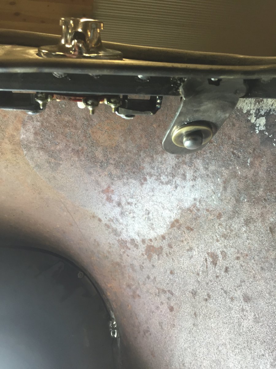

    So...question, is that paint on the inside of the hood or a layer of oil to aid in punching?
    If paint was it to aid in layout?

    Yep, I sprayed a coat of paint so I could scribe a layout line. A scribed line is thinner and more accurate than a sharpie line.
