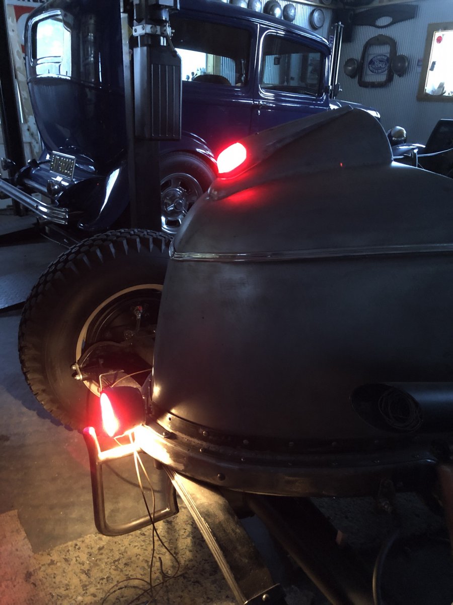

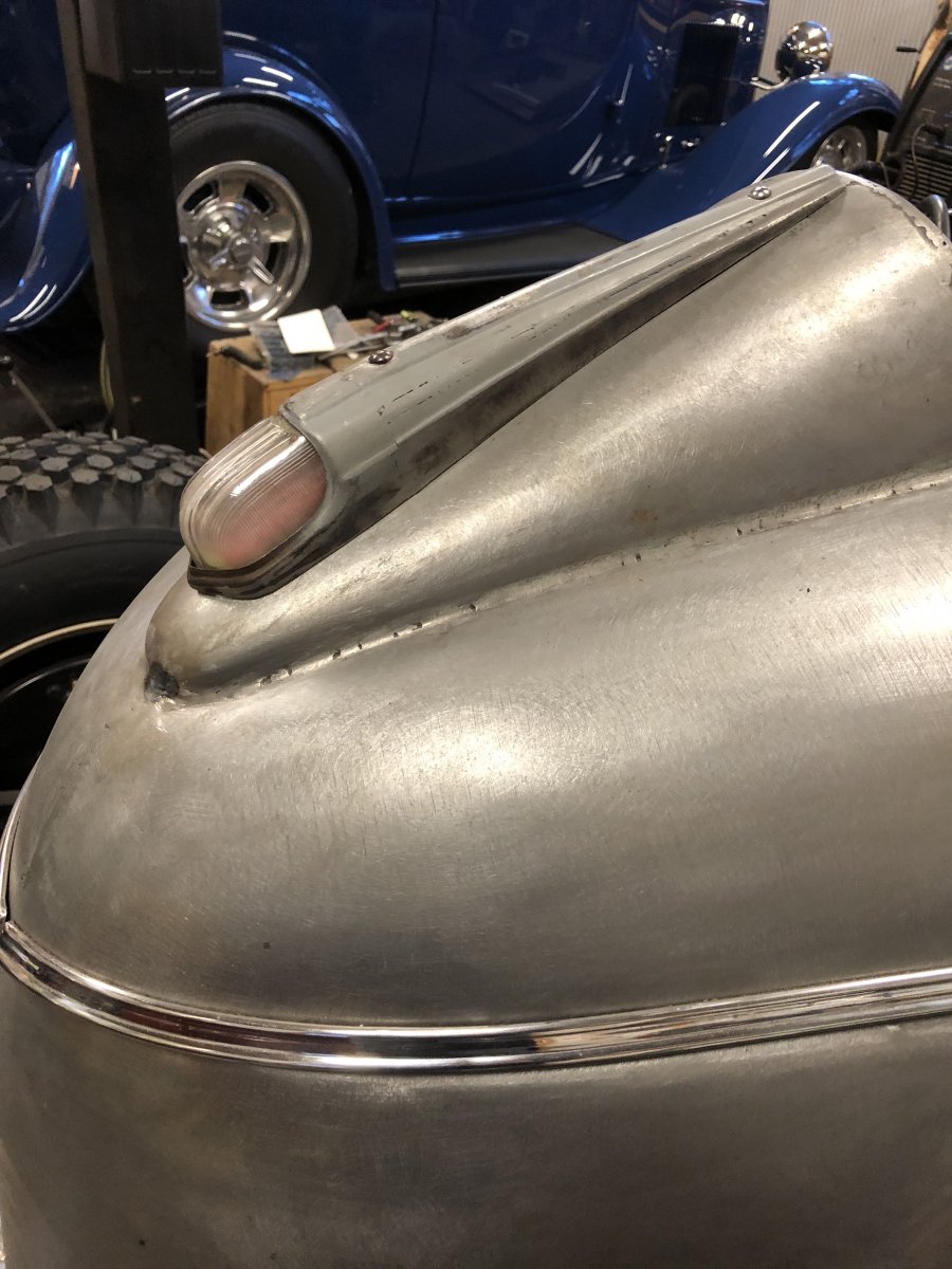

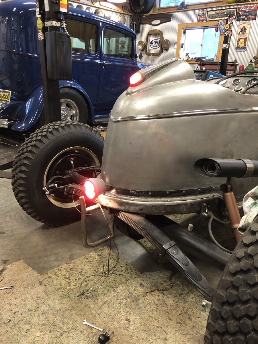

    Working in small baby steps. Today after work I got my brake light wired. I had a small l.e.d. light left over from a motorcycle build so I thought I would hide it under the clear parking lens. I know led’s aren’t traditional but maybe I won’t get run over. 009847BC-EC5B-491A-9313-17C3B79CF4C8.jpeg 95FC011F-74C4-4624-A9BC-6D9A8E6D2921.jpeg ECFB37CE-960B-42A9-B220-4FC028DFF8A9.jpeg

    :rolleyes:...Well that is just beyond Spiffy, Rusty...;)

    I like it. You've got that perfectly good lens sitting there, makes sense to put it to use.

    Texting and driving isn't traditional either so I think that more than cancels out LED bulbs and 3rd tail lights.

    Love the 'Third light' (er, 'second one'!) Being that the Art-Deco stamping of the parking-light fairing matches the stainless trim of the '46 'fender'...Consider nickel plating the fairing to match?
