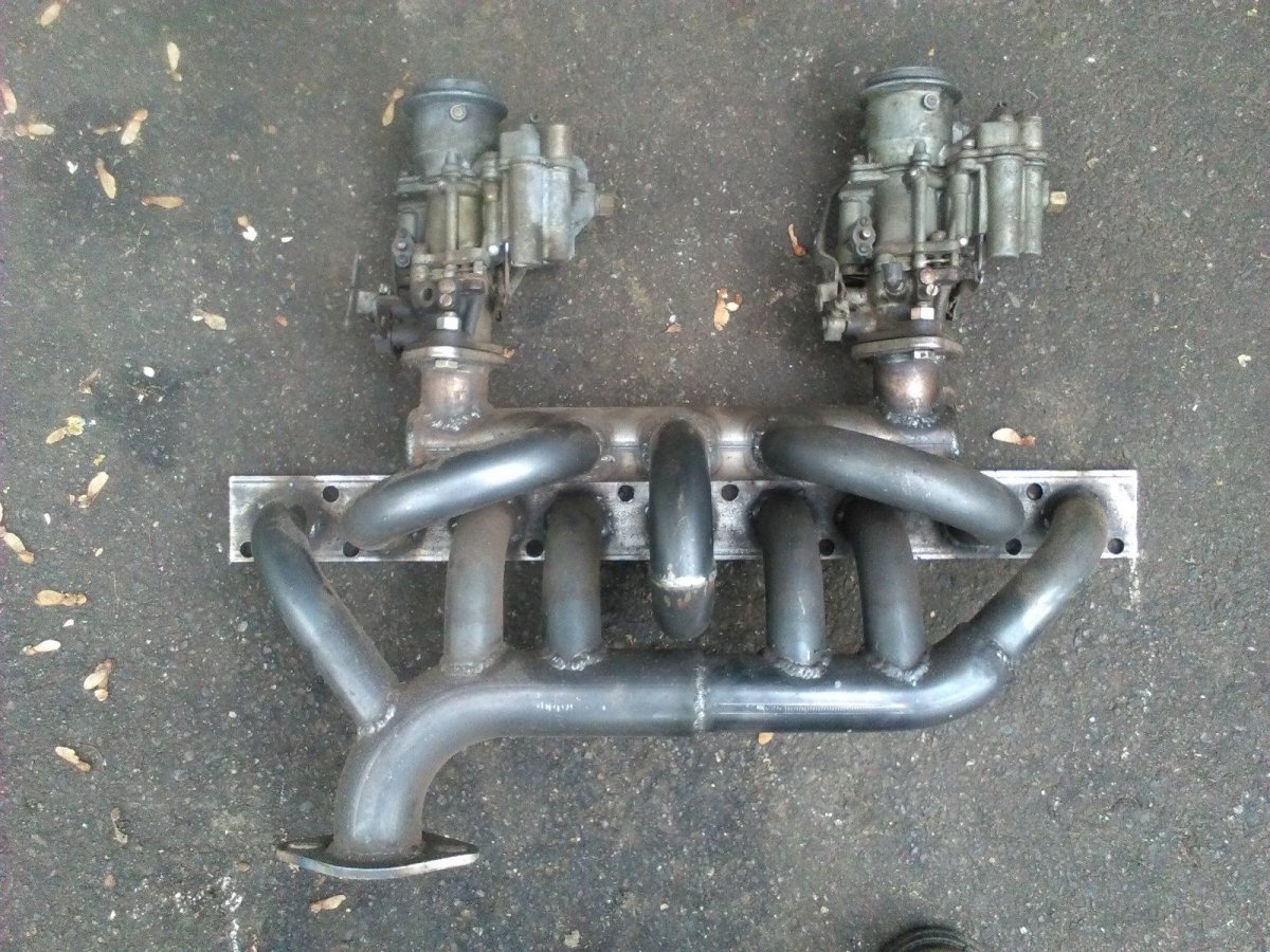

    s-l1600.jpg I just looked on ebay. There are a couple cast intakes for your engine, but they are high. Also, one for a 25 inch Chrysler that the fellow built himself. Looks like a good option.

  4. Fabber McGee
    Joined: Nov 22, 2013
    Posts: 1,459
    Fabber McGee
    I sure can't see why not. You could likely do it for less than the 500 bucks he's asking and do a little smoother job too. His carbs need rebuilt, I just don't see a lot of value there, hasn't even been tried out.

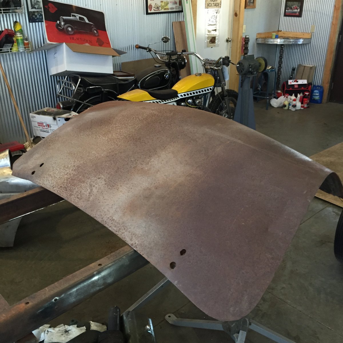

  5. rusty rocket
    Joined: Oct 30, 2011
    Posts: 5,262
    rusty rocket
    I have a 49 and 51 Ford decklid laying down at my pops, I grabbed the 49 and took the skin off. I was thinking that it would have the crown to fill in the sides of the idLdo. IMG_2323.JPG IMG_2324.JPG IMG_2325.JPG IMG_2327.JPG

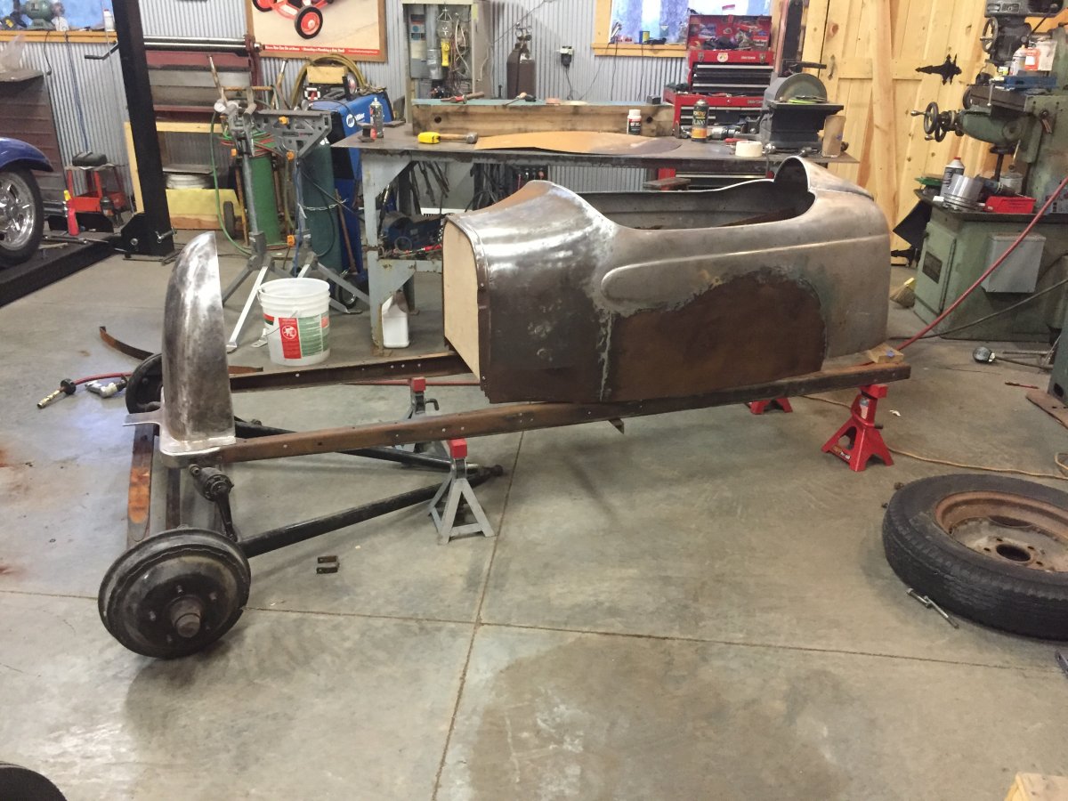

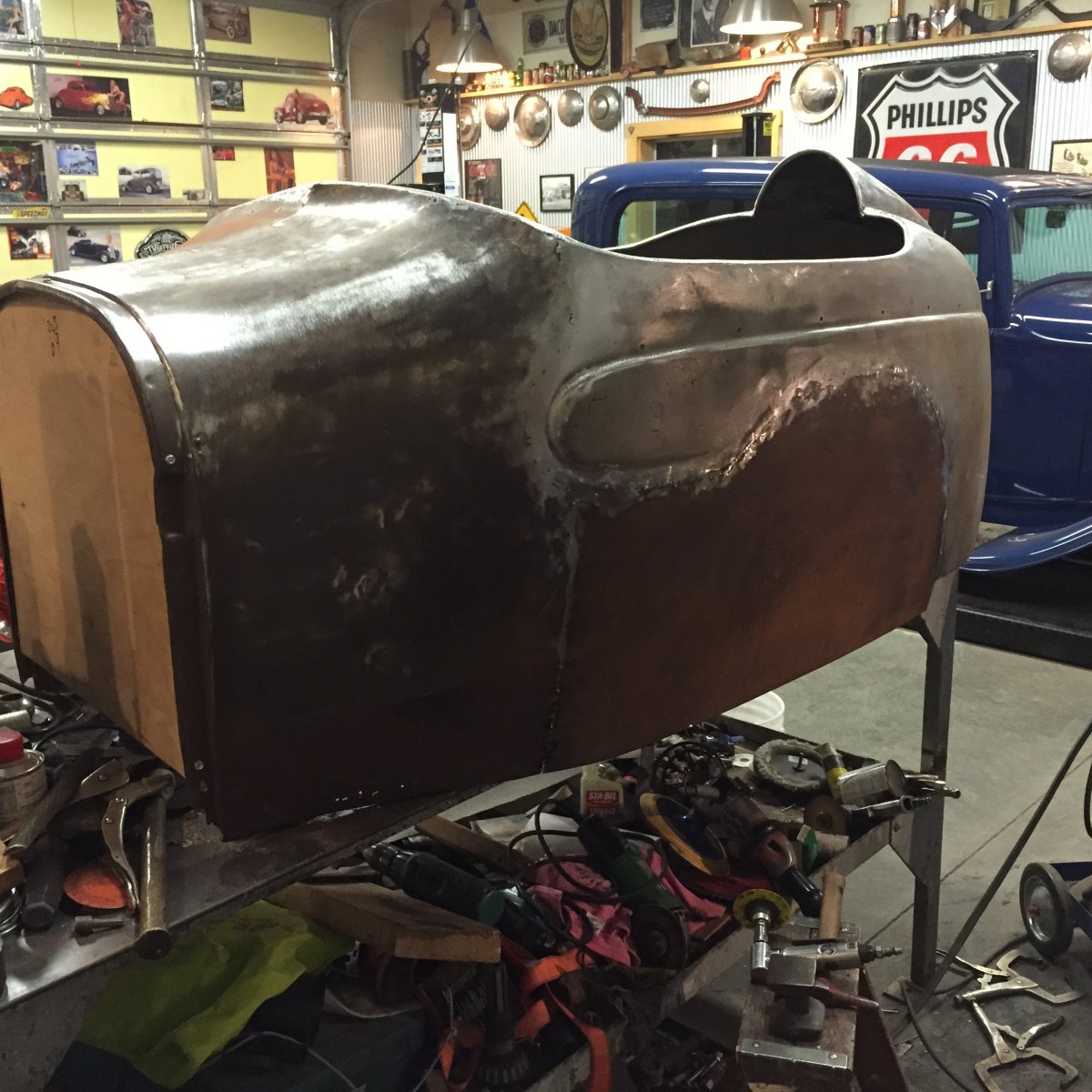

  13. rusty rocket
    Posts: 5,262
    rusty rocket
    Welded in most of the side panel until I ran out of gas. Looks like ****! Going to have to do a ton of work trying to get it straight. IMG_2338.JPG IMG_2339.JPG
  14. oldn_rusty
    Joined: Jun 26, 2008
    Posts: 112
    oldn_rusty
    Hey, Rusty.... For those of us that are novices and beginners, this is a terrific template of how to fabricate. Thanks for the primer. And its such a cool ride. Can't wait to see the peddle arrangement.
  15. rusty rocket
    Posts: 5,262
    rusty rocket
    Oh boy dont let me take the lead here. I'm doing everything *** backwards. I have good friends that are fabricators and I've seen how to do things correctly but when I get in my home shop I seem to forget all the right ways to do a job. As far as the pedal set up I've had that stuck in the back of my head but dont have a clue of how it will all go down. I guess it will depend on what parts are scrounged.

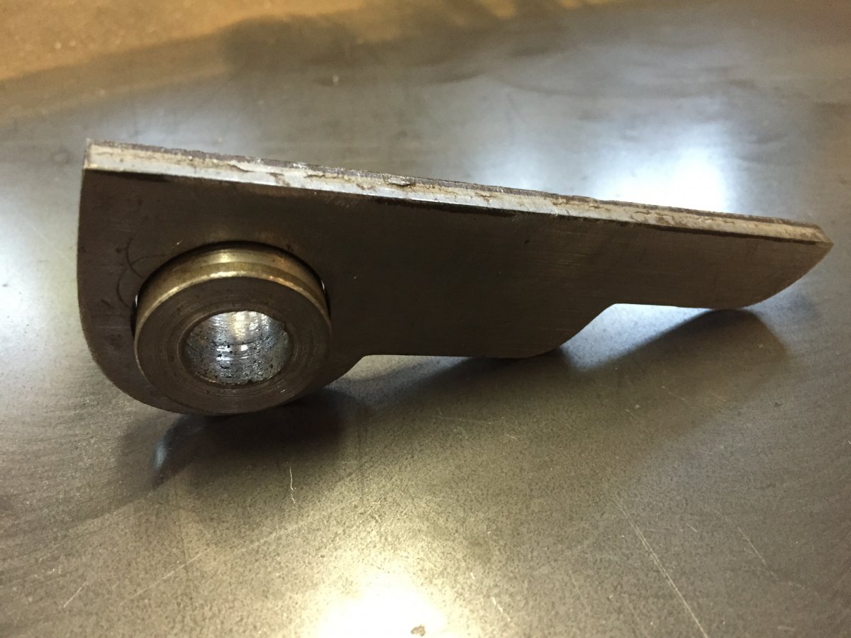

  26. rusty rocket
    Posts: 5,262
    rusty rocket
    I made a prototype tie rod mount for the frame. I just cant seem to do things simple, I still have to ream the bung out to 7 degrees. IMG_2362.JPG IMG_2363.JPG IMG_2364.JPG IMG_2365.JPG

  27. rusty rocket
    Posts: 5,262
    rusty rocket
    Milled up three more mounts. Little over the top for the car but what the hell. IMG_2366.jpg IMG_2367.jpg

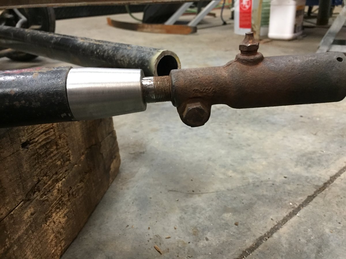

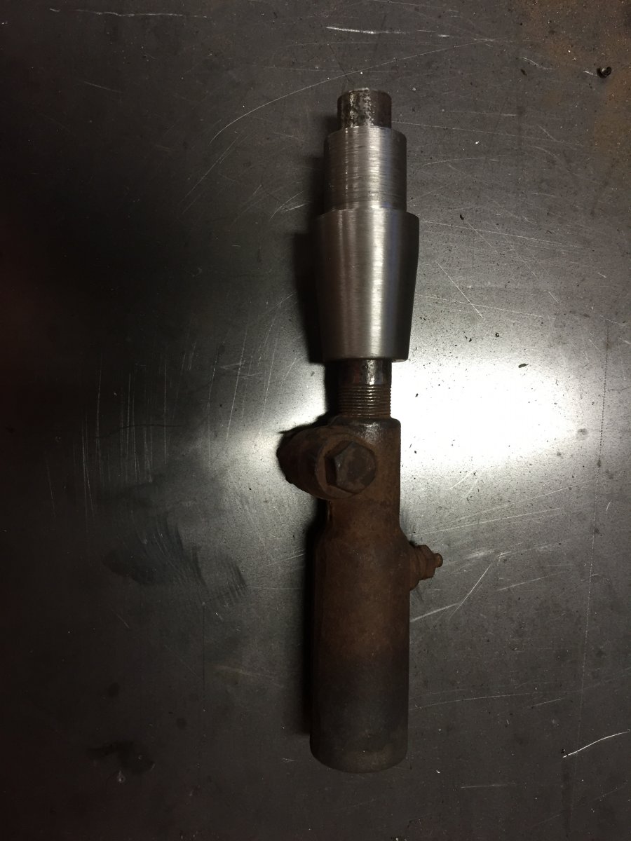

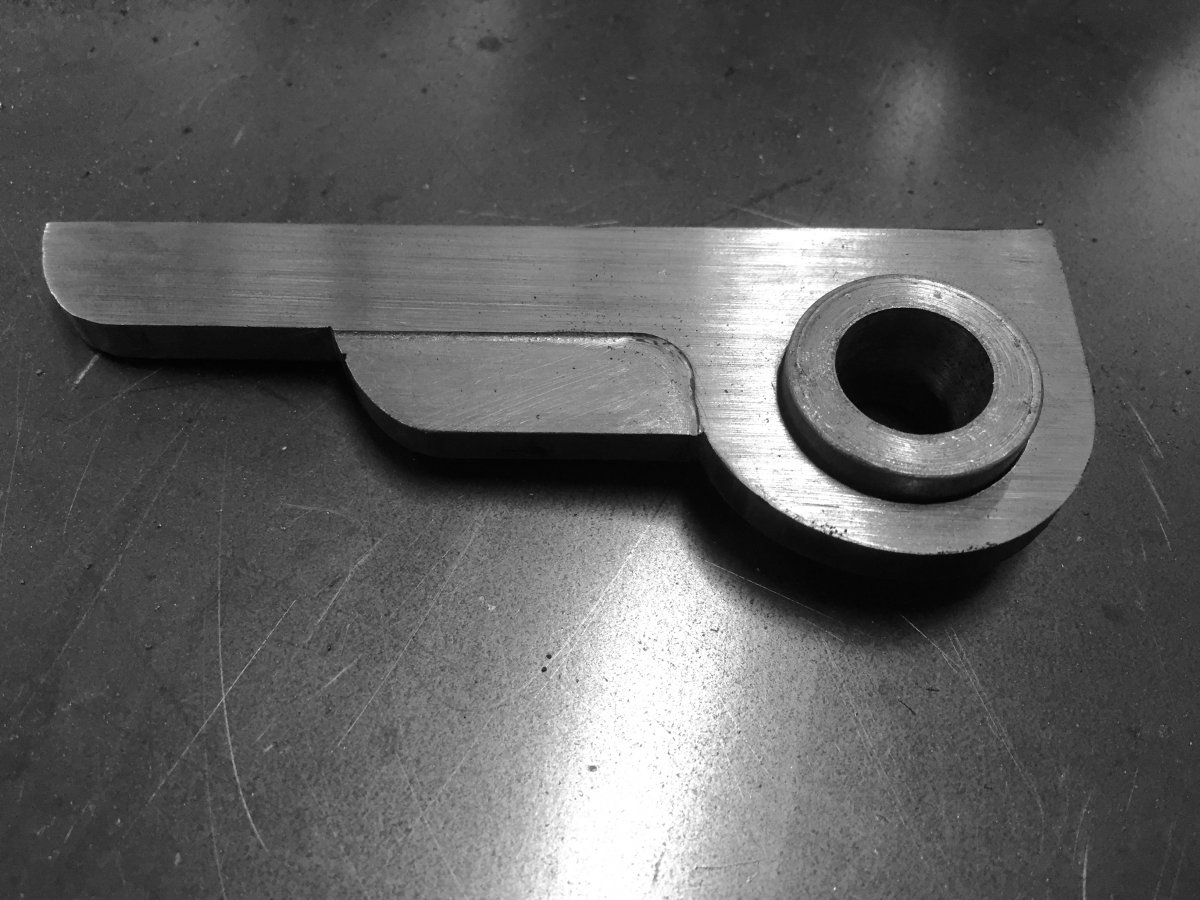

  30. rusty rocket
    Posts: 5,262
    rusty rocket
    Made one tie rod/ wishbone bung today after work. Going to weld the model A tie rod into the bung and then weld the bung to the wishbone. Should be fine for the weight of the car. Now to mill three more. IMG_2370.JPG IMG_2371.JPG IMG_2372.JPG
