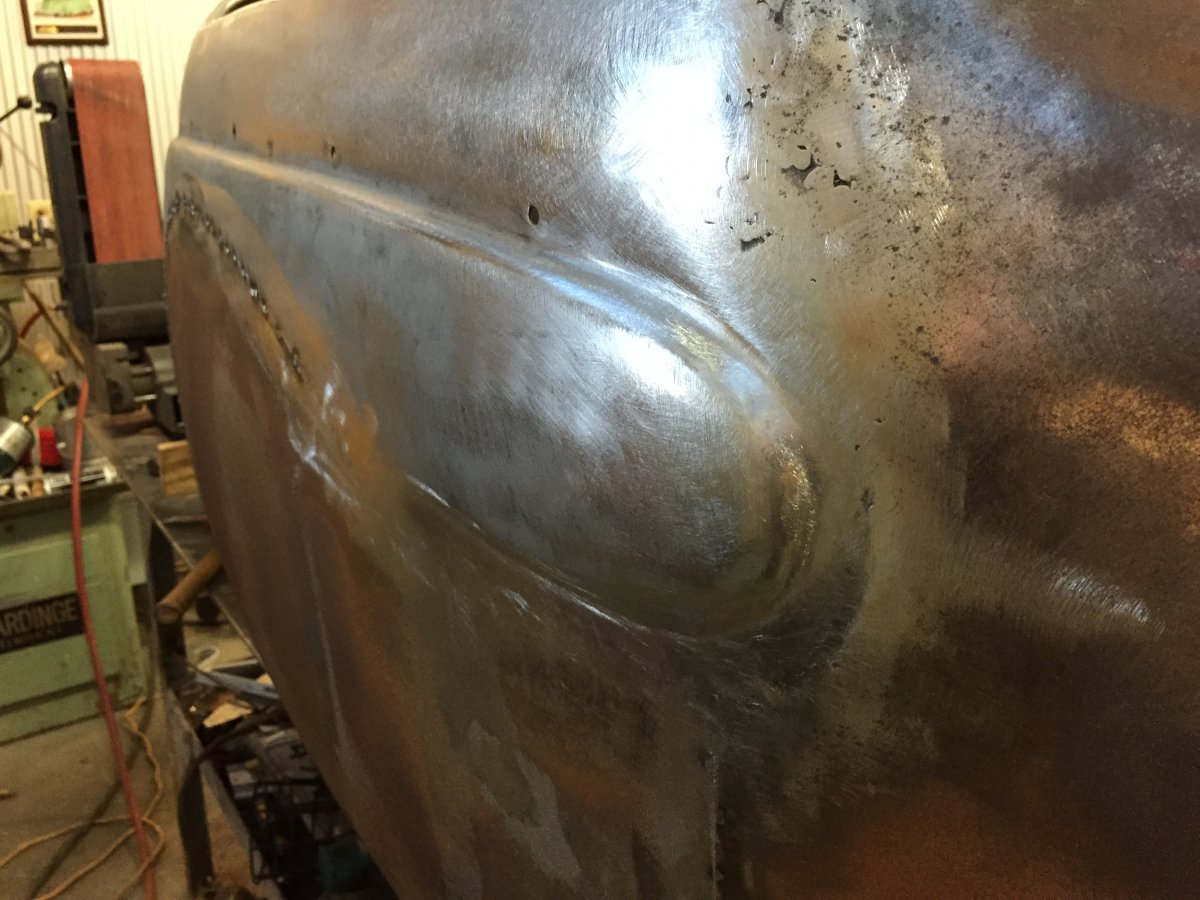

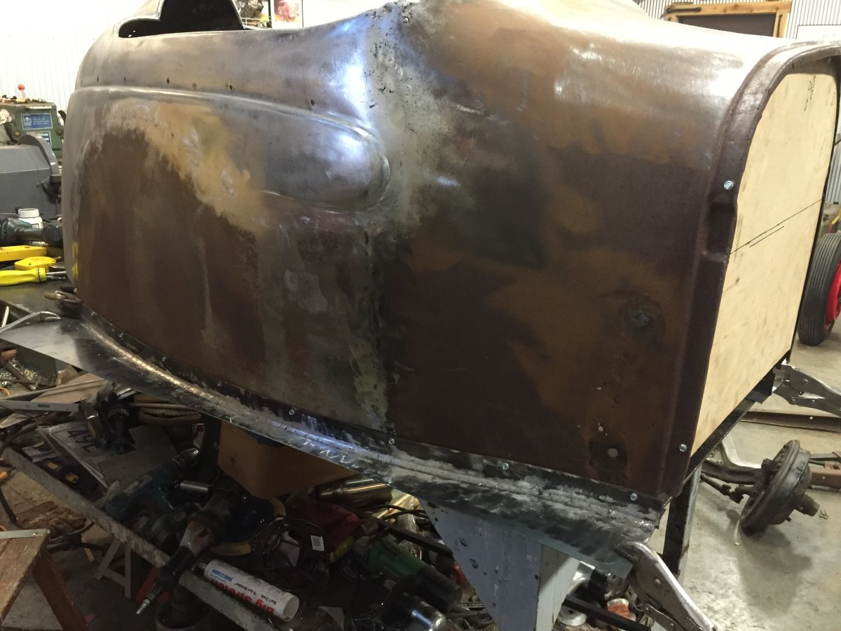

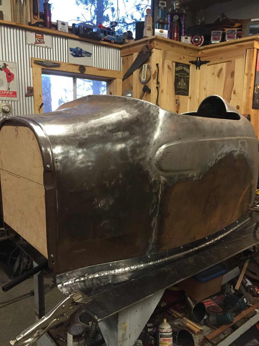

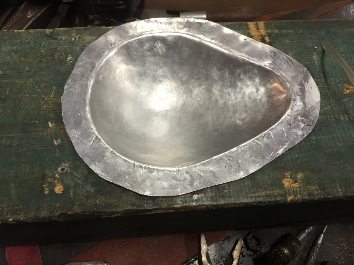

    I'm all over the place with this build, tonight after work I ruffed out a cowl steering blister(may or may not get used)I made the buck years ago for a blister on my T modified. I was going to make a different style for this car but my pops talked me into using the same one. IMG_2404.jpg IMG_2406.jpg IMAG0123.jpg

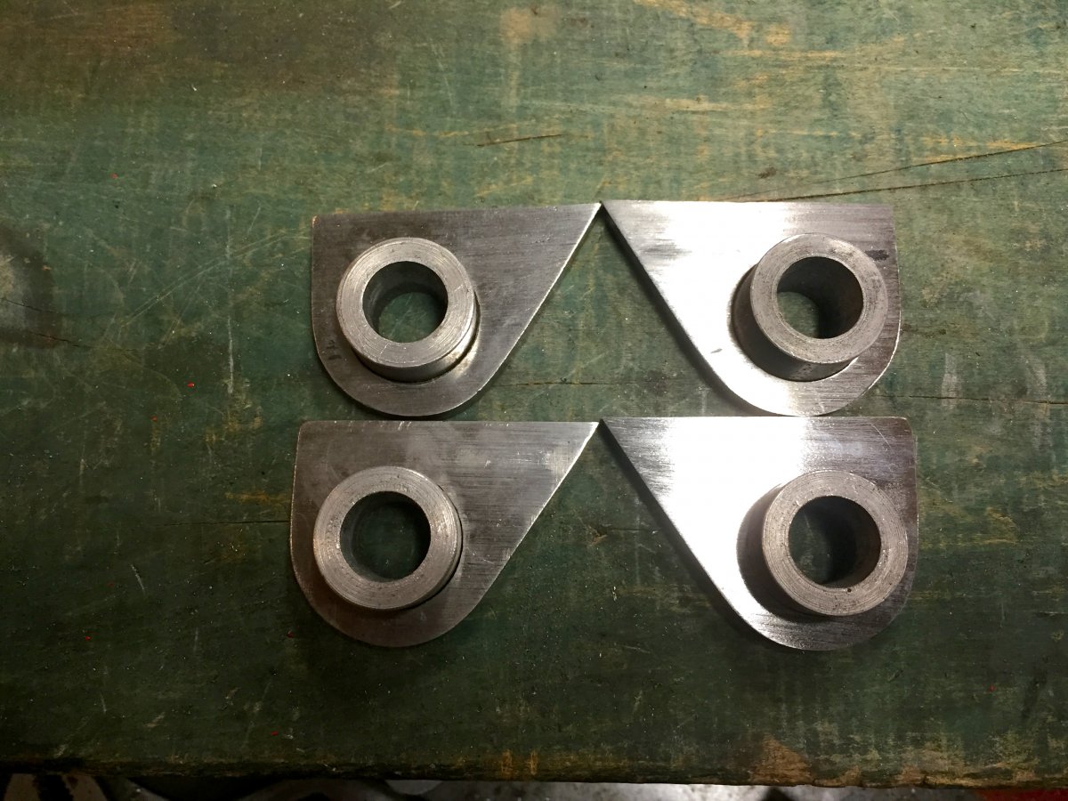

    IMG_2403.jpg I just could'nt use the Kool tie rod /wishbone frame brackets that I had milled up a few weeks ago, they were just to over the top for the style of build I'm going for. I whipped these up Sunday afternoon.

  7. vtwhead
    Joined: Oct 20, 2008
    Posts: 5,307
    vtwhead
    Like the blister and I would agree with your Dad! Your brackets are always flawless. :):)

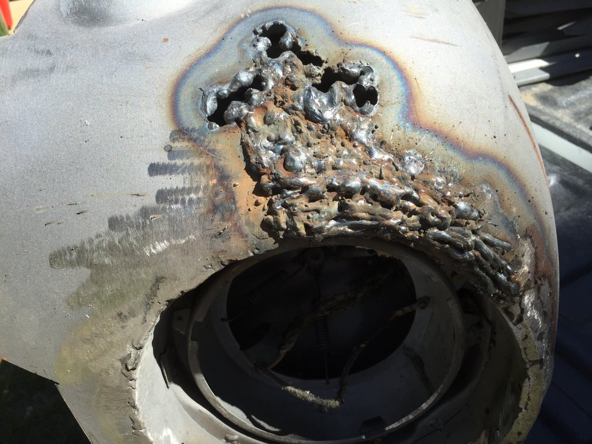

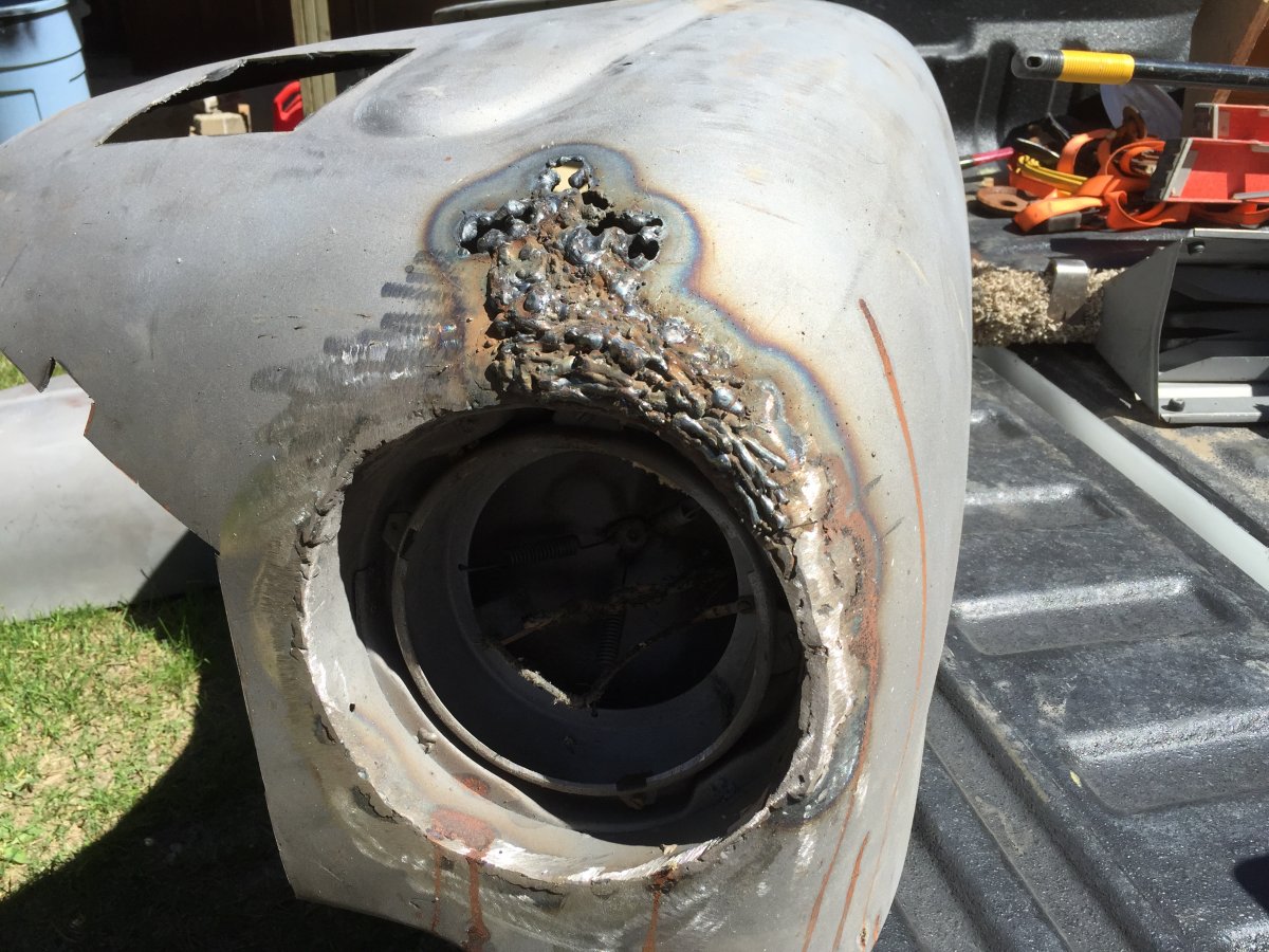

    I was going thru some photos and found this. I got my two 46 front fenders for the tail section from a local hotrodder. Back in the late 80s early 90s guys were using cordoba headlight buckets and trim rings for a frenched headlight. So the guy I got these from had just bought himself a new wire feed and the headlights were the first project. It didnt go so well, I didnt feel to bad cutting them up for the tail! I have to laugh every time I see this. My wife thought we should put a headlight in it and make a piece of yard art. IMG_1976.JPG IMG_1978.JPG

  17. Peanut 1959
    Joined: Oct 11, 2008
    Posts: 2,188
    Peanut 1959
    I'm very glad to see you chose your source material with some forethought. It's a shame to waste otherwise good panels. Thanks for sharing those pics. Unbelievable!

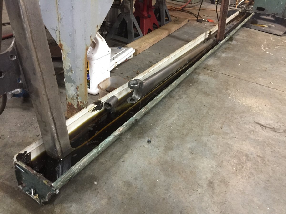

    Made a redneck citric acid dunk tank made from a piece of rain gutter so I can de rust my frame rails and wishbones. Wow what progress!!! IMG_2475.JPG
  21. timwhit
    Joined: Jan 30, 2012
    Posts: 5,188
    timwhit
    Tim: I like the citric acid idea. I have used lemon juice concentrate and works good. I did it on a piece of sheet metal with surface rust. I told a friend about it and He soaked a door lock ***embly out of a '32 p.u. and was amazed how well it worked.TW Edit: I went back and looked at the "Kool" frame brackets, I would use them!!! They are kool, deco look. I also saw the "F" script bolt heads. I've not ever seen those before, where did you get them??. I have seen bolts with Ford script spelled out on them A friend had a gennie '32 hiboy with a set holding the gas tank on but didn't remember where they came from. Tim
  22. patmanta
    Joined: May 10, 2011
    Posts: 3,882
    patmanta
    from Woburn, MA
    I LOVE IT! I might build a jig like that myself!
    You got the stuff on Amazon, eh?
    I looked around here on the HAMB and found a recent thread on proportioning:
    https://www.jalopyjournal.com/forum...for-mixing-citric-acid.1081388/#post-12257016
    It's also being used in @justabeater37 's build:
    https://www.jalopyjournal.com/forum/threads/pounding-out-a-t-roadster.1086957/page-6#post-12383445
    where @Finnrodder says he uses a 5% mixture.
    brad2v likes this.

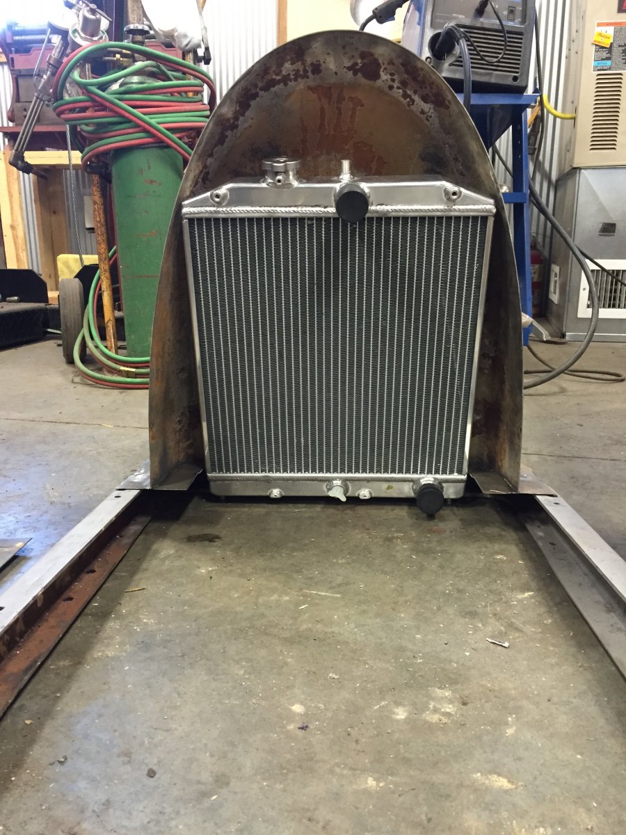

    Been trying to figure out a radiator to fit in my track nose. So I've been surfing the net and found a honda civic tuner radiator and a John Deere tractor radiator, so I was leaning towards the John Deere. My buddy in the mean time calls and wants to do some trading for an I beam front axle I have for a forty ford banjo he has. Told him I was kicking around radiator choices and he says I have a 65 mustang radiator so I load up the I beam and my track nose and head to his place, when I get there he says I forgot I have this little alum. Radiator new in the box. Low and behold its the exact same Honda radiator I was looking at online. Best part was he gave it to me. IMG_2484.JPG

    What is the overall measurements of the Honda radiator? Do you know any manufacturer info?
