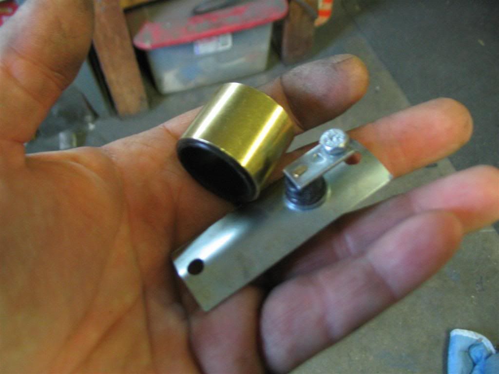

    The Jeep part numbers are A302, and A302B.
    A google search on "willys horn A302" provides numerous sources for the parts...
    www.willysjeepparts.com
    www.kaiserwillys.com
    www.walcks4wd.com
    The brush is about 15 bucks and the bushing is another 5.

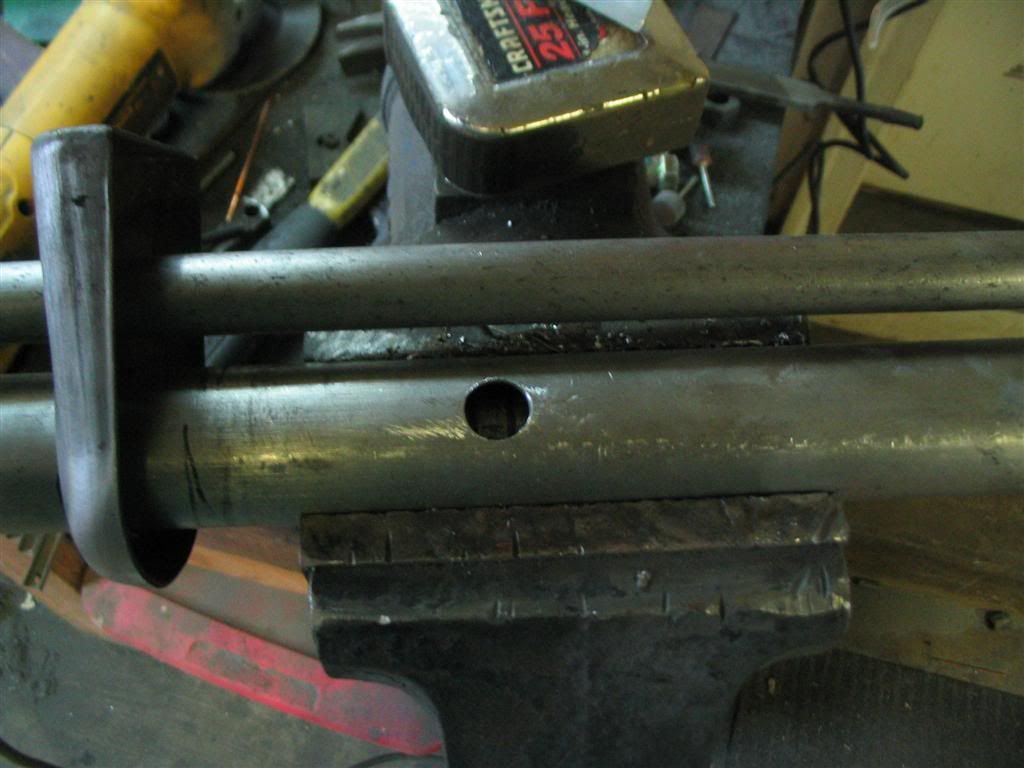

    First, drill the column where you want to install the horn contact.
    I chose just behind on the column support, on the passenger side.
    kidcampbell71 likes this.

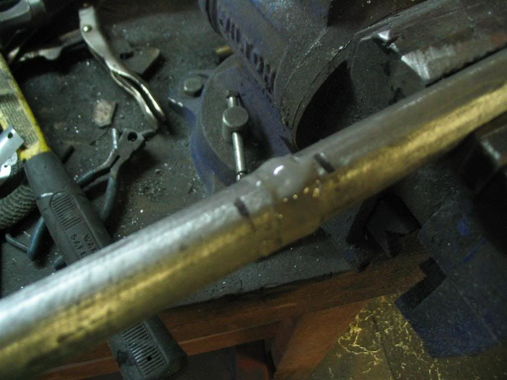

    Next, install the shaft, and mark it, in correlation with the hole.

    I guess the epoxy insulates the bushing from the shaft? Or is the shaft still a conductor?

    Looks like the bushing is plastic in the center, so it would be insulated from the shaft even without the epoxy.
