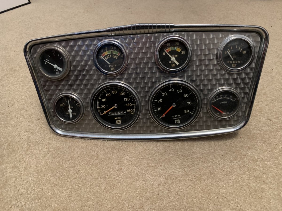

  22. 31Apickup
    Joined: Nov 8, 2005
    Posts: 3,769
    31Apickup

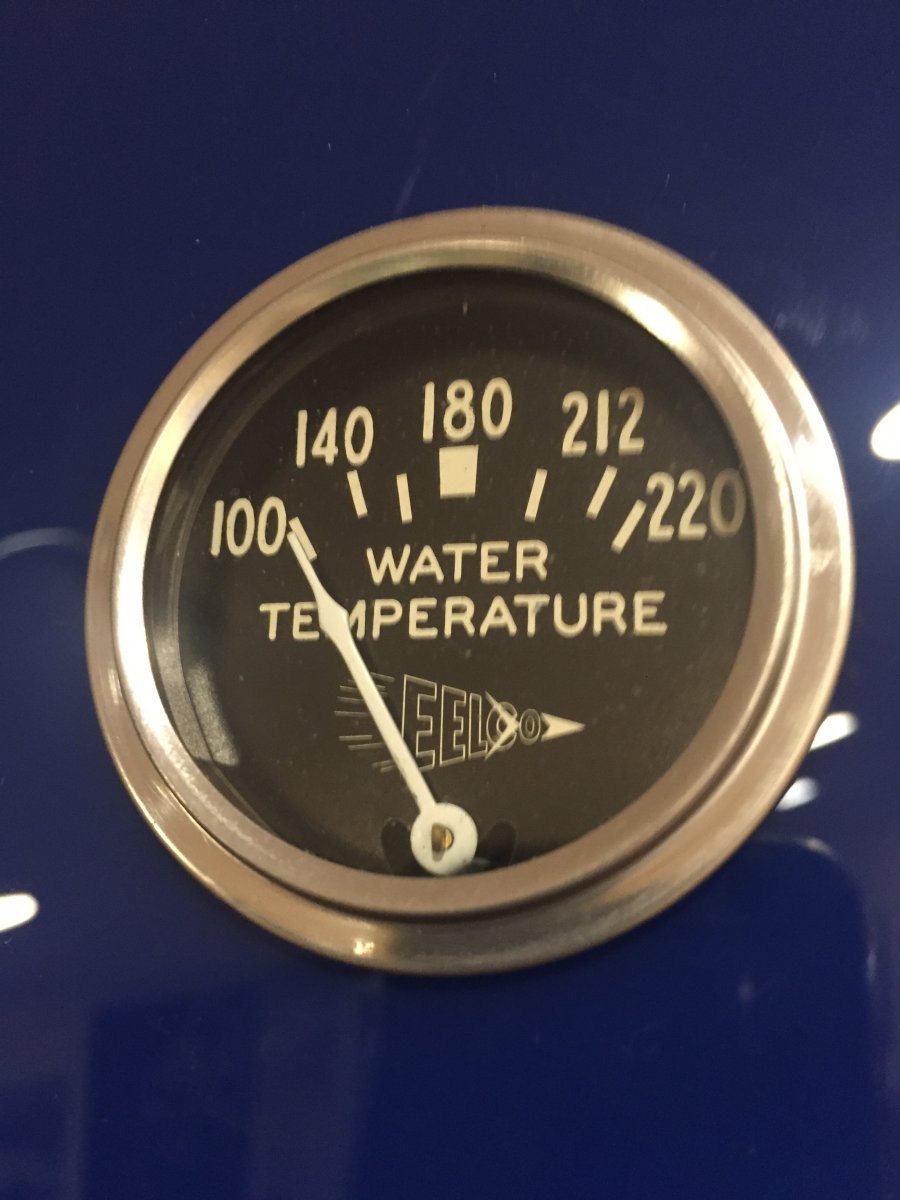

  25. Moriarity
    Joined: Apr 11, 2001
    Posts: 41,120
    Moriarity
    SUPER MODERATOR
    wow! a dwell gauge? how cool is that??? I have never seen one of those before. who is the manufacturer of that?

  26. 31Apickup
    Joined: Nov 8, 2005
    Posts: 3,769
    31Apickup
    Thought that’d get a second look, the case is plastic and only had “Made in USA” have to pull it off to look further. Paid a buck for it.

  27. Moriarity
    Posts: 41,120
    Moriarity
    SUPER MODERATOR
    The elusive Eelco water temperature gauge
