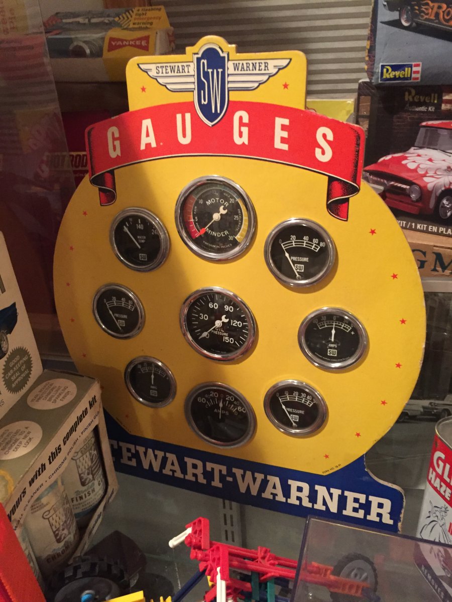

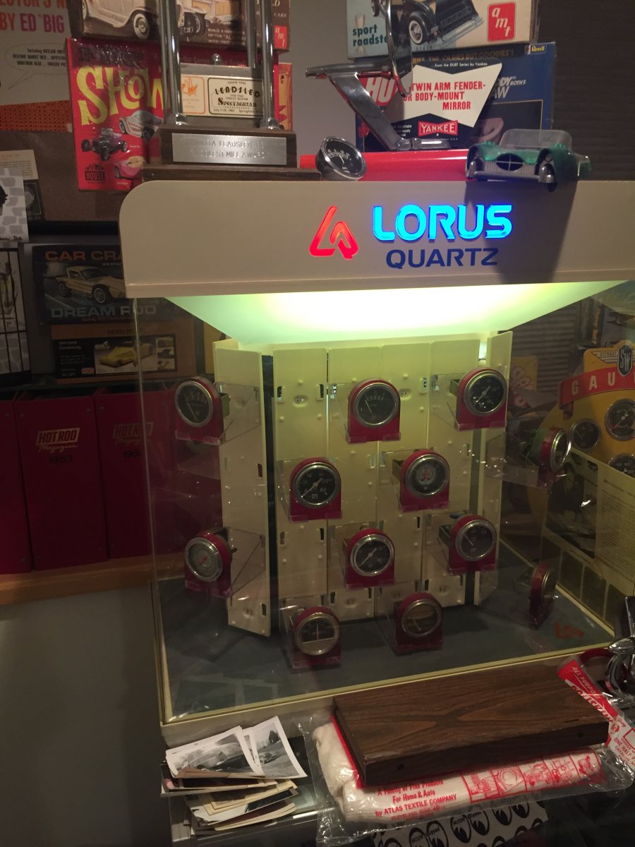

    Here’s a Stewart Warner store displays and a wris****ch display that I converted for gauges
    EF4138AD-F05C-407B-8E86-6B5D10B73687.jpeg 89884218-C8EA-4974-92B9-549777C42C9F.jpeg C6F07AD6-65C4-44F7-A341-F56BAF1319C3.jpeg

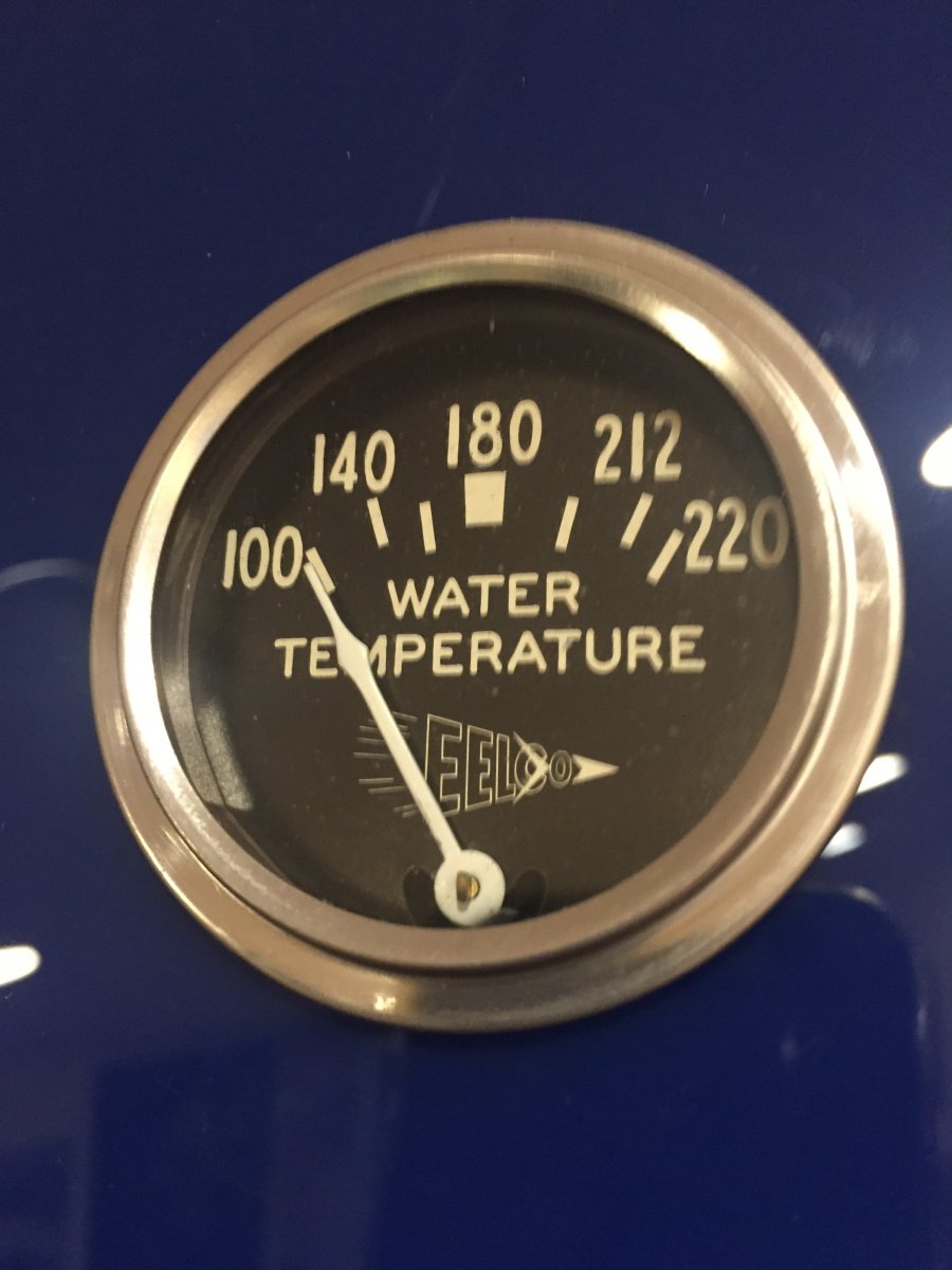

  6. I have an almost complete set of EELCO silver faced, red and blue trim gauges for my roadster. I am only missing the water temperature gauge. Does any one have one available ? I will take one with the capillary tube cut off, or with a damaged bezel. Any help out there ? I heard that there was a silver faced tachometer, and speedometer for sale at the LARS a few years ago. I would have traded my left nut for those.Thanks, nick.

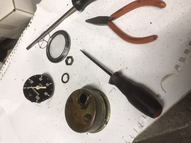

  12. I bought a few different oyster shucking knives off of Amazon. They are usually stainless steel and the blades are thin and blunt as opposed to being sharp. They don’t bend. I found a number of H.A.M.B. threads that covered dis***embly.
    I lightly restored a br*** SW fuel pressure gauge recently to go in an engine turned panel with a pressure pump. Good results, no damage, and looks nice with slightly yellowed lettering.

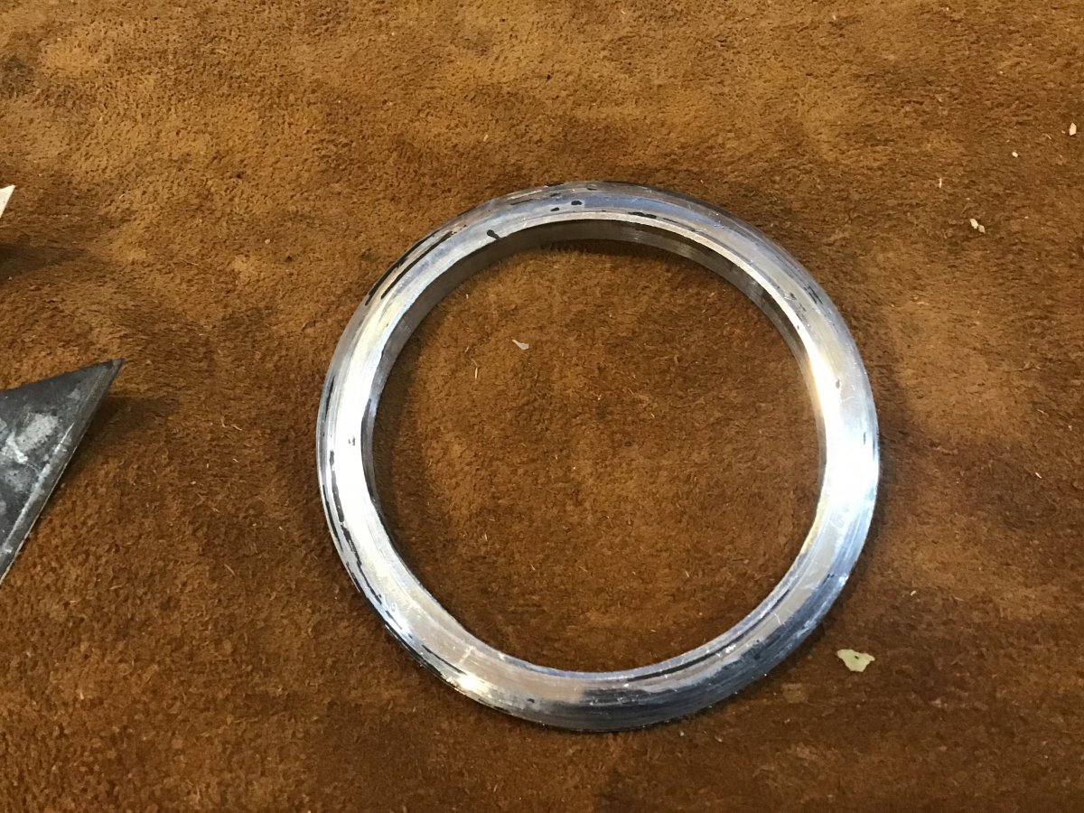

    I have had good results with my technique and using some tools I had in the shop.
    I first start with Kroil and those who haven’t used this stuff its crazy good. I soak the rim and tap in used razor blades 4 one on each side. I let it sit for a hour to let the kroil do its stuff. I then start moving the blades around till they all slide in easy or with little effort,.
    I then move to a paint s****per and with some more kroil and I have a few thickness and work my way around also working them till I have little effort to put them in. I then move to a old plane blade that I modified to fit with out distorting the rim. My last step is using a starrett hold down and slide it around and it also has a taper. So my progression on thickness is .024 razor blade, paint s****per .035 then .050 then the plane blade.070 and then to my hold downs at .070 taper to .125 . This will loosen it to a point to use the hold down to work the rim off.
    If this seems to much to do to get the rim off just turn one up on the lathe as I did :D. I made this one out of aluminum but have ordered some stainless to machine some.

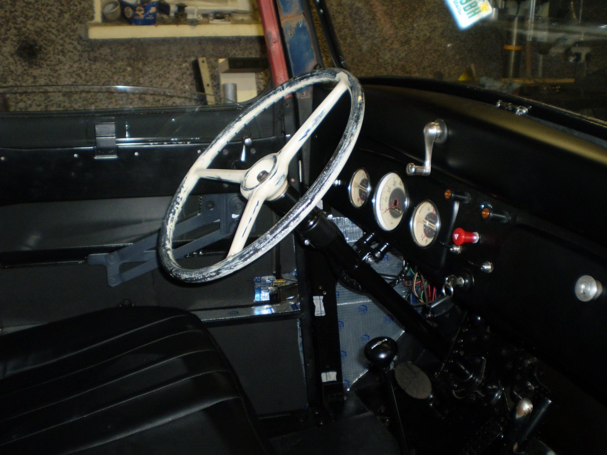

    original gauges overhauled with new faces steering column final fit maybe 002.JPG

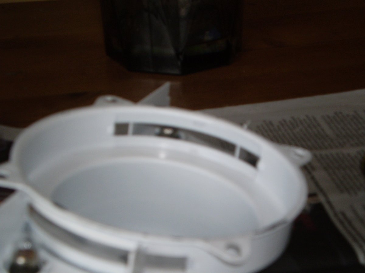

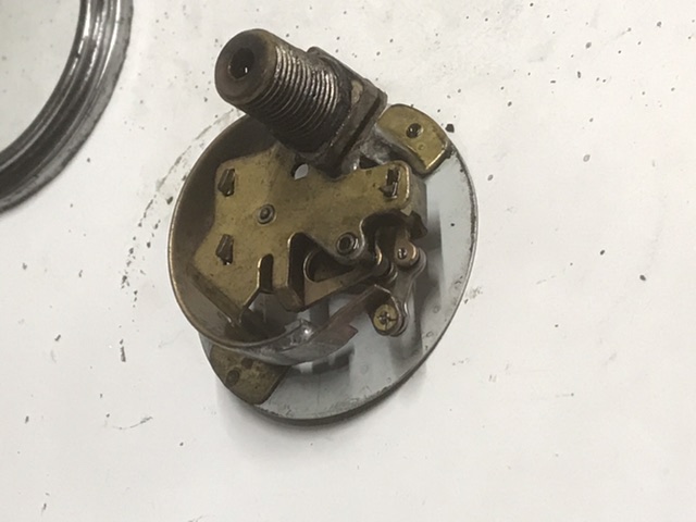

    Well I’ve had a go, it’s in bits! Bit of a pita to get the bezel off, not sure how it will go getting it back on..
    The needle appeared to be on the wrong side of the 0 stop, popped it over, and gently moving the mechanism, it seems to work and return fine. Wondering how to clean all the oil and engine mess out of it, paint degreaser? I don’t want to damage the face, obviously. Is there a way I can check it’s working? Also need to replace the mounting studs on the back.

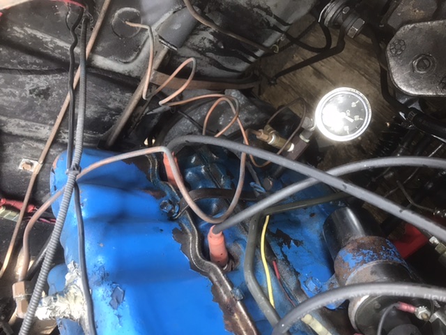

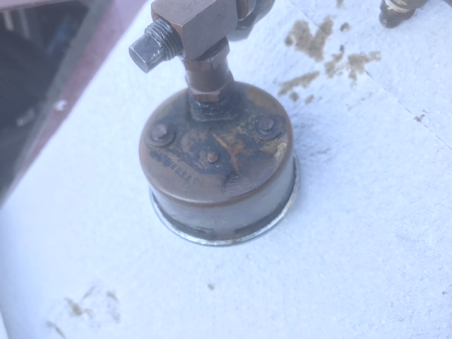

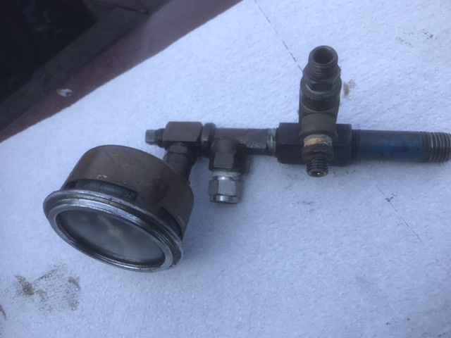

    Hello Guys,
    As you will recall my oil pressure gauge would only return to 4 psi (not all the way back to 0). Some of you asked how I was able to resolve this. This is a little "photo heavy" but I hope this post helps illustrate what I did.
    Here is my "Before"
    I had a sneaking su****ion that it just needed to be "worked" a little. I grabbed a br*** adapter for the oil line, a 10cc bulb syringe, and about 9cc of oil.
    The end of the bulb syringe fit nice and tight inside the br*** adapter as shown here....
    I simply pushed on the plunger (creating pressure) obviously moving the needle which gave an oil pressure reading of 25psi. Then I pulled back on the syringe plunger creating vacuum (suction) which brought the needle back down to 4 psi. I kept doing this for about 4 minutes. After "working" the internals of the gauge for 4 minutes, the needle went to 0 PSI.
