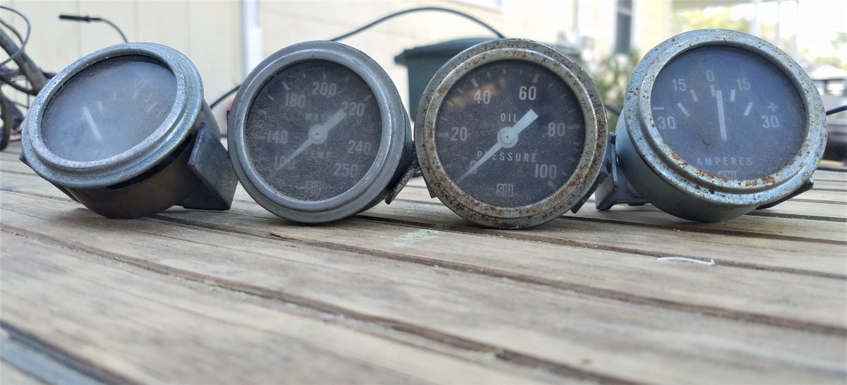

    Took these out of Dominique. A cleaning...and then some...is in order. 20200328_165714 (2).jpg

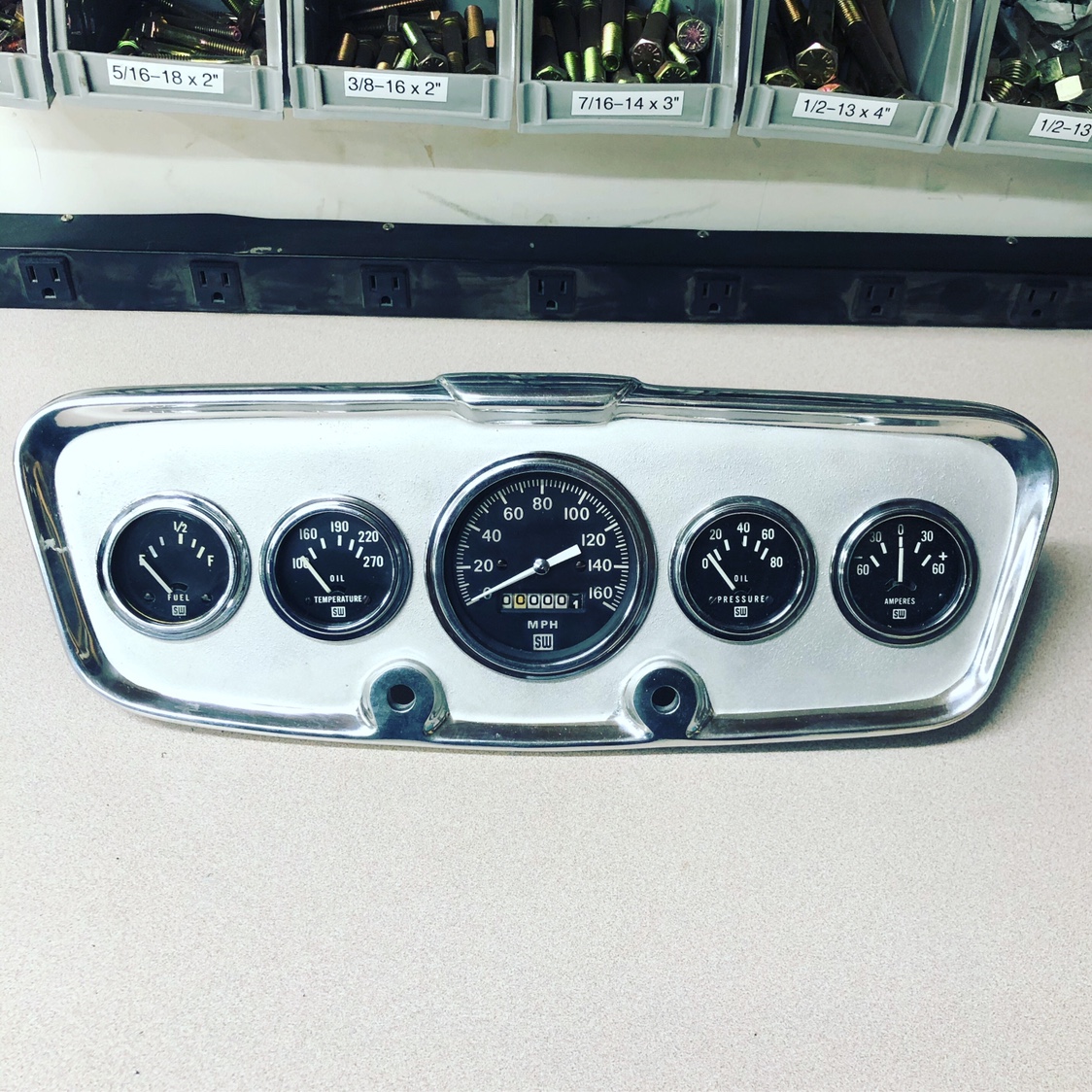

    Here’s what I’ve been able to scrounge together from the great auction site. I have a 100-240 Water temp gauge, but it’s more worn than this NOS Oil Temp one.
    I took the speedometer apart and cleaned it up. I also cleaned up the fuel gauge. The other are like new. All USA made small block logo. Now to find the right sending units since these are all electric except the speedometer of course.

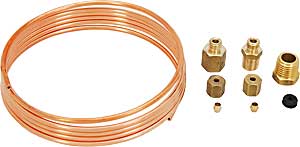

    @neilswheels
    Not sure if this helps you, but I have used this kit numerous times with my SW gauges. You can get these from ebay, Summit and Jegs cheap, about $11.00
    55541055.jpg b

    Thanks Speed On, I’ve seen those, it’s just a bit expensive to get th here, UK. I have a hydraulic supplier over here,who also happens to be a hot rodder helping me out. He’s supplied what he thought they’d be, but they seem too tight, like the thread pitch is wrong.
    As Cosmo mentioned, I’ll have to find a thread gauge, which won’t be that easy over here ***uming it’s an npt thread

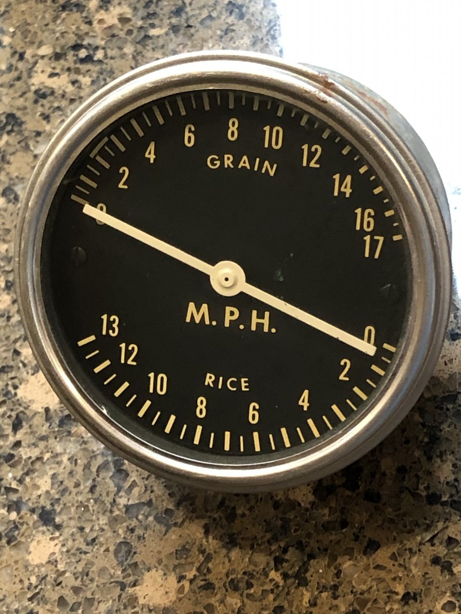

    Probably the least useful thing I have bought recently. I believe that this is from an Oliver tractor. I don’t own an Oliver, not do I need to know how fast I’m harvesting rice. And I certainly drive faster than 17 miles per hour...even on the John Deere!
