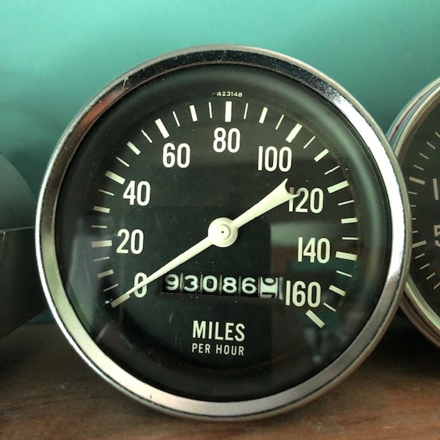

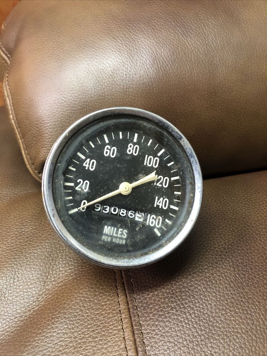

    The odometer really needs to be removed and set by hand, if you figure your average drill is 1000 to 2000 rpm and most domestic speedometers are 1000 cable revolutions per mile... well it would take a long time. The needles are tricky sometimes and as fleetside66 stated while I haven't taken one to the jugular, how does the saying go Cross my heart hope to dye stick a speedometer needle in my eye... or something like thato_O. The absolute worst one is the 56 T-Bird tach needle it's so thin and delicate. Turn counter-clockwise against the speed-cup stop while gently pulling.

    Yes, it took awhile moving the odometer to 42k miles with the drill. I set it up in the living room and let it run a few evenings while we watched television.

    With this one, once I took it out of the cup, the odometer was easy to remove and clean up a little. I lubed it with some white lithium grease, reset it manually moving the dials and put it back together. The odometer had to go in just the right orientation with the metal tabs between the numbers for it to work. I tested it with the drill after putting it back together.

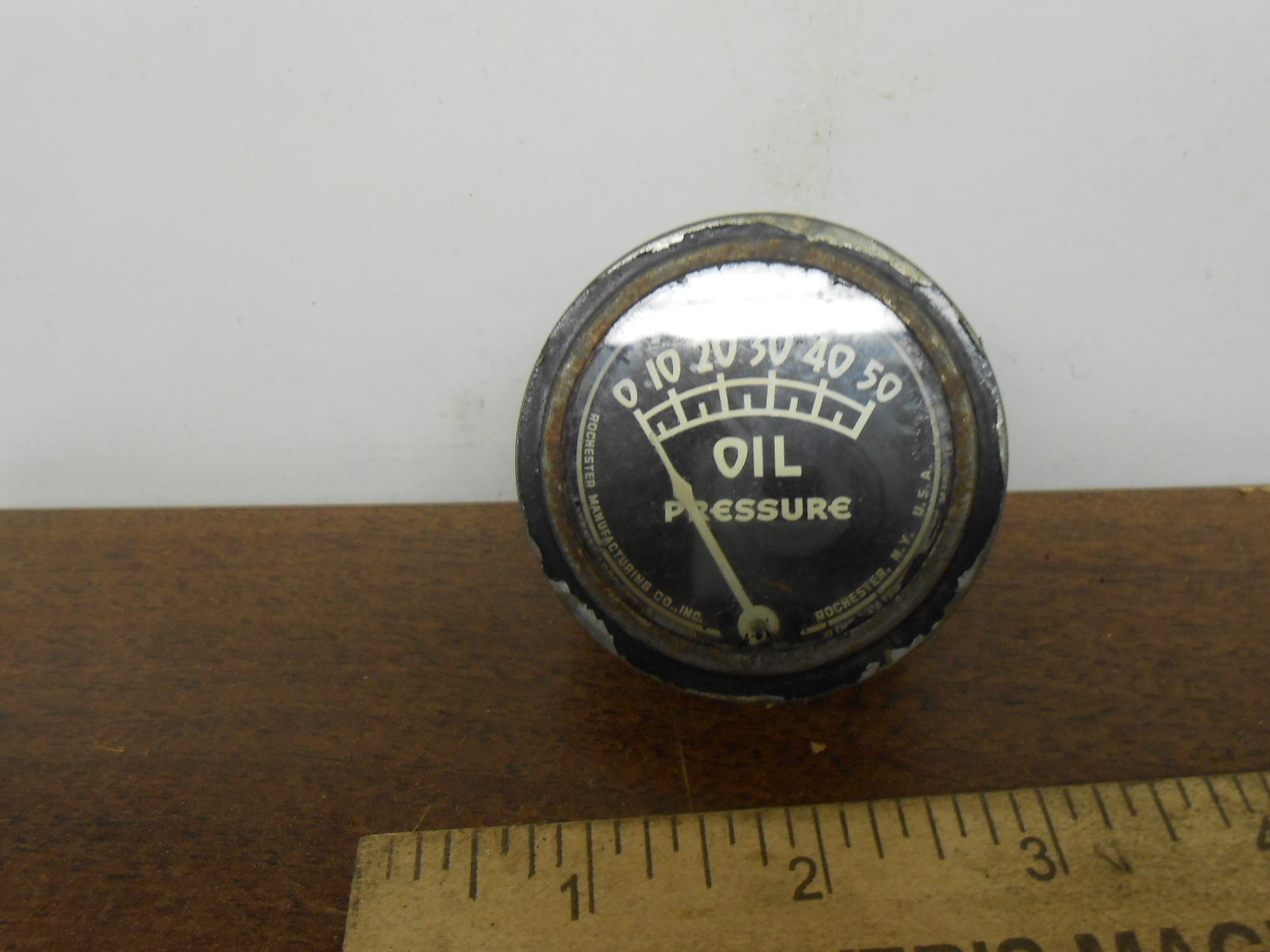

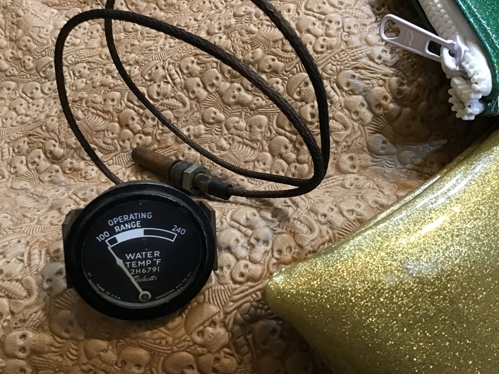

    I found this outstanding Rochester Mechanical Water Temp gauge. It's 2 1/16" with the coffin needle. The numbers, lettering and gauge face are crisp and present very well. The gentleman selling the gauge told me it worked and he allowed me to test it. Sure enough, when I put heat to the bulb the needle rose.
    I was also able to find the matching Rochester Mechanical Oil Pressure gauge. It is N.O.S. as it was still in its original box and wrapped in the original protective paper from the factory. Score! Then I found an N.O.S. Stewart Warner 2 hole chrome panel still in its original box. The panel even had the protective film on the face! How awesome. So, it put the three together and this is what I have......
    I dipped the bulb in boiling water. The needle rises as it should, provides an accurate reading and returns to 0 very smoothly. The quality of these old gauges is amazing. This is why I like them so much. Rochester2.jpg

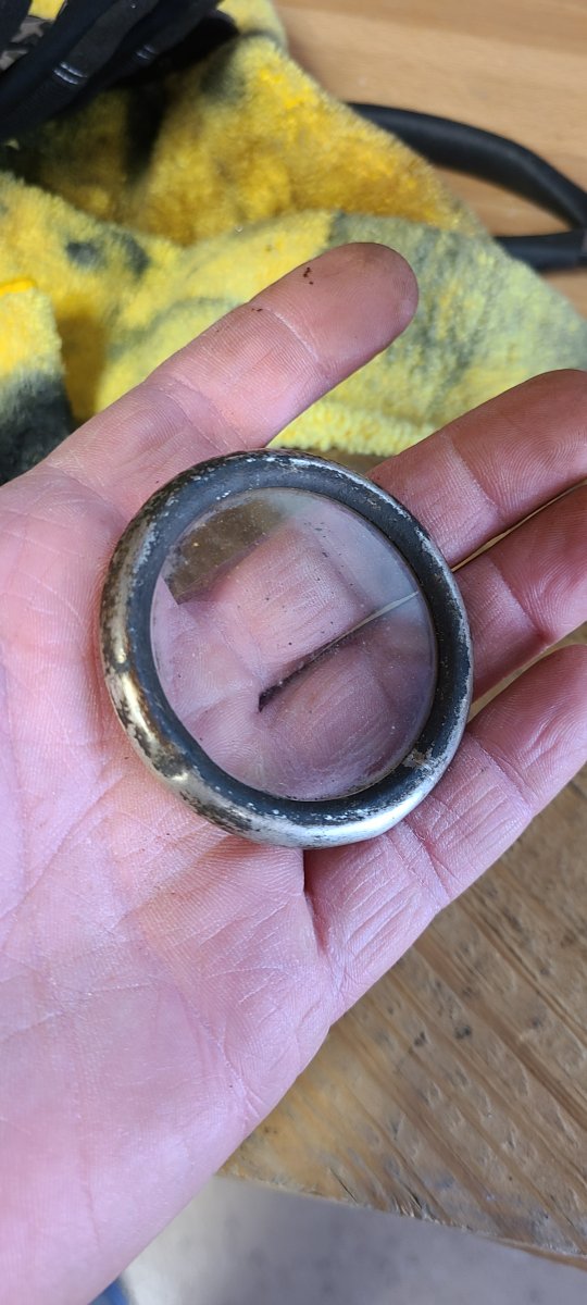

    Next, I turned my attention to the bezel. As I cleaned, it was apparent it had a nice br*** bezel beneath the black paint...
    I cleaned the retainer and the backside of the bezel as it was full of dirt/corrosion. It cleaned very nicely. Also, there is something that is very satisfying when you get to clean the inside gl*** on a gauge. All the clouding and dirt wipe away so quickly and it really brings the gauge back to life. It's really a "game changer" when the gl*** is super clean on an old gauge.
    I was to the point where I had gone over all the pieces of the gauge and was ready for final ***embly...
    Once I had it back together I gave it a test (sorry about the glare...my boy took the photo while I gave the gauge a little pressure....
    As I stated, I wish I would have taken a "Before" photo. It was a rusted out pile that most would have walked bye. Anyway, here is the end result....

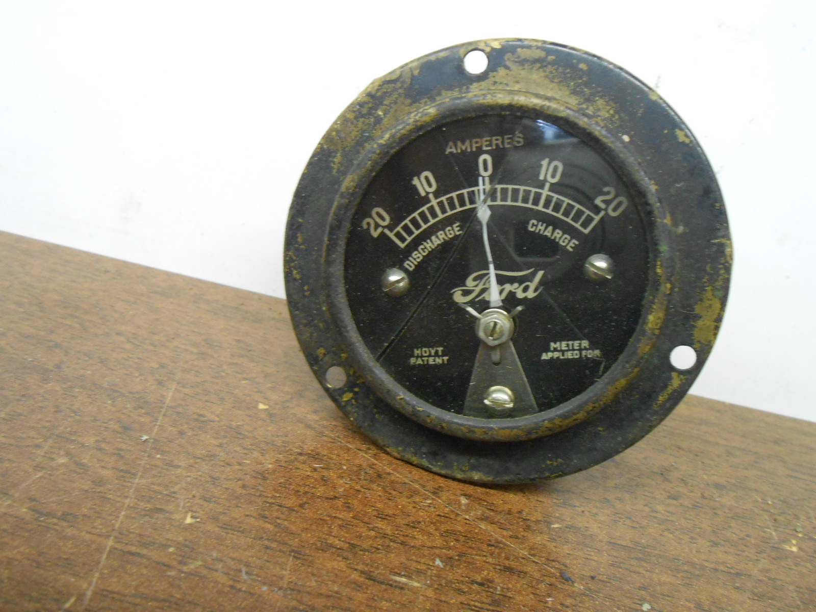

    I picked up a few of these temperature gauges new old stock and info would be cool image.jpg

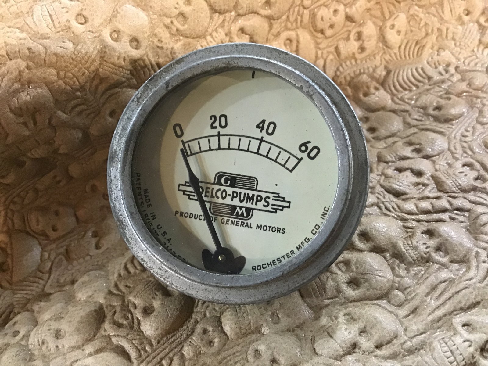

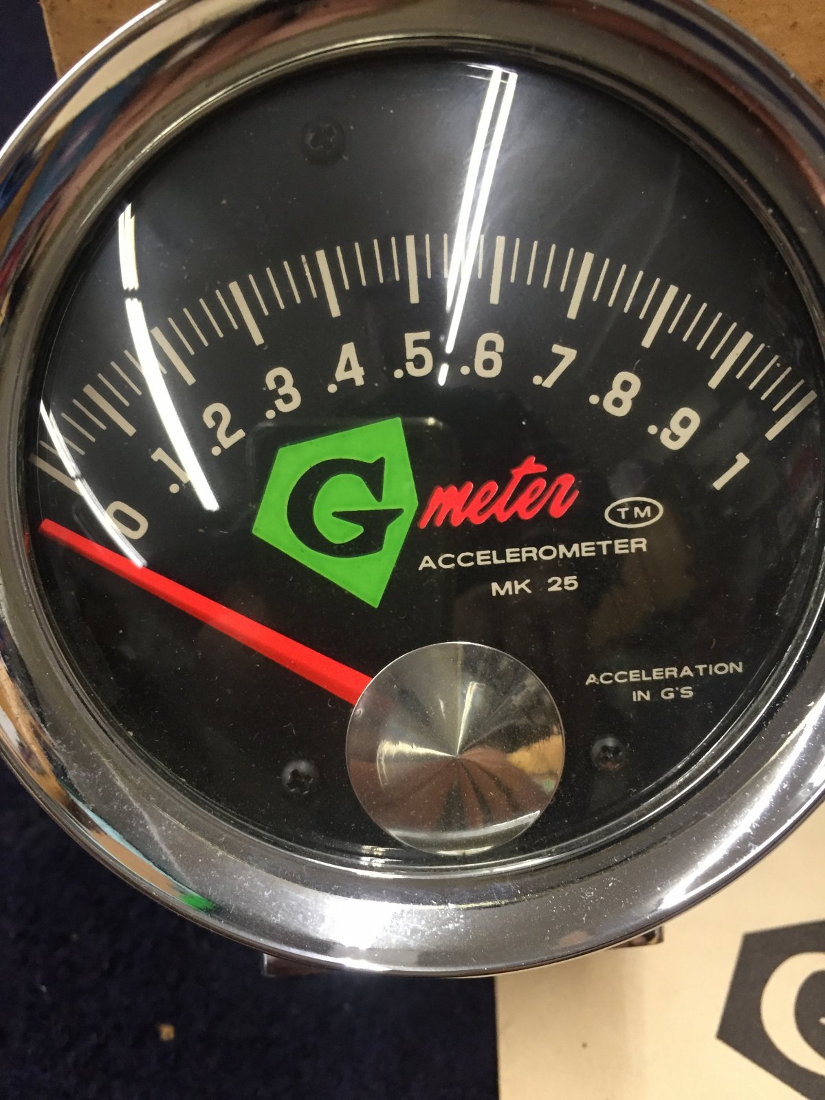

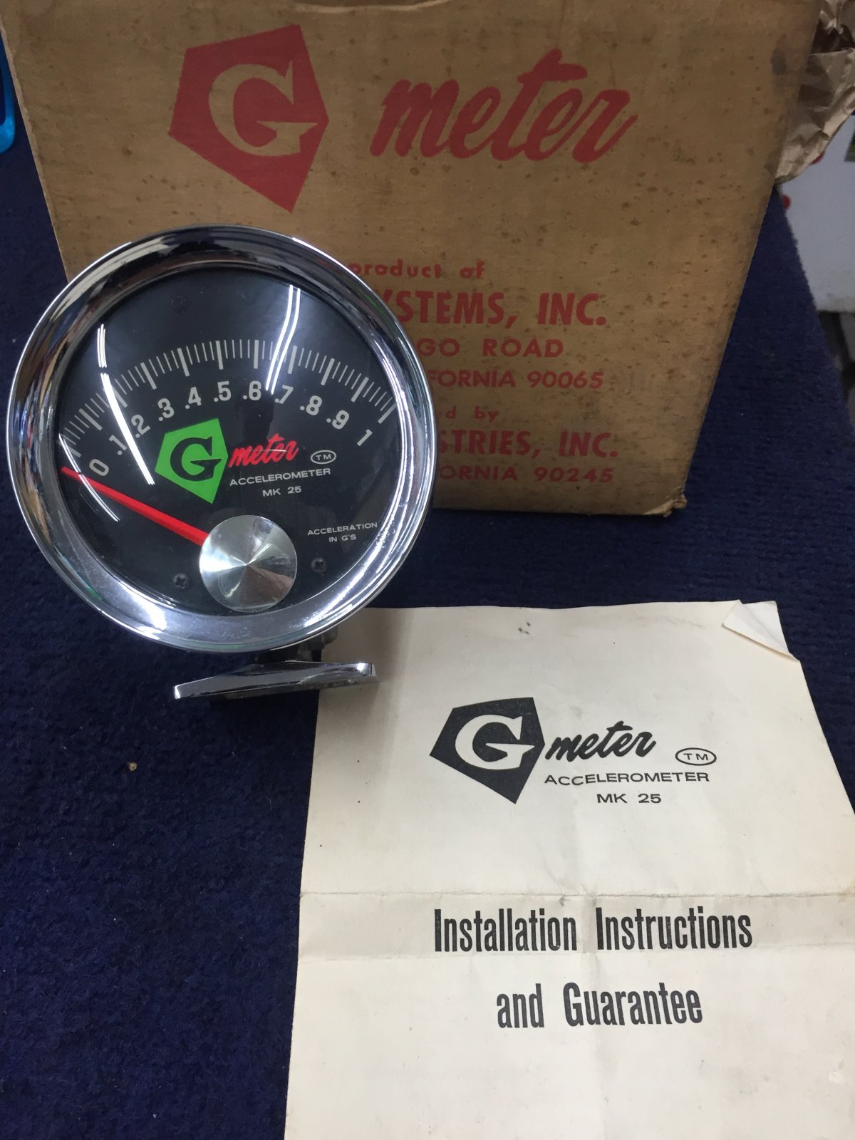

    Finally picked up a G meter..... 96734066-DB92-4949-A302-7E2BC6D996E1.jpeg 4491D34F-8116-44A2-B646-107BA139107B.jpeg

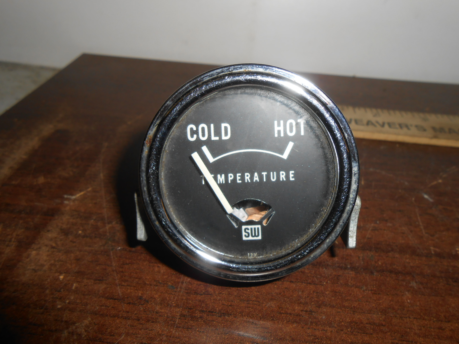

    That Cold-Hot temp gauge is great if you have a car that runs a little hot. Since you can't pinpoint the exact temp, there is much less anxiety when you're stuck in a little traffic. Stewart-Warner should have called it the "Rationalizer."

    That "G-Meter" must be pretty rare. It would be neat if they made one with units of feet per second squared.

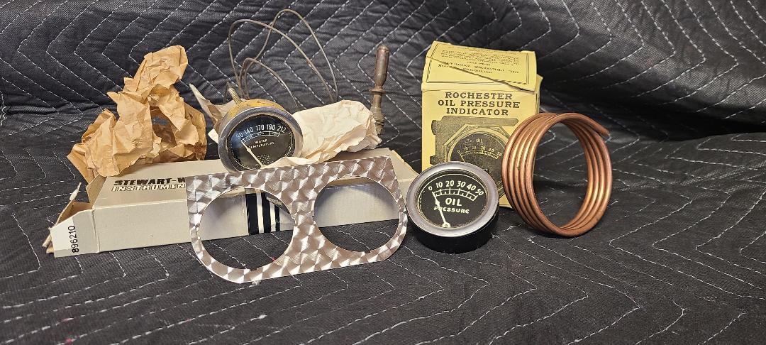

    I was recently contacted by a well known hot rodder and hot rod artist. He asked if I had a set of original gauges that capture the spirit of early 60's racing in America. This type of request is something I truly enjoy. He is working on a project where authenticity is important. Here is a taste of what I'm putting together
    Early 1960's Stewart Warner mechanicial water temp with steel capillary line. Matching Stewart Warner mechanical oil pressure gauge and a beautiful early Faria 8,000 (8 cyl) tachometer.
    I still have a few more gauges to add, but I like where this is going. His project is quite amazing and very HAMB friendly. That's all I can say about it.
