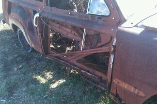

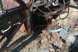

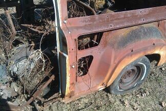

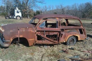

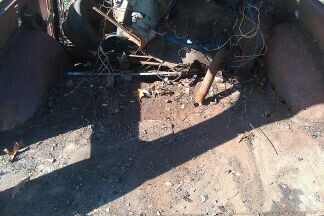

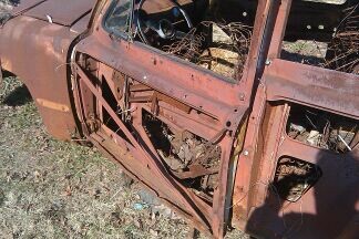

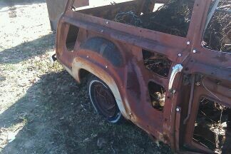

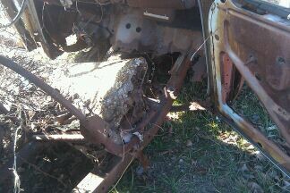

    Well heres the deal, this car is really bad, I mean bad, I dont really know what to do here......I have pretty good vision but I am having a hard time with this one, the frame is gone, the rockers gone, the lower cowl gone, the floors gone, the front clip gone, bottoms of doors pretty bad, no upper tailgate, no wood of course, no taillights, no tire mount or cover, no seats, I dont know if this thing is saveable or not, what do you guys think?

    How much different is the ford and the merc? How hard would it be to cut the woody part off and graft it on a 4-door merc? Just kinda dreaming here....Jim

    OK Did some measuring, the ford and merc are close, the big question for me is the doors, I am thinking shorten the ford door about 3" and then find another pair of doors to build the rear doors from and keep them suiside like the merc would have. What do you guys think? Or should I just do it as a 2 door like the merc woodys were? Could someone photoshop a 4-door merc woody for me? Thanks, Jim

  21. Just cut a 4-door with a good frame down to the floorpans and graft on what's left of the top of this one, weld a ton of braces in it and cut the rotted remains away, and figure on building it as a custom that doesn't need the stock taillights or spare tire mount.

    I made the same guess and bought a nice 50 fourdoor for the frame and front clip...only used the clip 'caus the frame is different. I never thought 'Ol Henry would make a frame just for wagons, but he did. Merc wagon doors are different as well as the front clip (but car clips are the same).
