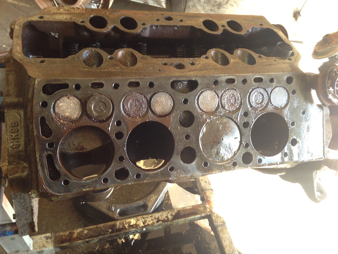

    Question time! how the heck can I get the motor to turn over if all the crank bolt does is keep tightened? the motor moved a little bit back and forth and then the bolt just started turning?
    btw heres the pics with it taken apart some, everything looks real good. I am now 95% sure it was yanked out of the truck because the ****** was ****. only problem is it was stored for the last (who knows many years) with no carb on it so now the pistons have some light pitting on them. everything else looks very good with no cracks and the bottom end is still fresh with oil. the top end looks good but I currently have oil dumped down the pistons to help them break free. cylinder walls look nice as well.
    so back to my question how do I get it to turn over if the crank bolt just keeps tightening? should I just pop the crank and pistons out?
  30. 53OlderThanMe
    Joined: Oct 17, 2007
    Posts: 438
    53OlderThanMe
    I don't think that is supposed to happen. Can you try to remove the bolt and see if its stripped?
