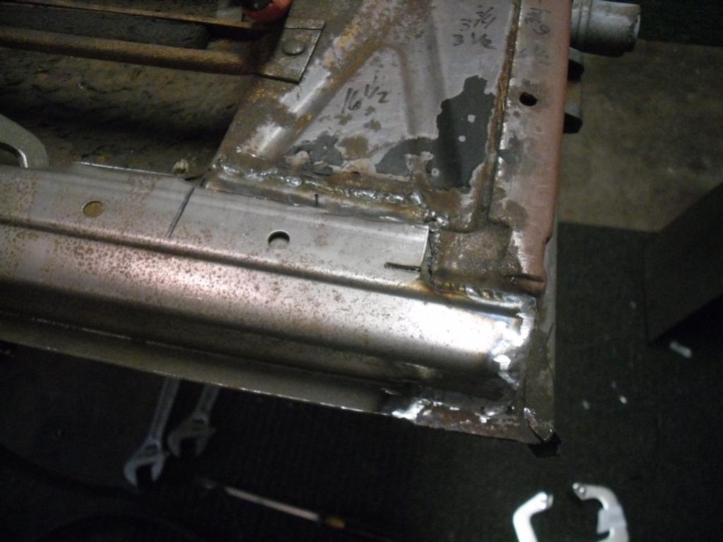

  5. rcnut223
    Joined: Oct 12, 2006
    Posts: 1,282
    rcnut223
    from wisconsin
    Thanks for the words of encouragement. I seem to be taking 1 step forward and 2 steps back.
    I used vinegar on the backing plates for this project, I would not do that again. It eats the base metal as well as the rust.

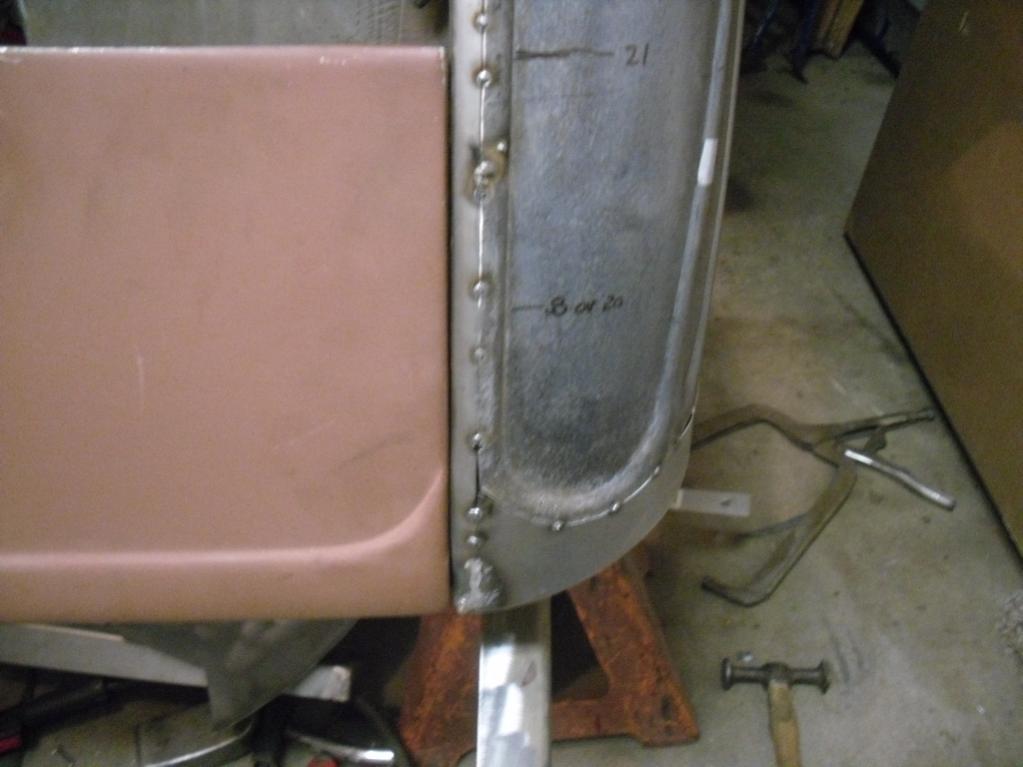

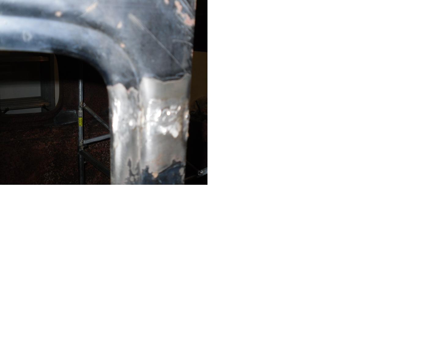

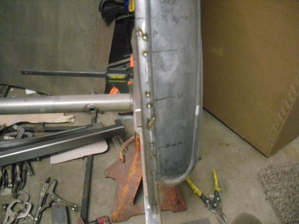

    I have started work on the doors, much to do here.
    The 4dr doors are taller than stock 32 5w doors so they need to be cut down in hieght.
    Once cut they unformtunately don't just fall into place! I heated the front curve witha torch and gently pulled them down.
    The right side worked out a bit better than the left although the process used was the same. On the left the curve inner curve will require a little bondo, the right looks perfect as is.

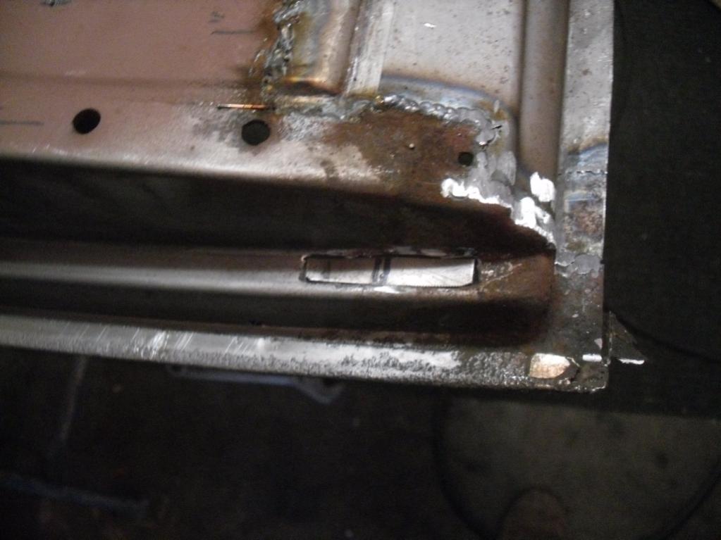

  8. rcnut223
    Posts: 1,282
    rcnut223
    from wisconsin

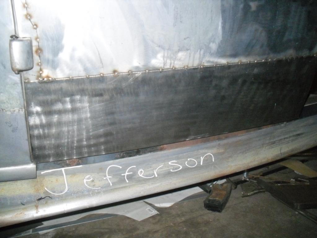

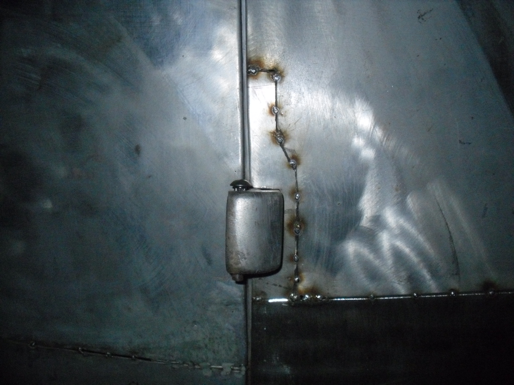

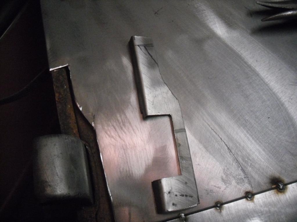

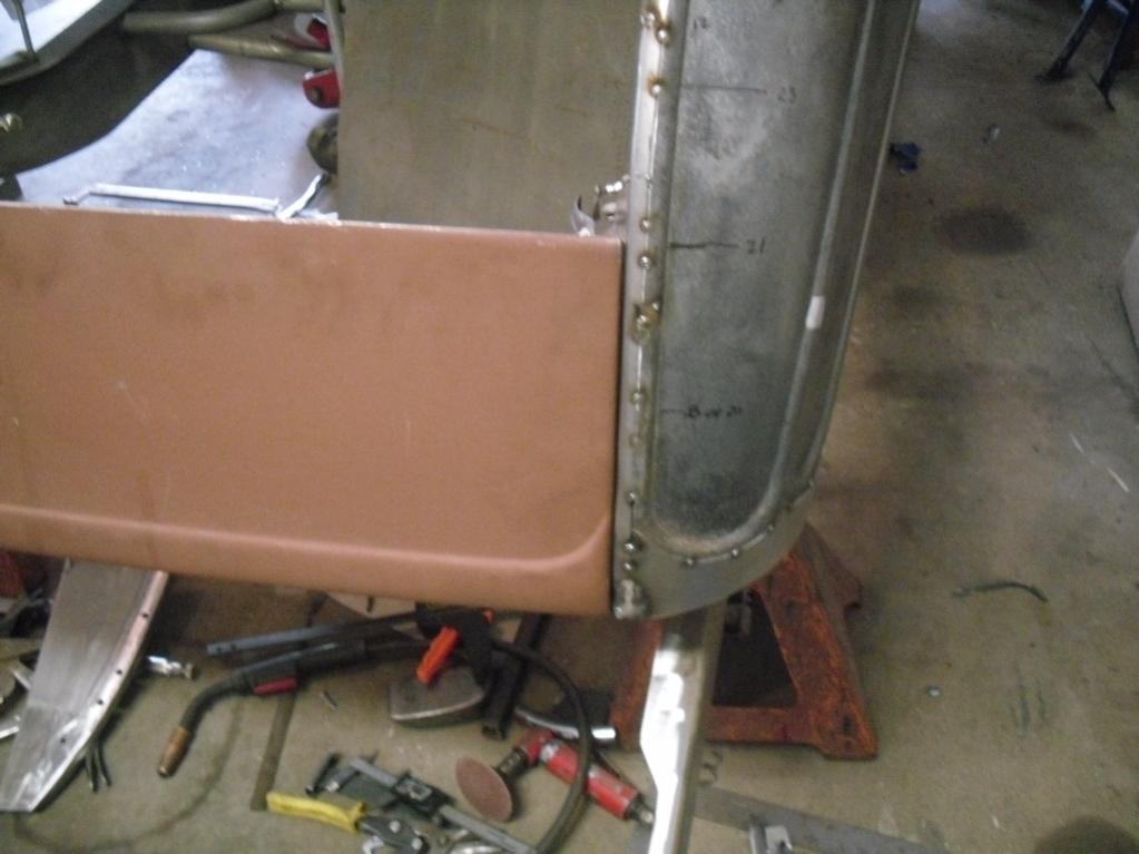

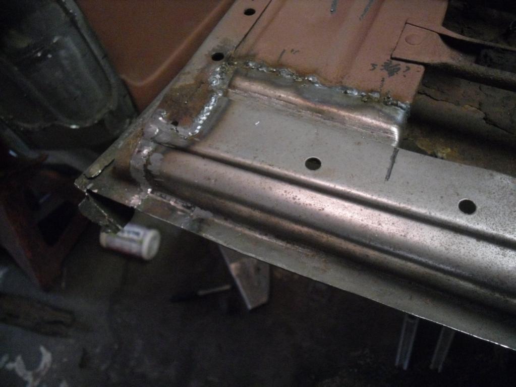

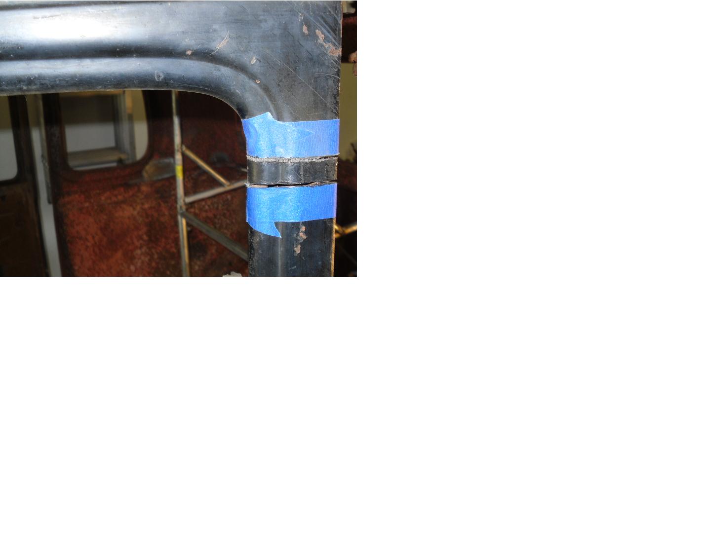

    Lower patch panel was a originally a flat panel and did not fit well. I wheeled it to match the original factory curve and tacked in place. It winds up being 1/4 inch to lonaf as the are forder doors. The ends were rebent to the correct length.
    Mike
  9. fitzee
    Joined: Feb 26, 2003
    Posts: 2,862
    fitzee
    never easy repairing those doors around the hinges..nice work.. love this thread..
  10. F&J
    Joined: Apr 5, 2007
    Posts: 13,291
    F&J
    Mike, very impressive lower door verticle gap in pic one, with door shut all the way. Maybe some readers that don't do this stuff might not know how bad that can get with a major rebuild. Nice.

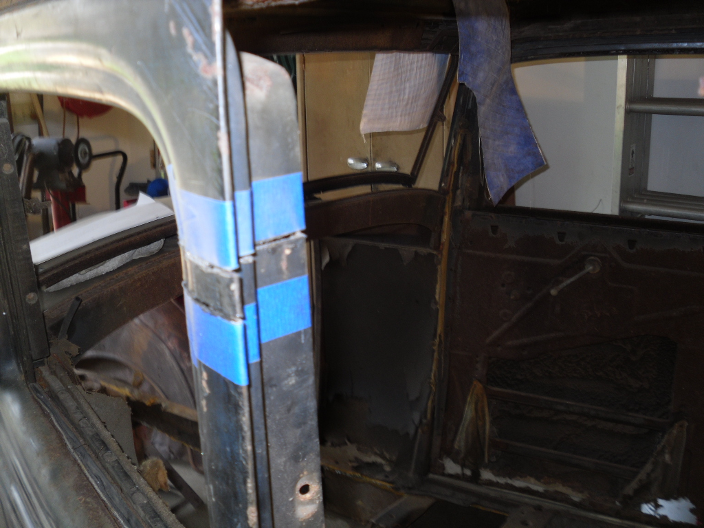

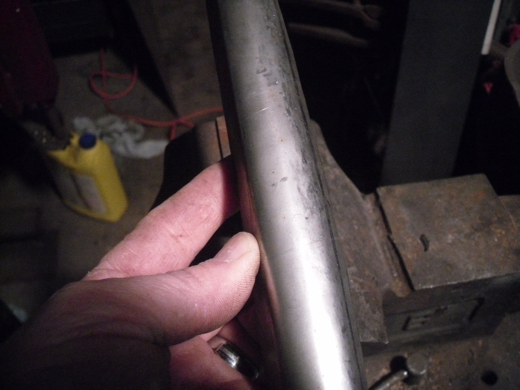

  19. rcnut223
    Posts: 1,282
    rcnut223
    from wisconsin

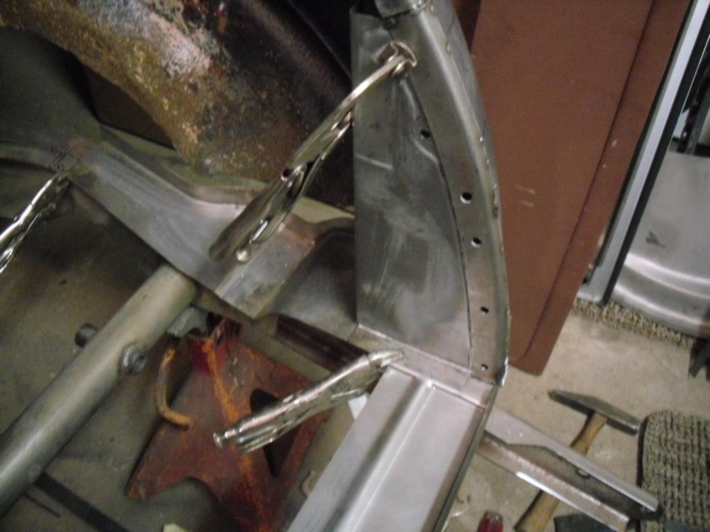

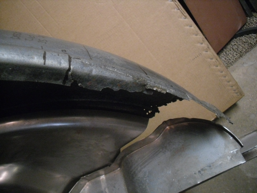

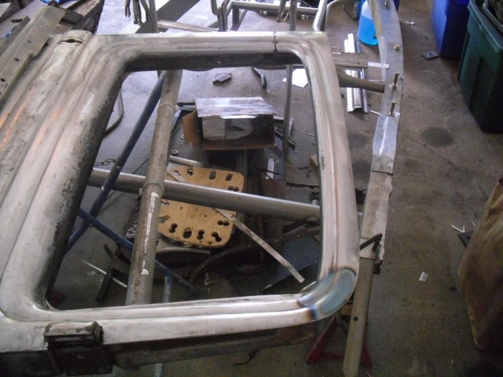

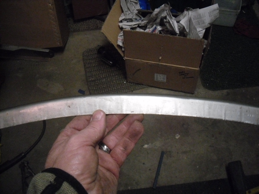

    Ok here's a few more pic's , more on the repair of the rear qtrs. I made a dolly or form that matched the curve on the qtr belt. I did not take a picture (unfortunately) but the piece I started with had a slight break in , perhaps 25-30 degrees. From the break the part curves and here is where i used the dolly. to get the overall curve was made with a shrinker

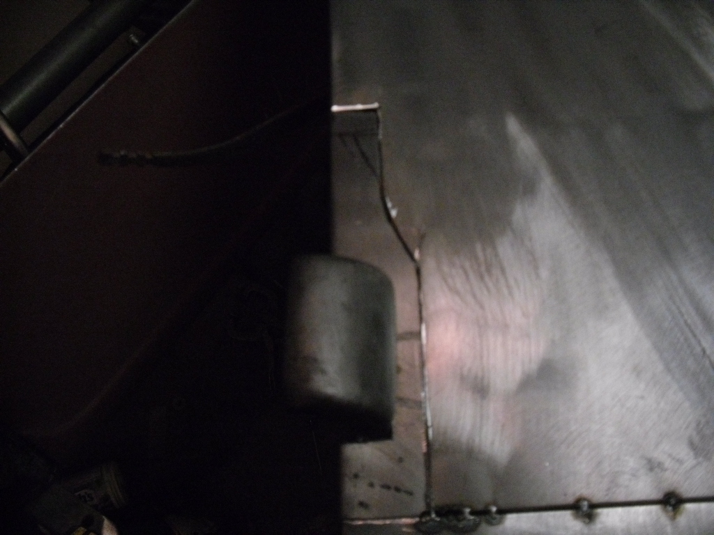

  20. rcnut223
    Posts: 1,282
    rcnut223
    from wisconsin

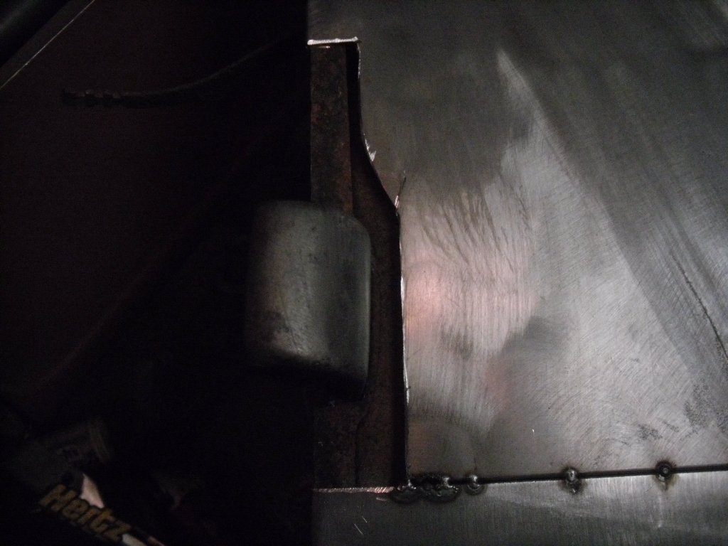

    Made a couple qtr triangle supports. Fortunately I had i an old one to pull a pattern from.
    Used a wood buck as a pattern , the raised section was made with a thin piece of metal cut to size and traced with a corking tool.
  21. F&J
    Joined: Apr 5, 2007
    Posts: 13,291
    F&J
    Wow on that last post. Nice work on the inner corner brace.
