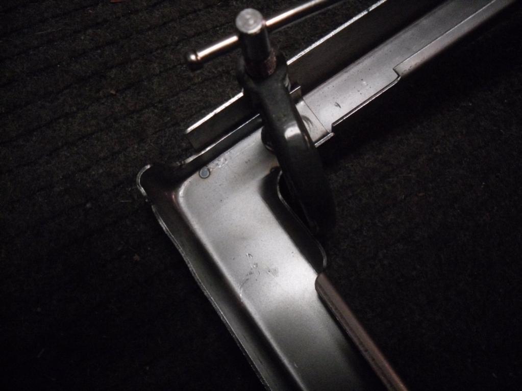

    Posts: 761
    FlynBrian
    Nice work on the corner braces!

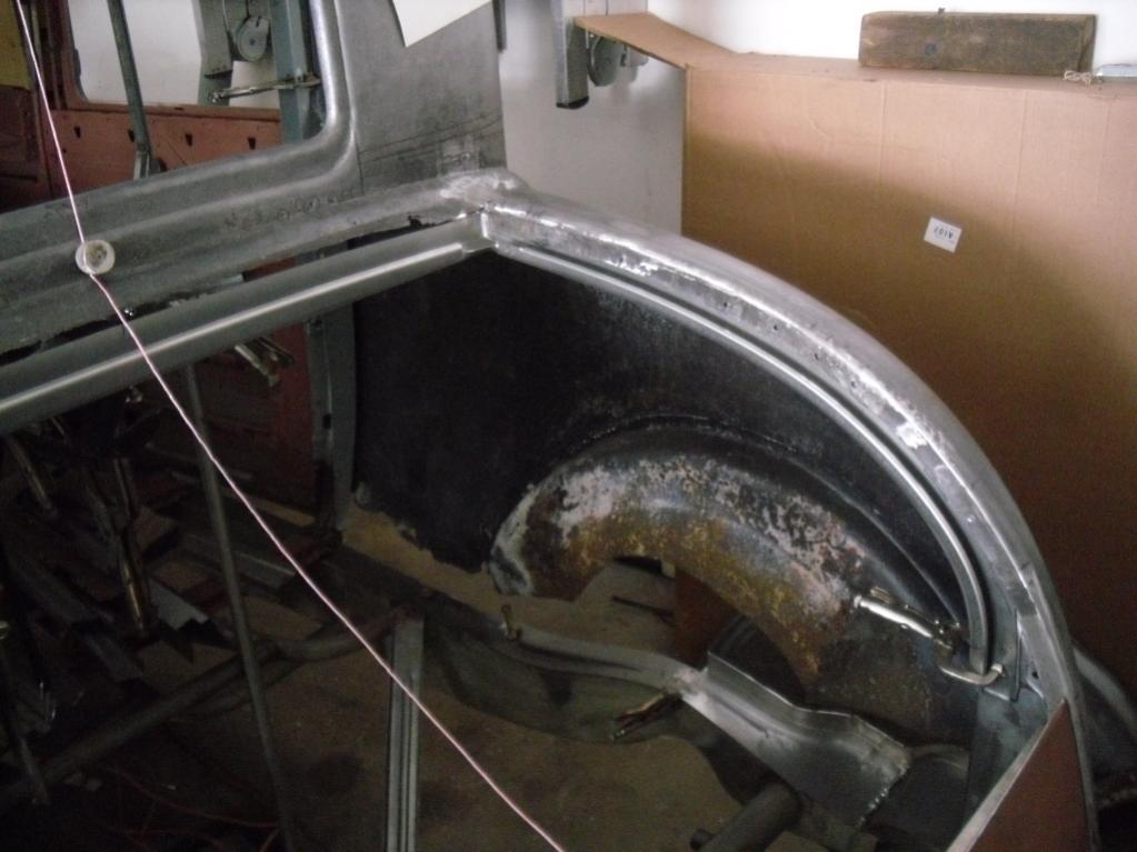

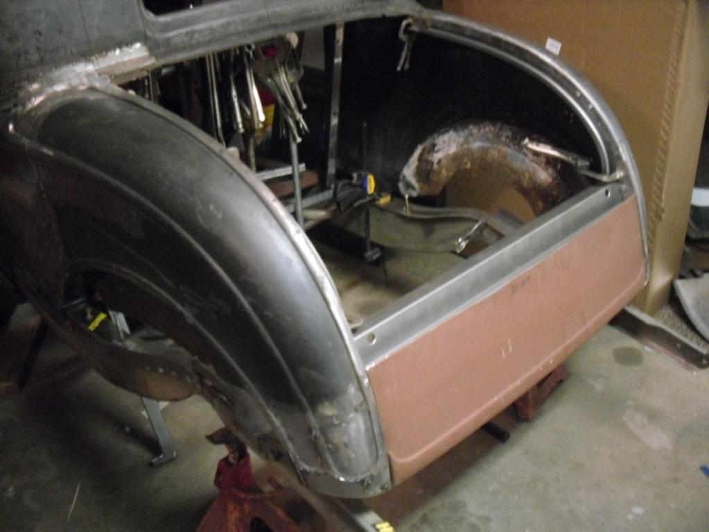

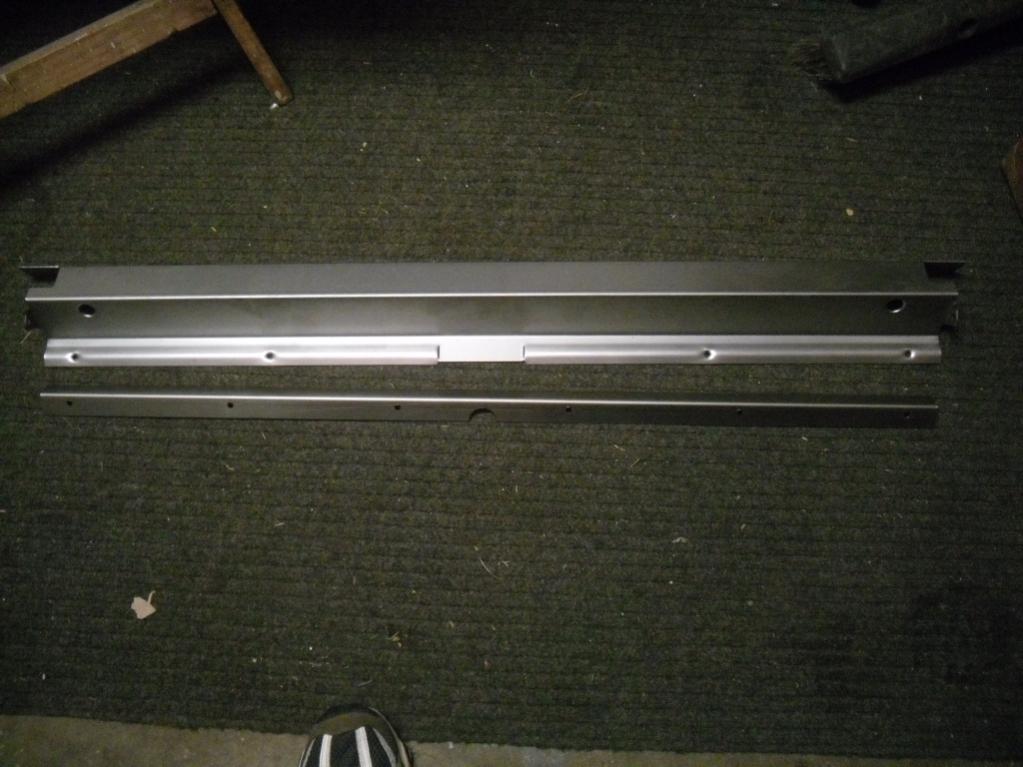

    One of the ways I am trying to control the gaps on the rear qtr panels is with a gutter set from Brookville.
  12. rcnut223
    Joined: Oct 12, 2006
    Posts: 1,282
    rcnut223
    from wisconsin

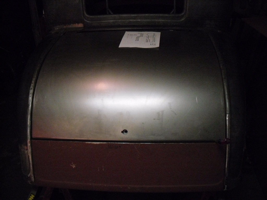

    I also purchased a lower gutter panel and decklid from Brookville.
    The Brookville lwr gutter panel is wider than the below decklid panel I bought from Tom Bay. As a result this was not a bolt tegether afair. I modified the brookville panel by shortening it.
    Here's the first peak at the fit...

    Impressive work...how do you like the decklid?
  15. rcnut223
    Posts: 1,282
    rcnut223
    from wisconsin
    Decklid is very impressive! Quality is absolutley amazing.

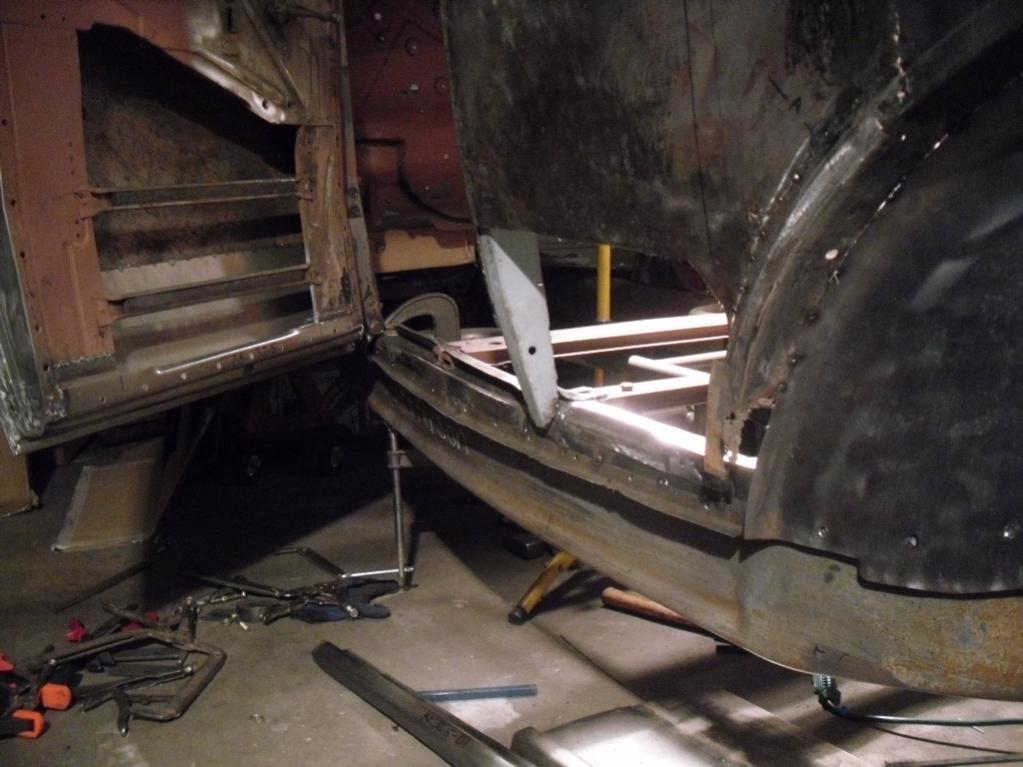

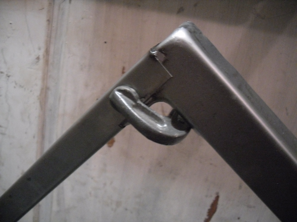

    A small upadate... Here is how I am dealing with the door post to subrail.
    I was relucant to just weld the posts to the rails and was after something a little stronger.
    I will go into a little more detail latter, needed to be able to pull the body off.

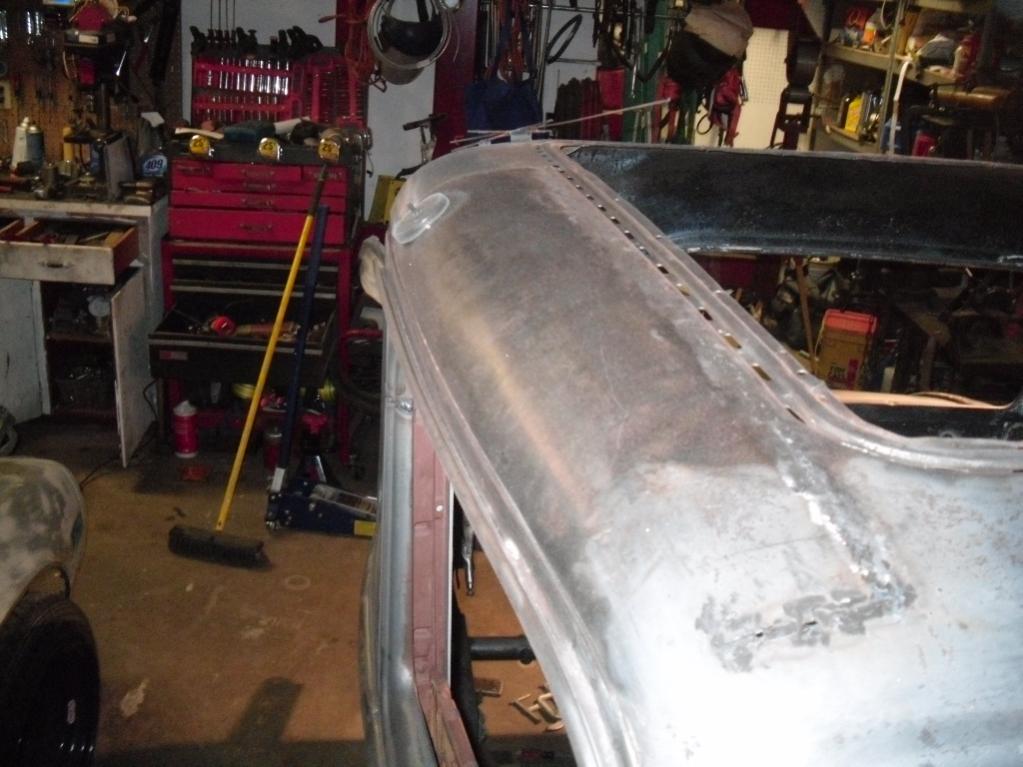

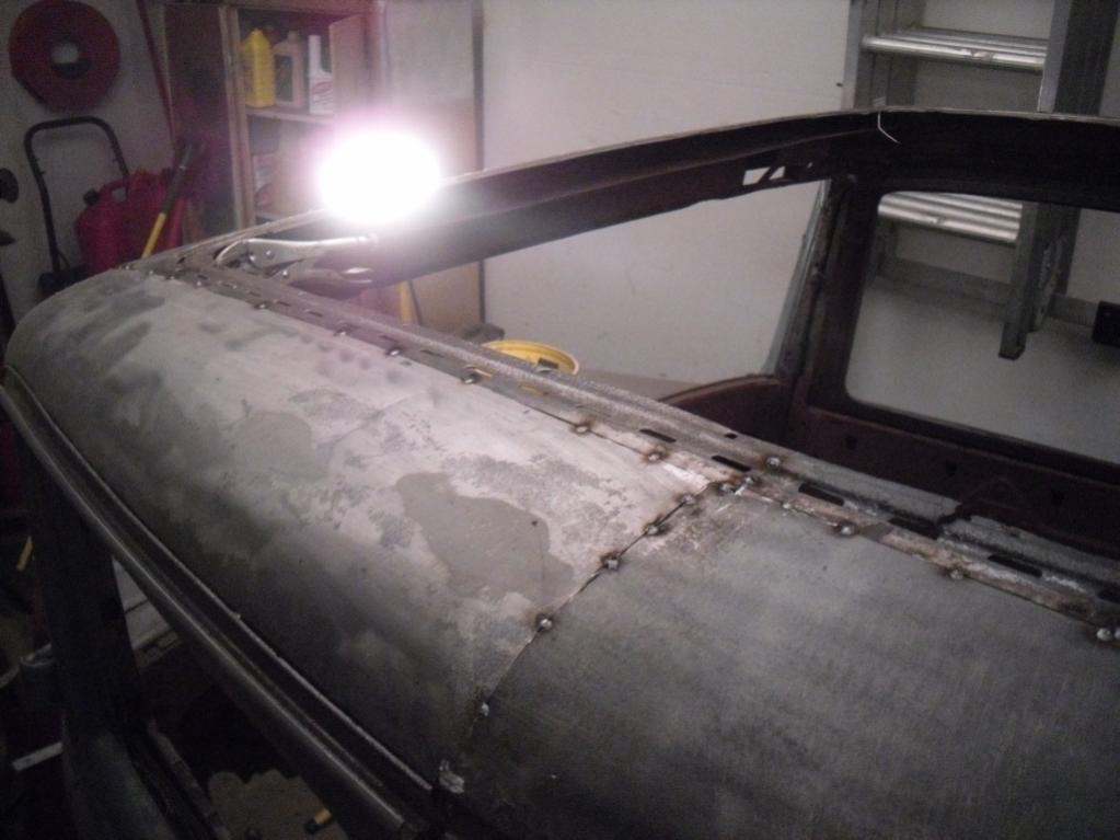

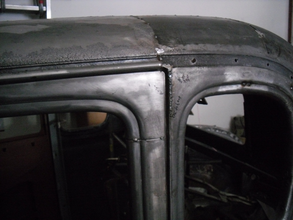

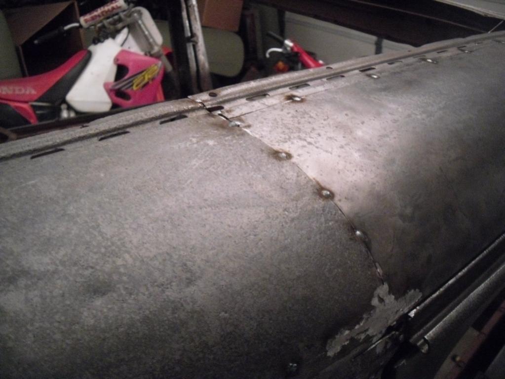

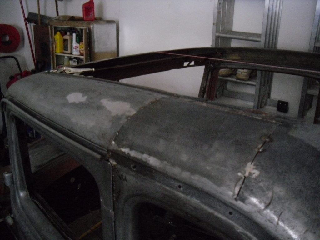

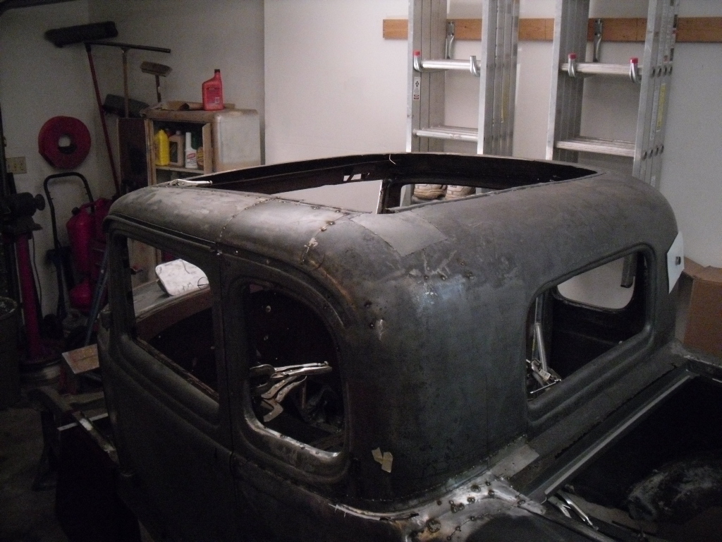

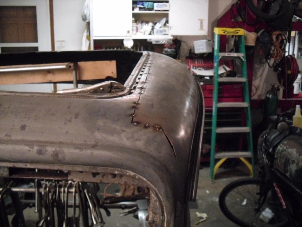

    As part of the post install I made the connection between the fordor front and back half of the coupe body. The fordor is approximately 3/4 wider at the post than a coupe.
    This required a pie cut the length of the roof above the door. Tig welding the length of the roof, given my lack of experience resulted in quite a bit of metal work but the results were acceptable.
    The right rear of the roof is low in the pictures and will not hold it's shape, I need to work this a little but everything is square and a slight amount of upper pressure from underneath and it looks good.
    Mike
  22. rcnut223
    Posts: 1,282
    rcnut223
    from wisconsin
    Here's the right side welded up.

    Rcnut when I started on my roof it had been welded on beat and ripped I took my top wood and ***embled on the ground and put in the opening and put light preasure on it with a monkey jack and it helped to line it all up and pre load the panels while I straightened them looking good !!

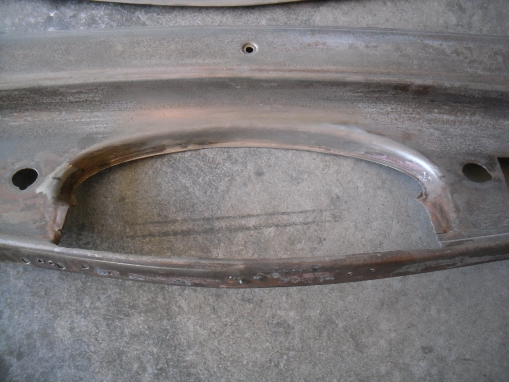

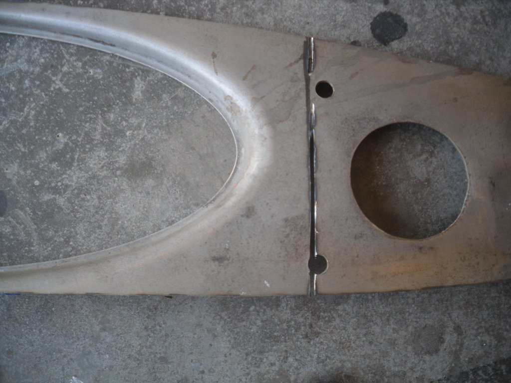

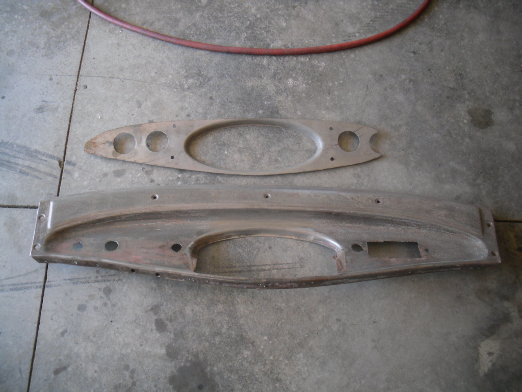

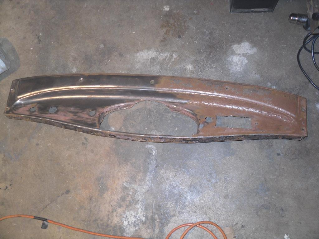

    Another Update: Spent a few hours in the shop yesterday working on the dash, pretty hot!!
    Here's a few shots of the dash before I installed a new gauge insert. Someone had hacked up the lower and upper portion of the gauge hole. I intintially fixed the upper cut wiht the intentions of making the bottom portion as well.
    Fortunately I found a new opeing for 25bucks on ebay!
  30. rcnut223
    Posts: 1,282
    rcnut223
    from wisconsin

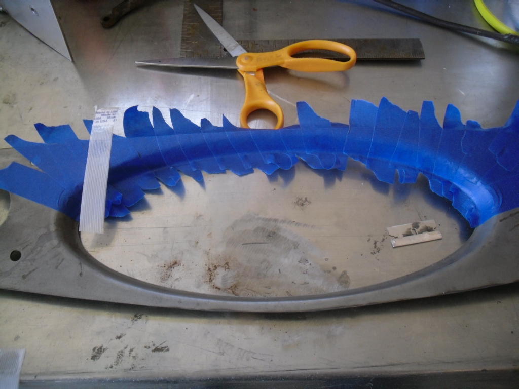

    To start I made a flexible pattern of the upper portion, this was to give something to help cut both pieces the same. Should have spent more time on my end cuts on the pattern, as I did not get it as square as I thought.
