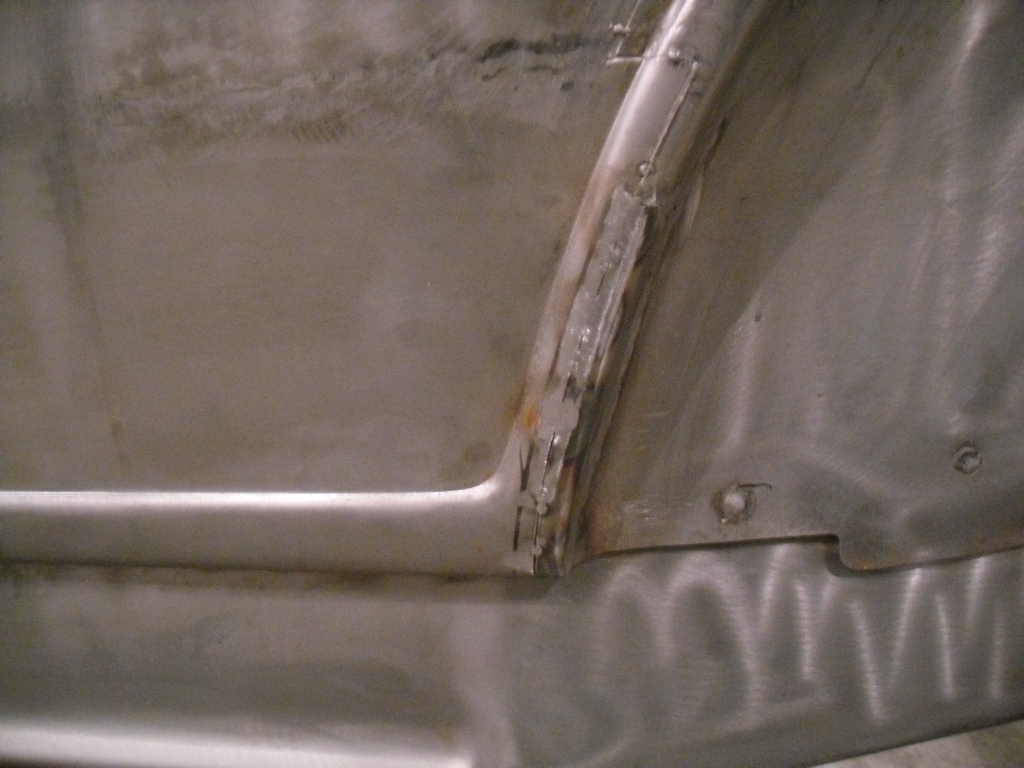

  3. rcnut223
    Joined: Oct 12, 2006
    Posts: 1,282
    rcnut223
    from wisconsin

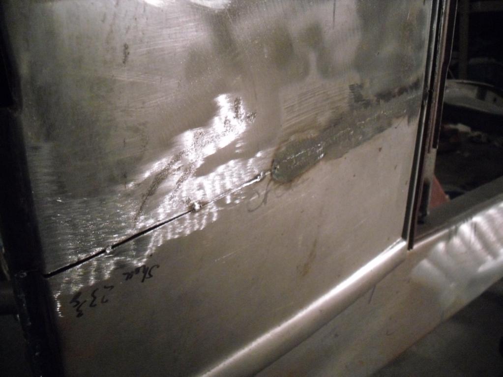

    Finishing up my patches on the qtrs.

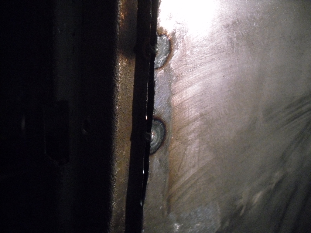

  4. rcnut223
    Posts: 1,282
    rcnut223
    from wisconsin

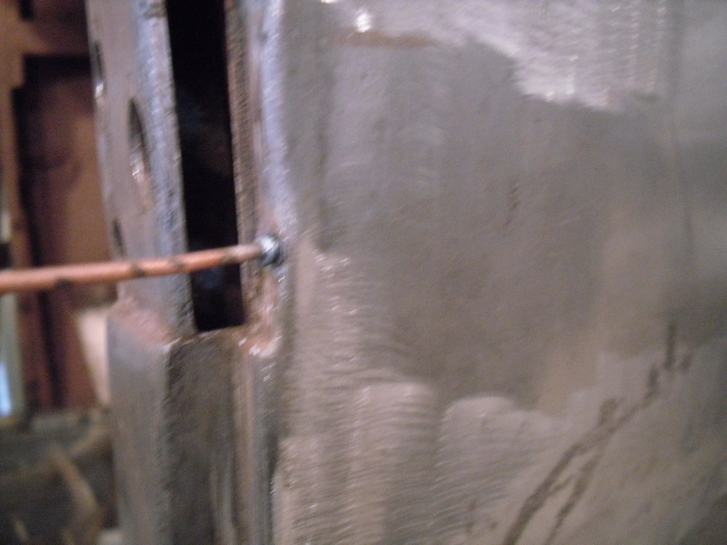

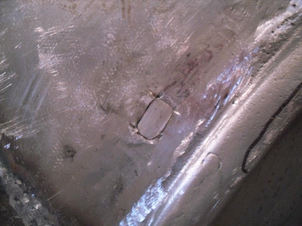

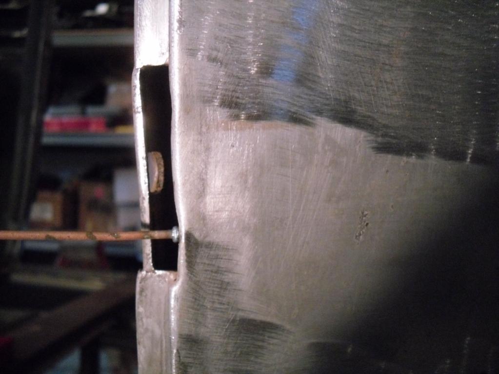

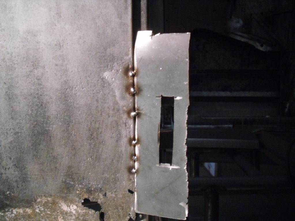

    Don't think I posted this earlier but I had some issues with one qtr and the cowl area around hinge opening. I made a flat panel with a hole and used a slide hammer on the qtr.
    On the cowl a copper pin and slide hammer made to pull these.

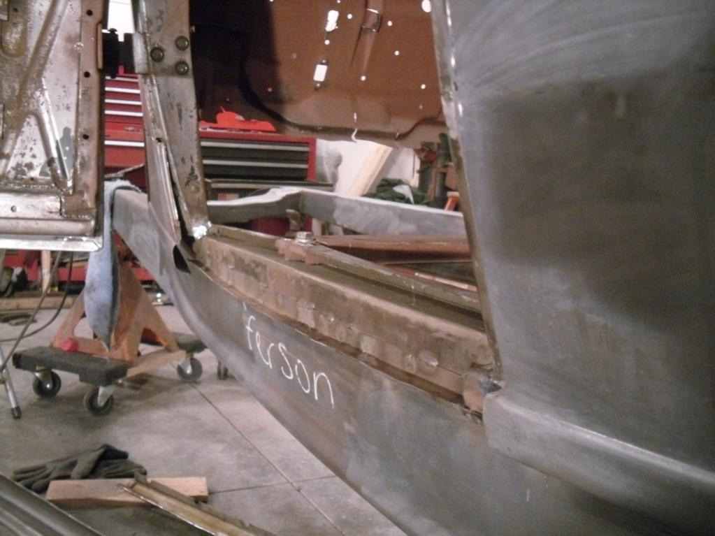

  5. rcnut223
    Posts: 1,282
    rcnut223
    from wisconsin

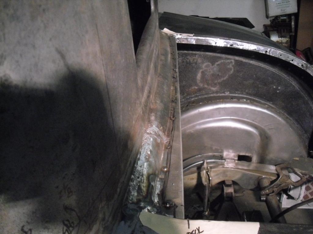

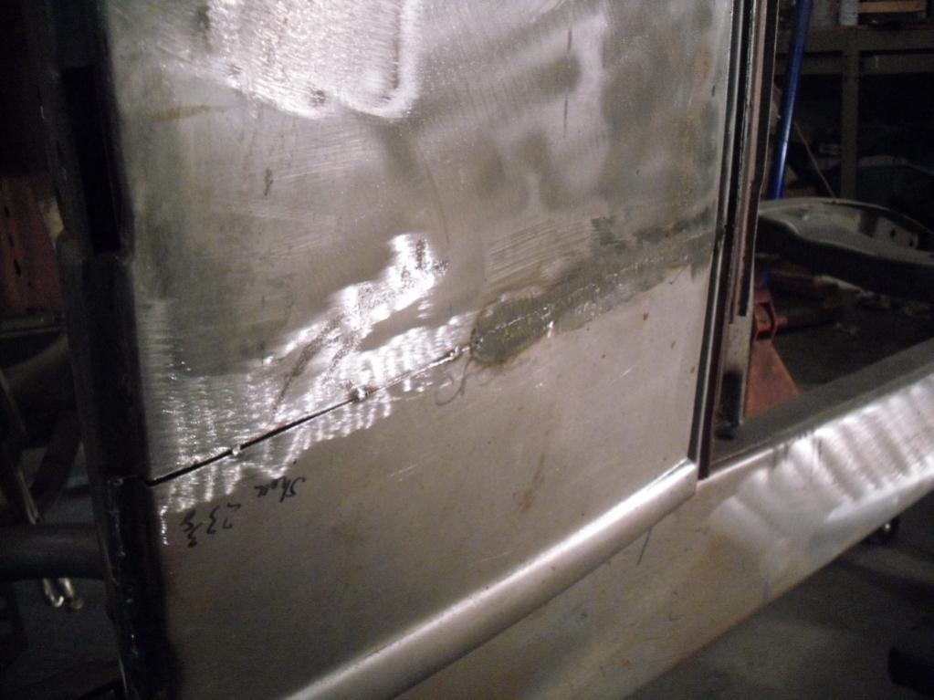

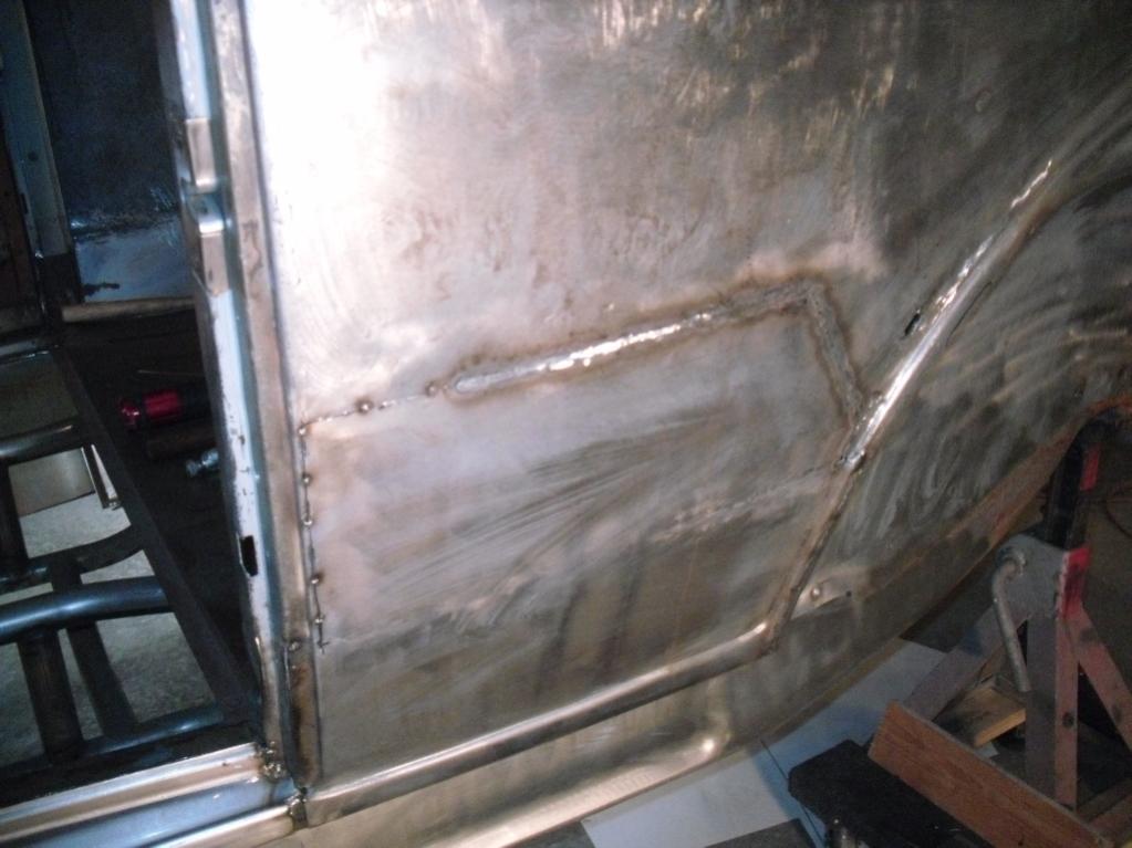

    Welding up the qtr in the next few pic's
    I welded up the sill panel below the door and I either misaligned it or it moved after I set it. I pulled the door to weld the panel and then put the door back on and not happy with the gap.
    I will be cutting it off a ordering a new panel.

  12. rcnut223
    Posts: 1,282
    rcnut223
    from wisconsin

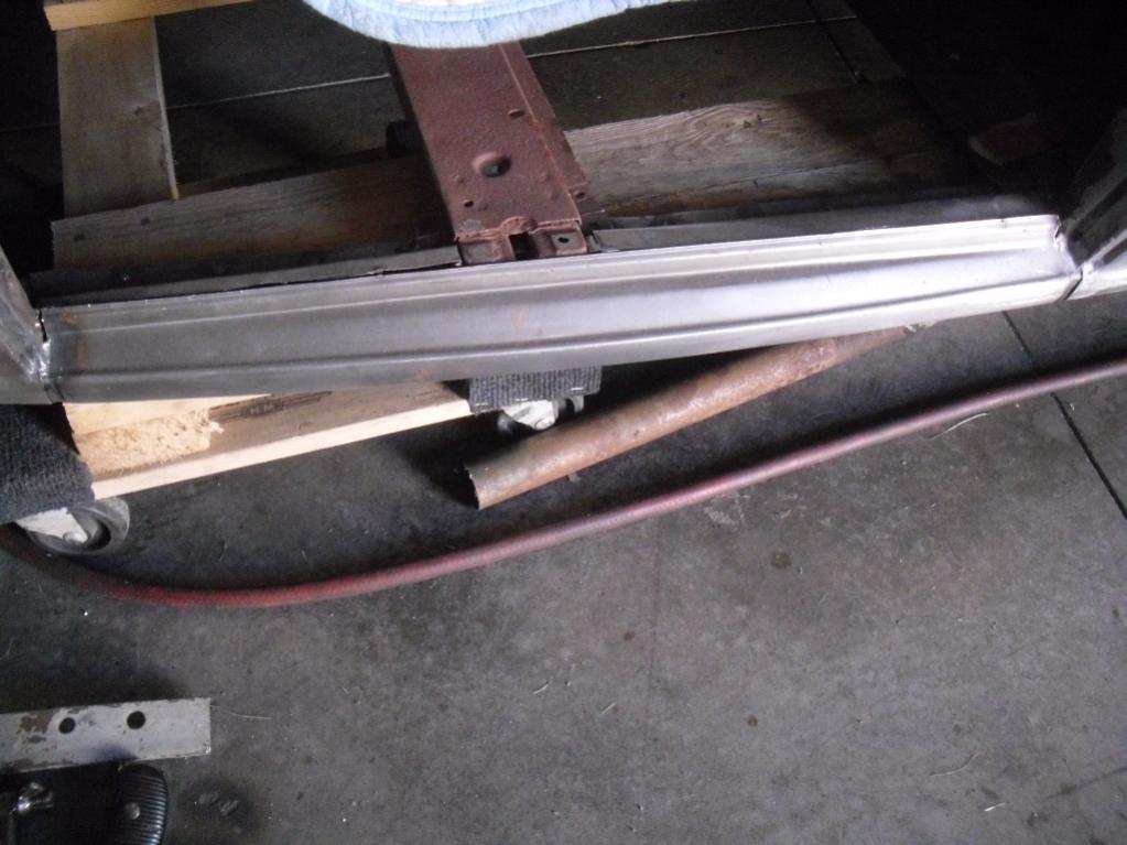

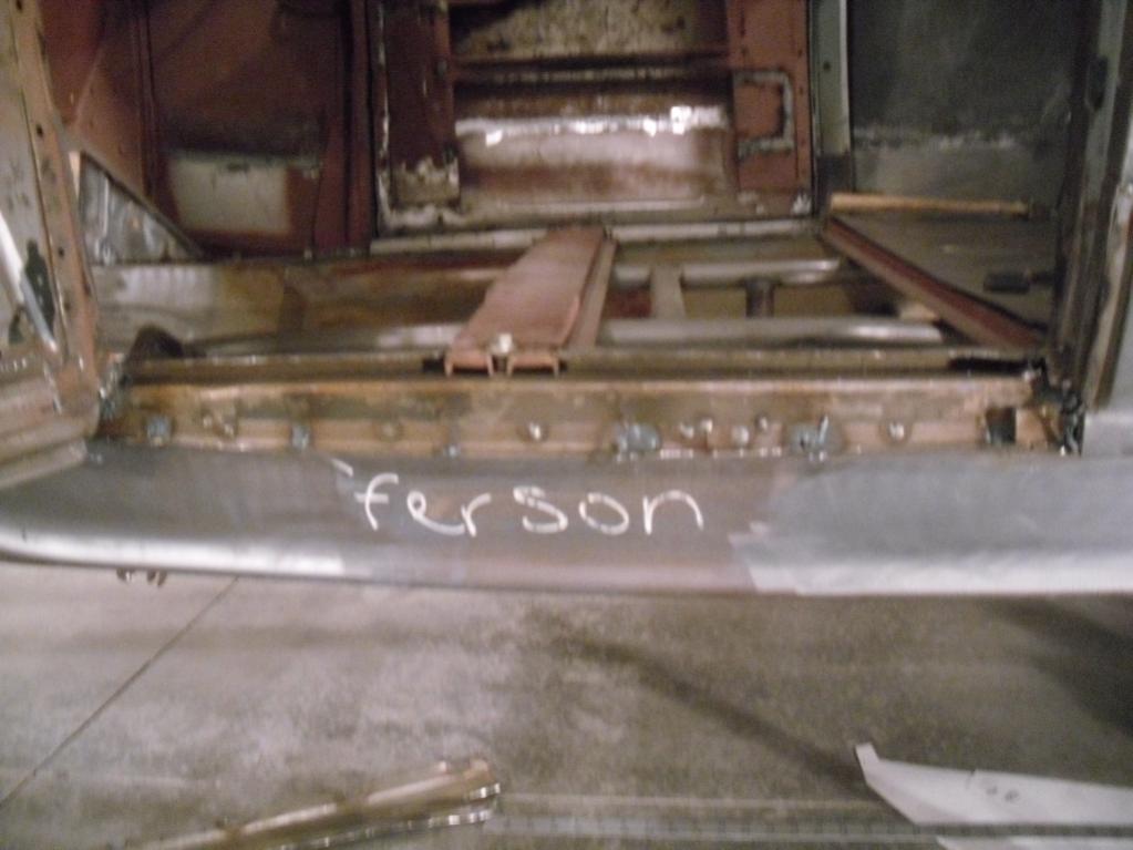

    Here the replacement of the door sill welded in incorrctly,You can see the sill be for I cut it back out, and in the other shots see it on the floor.

  13. rcnut223
    Posts: 1,282
    rcnut223
    from wisconsin
    this is a shot of the cowl patch being welded up.

  16. rcnut223
    Posts: 1,282
    rcnut223
    from wisconsin

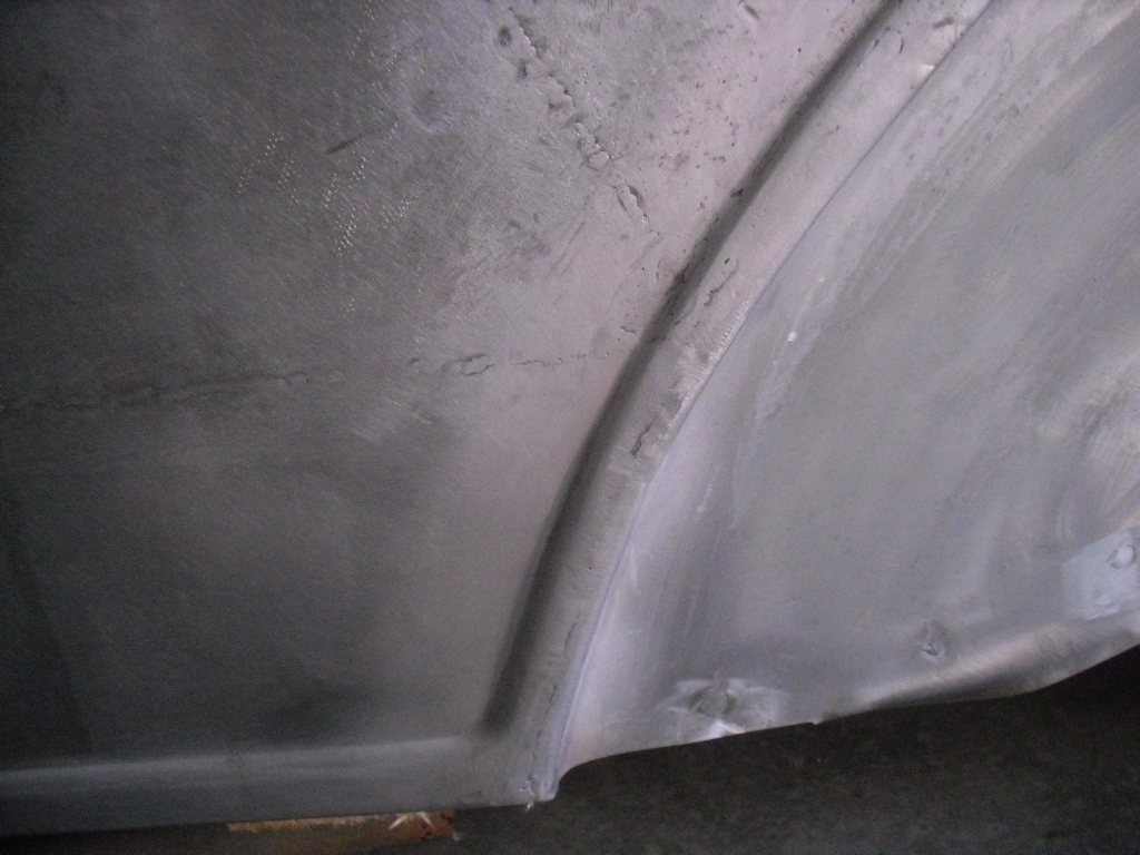

    Worked the welds on the qtr patch and seam. Also got the sill welded back in.

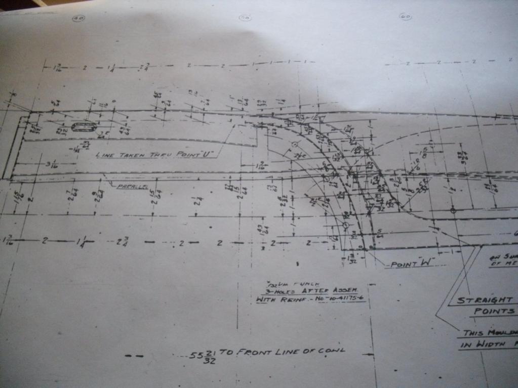

    Mike,
    In post #85 you said you got some Factory 32 quarter panel prints from "Kiwi Connection", can you elaborate? Was looking for some prints/drawing for 30 to 32 Tudor.
    Thanks in advance
    BillB

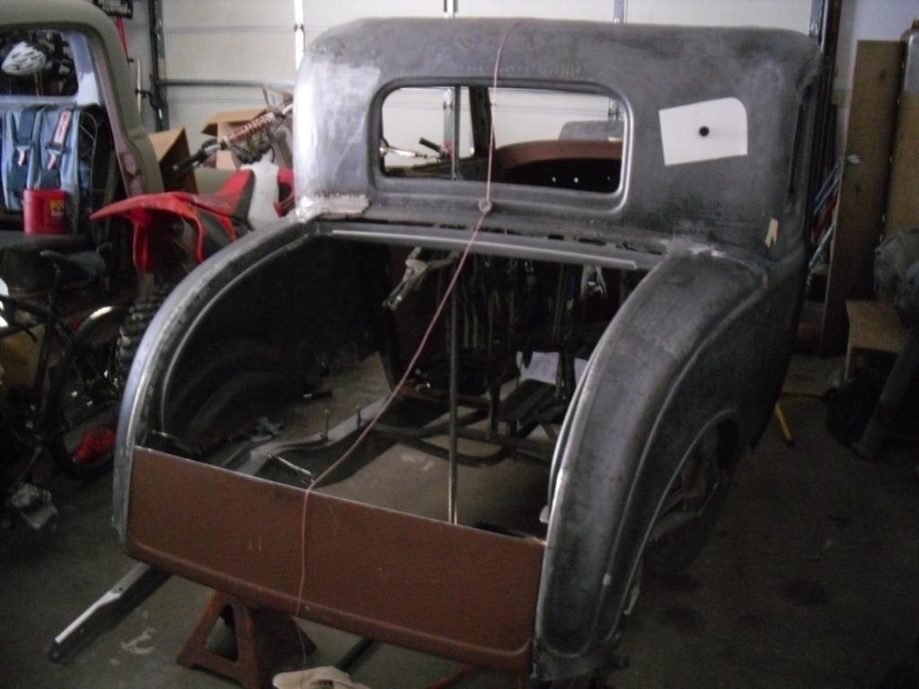

  21. rcnut223
    Posts: 1,282
    rcnut223
    from wisconsin

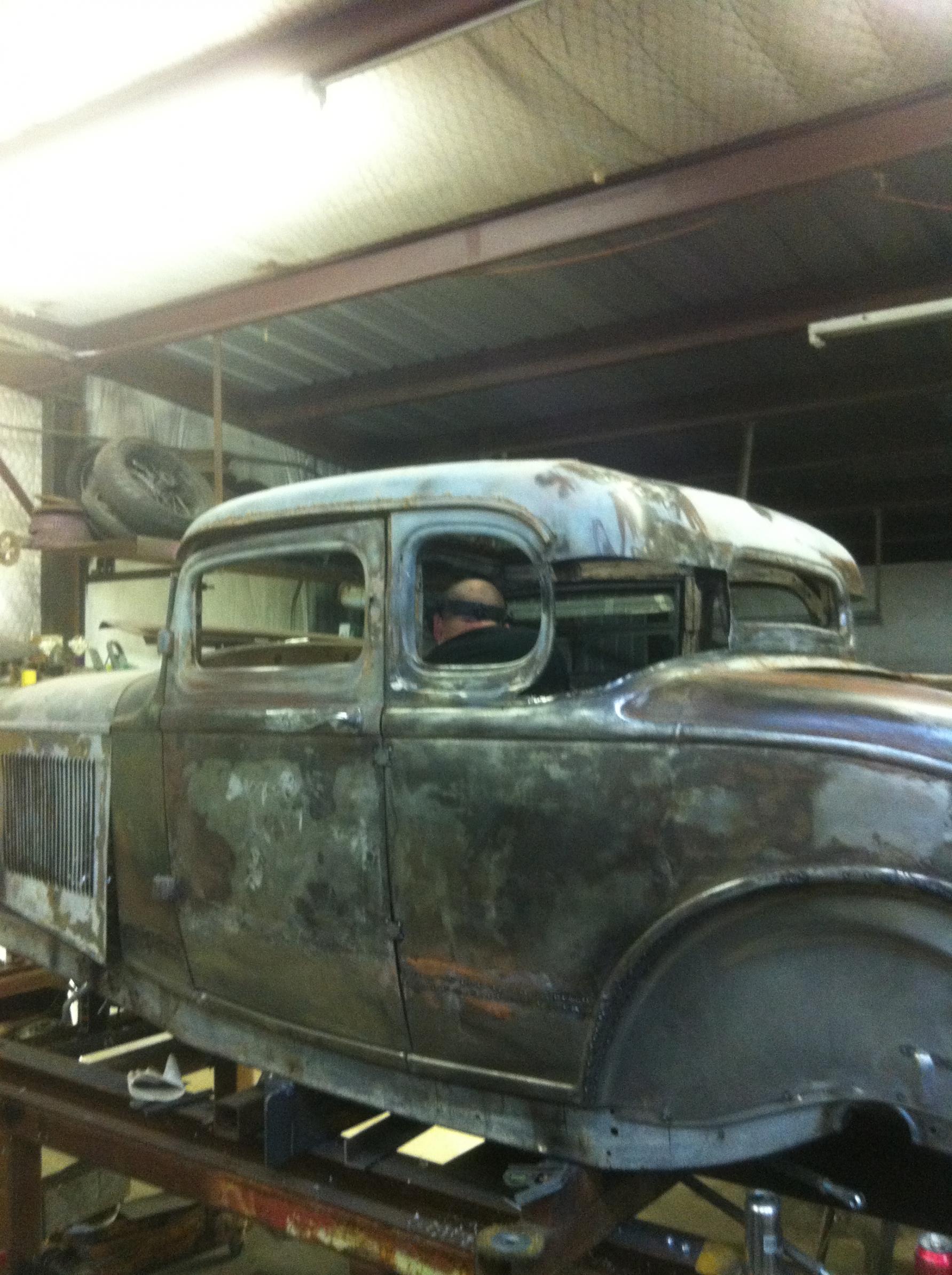

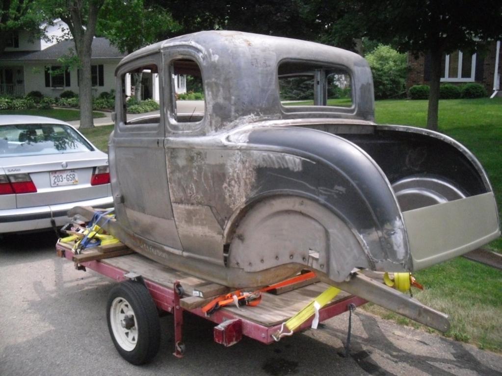

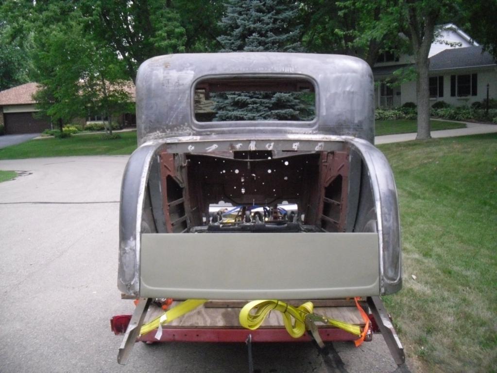

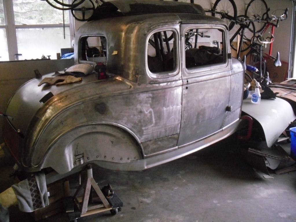

    As requested here is a shot from a distance. It's first time outside as a 5 window!!

    As you can see these were taken before I finished the qtr to it's current state.
  23. rcnut223
    Posts: 1,282
    rcnut223
    from wisconsin
    Kiwi is out of California. The print is a half scale 32 ford raodster qtr. These are factory drawings, not something homemade.
    Note that I did find some measurement errors when converting this to full scale. They are on the belt line curve and did not affect what I was after.Might be why the drawing exisits?
    Also note that the right and left qtr on my car are not exactly the same either, guessing the clay model that was made had slight differences. Without patterns their is no way you can see these with the naked eye.
  24. The37Kid
    Joined: Apr 30, 2004
    Posts: 32,539
    The37Kid
    That really looks nice outside! I know it really doesn't matter but how many hours do you think you have into the body save? Bob [​IMG]

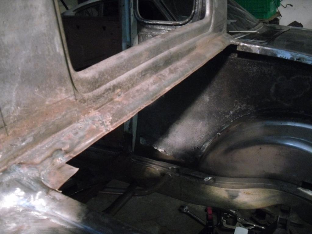

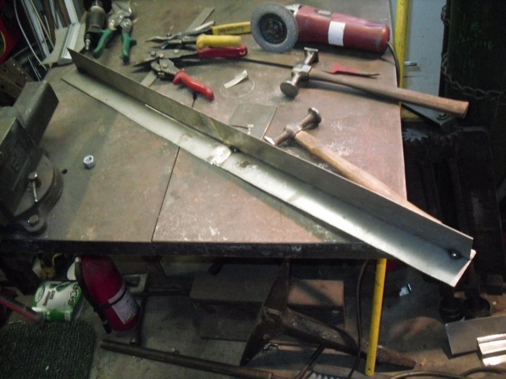

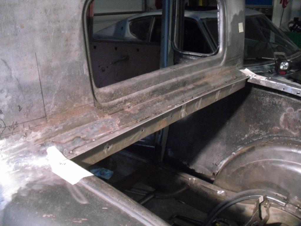

    One of the more challenging areas to repair was the upper panel between the front edge ofthe deck lid and belt line.
    first picture shows the gutters inplace to get a feel for what I need to make.
    This panel has 2 slight curves that matches the front edge and top of the decklid.
    It als has bends that allow it to hold the gutter. Fun!
    My brake is only 3ft long so I had to make this in 2 pieces and weld it the center together.
    The entire part is made from 3 , the top and inner lip. see picture 3.
    Thier are not any pictures of this but as decklid algnment took place this thing was cut back out 3 times.
