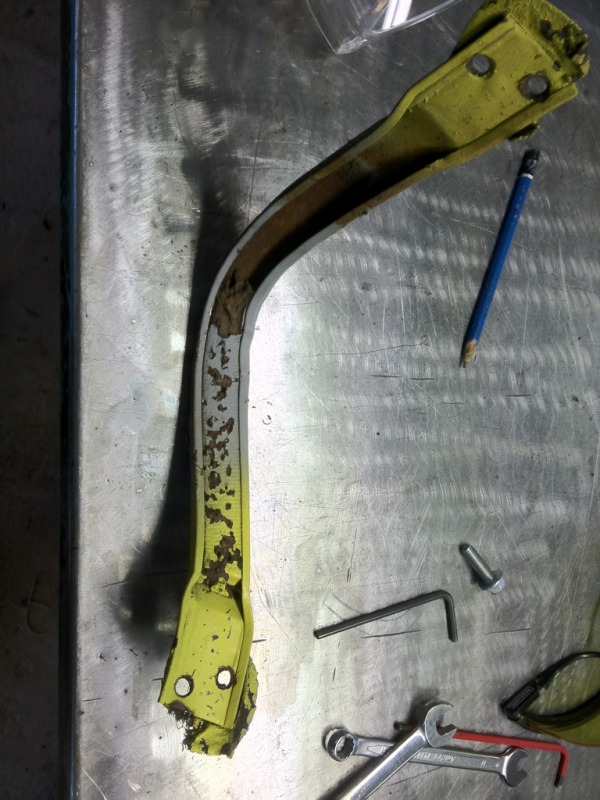

    I getting ready to install some of the interior wood and need some help.
    I don't any of the brackets, like that between the roof wood and header, the quarter window and floor and the corner upholstery bracket.These are shots I have found on the net.
    Anyone have patterns or extras?

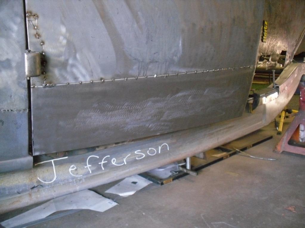

    Welded up the door patches. I wanted to finish these as best I could so I cut the inside to gain access for my dollies.

    Good job on the door! ****, no room for filler on that seam!!!

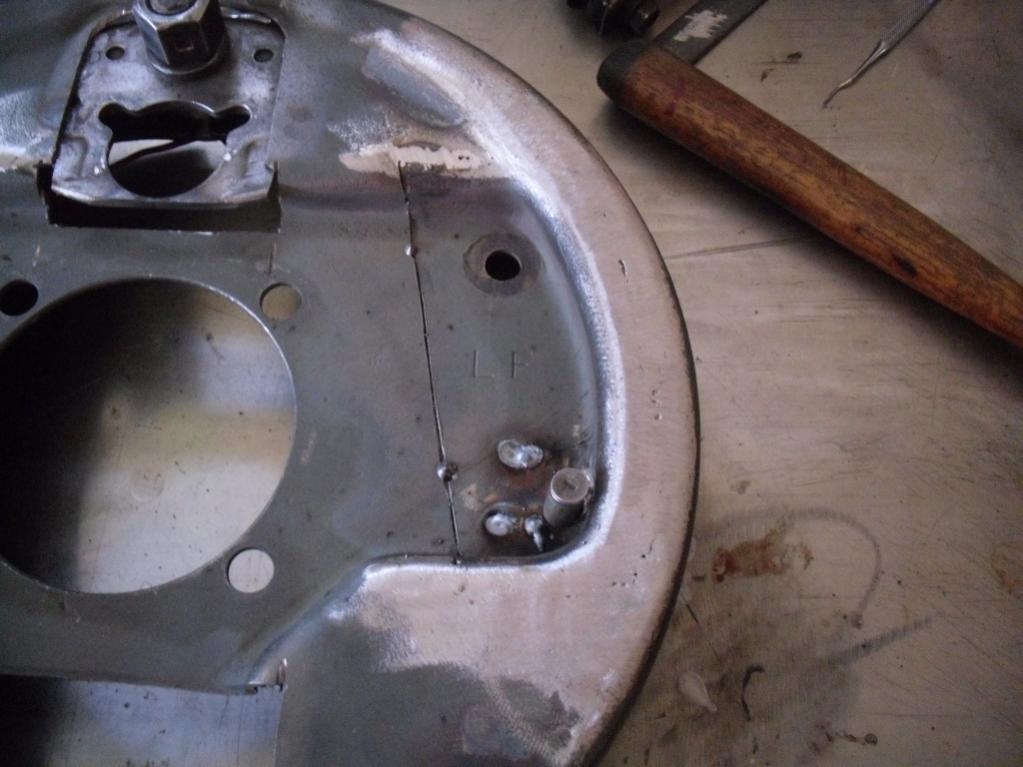

    On the backing plates, I adapted the complete 64 Buick brakes that came with a set of the drums to the 40 ford backing plates. I originally bought some repop 39 backing plates but decided against that because I wanted the look of the 40 ford.
    The 64 buick shoes are 2 1/4 needed to modify the plates to get every thing to fit. I've got 4 days , actually two weekends in these so far.

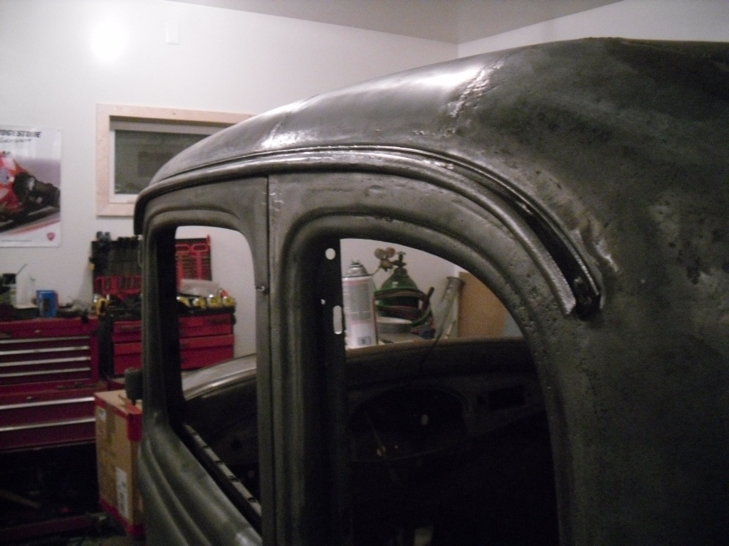

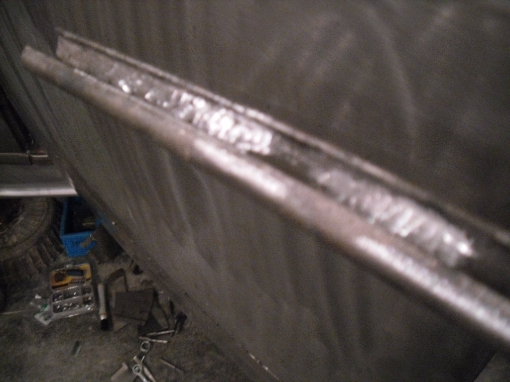

    With the front and rear halves of the body welded together I still needed to fix the drip rail and upper door opening.
    Here's the upper door opening repair
  16. rcnut223
    Joined: Oct 12, 2006
    Posts: 1,282
    rcnut223
    from wisconsin

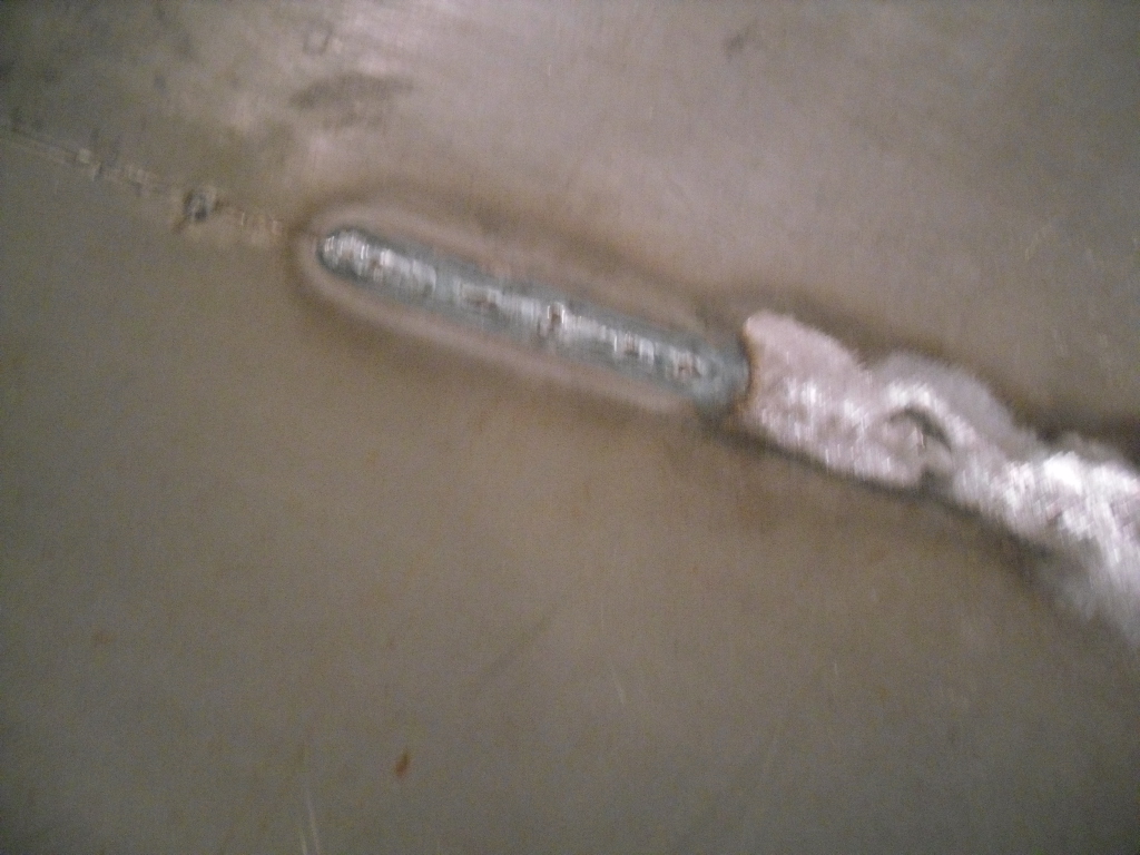

    The drip rails I have a a mess... I tig'ed the holes using copper as a backing material...
    Then carefully ground down the weld
  17. rcnut223
    Posts: 1,282
    rcnut223
    from wisconsin
    Here are the rails welded on the car...lot's of hour tweeking the alignment of these inorder to get the fordor curve and the coupe rails curve to look right...

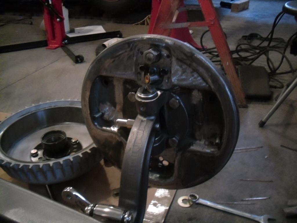

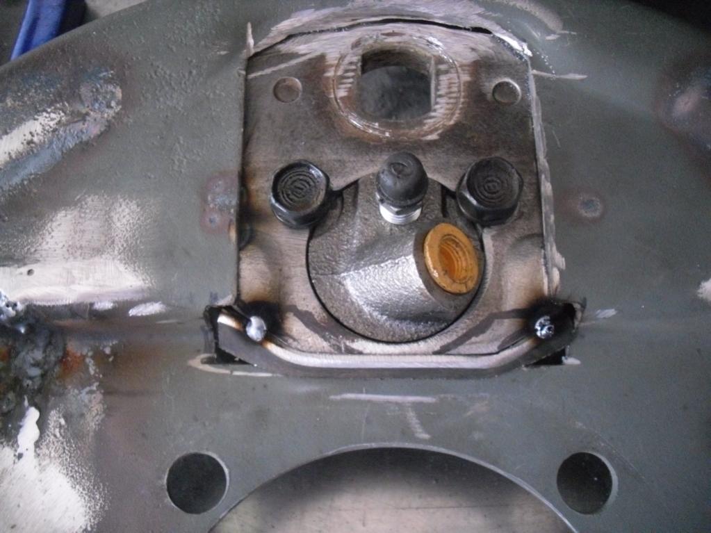

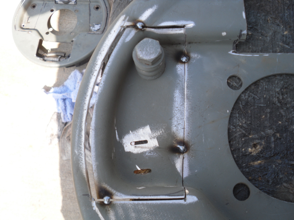

    I have had a few questions about the brake components used with the Buick Drums as well as the process.
    There are several members that have accomplished this by using mid seventies Chevrolet wagon innards. These are 12 x 2 brakes.
    <O:p</O:p
    The hardware i used came from a 58 Buick, and the backing plates to be converted were 40 Ford .
    I had a complete set of brakes and hardware for the 58 including the backing plates. These big cars used 12 1/4 brake shoes, and cylinders and replacement shoes are readily available and cheap.
    Converting this is a trial by error proposition. The key measurements are
    The Pivot location ; relative to the outer edge of the backing plate and it's depth to the face of the plate.
    </O:p
    I cut the actual mounting surface from Buick plate for the pin and cylinder. This gave me the one less variable to deal with, the cylinder to pin location. <O:p></O:p>

    The 40 Ford plates were disected in the middle enough for to allow for clearence for the 58 shoes, only need 3/16 of an inch or so.
    The lower middle area, the pocket that serves as the location of the pivot bolts on the 40 Ford plates represented more of a challenge. The plates did not give room for adjuster wheel and spring as well as the hole for the adjustment .
    I certianly could have made this easier in retrospect.

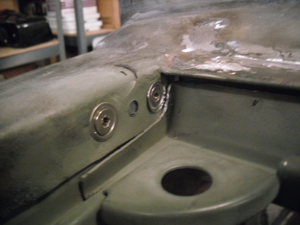

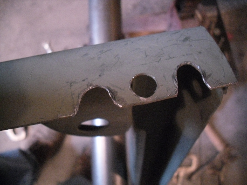

    One of the area's that still needed attention was the deck lid hinge. I wanted stock type hinges.
    I was able to take some measurements off a brookville roadster that useed a stock typw hine. This gave me a idea for the pin location.
    Here is the corner of the quarter on the left side with the old metal cut out and then a shot with the new plate and holes welded in.
    locait
    Nailhead A-V8 and mgtstumpy like this.

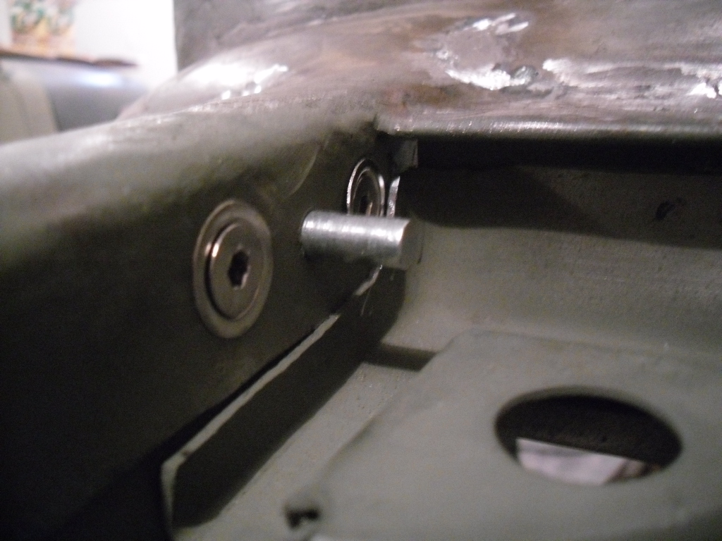

  24. rcnut223
    Posts: 1,282
    rcnut223
    from wisconsin
    Here's a couple shots of the process. The hinge kit was purchased form Mac's and I made stainless fasteners from washers bought a Menards.
    I had to trim the washers, they were a finishing washer with a ridge.
    The bolts needed work as well the counter sunk portion.

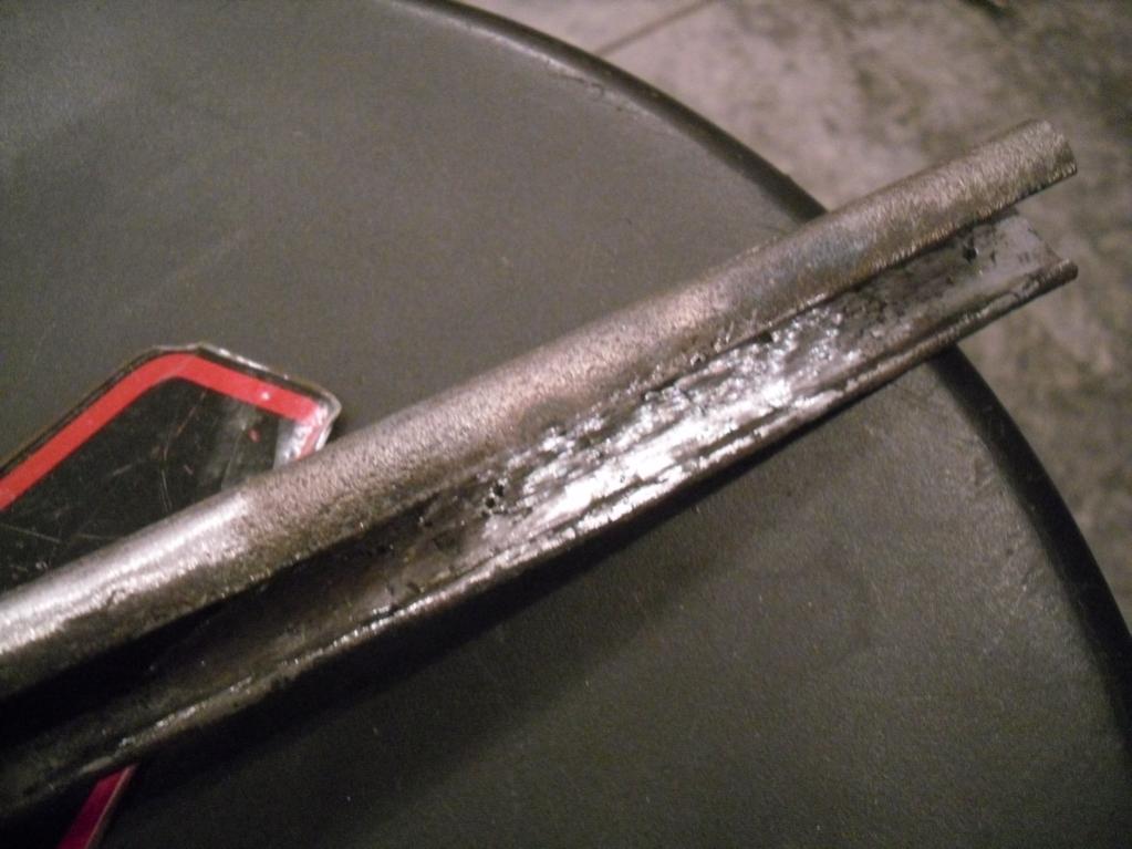

    The drip rail needed trimmed. Here's a shot

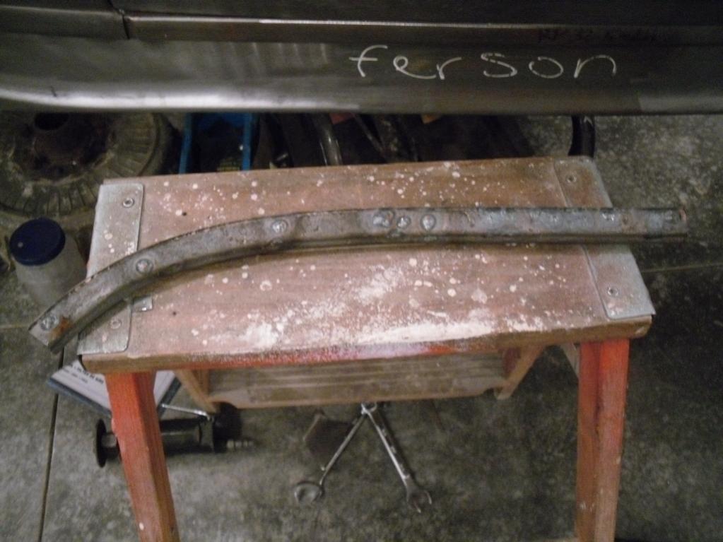

  26. rcnut223
    Posts: 1,282
    rcnut223
    from wisconsin
    Once togehter here's what it looks like

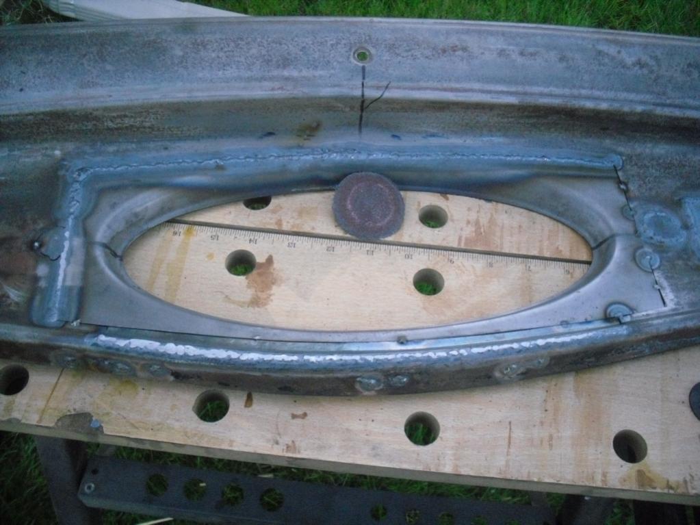

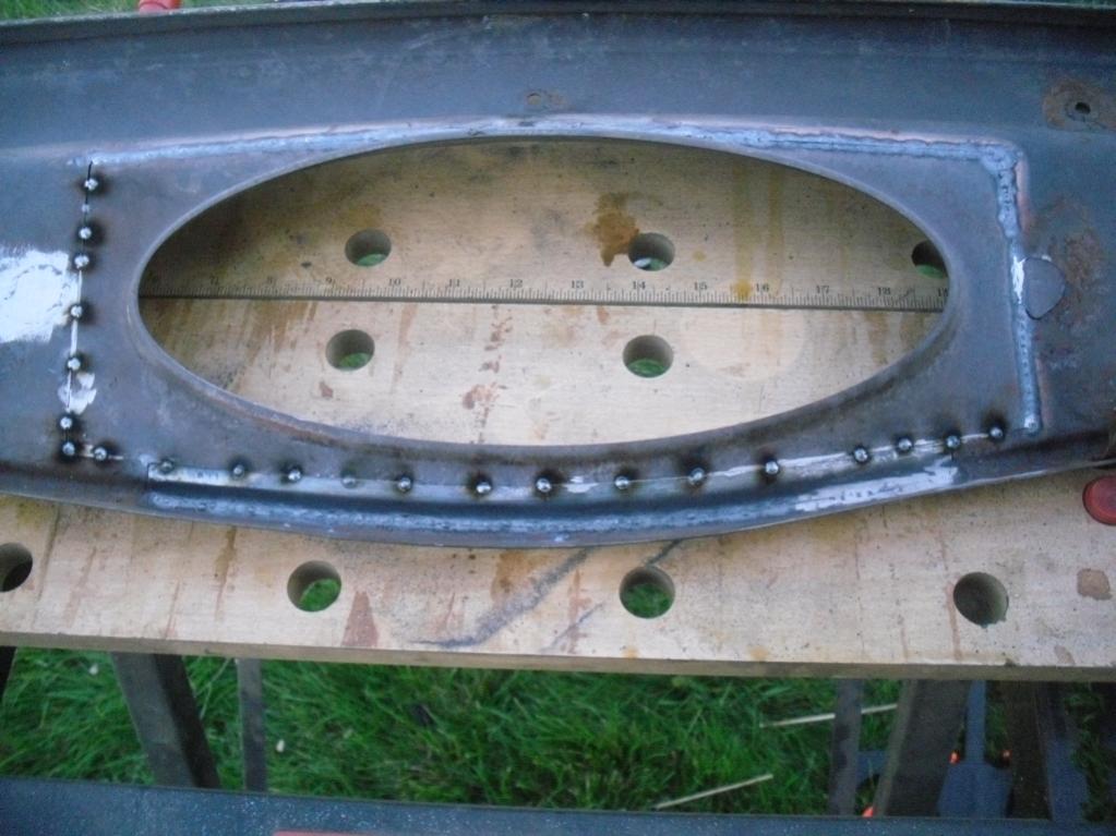

    I welded up the dash yesterday. I showed this making of this earlier but never got around to welding it up.
    I tig'ed the panel, welding the long runs all at once. Old timers taught me to s***ch this heavily (I use the mig for this).
