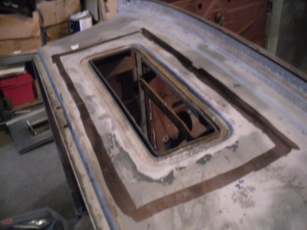

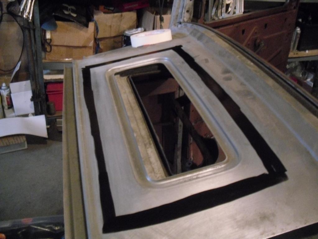

    Next I marked the new vent with a marker in the same manner, finding the center in both directions. This is tricky on both the car and the new vent , the lines are not sharp and it's easy to mis measure.
    On the body I double checked for center using the hood bracket holes and the center measurement from the cowl belt line on the sides.
    Once I was comfortable with this I marked the cut lines with tape.

    I thought I would show a sot of the manner in which i used tape to help create something to mark centerline.

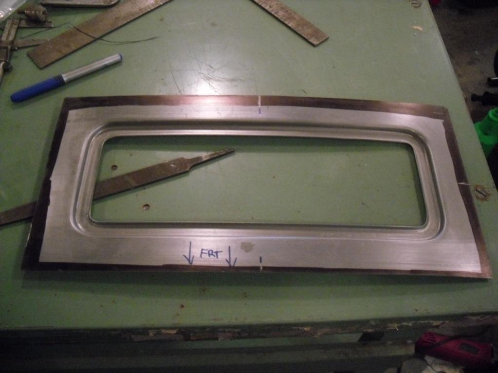

    After I cut the opening in the body I used a paper pattern to trace the cut line and transfer that to the new vent. This gives me the same pattern from which to cut both pieces

    Next I used the paper pattern (also marked with the centerline top and bottmo side to side) and traced the cut lines.

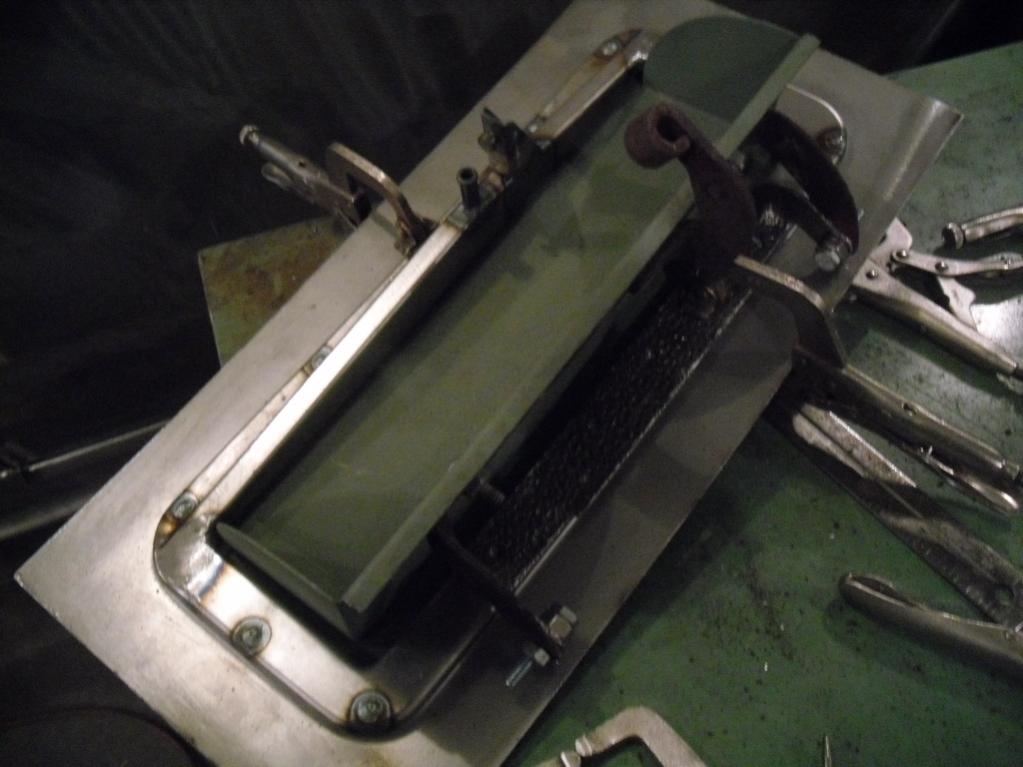

    Next I checked the fot of the new vent agaisn the body. It did require minor filing, for a comfortable fit. The cowl bead was used to verify even depth. I also the need to weld the trough onto the vent .

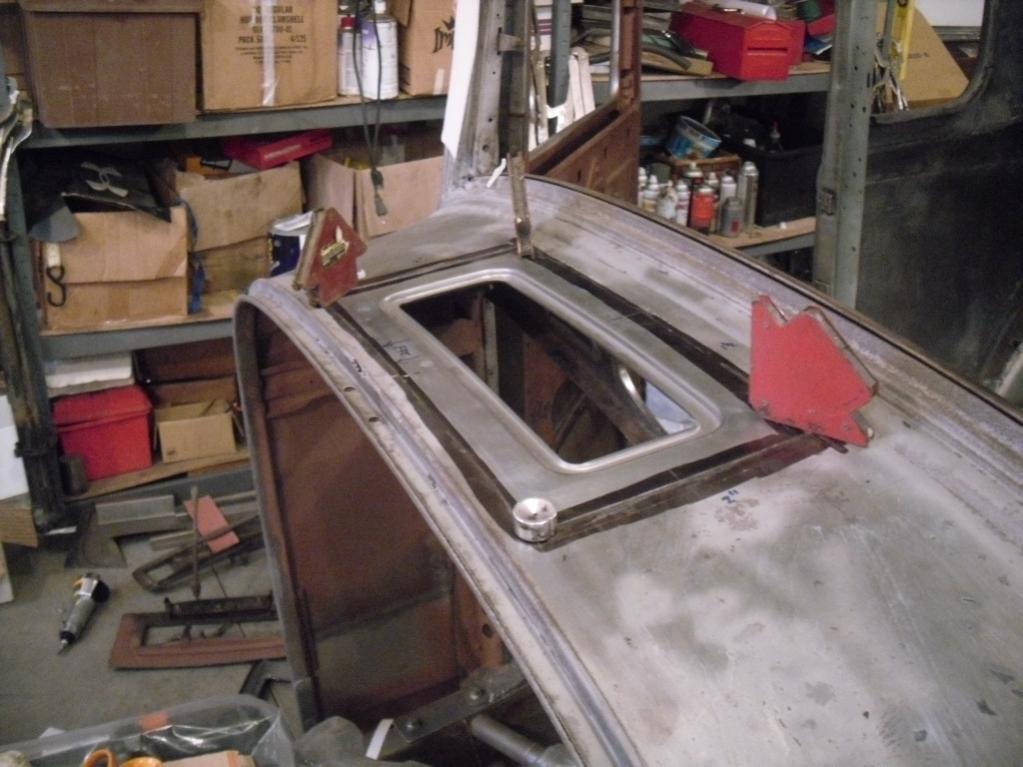

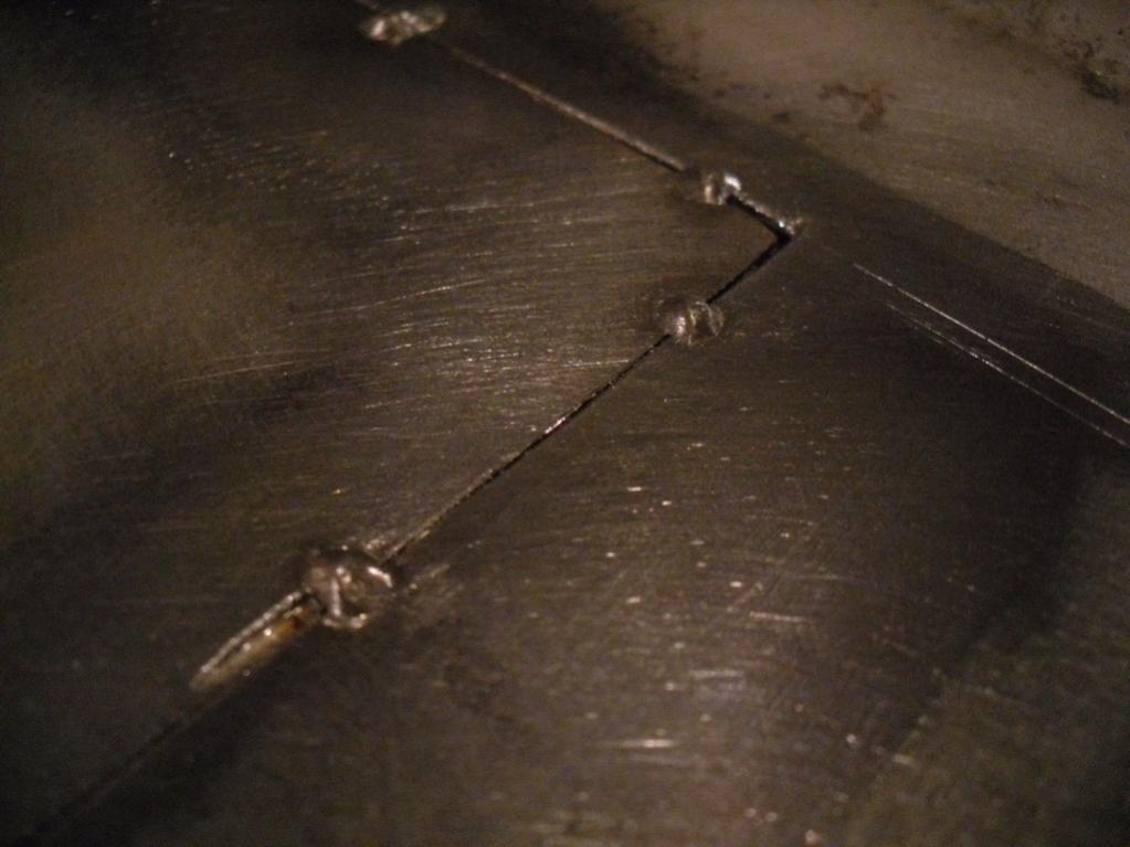

    Then I tacked the new vent in place using magenets to hold it in place. It is critical to keep the panel flush, and flat.This is by far the most important step to a quality finsihed product.
    I am tiging this weld so I wanted lttle to no gap , at the weld line. If I were migging this I want to v the gap and have the gap at the thickness of a business card .
    As I tack this I use a hammer and dolly where necessary. The tacks were made with a mig.

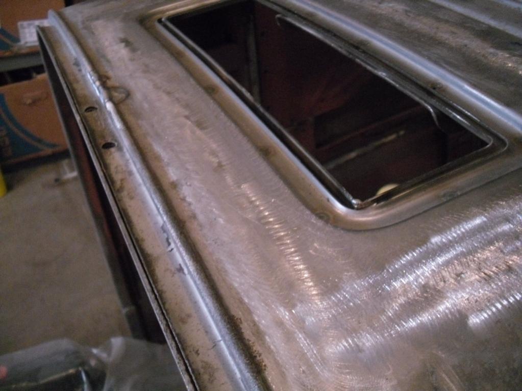

    Here's a few shots of the panel welded and metal finished.

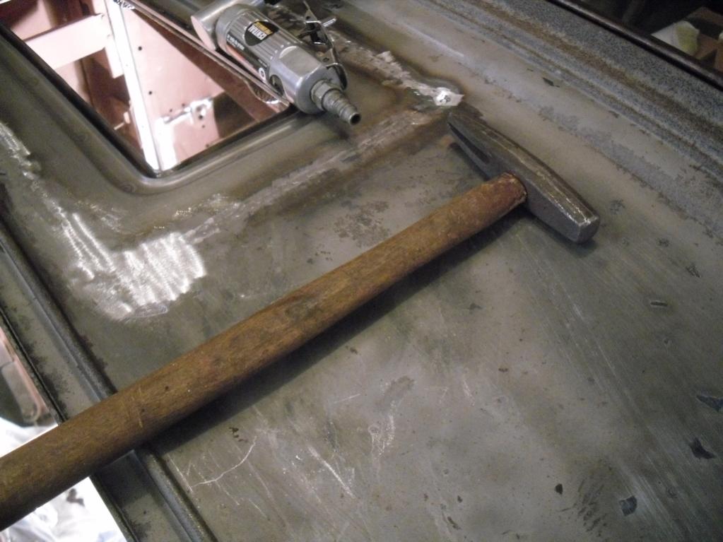

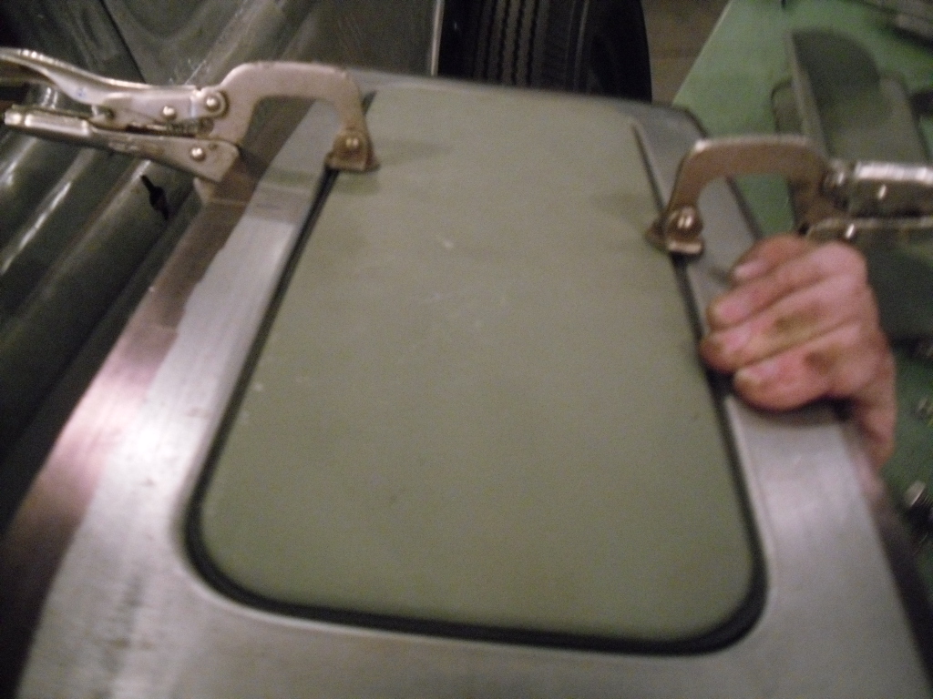

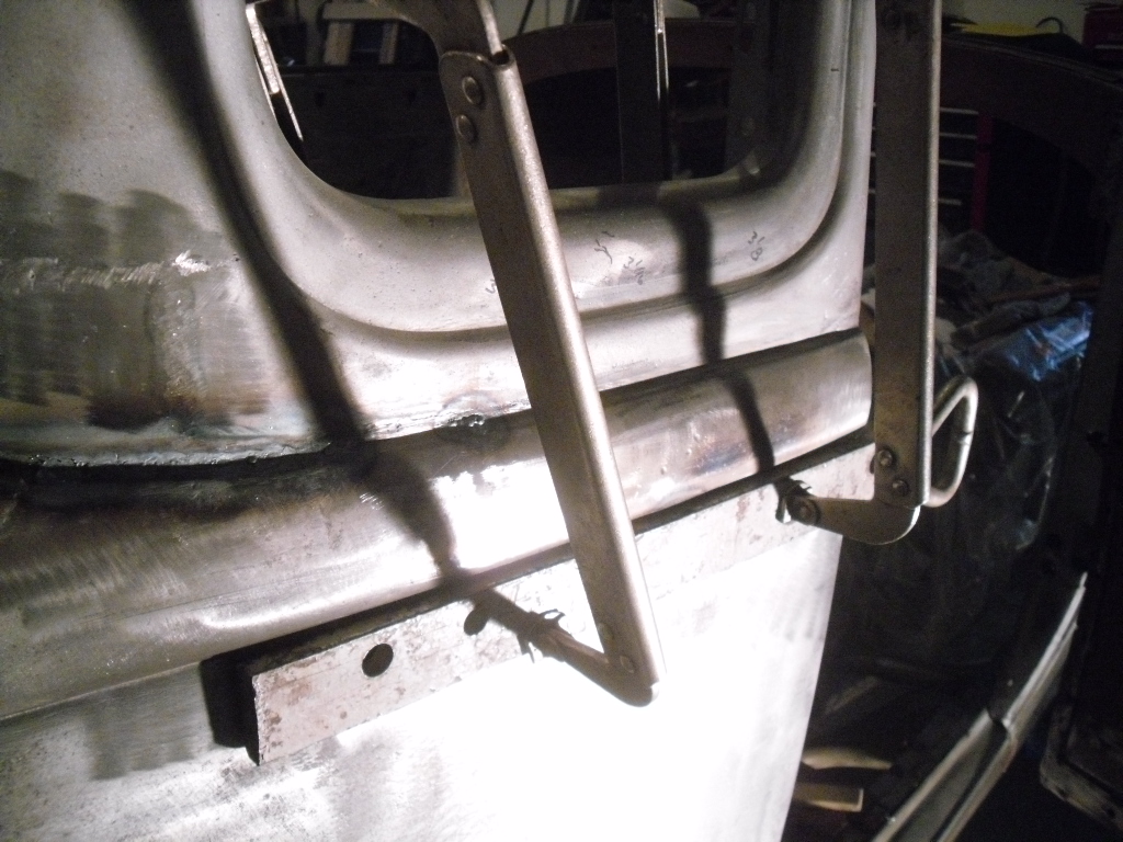

    During the shipping of the back of the car the qtr dangled in the air for the ride, and created a bulge in the qtr belt just below the qtr window. I had tried to work this with a a hammer a dolly with no affect .
    So I tried another approach . First I clamped the panel at the bulge with a heavy plate on the outside and a board on the inside. The pressure removed the bulge but it would not stay when released.
    I clamped it up a again and heated the area on the belt line with Map gas, and Wa La! Fixed!!!

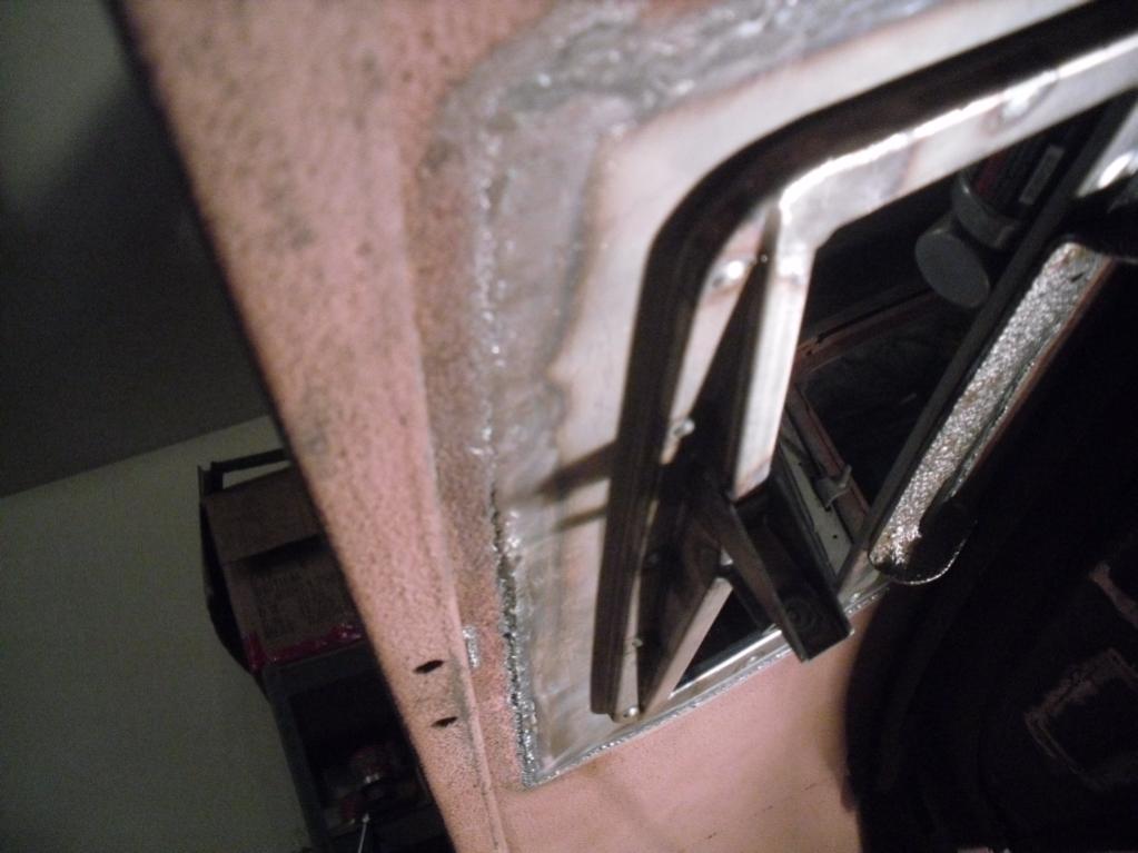

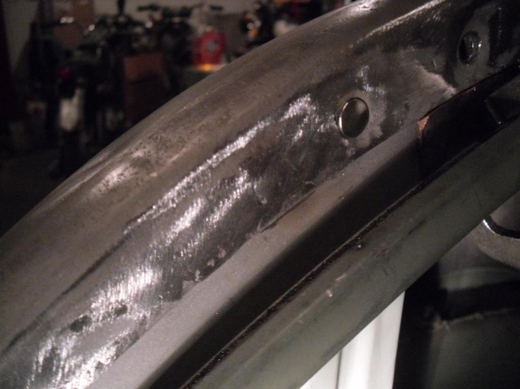

    Another area that needed attention was the on the left qtr panel at the trunk opening. This area had some rust pits on the edge (see pictures) and needed to be filled.
    I used a piece of copper to maintain a straight line and welded in the pits. Finished with a grinder
