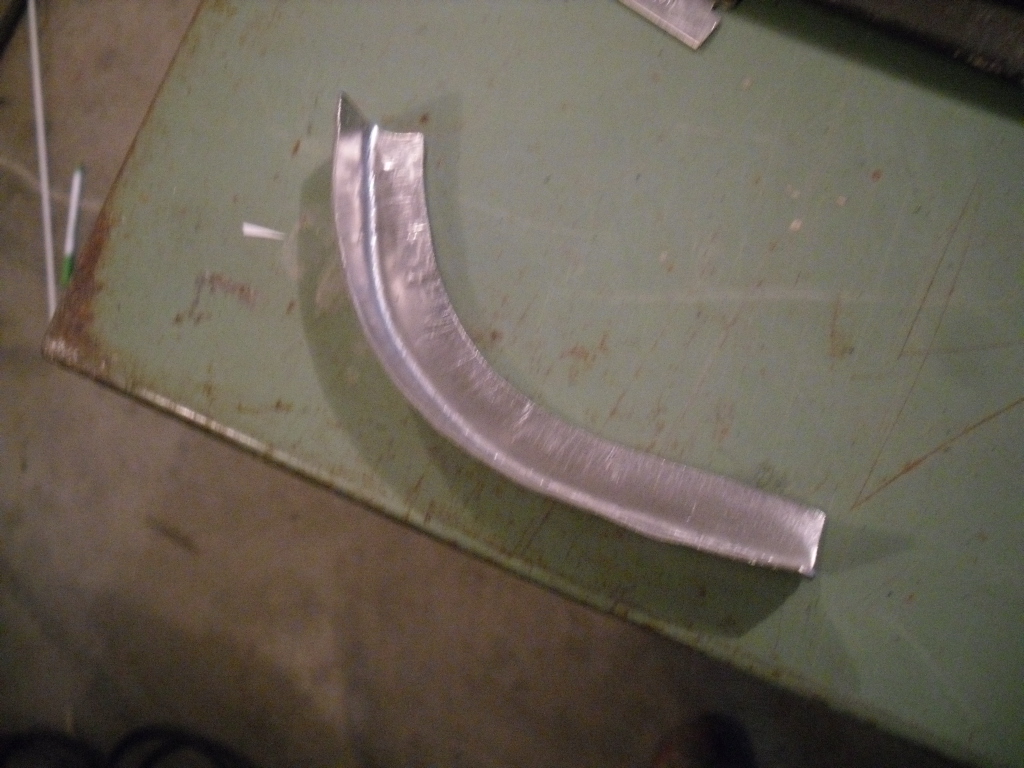

    I also needed to finish the left qtr window where the window attaches to the wood.
    I made the pieces from 19 gauge sheet metal and shaped with a shrinker.
    Welded them in using the wood to verify!
