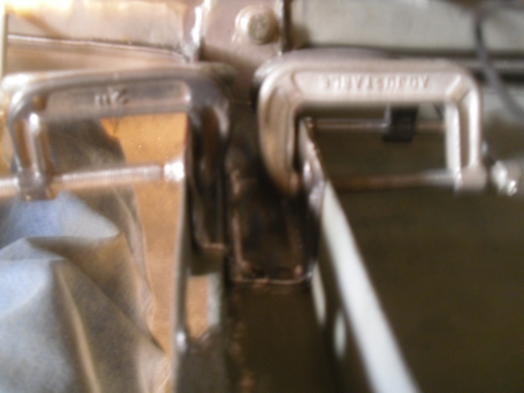

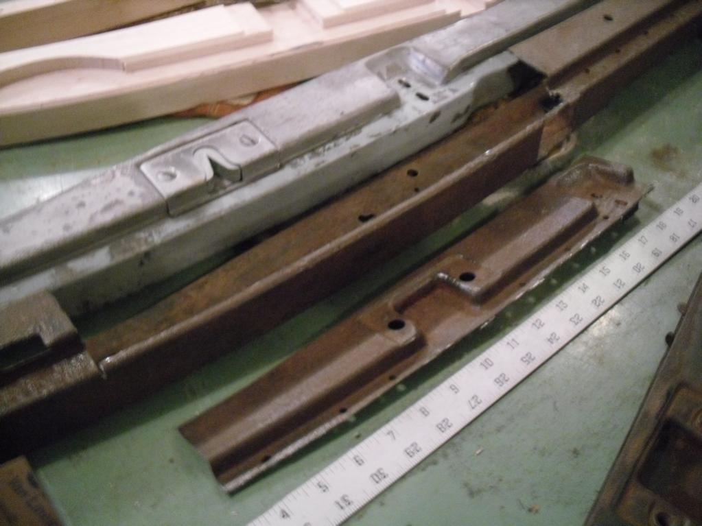

    Have been having trouble with the left door post. Could not get the wood to fit. This is the post I fabricated at the beginning of the build.
    Seems I did not maintain the minimum width at the center when I welded it up. The wood just made this obvious.
    Hamb member Xman (Dan)had a post from a 2 door that he gave me and I received it Friday via fedex. Thanks Dan!!!
    This post is a little longer and had some surface rust on the latch side. I decided to fab the post again using the remains of my 4 door posts.
    Not finished but it the door closes.

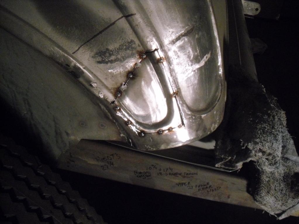

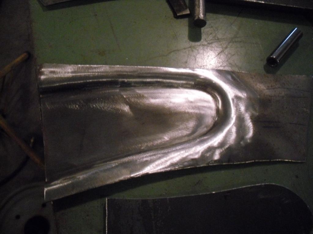

    I mentioned that i needed to replace the tulip on the left quarter.

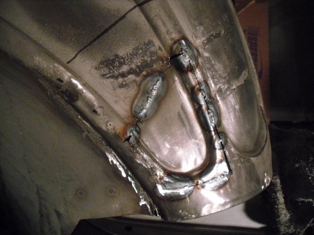

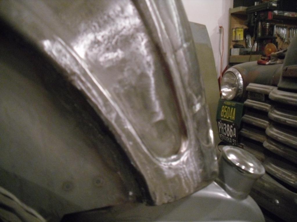

    Once the replacement panel was made it needed to be installed.
  13. rcnut223

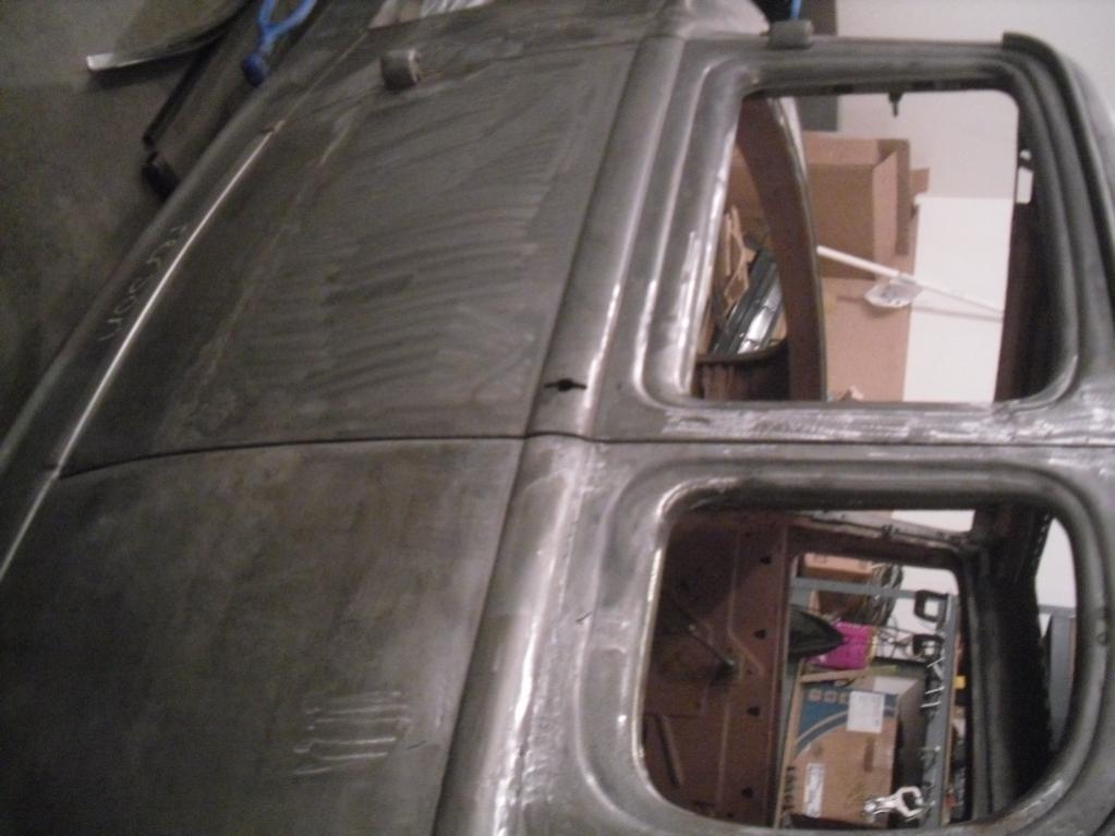

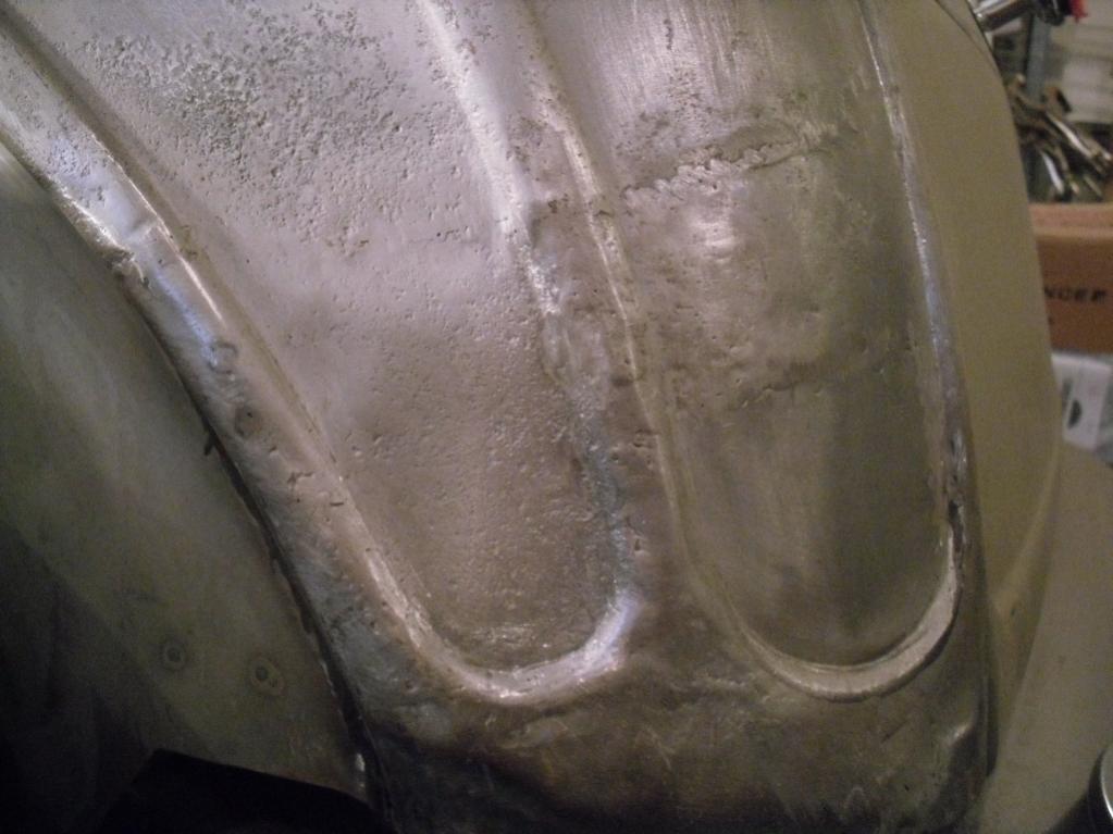

    here's the result

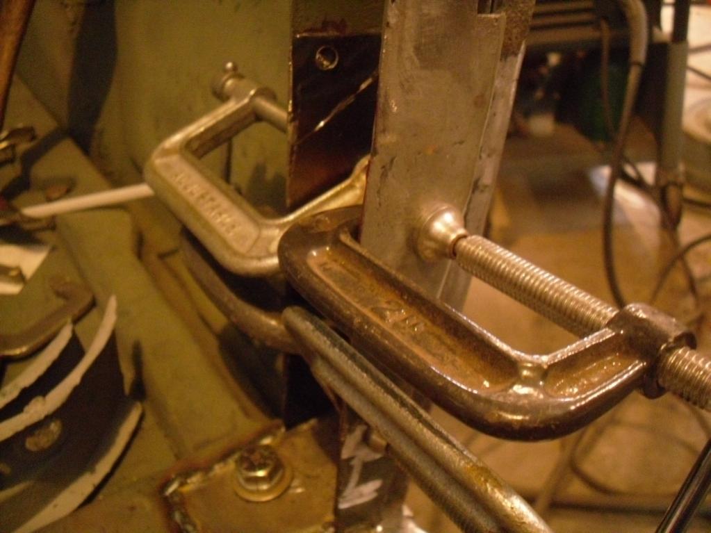

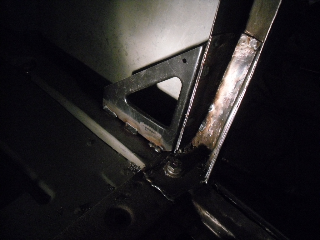

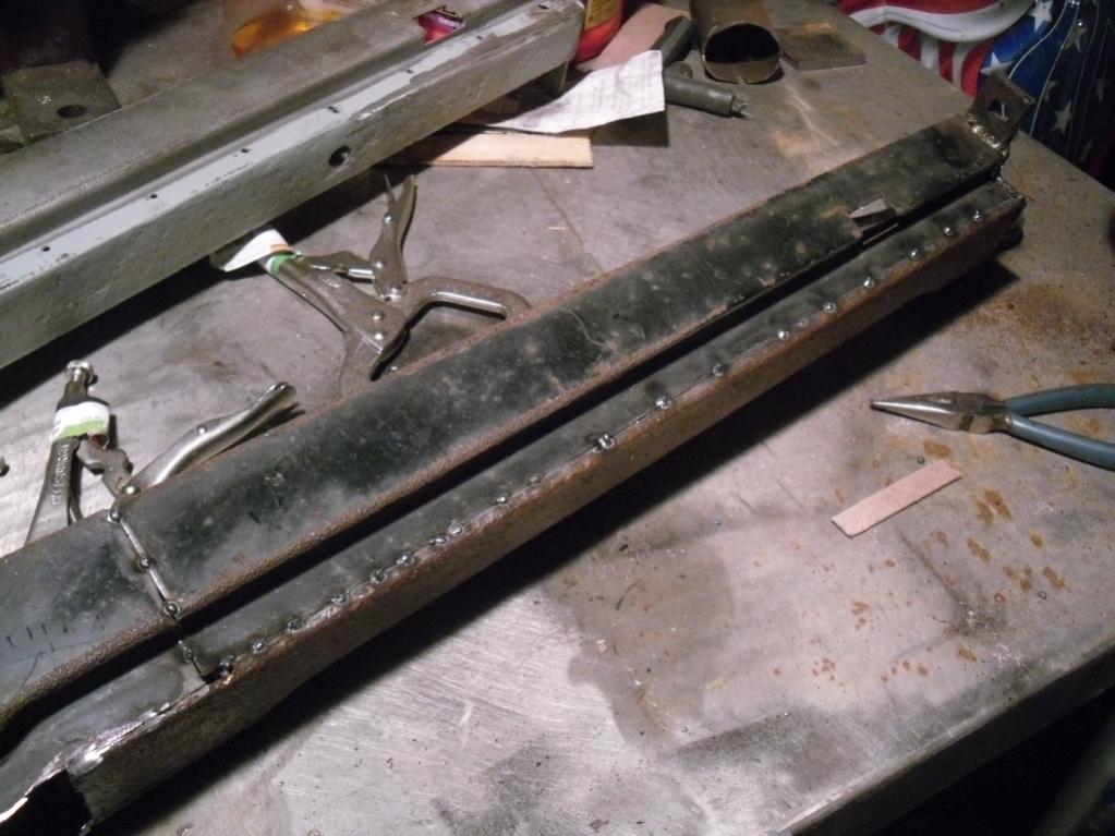

    I've struggled with the left door post since cutting the old post out and making the replacement from the sedan and 4 door posts. It just hasn't fit right.
    I took the post out again and cut it apart. it's now back in the car and he door shuts correctly. Not many pictures ...
    once the posts were in place i had to reinforce the post mounts.

  26. Dyce
    Joined: Sep 12, 2006
    Posts: 1,980
    Dyce

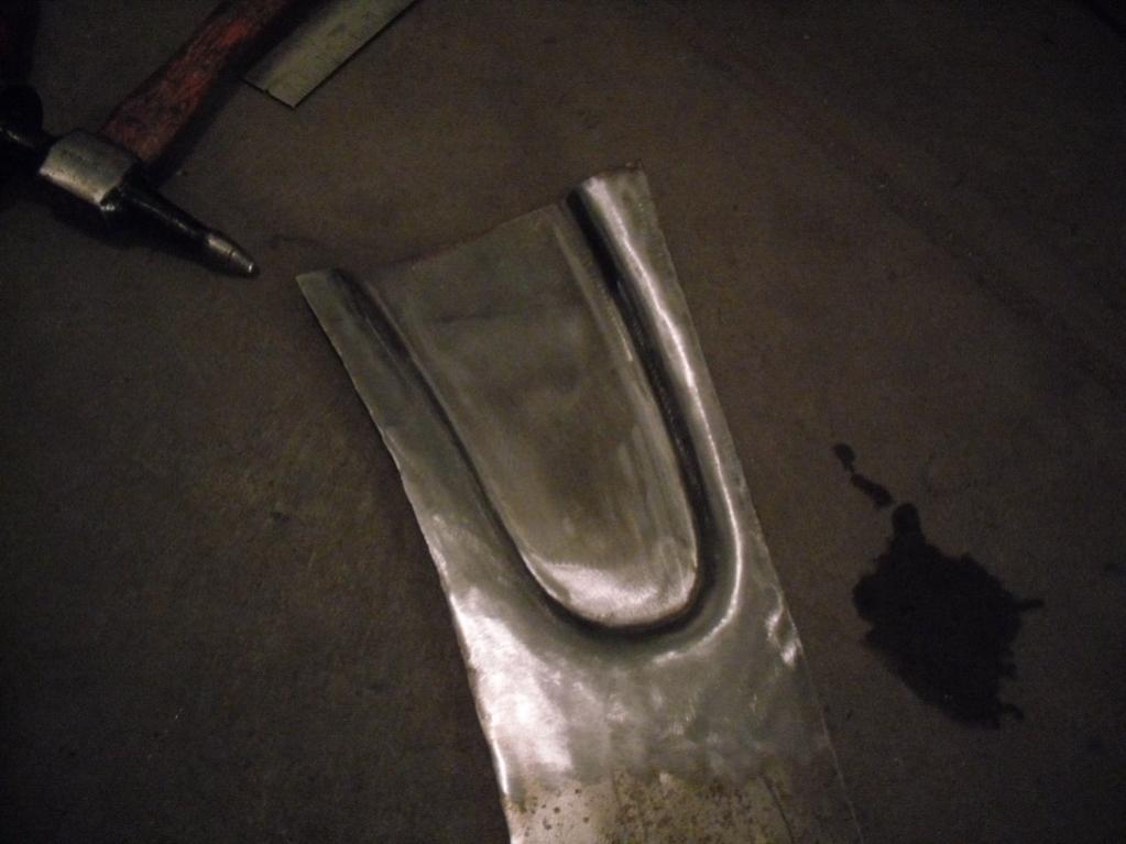

    Nice work Mike!! I wouldn't have thought of making a hammer form for the quarter peice. Looks like it worked good.

    Mike, it is looking really good.....That left quarter panel has shaped up a bunch, considering what you had to work with. You know it is funny, Kenny had a super nice quarter panel (had quarter window and all included) when he first got that stuff, And he sold it on ebay before I seen the stuff. I did buy the really nice right side door and a windshield frame from that same batch of stuff your cowl and doors come from. Did you get the frame he had?

    Nope, All I I purchased was the right qtr and back window. Sure would have saved a bunch of time had that other qtr been with the lot. Oh well
    Last count the left qtr is made up of 18 different pieces, actually probably more since i did not count little patches.

    Dyce
    The finished form was not pictured, it did work well as that is a relatively flat piece. i could not use my bead roller as the radius was too tight for my 3" roller,
    One of the guys at the metal meet (from fargo) showed me his form for that spot. that is where this came from.
