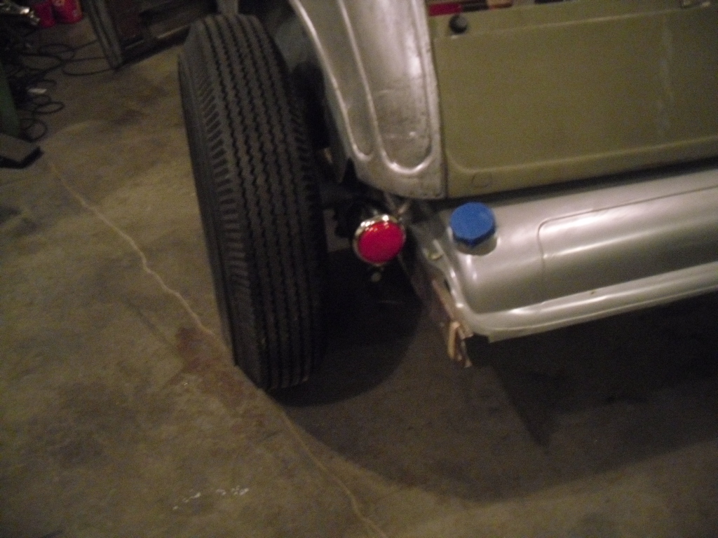

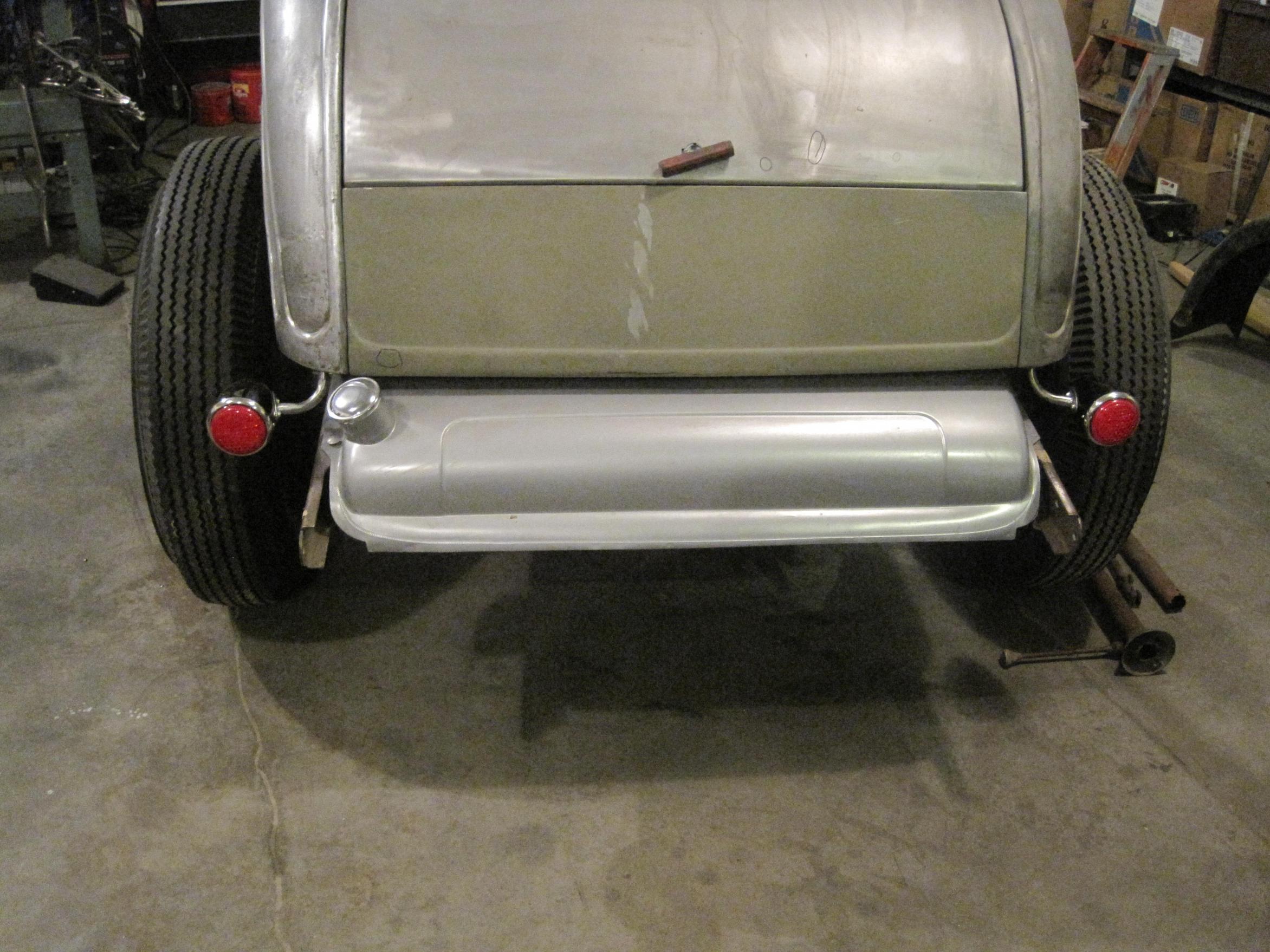

    Well after a couple months off...not necessarily by choice , I was back in the shop yesterday.

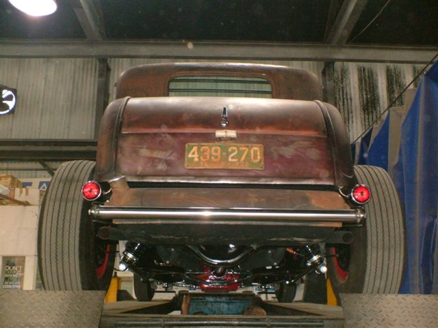

    Did not take a lot of build pictures but I made a pair of tailight brackets.
    I would really like some comments on the location, they wound up sticking out a little further than others mounted in similar fashion.
    Thanks

    Mike,
    As much as I hate to say it, The tailights Do not fit the build in that location. Now ofcourse that is just my opinion, It is your car, So if you like them there that is all that matters. If this was a full fendered car they might be ok there, but not on a highboy IMO anyhow. I would try moving them forward and tucking them in tighter to the frame, Most guys would put the tailights in the rear panel, I commend you on trying something a little diffren't. Man you have really out done yourself with this project. I am blown away how good the left rear quarter come out.

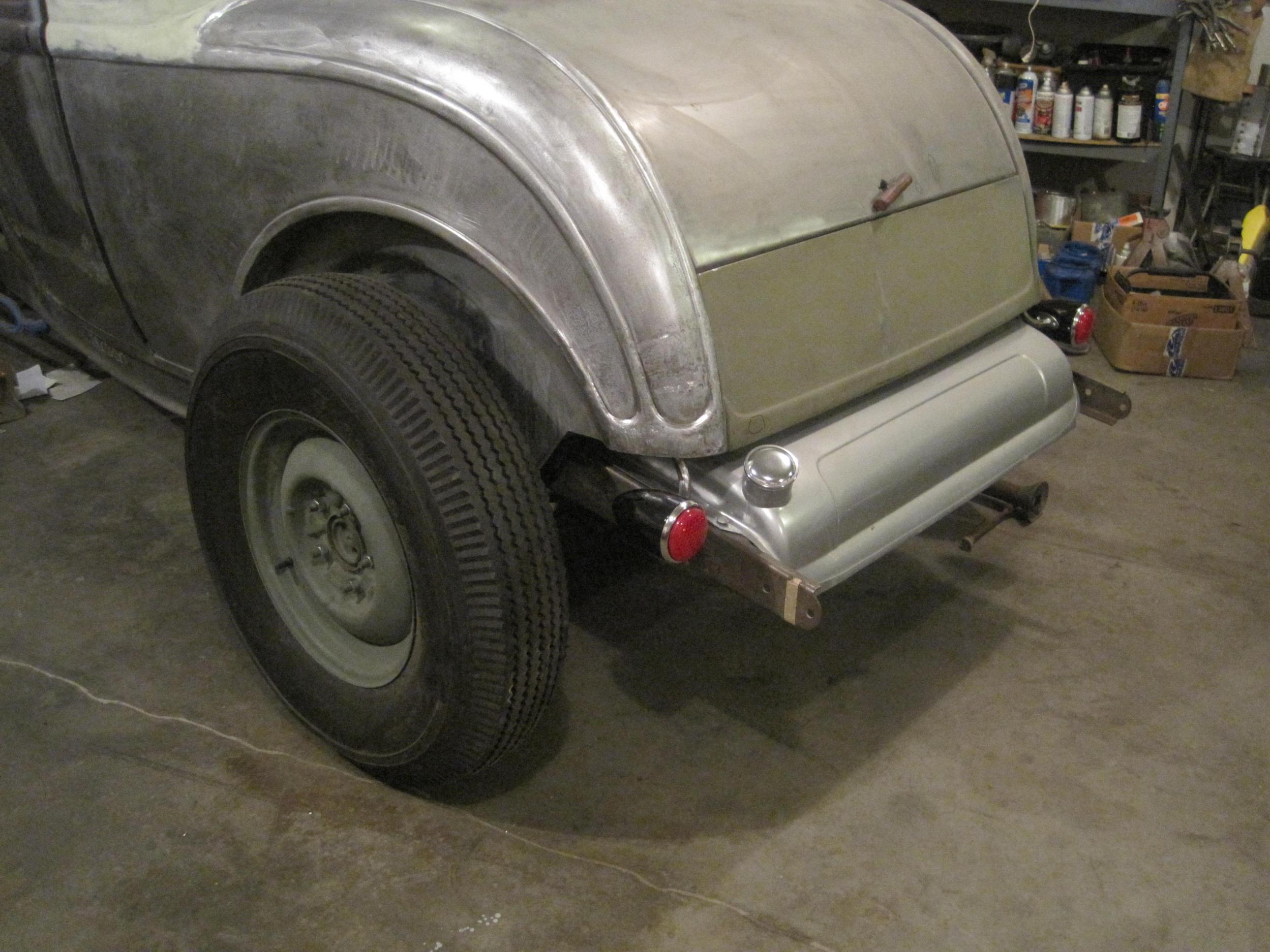

    Thanks Cowtown
    Here's a shot of the left light moved per your suggestions
  5. Mart
    Posts: 5,008
    Mart
    I like the new positioning a lot better.
    Mart.

    Good cl***ic taillights, is it 37 chevy or so ?
    I think it looks alot better when it is closer to the frame. the brackets are perfect but maybe you could cut them of at the light-side and make them shorter to get the closer.......just my 2 cent ;)

    That looks really good to me!...

    Cut-down stock '32 brackets work really well IMHO, either in the stock location or under the floor .

    Much better tucked in closer. Great project.

    Thanks Guys
    I like them much better closer as well, really appreciate the input
    I may try to pull them a little more.

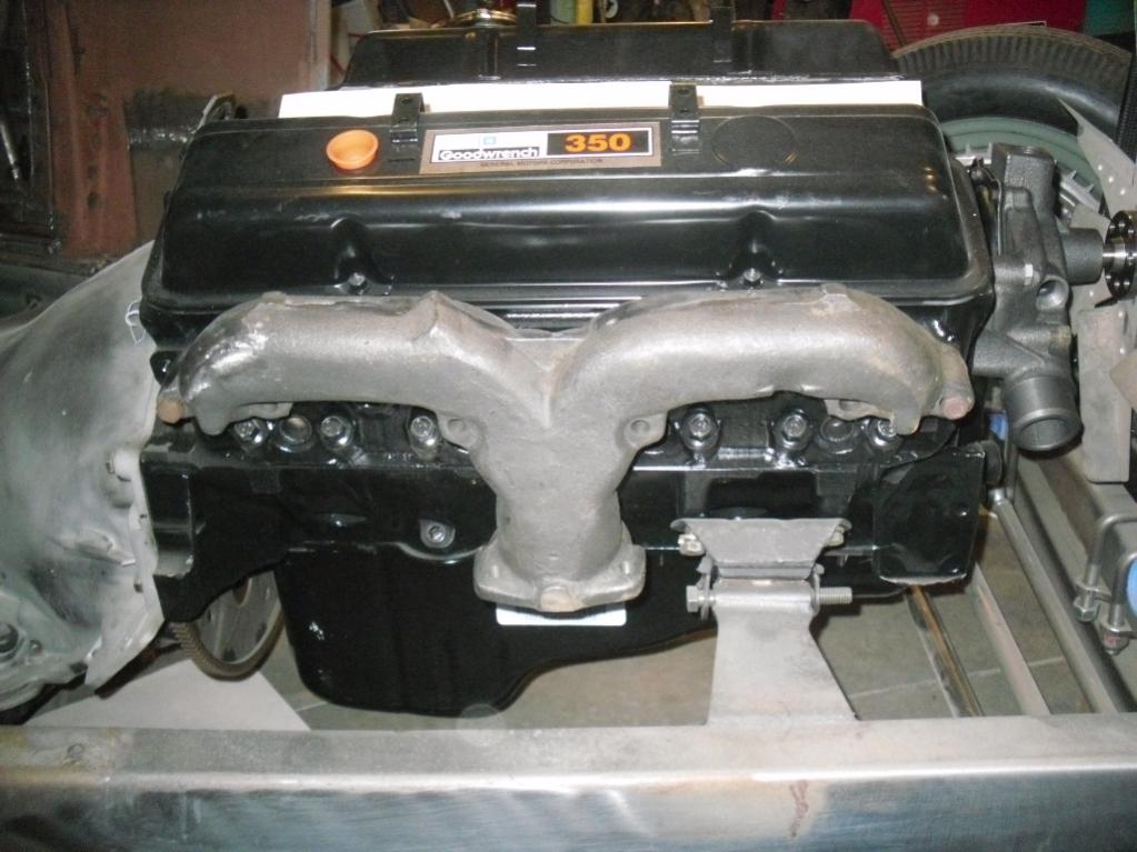

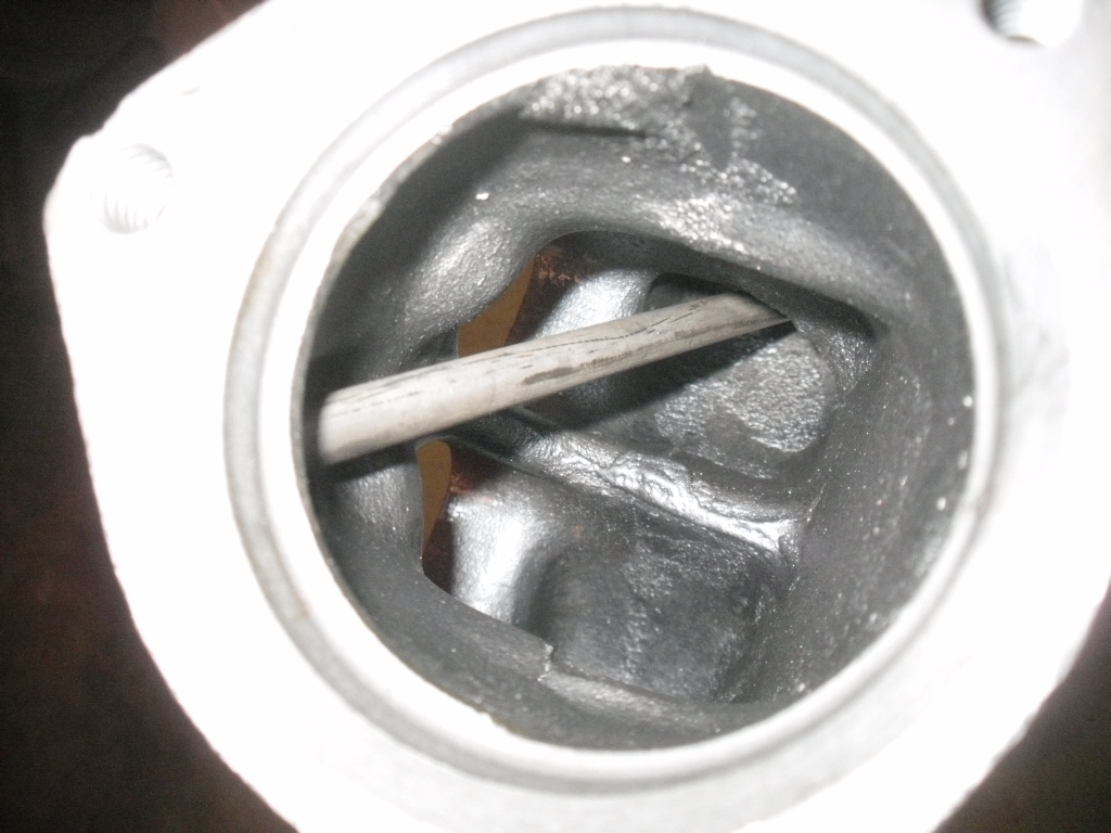

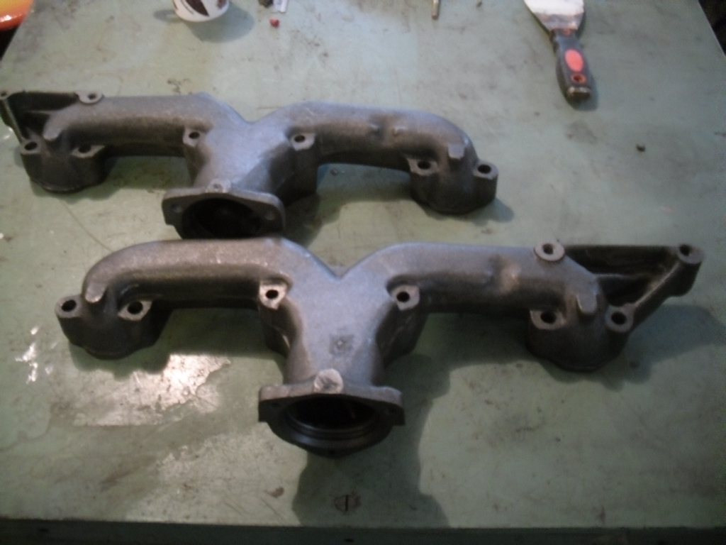

    Started working on on the engine bay today. Bought a set of 63 Corvette knock off cast manifolds.
    These have brackets cast into them and need to be cut off and the mounting holes welded shut. One has a tube in it as well, removed this also.
    I will sand blast these once the weather warns up to help the ground parts on manifold look
    more like the cast area.
    Here 's a few pictures....

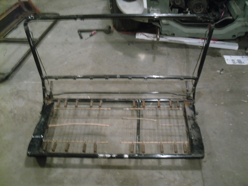

    Here' what the seat looks like with the seat covers off. The top of the seat back matches the stock 32 seat dimmensions perfectly.
    All other measurements are wider, 8 inches wider at the seat bottom.
