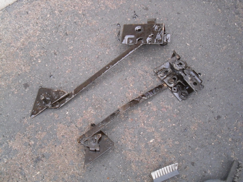

    Been soaking my Door latches in Mol***es for the past month or so...really cold here takes awhile
    Here's what they looked like after I pulled them out of the stuff followed by a shot of them after washing and a quick wire wheel.
    Now for a rebuild ...

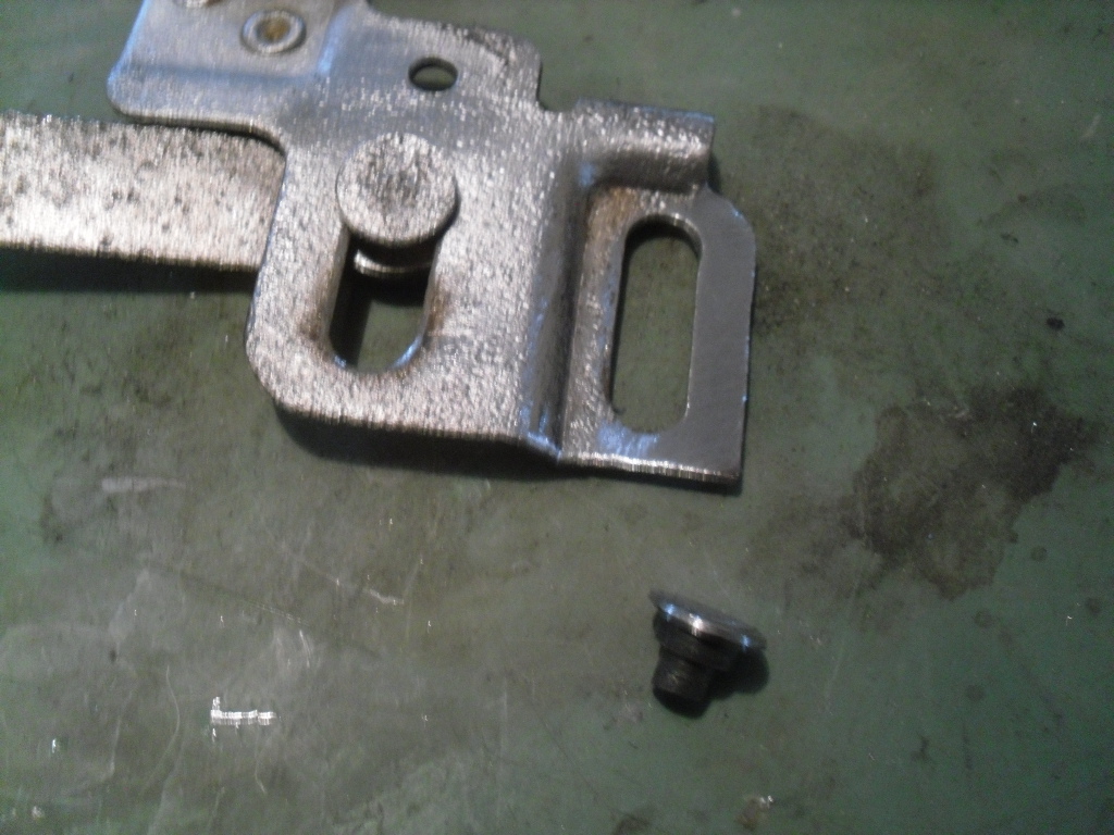

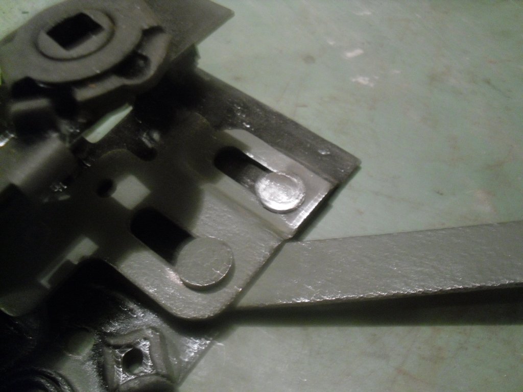

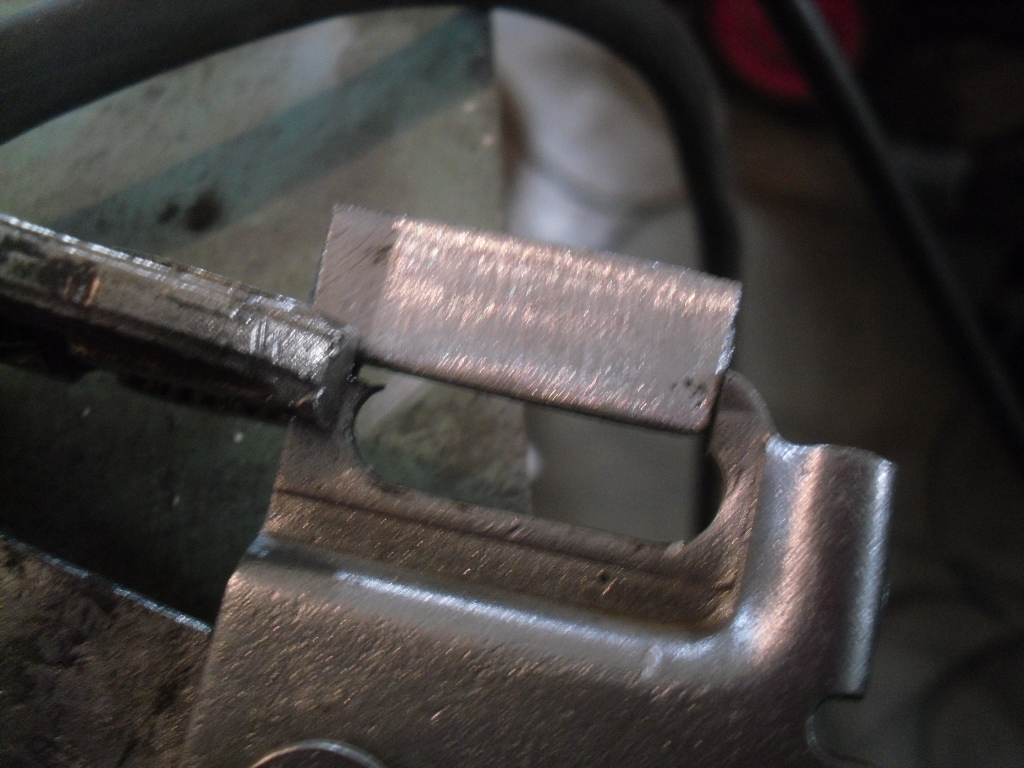

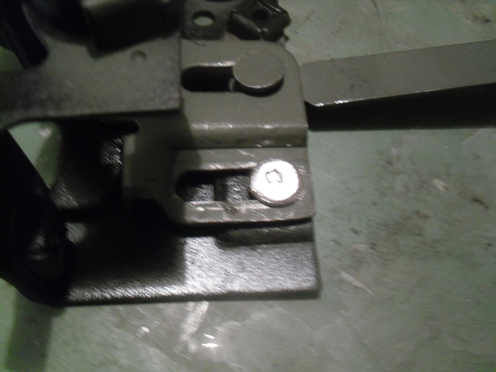

    I began by removing the rivet the held the door catch. Both the rivet and the hole it slid in were well worn.

    here's a few shots

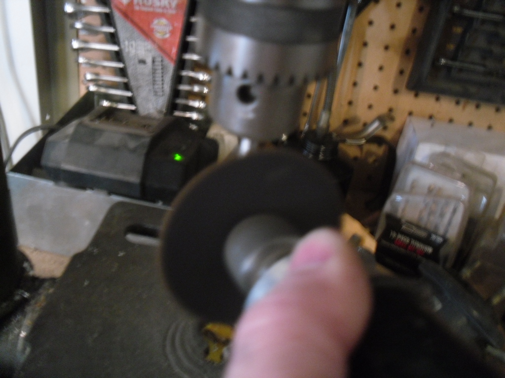

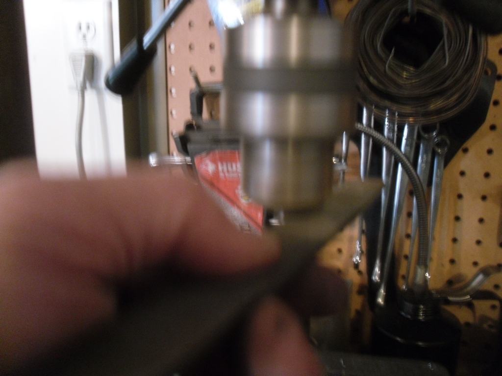

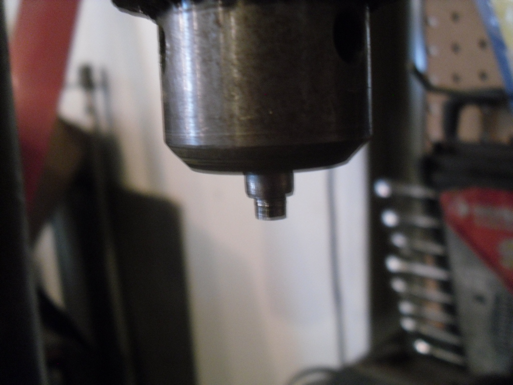

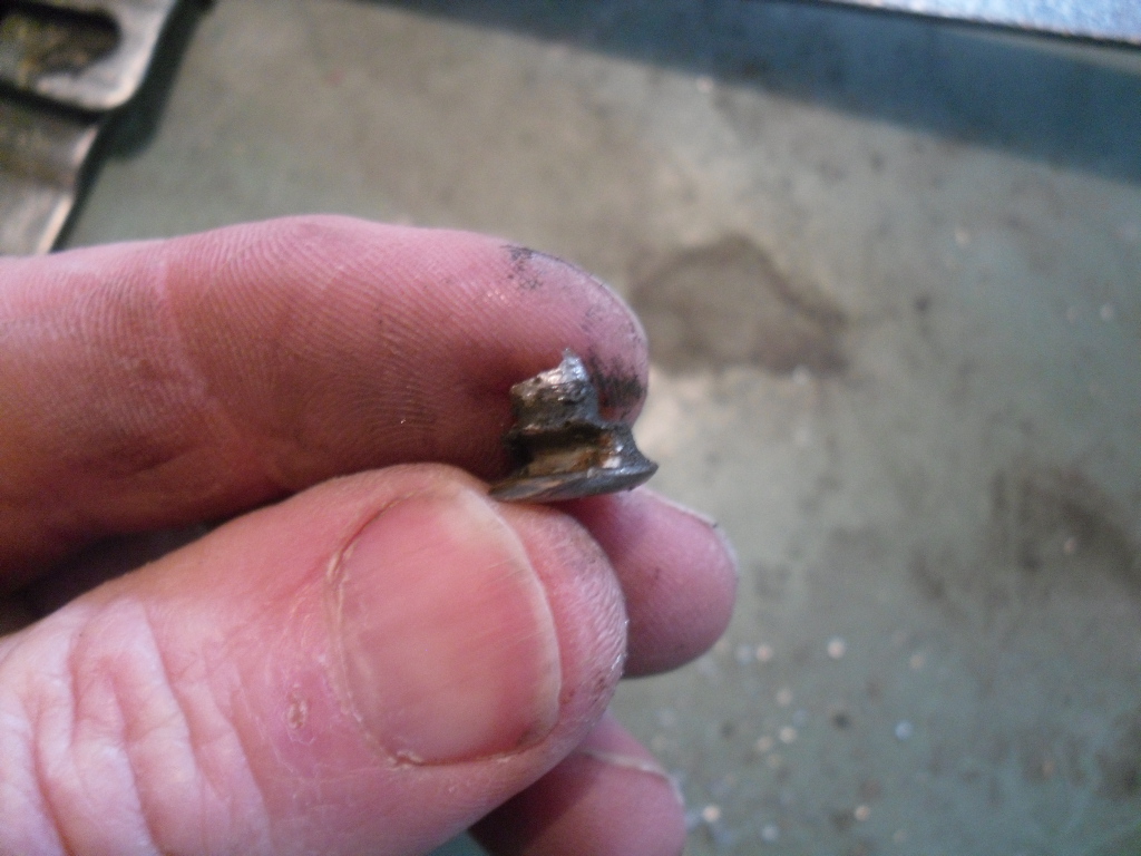

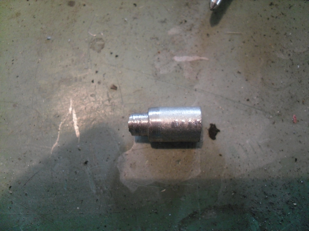

    Here a pic's of the process I used to make the stepped rivet . I started with a standard bolt, cutting the head off. I chucked the bolt in the drill press and created the step with a grinder and files.

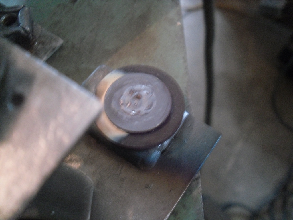

    After cutting the rivet to length and using a spacer to make sure the shaft length was correct , I welded a washer on with the tig.

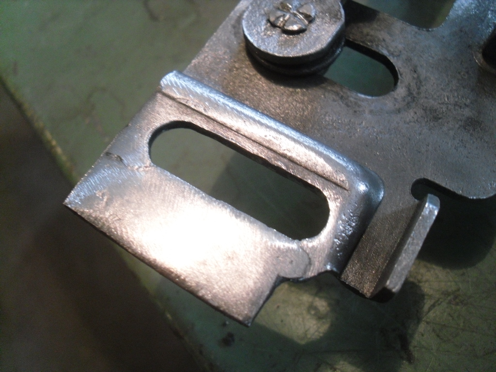

    Here's the repair of the hole , I used a bolt the same size as the rivet shaft to maintian spacing.

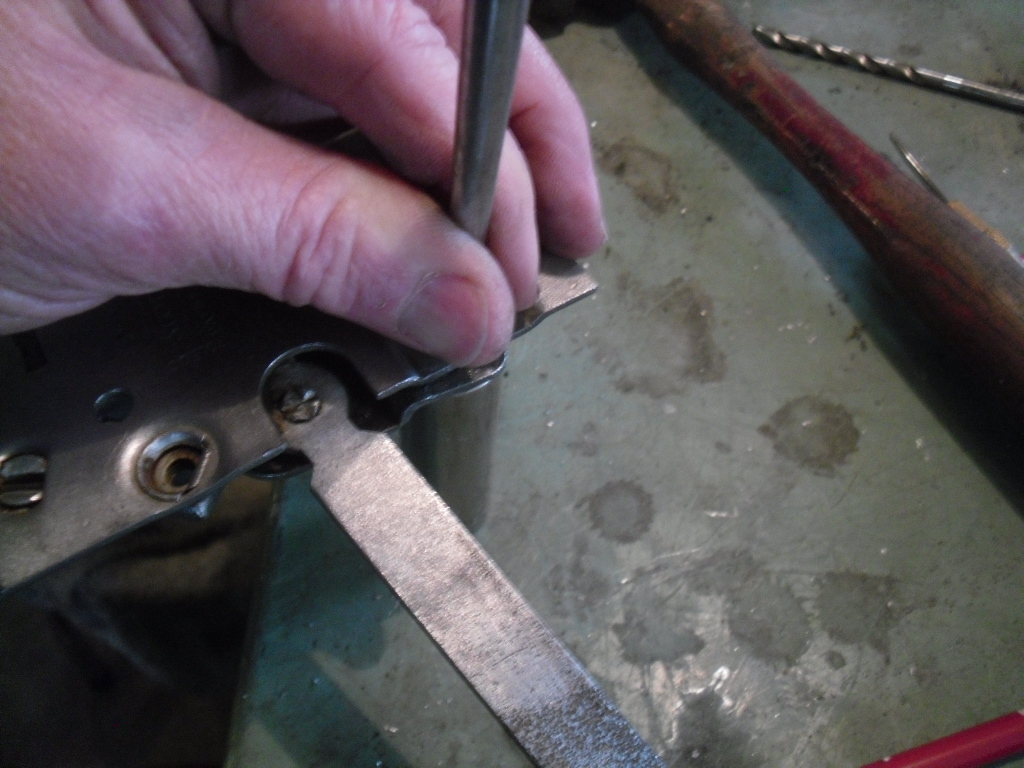

    I replaced the remote springs as well, these required dis***embly of the remote. I heated the tabs and bent them straight . One went smoothly, the other not so much...the tabs broke and I had to weld replacements on.

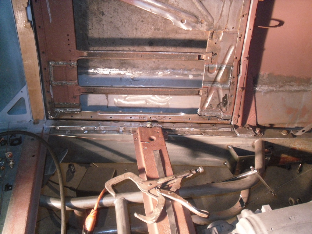

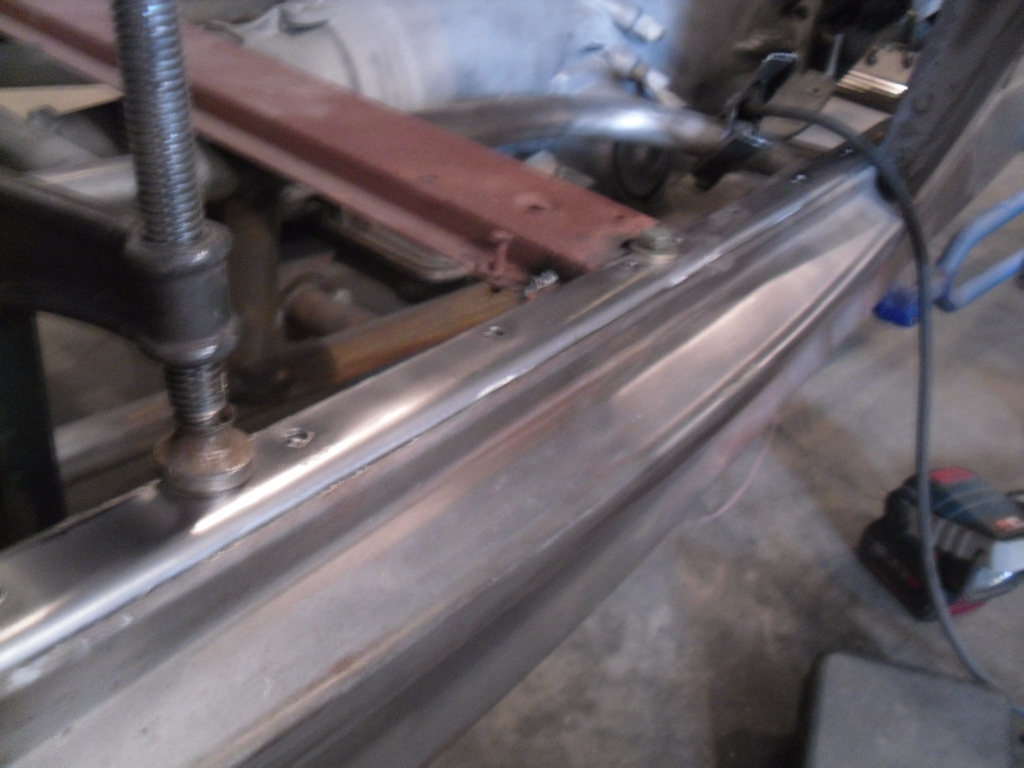

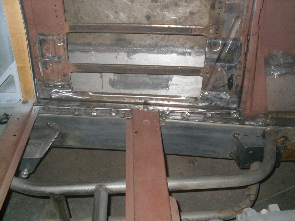

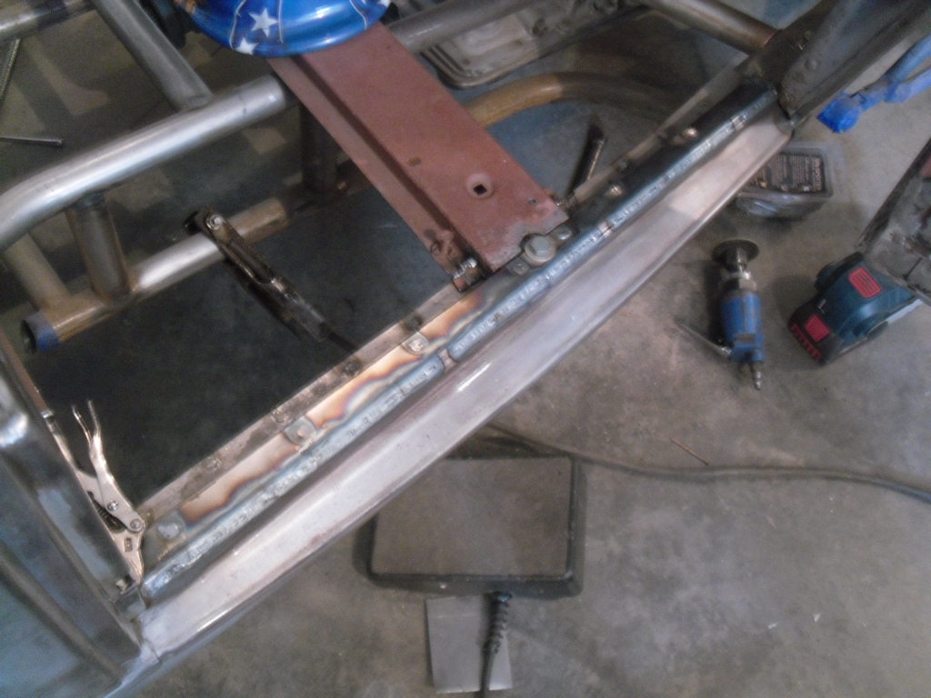

    A decision I made earlier was to trim the top lip on the door sills i hind sight made the job much harder.
    My original thought was to do this so that I could get rid of the lip on the sill.
    Here's what I would up doing.
    kidcampbell71 and mgtstumpy like this.

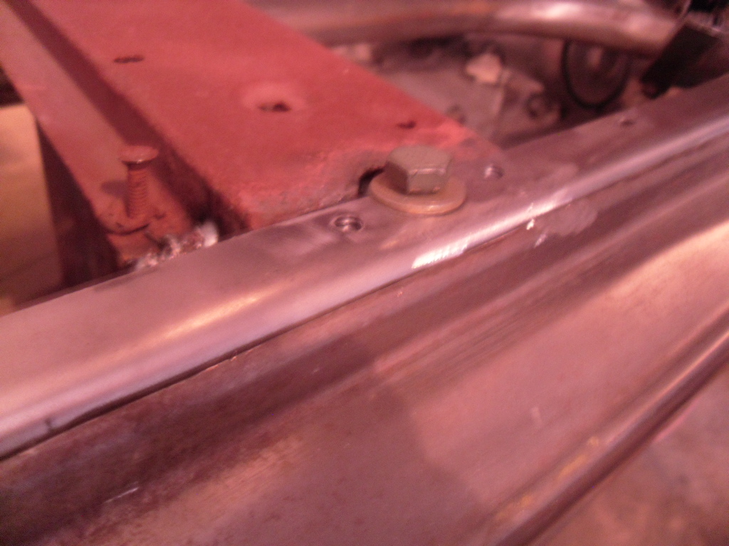

    Here's the process I used on each side to complete the door sill.

    As for the doors, each were off at the front. I had to cut the inner patch loose on each door and pry the front down to square the door.

    After Saturday and Sunday afternoon, here's the result.

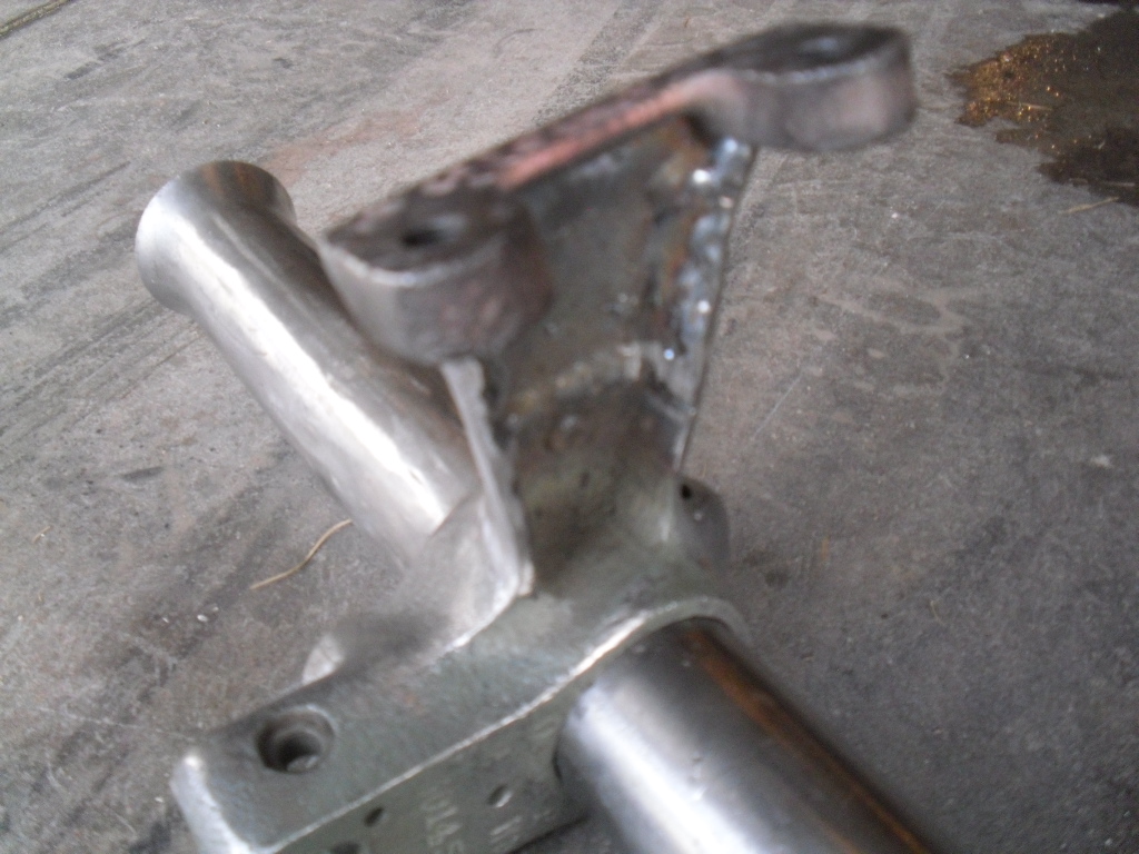

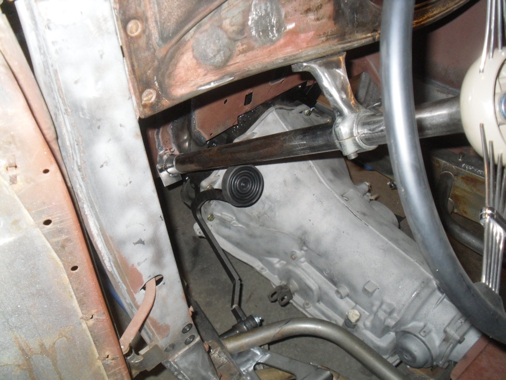

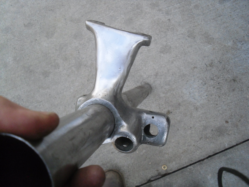

    Have been working on the lengthening steering column drop.
    This is a 1936 Ford mount, cut and using 1/4 plate lengthened 2 1/2".

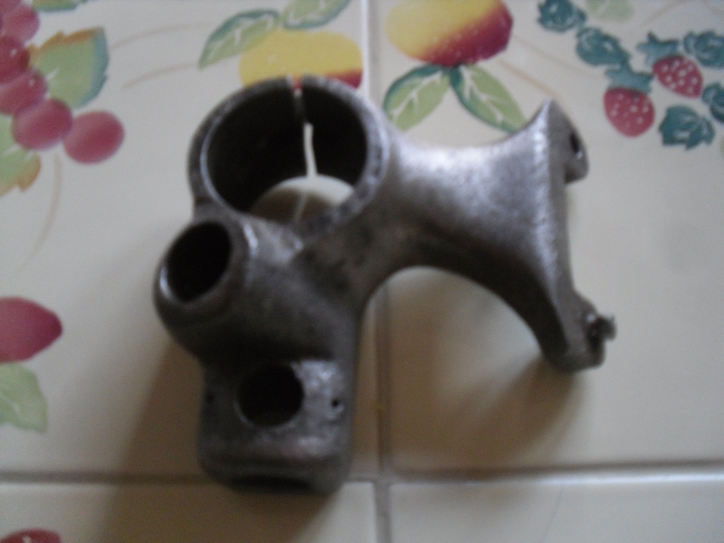

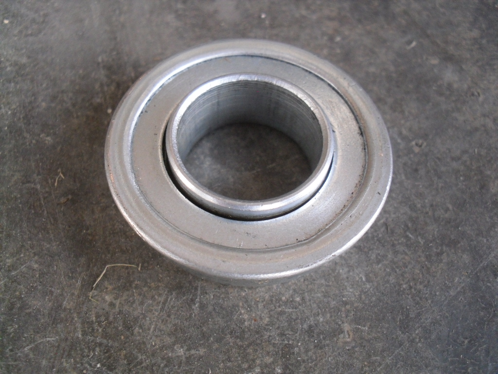

    The column tube was cut to length. I am using hardware store bearings 1 3/8 od , 3/4 id a the top and bottom of the tube.The bearing is not completely inserted in the image shown.
    The upper bearing was secured with homemade ring tacked in place.
    The lower bearing need a thin bushing placed into the tube to fit snug. I will secure the bearing with a lock collar
