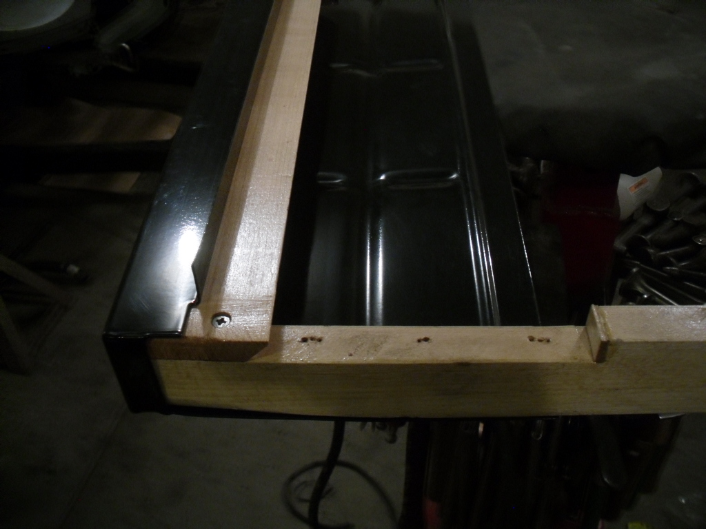

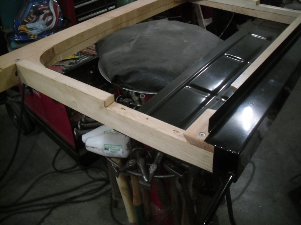

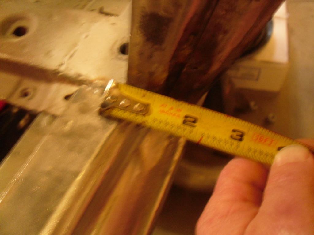

    I have the wood for the rear window out of the car now but I can stick it in this weekend with the pan. Anything in particular you are looking for? I can take pictures of the setup out of the car too.
    32 viper
    Yes, I can give that measurement. I can tell you this, it is different measurement from one car to another
    Good Luck on your car and thanks Brady1929
    Mike

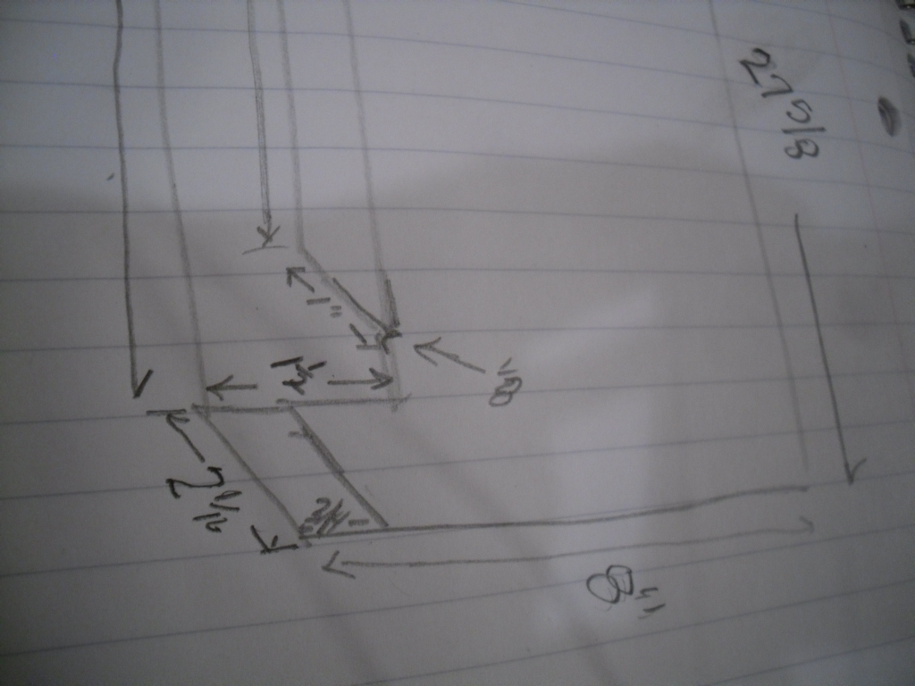

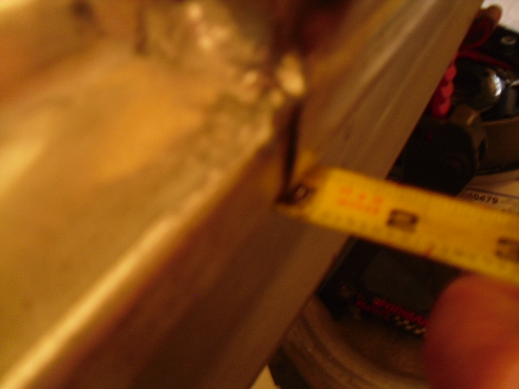

    Viper 32
    The width from center line at the B pillar is 22 5/8
    I have taken a few shots from the frame to the outside 1'" and from the center of the body mounting hole.
    Martin
    I'll take pictures and get dimension on the pan for you. Battery went dead
    Mike

    Martin
    Here's the back window tin and wood
    with measurements.

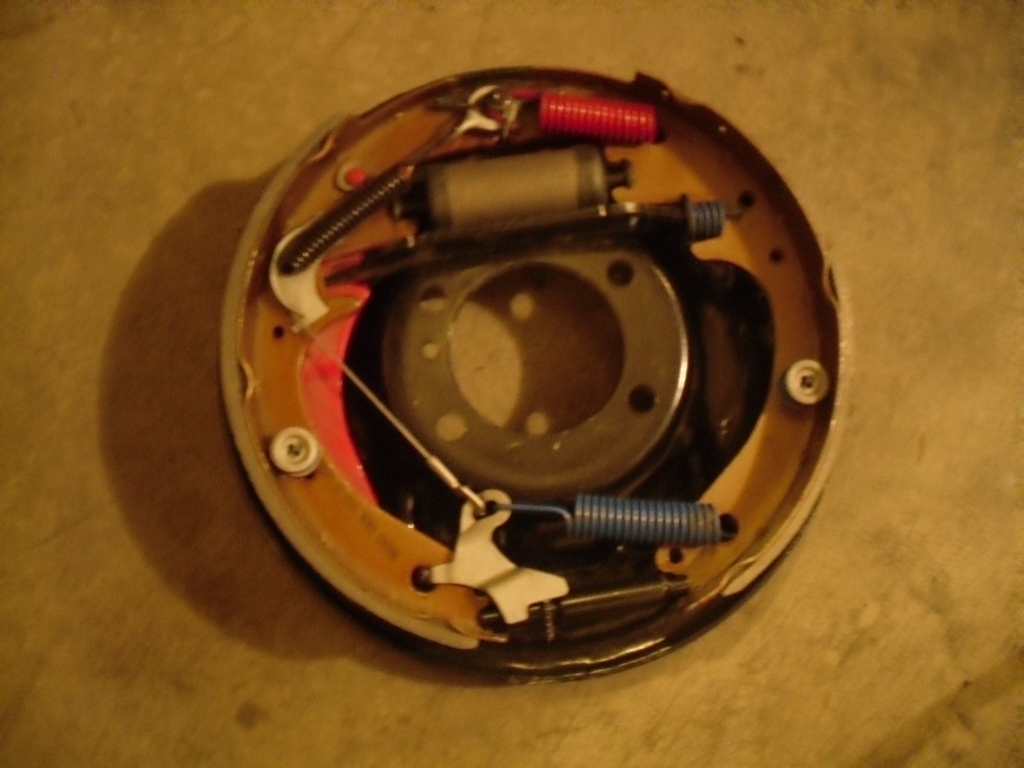

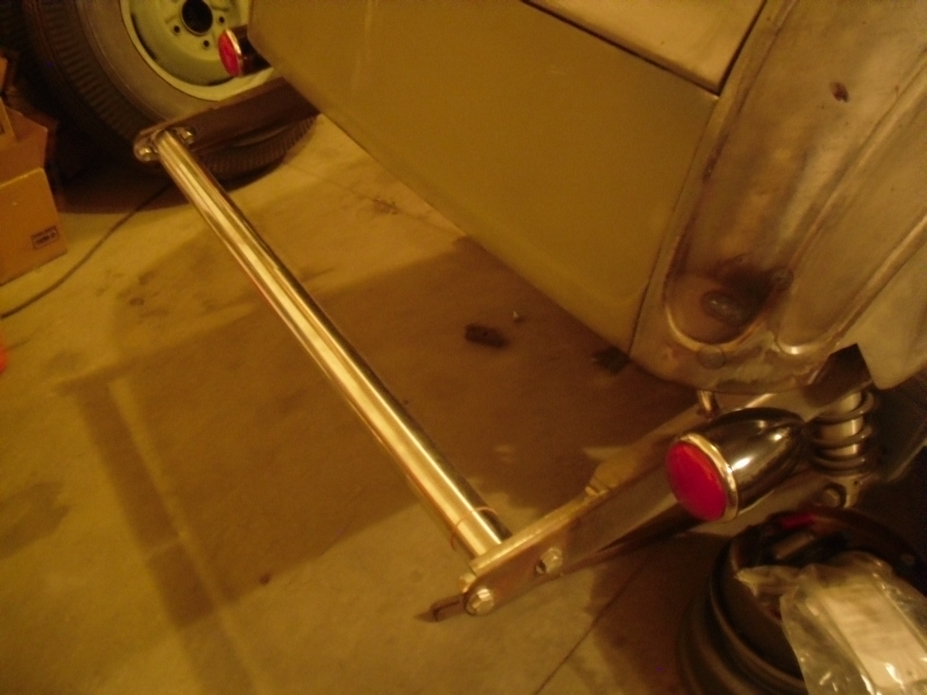

    Have been working on the car , although have not posted much. Nothing really noteworthy.
    Here's a few shots-
    spreader bars..
    brake hoses..
    brake rebuild rear ..
    kidcampbell71 and mgtstumpy like this.

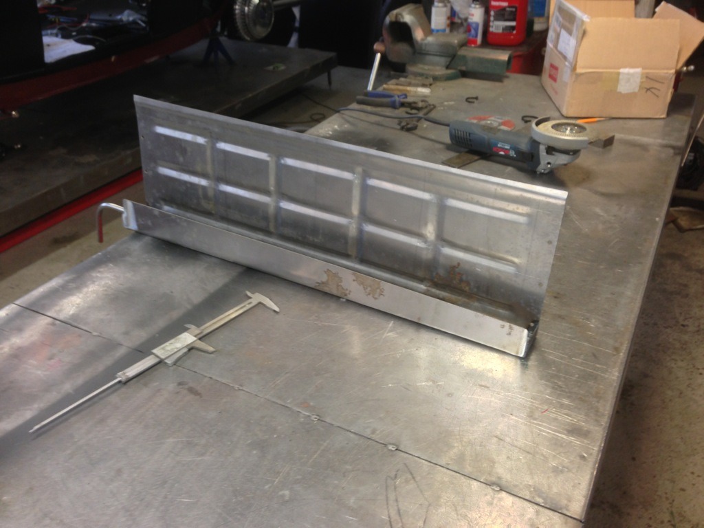

    You made it possible for me making one, its not exactly perfect but it works as nobody will ever see it. My beadroller is to short so I couldnt do the middle bead so I made it a little different.

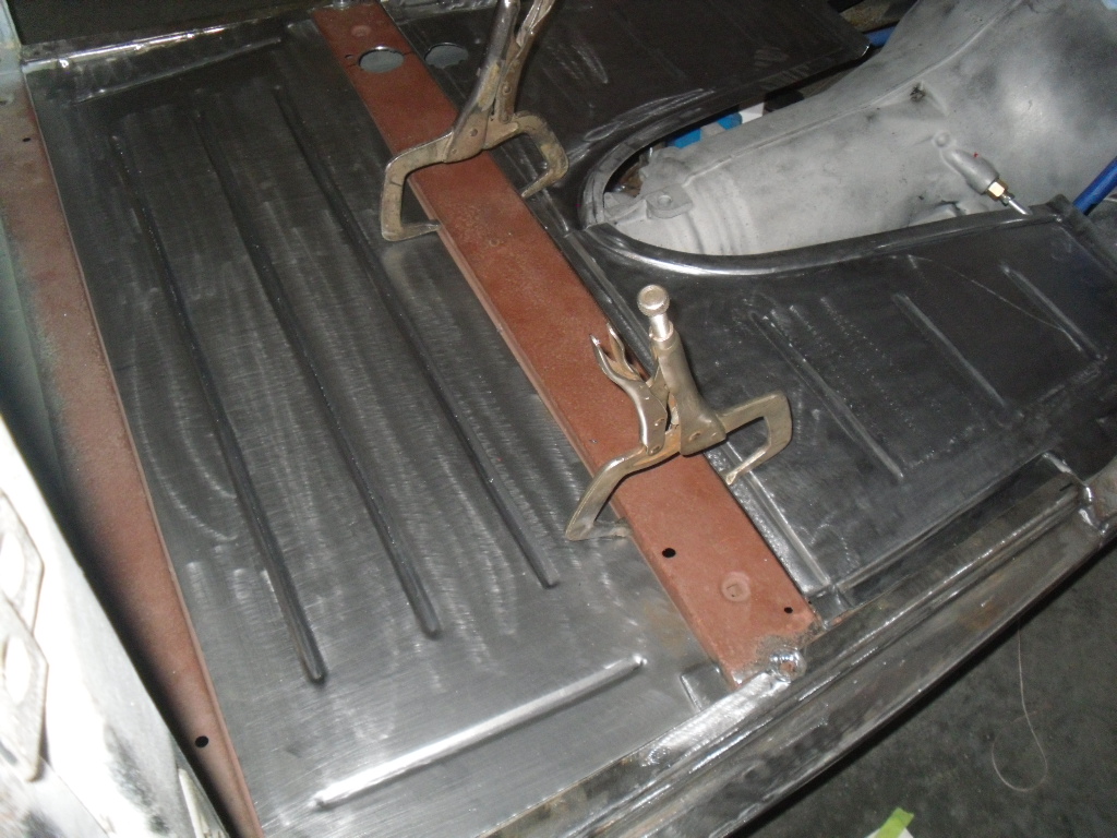

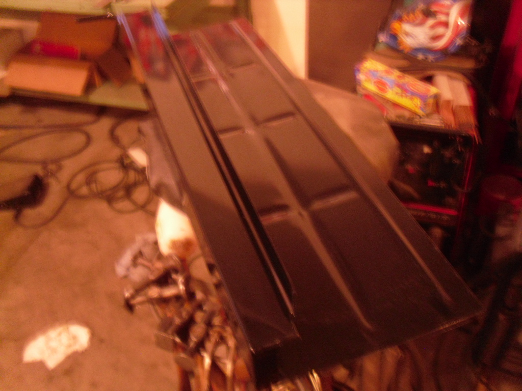

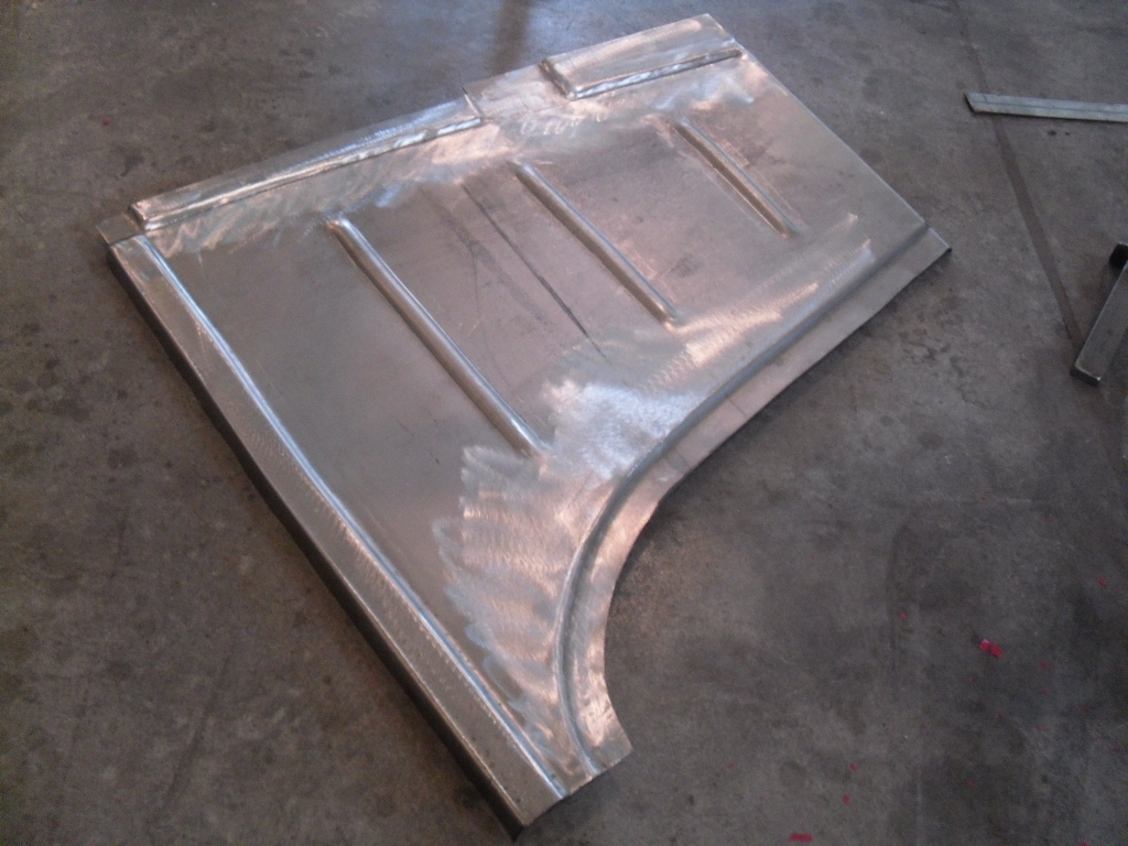

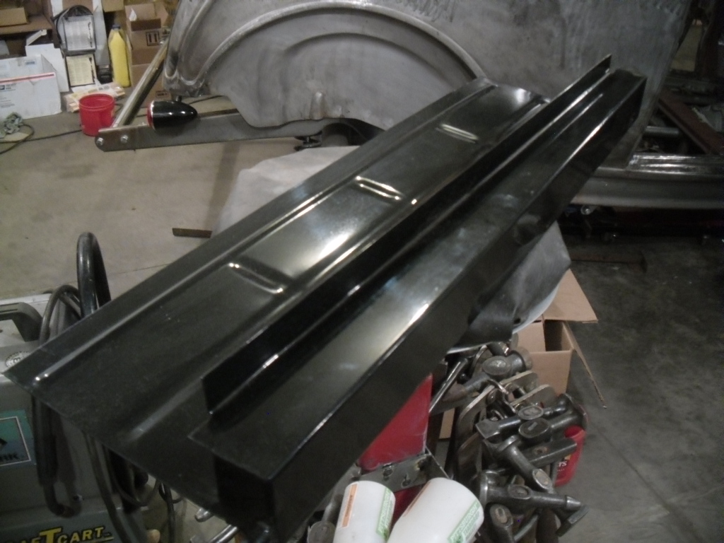

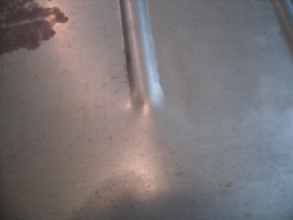

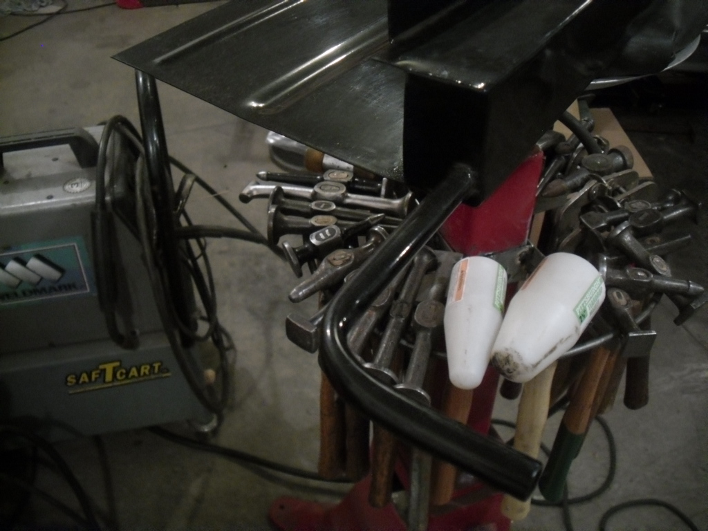

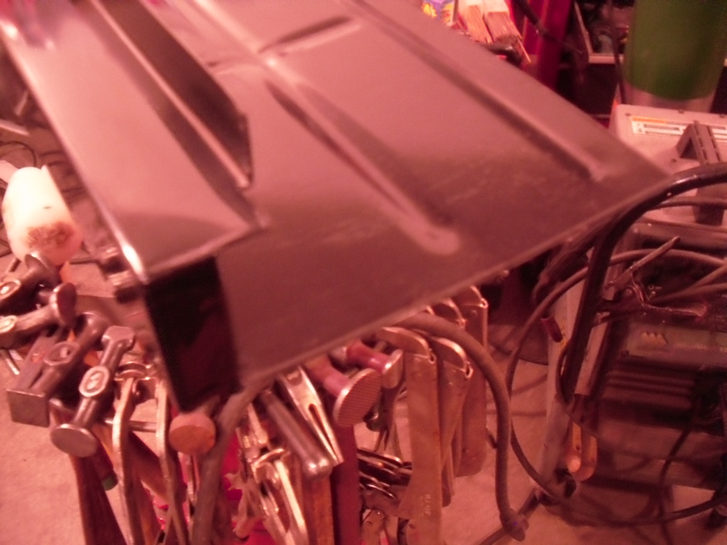

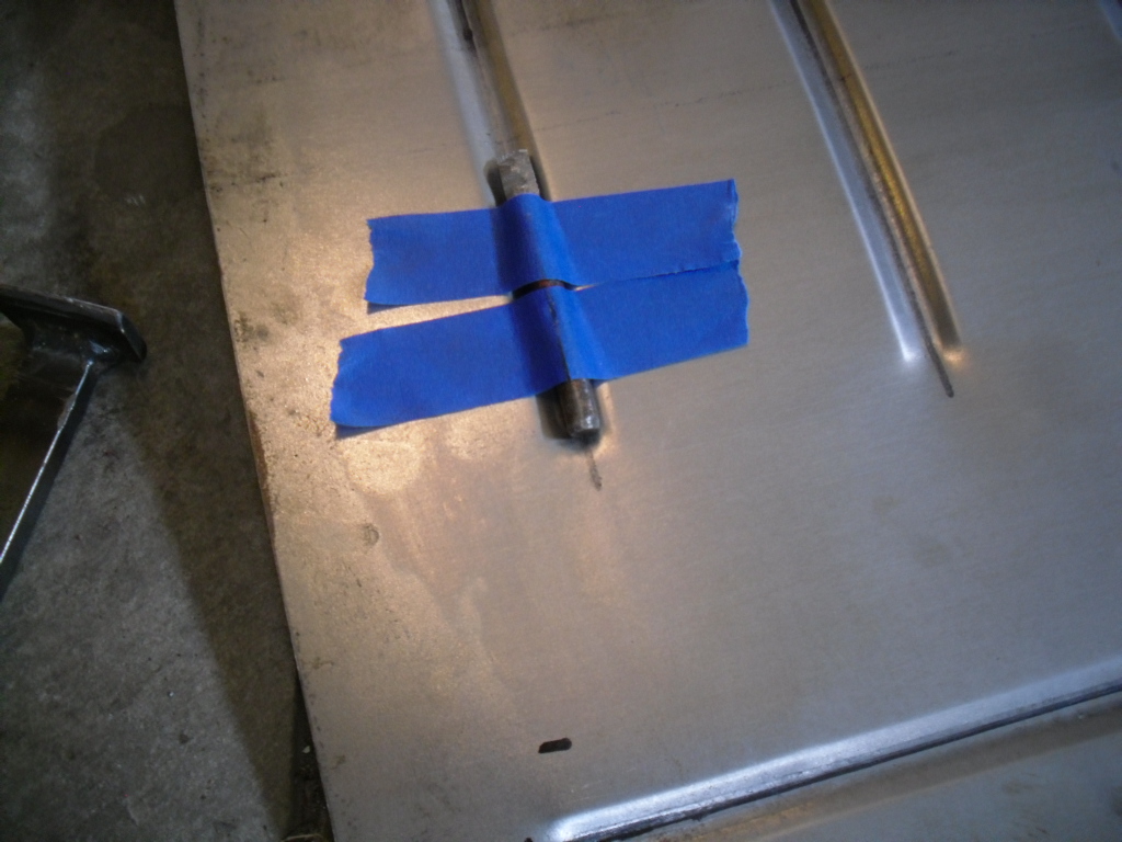

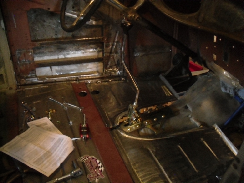

    Well it's been a while since my last post...Summer is almost gone and as with all of us life has gotten in the way of much progress until the last couple weeks.
    I finally started to finish the floor , for some reason this and the firewall have really been difficult for me.
    I have managed to make the center panel and the floor boards ( well sort of).
    I wanted to show how I made the panel as Henry did . Here are a couple of the tricks I have used .
    While the floor boards look cool I have decide to go another direction after installing the shifter .

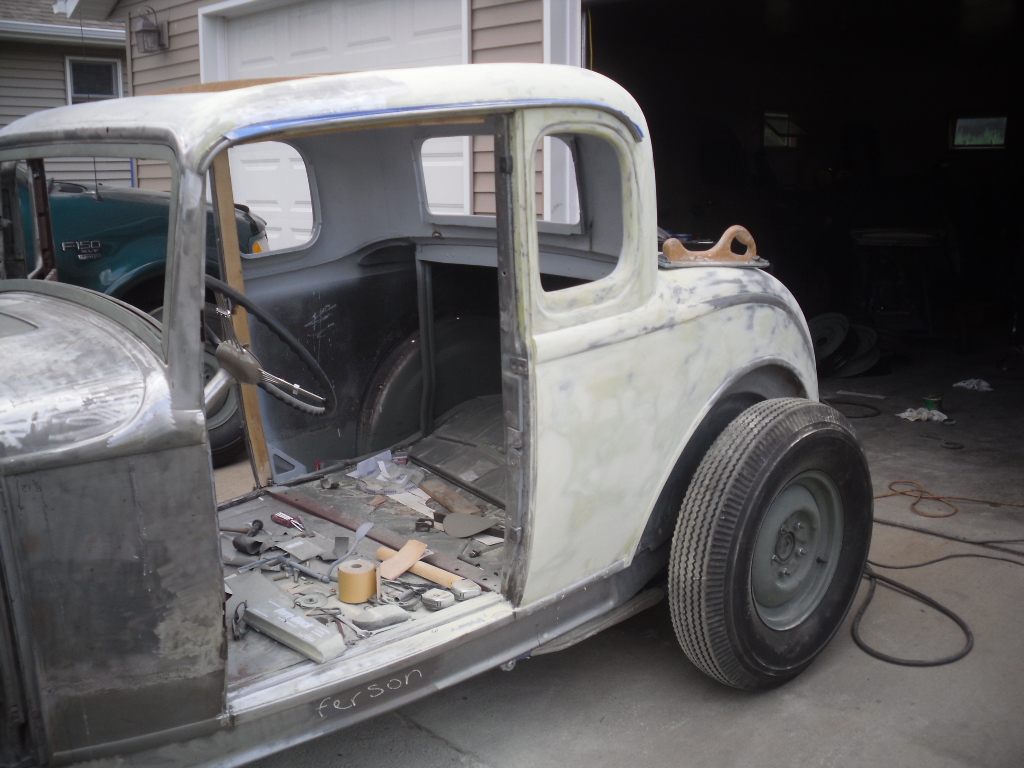

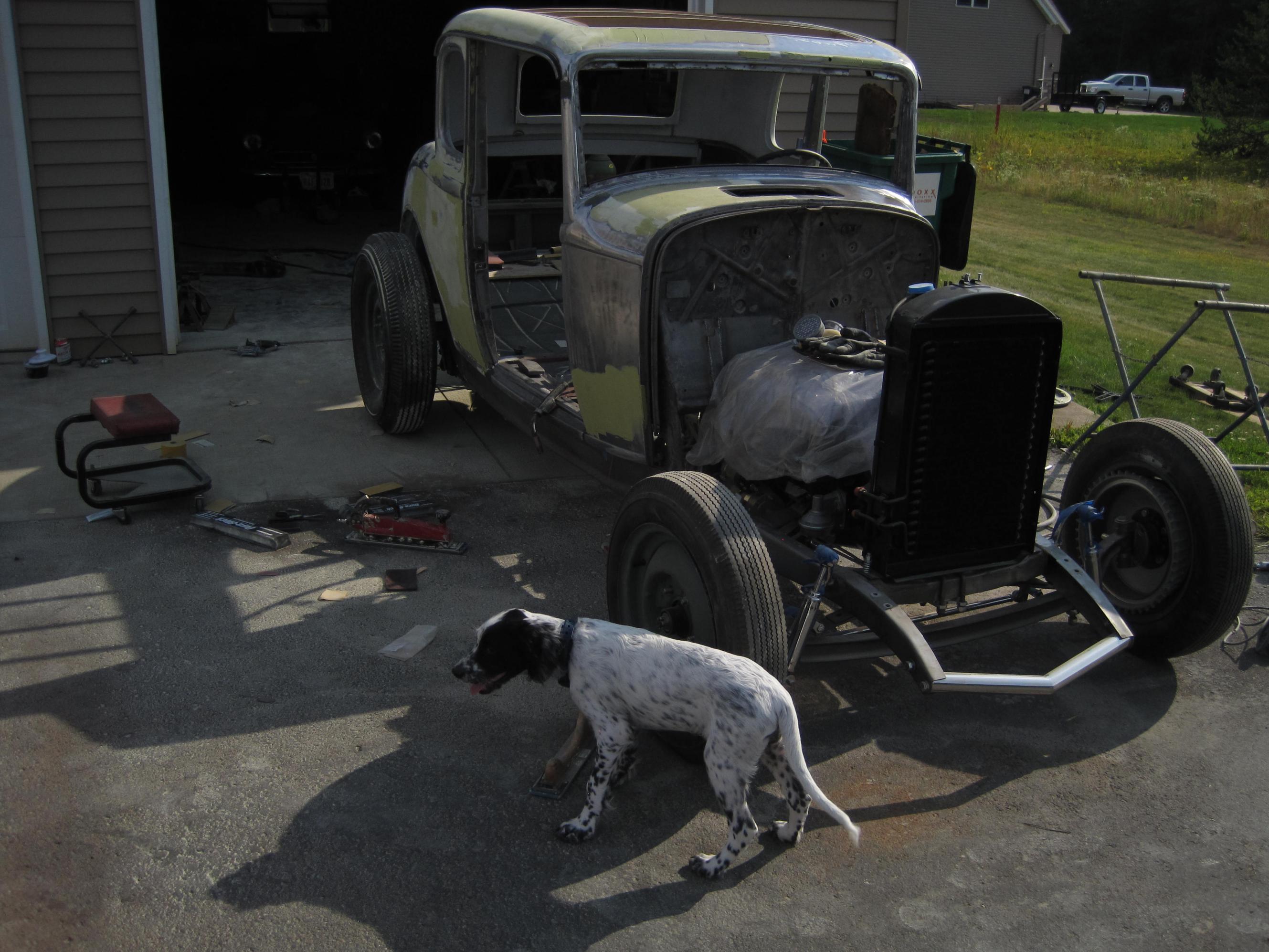

    Last weekend I started the body work. I began by using a metal claening wheel and then grinding/sanding the entire car.
    Here a shot or two of the body and then with the first applications of rage gold.
    ....lot's of sanding ...argh
    more pictures after the weekend...

    Thanks Guys, making good progress on the body today... in for a coffe break!

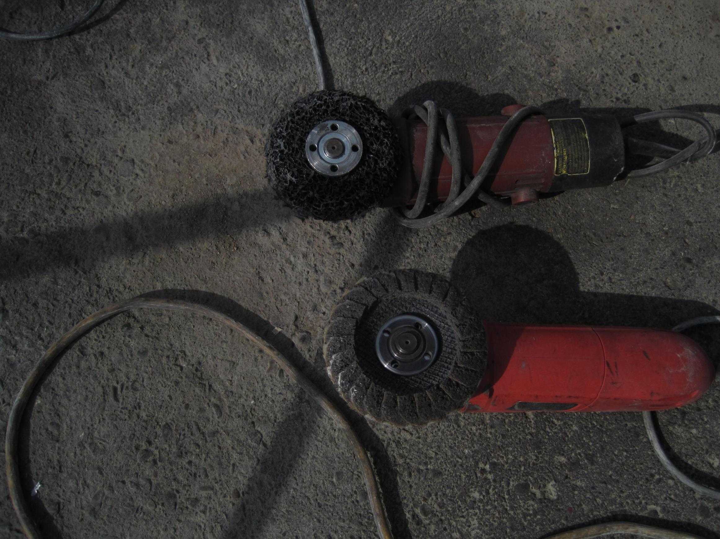

  18. Mart
    Posts: 5,007
    Mart
    Could I ask exactly what is a "metal cleaning wheel"?
    Thanks.

    Bob-really been about 6 months since I spent much time on the car...wife wants to see this thing done (and so do I)
    Mart -I will shoot a picture of the disc i am referring too tomorrow.

    Just came in for the evening... here the progress today....
    lot's of sanding....you could call it a bondo bucket..actually nothing is really that thick ...just a coat to get it straight.
    note the new pup was checking the proress out!

    from wisconsin
    Here are the disc's I use to clean the metal with
    2 are used with 4 or 4 1/2 electric grinders one with a 3" air sander.

    from pgh. pa.
    Where did you buy the discs?
