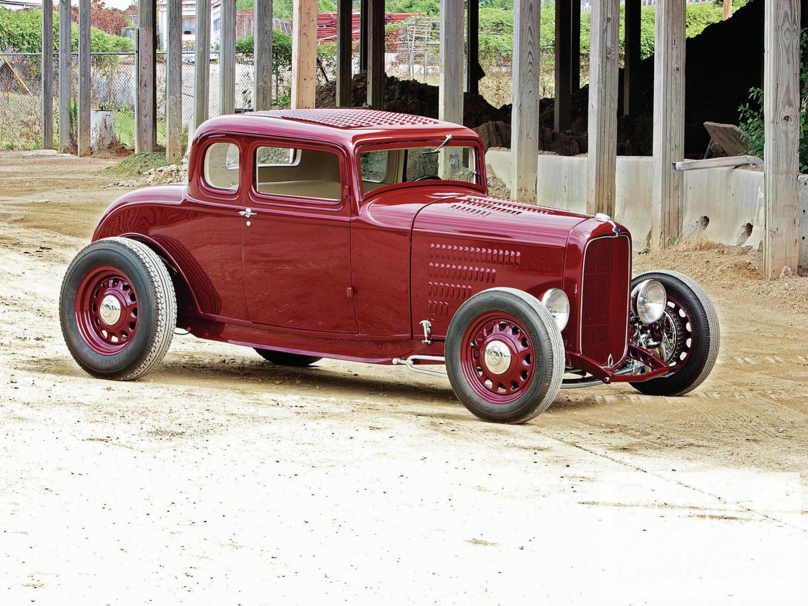

    As Brandon (Jalopykid) stated, tThe roadster I show is from Bruce's rod shop in spring Texas. I took the picture when I visited.
    You might try and contact Danny on the color , it is his dad's roadster.
    The other green is a picture i found on the web, really like that one too!.
    Here is a bronco green 1970, love this color in person took a shot a recent local car show.
    Can't figure out the maroon color , could use some help here.

    The green on that channelled coupe and the Bronco is kinda trendy right now. Lots of cars using the subdued green/gray paint. I bet it will be played out in a year or two.
    The red on the coupe is very close to a Ford Medium Red from the early 80's. Look towards the end of Geoking's thread about his coupe and he shows the code. It's one of my all-time favorites.

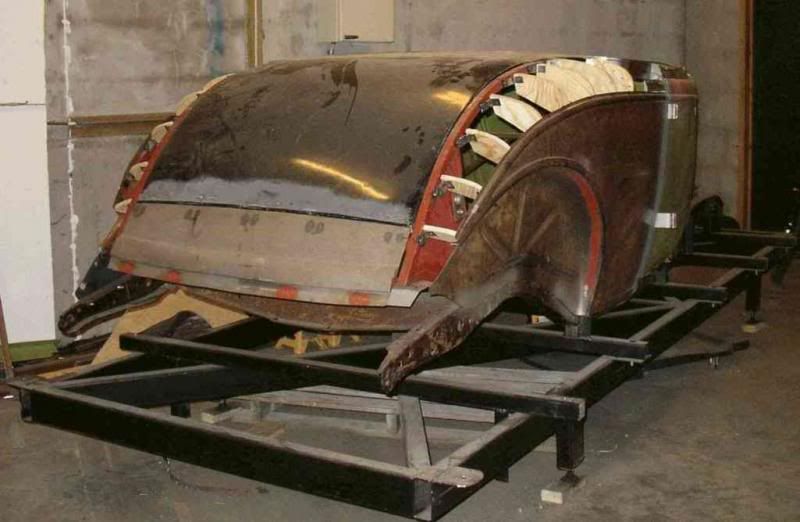

    rcnut233: Thank's for the kind words. I admit that I recieved some help with the back. I made plywood templates based on a fibergl*** car to a friend of mine, and then left the body to an english wheel expert. He rolled the two missing areas and I welded them on.
    Later I used the same jig to make a "dolly", too:
    I had heard that the frame wasn't stout enough to support the body during heavy bodywork.

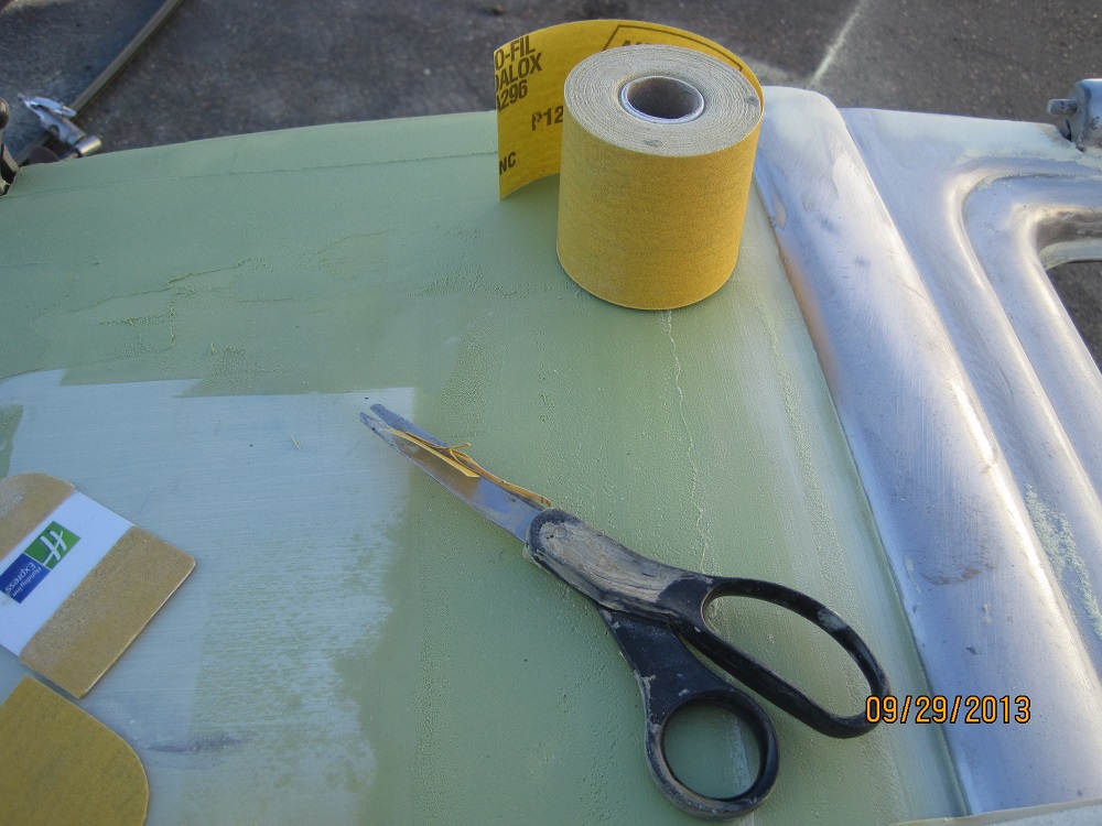

    During the bondo work I used dura blocks to sand the flat portions of the car. The 32 has more curves than any car I had worked on...
    As a result I had to get creative , here are some of the tools I used to sand the various shapes.
    Probably the most useful was the small foam blocks wrapped with sand paper , followed by the plastic motel door cards.
    I also folded paper over and cut the shape you see. Worked really well on the body lines around the windows
    Now I need to get the doors done!!
