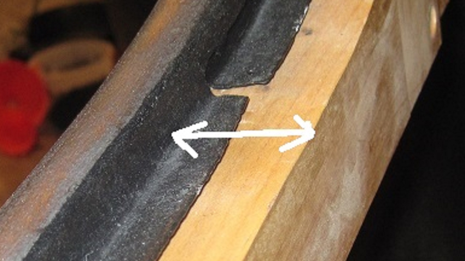

    Does anyone have the correct measurement for qtr window wood? I need the distance from the window opening the the outside of the wood.
    I am questioning the distance mine appears to be which is 1 3/8.

    Mine varies from 1 3/8 to 1 1/2 . Thankyou for the thread, and keep up the SUPER work!

    Is the upper wood flush with the qtr wood my is not and I think it is suppose to be.

    I appears that they should be flush, mine is +or- 1/16 in spots. But, if you were put together with wood screws and small brad nails fastened to tin for 70 years on bumpy roads, you would be a little "OFF" too. IS there a chance the repo wood kit may have different thicknesses?

    appears the curve is wrong on the top board, at least for my car. Interesting this is that the issue is more pronounced on one side versus the other, and the boards are Identical.
    I will install the qtr window wood and trim the upper to fit. I don't see any other solution.
