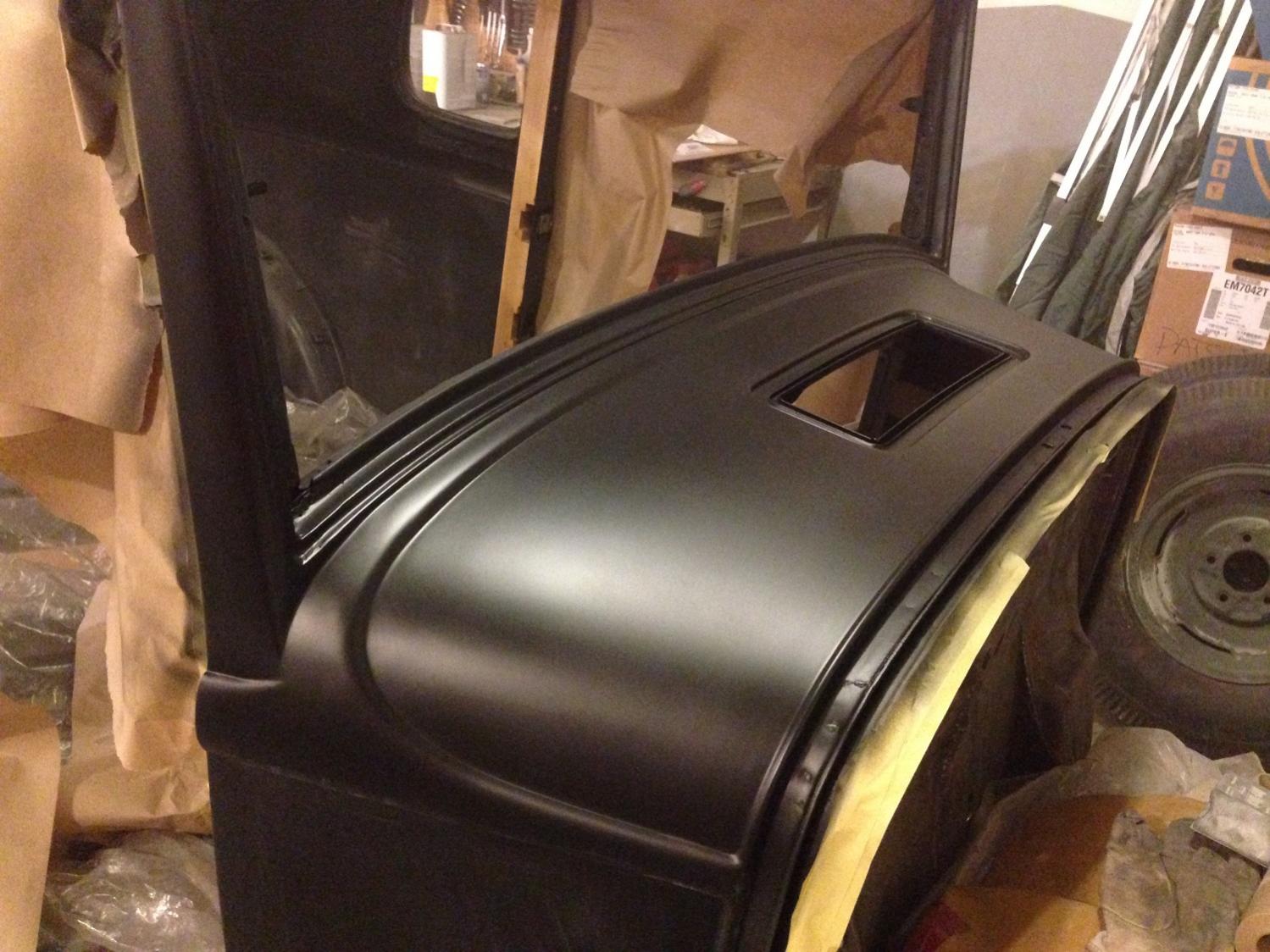

    Finnally finished the doors , primered them Sunday.
    Deck lids ready , should get that and another coat of primer on the rest of the body Saturday.

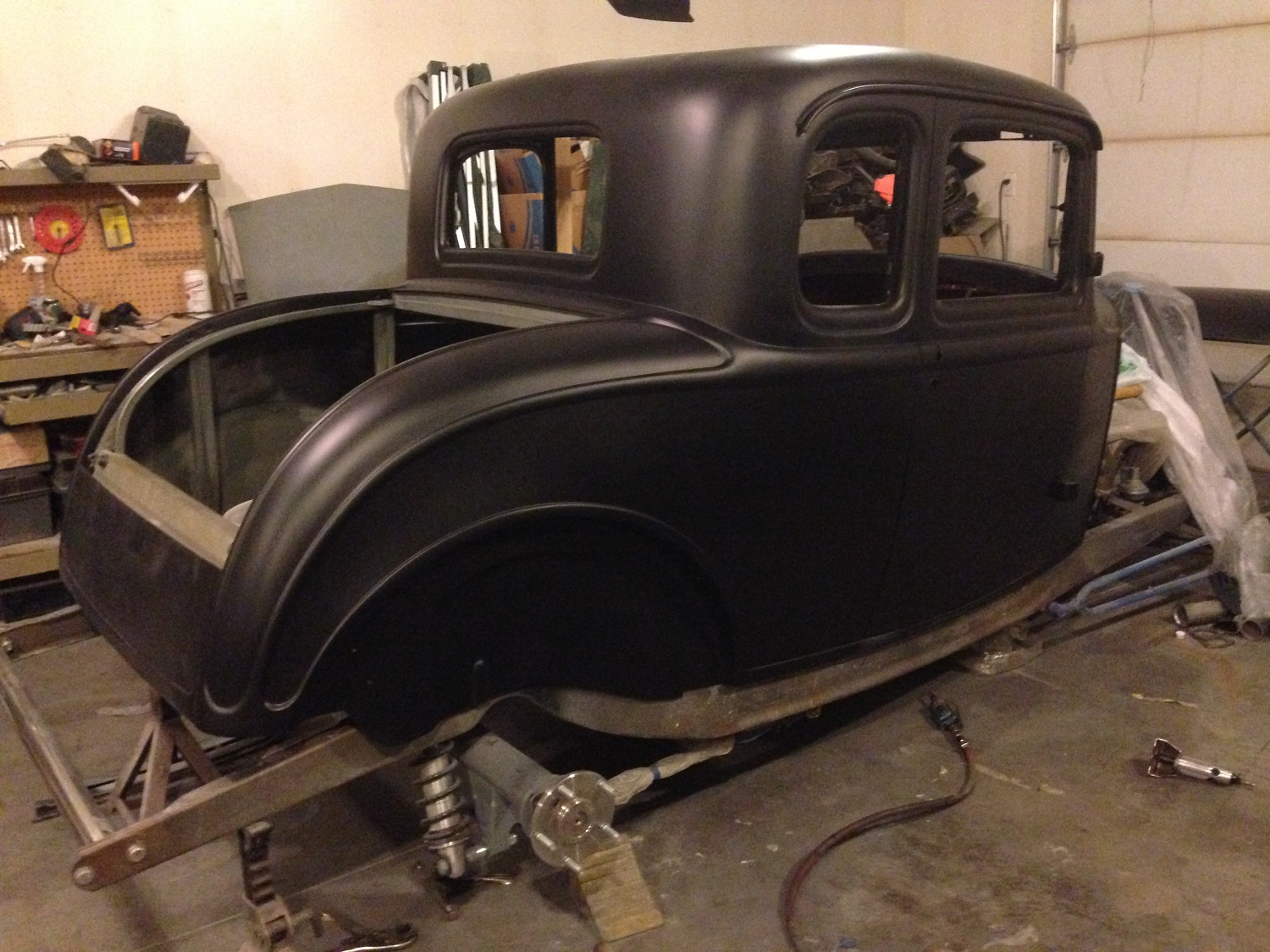

    Ok lot's more sanding and another coat of primer....Here is how she looks today.

    unmasked and doors on...
