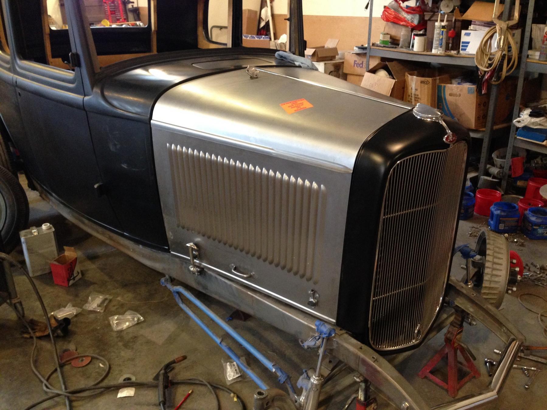

    Took yesterday off from work and had a chance to fit the hood and grille. Also made the rear hood latch bracket.
    Spent way to long on that portion of the project :).
    Bench seat brackets and final work on the firewall are next .

    Looking very nice Mike!! What would you charge me to do mine?

    I am so slow at this anymore that I can't afford myself !
    Mike

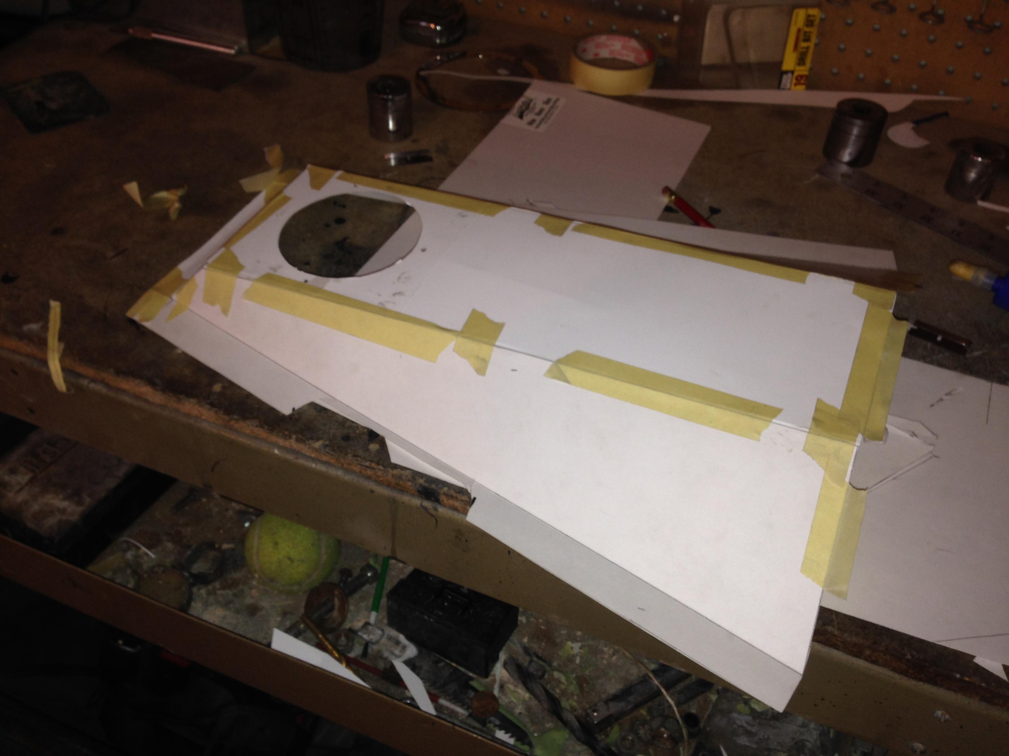

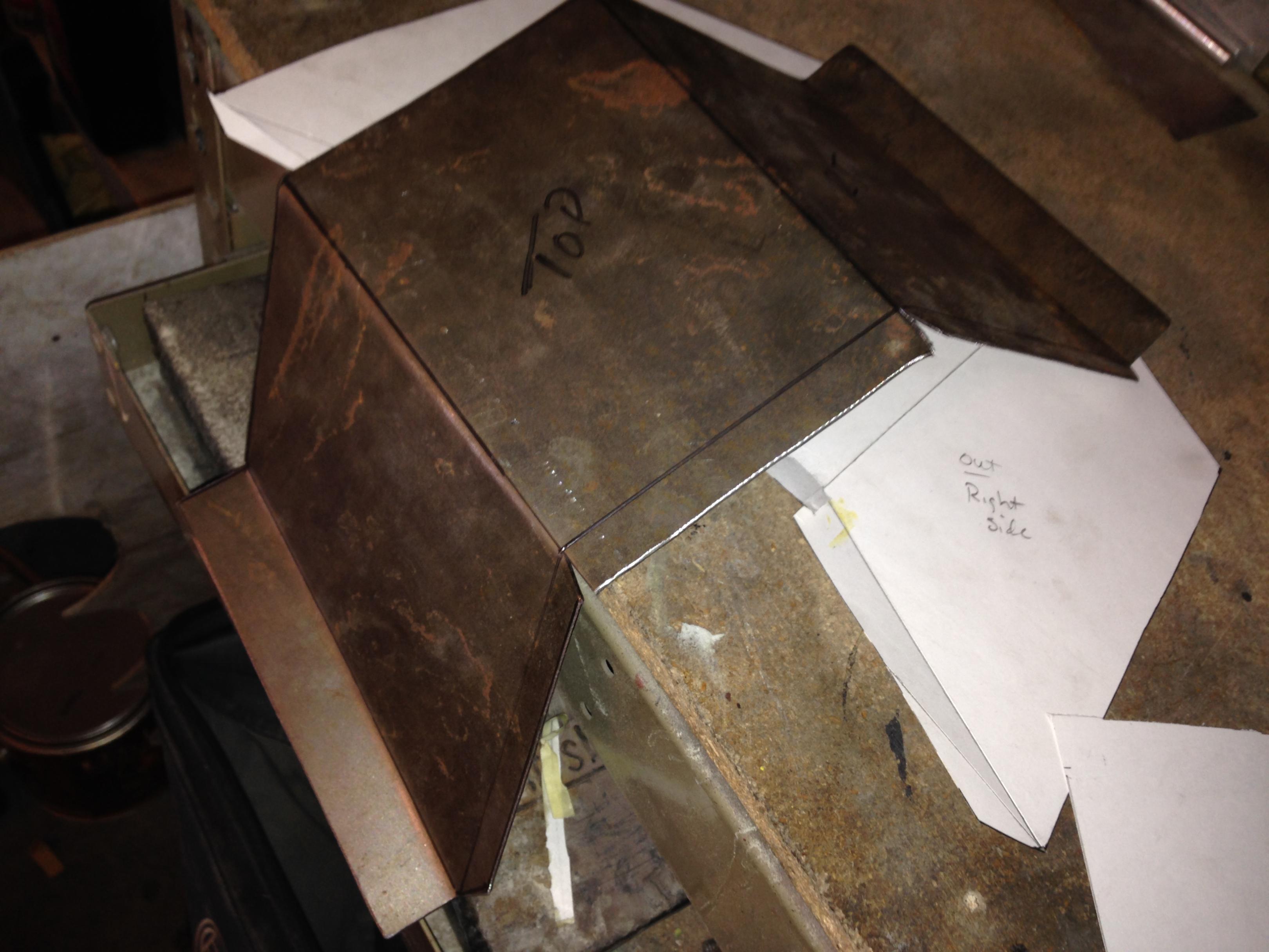

    Needed to add the trunk drains system.

    and another.
    I did not like the floor boards I made earlier , just did not fit right.
    Also needed to make the tunnel cover.
    Filled the holes in the fire wall , 43 in all.
    Also completely changed the cut outs in the wall as well.

    Nice work on the floor, i see you use notes on the patterns to help from making them backwards, I've learned to do it too.

    1959 Nomad ...yeah started marking these after I made a few pieces backwards when I was a bit younger!!
