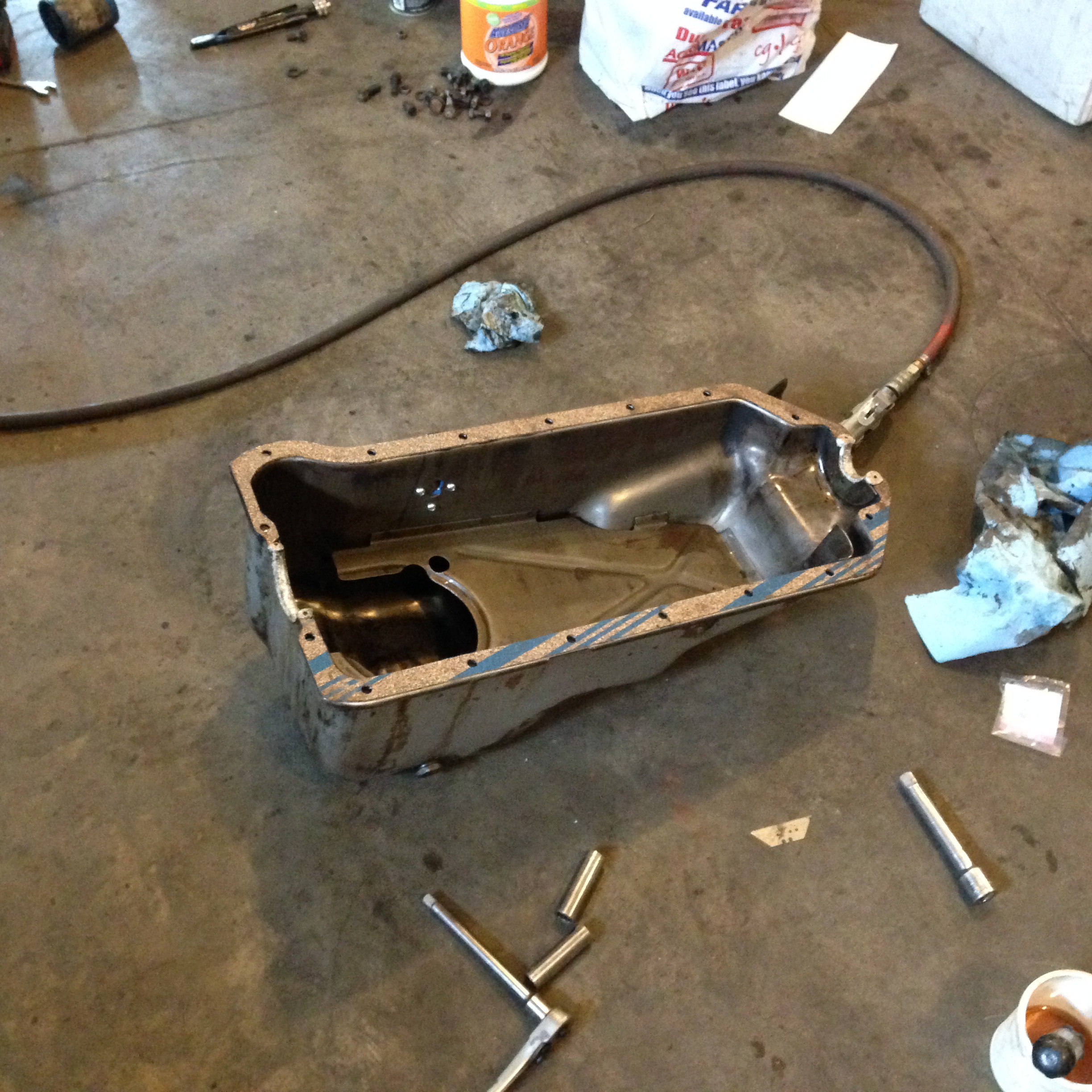

    here is the oil pan just before install

    She is hitting on 8 so that's a good thing. If she was holding water before then it still should. The old L-head blocks like to crack when they get too cold or too hot. Mercury dip sticks are marked with an 8CM part number so they are a bit different than a regular Ford or Ford truck. With the right length of tube (10-11/16" long with 7/16" worth of thread on the one end), you can fabricate a dip stick tube. The aluminum oil pan tube bosses are all the same in the 8BA family and you can use screws instead of rivets as long as they have a good quality locking nut on them.
