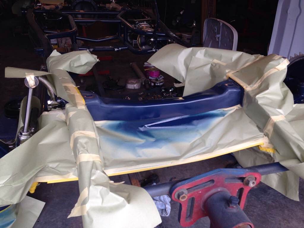

    Painted the crossmember tonight
    First few shots were at 6:30
    Now 10 and I am finished, in more than one way ...
    Onward and upward!

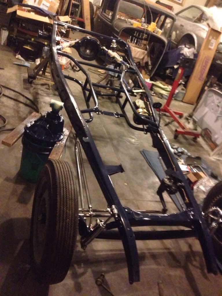

    On its wheels, well fronts at least !
    kidcampbell71 and mgtstumpy like this.

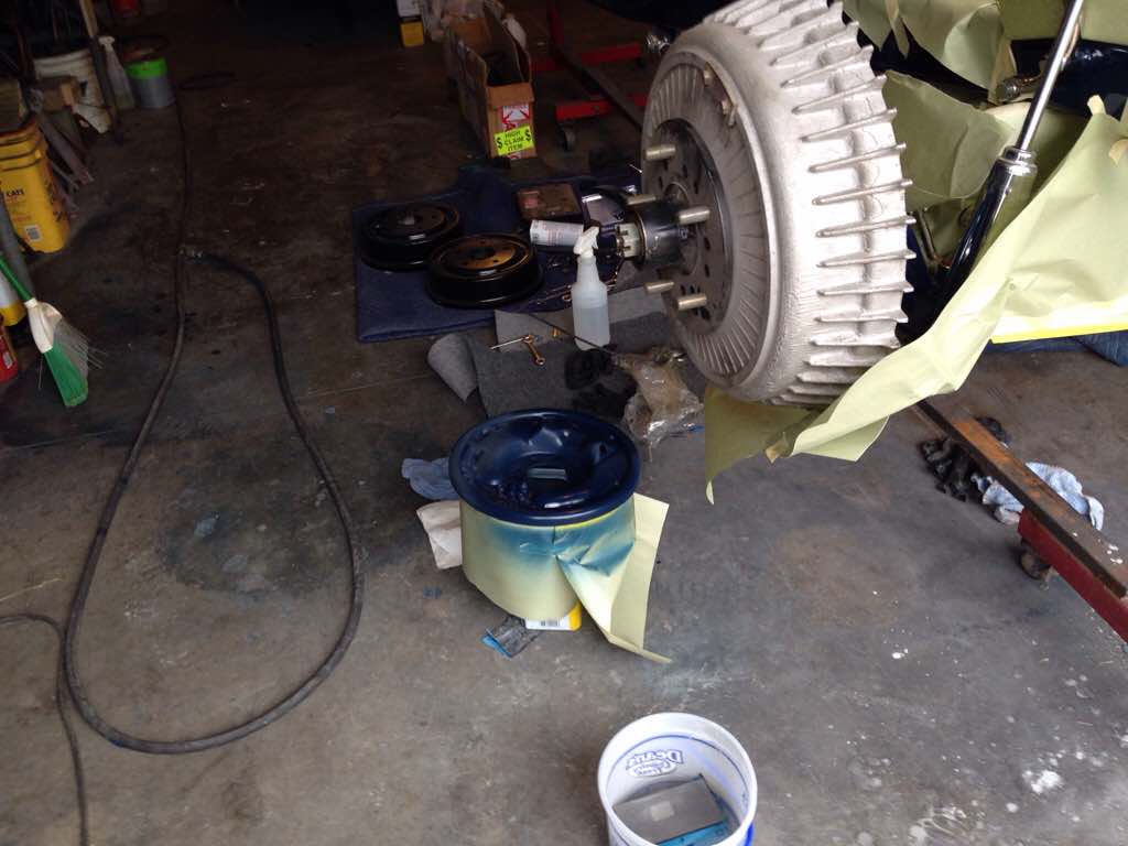

    Fun part was getting the darn thing off the engine stand rotisserie
    Good thing my boys are strong! I'm not anymore

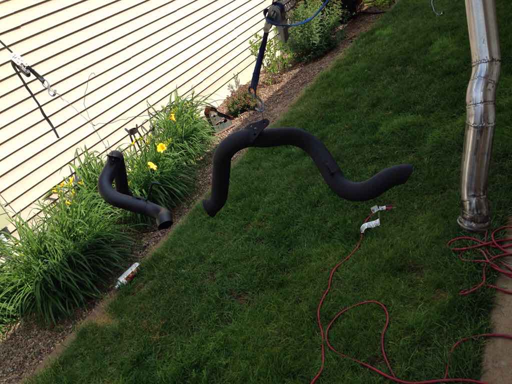

    Made significant progress this weekend

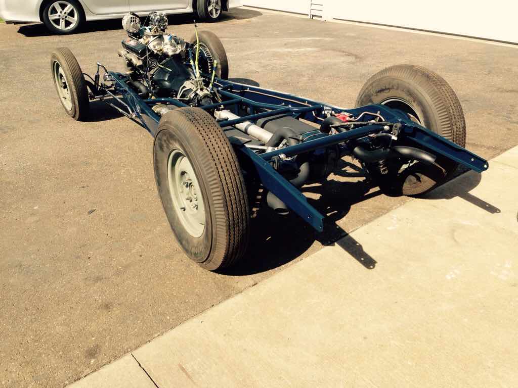

    ImageUploadedByH.A.M.B.1434932022.196826.jpg ImageUploadedByH.A.M.B.1434932039.533788.jpg
    Finished up the the exhaust and coated it
    kidcampbell71 likes this.

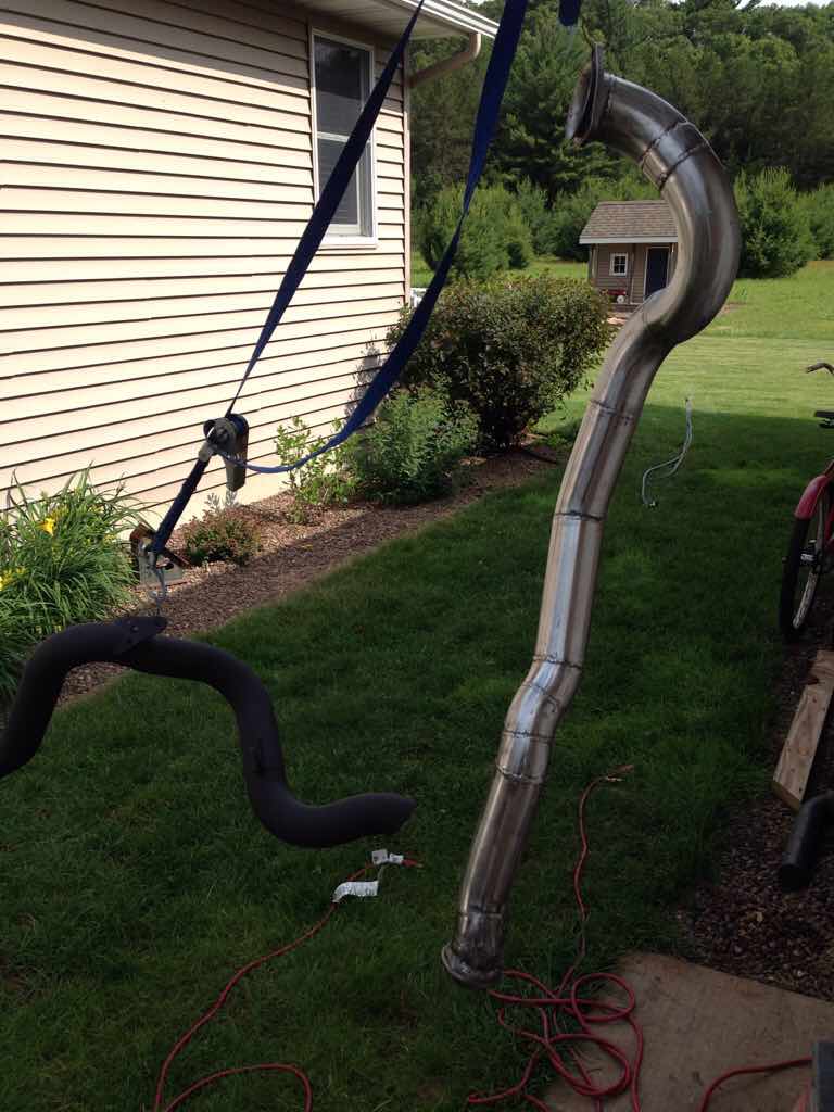

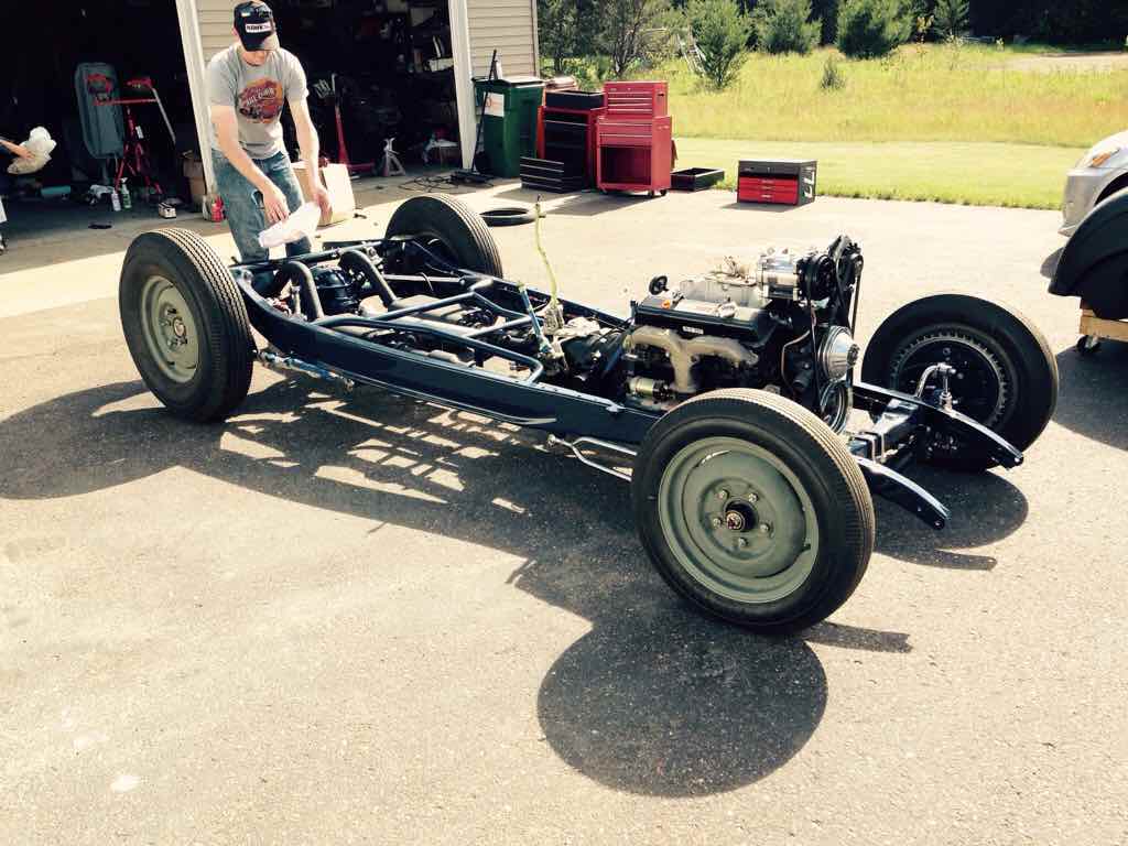

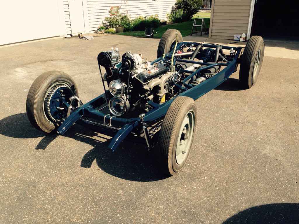

    Finished up the brakes,
    Having issues with the pads dragging, real bummer as I thought I sorted this out pretty well
    Installed the engine and exhaust ImageUploadedByH.A.M.B.1434932242.444875.jpg ImageUploadedByH.A.M.B.1434932256.725770.jpg ImageUploadedByH.A.M.B.1434932270.346666.jpg

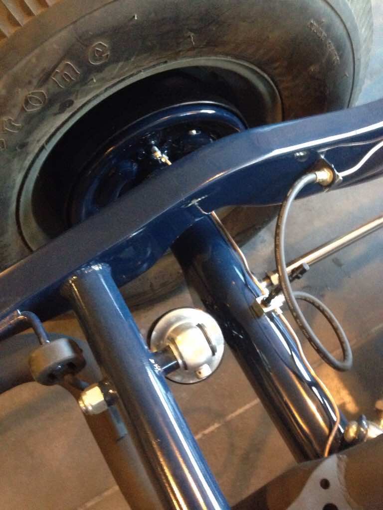

    ImageUploadedByH.A.M.B.1435117204.865074.jpg ImageUploadedByH.A.M.B.1435117215.914767.jpg ImageUploadedByH.A.M.B.1435117228.881620.jpg ImageUploadedByH.A.M.B.1435117244.285346.jpg
    Finished up the rear brake lines and park brake cable tonight
  25. greaser
    Joined: Apr 30, 2006
    Posts: 866
    greaser
    Could be the camera angle, but looks like possible brake line pinch point between top of rear axle housing and bottom of frame??
    This chassis is really taking shape quickly. Looking awesome!!
  26. rcnut223
    Joined: Oct 12, 2006
    Posts: 1,282
    rcnut223
    from wisconsin
    y

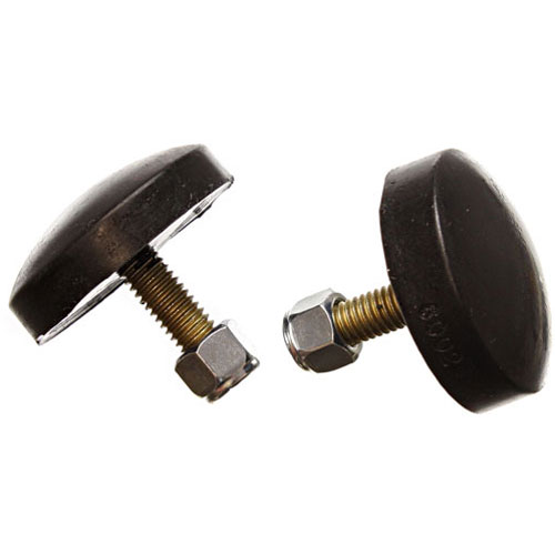

    You are correct, it possibly is, the coilovers should bottom before this hits at the brake line. I have not figured out how a bump stop to avoid the possibility of a pinch, working o that solution.
    Ideas?
  27. DDDenny
    Posts: 22,111
    These worked good for my boxed, c-notched chassis, just drill and tap frame and don't use the nuts, turn in real tight by hand bump stops.jpg .
    Energy Suspension makes them.
  28. alchemy
    Joined: Sep 27, 2002
    Posts: 22,546
    alchemy
    The best solution is to not run your brake lines on top of the axle. Also, make sure to place them in a location that won't get pinched should it ever need cinching down on a trailer.

    Alchemy, I looking into a solution for the clamp the holds the line on the right side, that is were the issue comes in. It's on the top and in the middle of the axle.

    ImageUploadedByH.A.M.B.1435457520.100759.jpg ImageUploadedByH.A.M.B.1435457533.749863.jpg
    Thanks for the watch out on the brake lines
    Here is the fix
