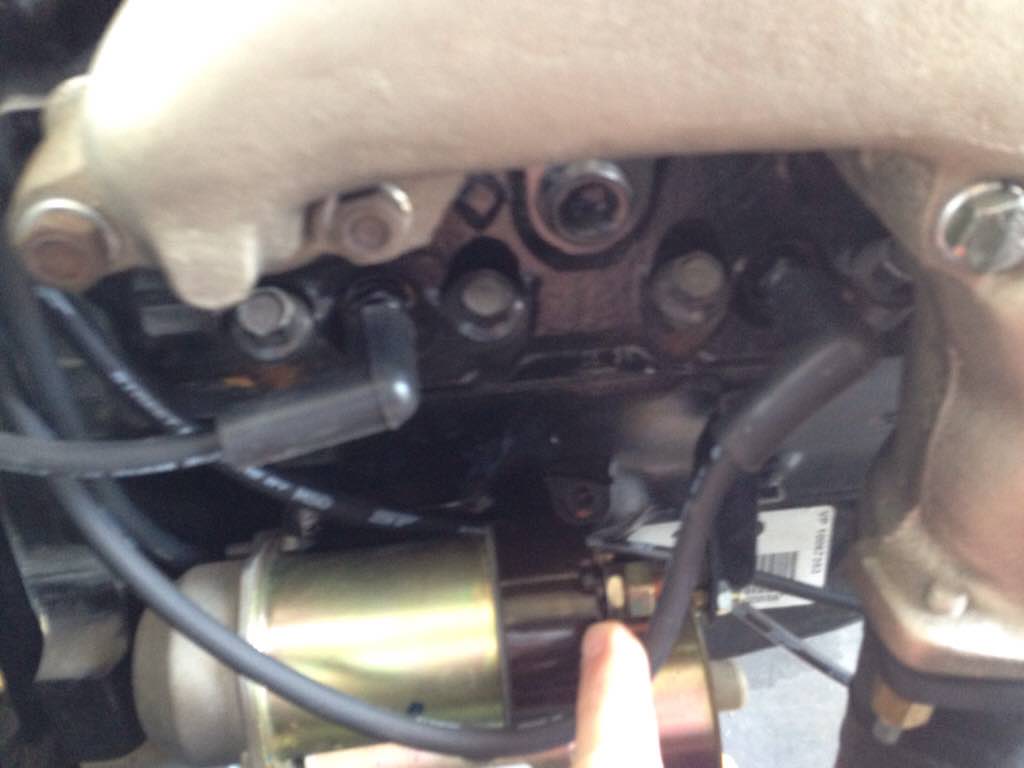

    Hit a bit of a snag
    Installing spark plug shields , hole for shield for 6 and 8 was not drilled and tapped ImageUploadedByH.A.M.B.1437532392.451890.jpg ImageUploadedByH.A.M.B.1437532413.452157.jpg
    kidcampbell71 likes this.
  11. rcnut223
    Joined: Oct 12, 2006
    Posts: 1,282
    rcnut223
    from wisconsin
    Bought an angle drill, and drilled and tapped the block
    did not want to pull the motor
    Worked out well

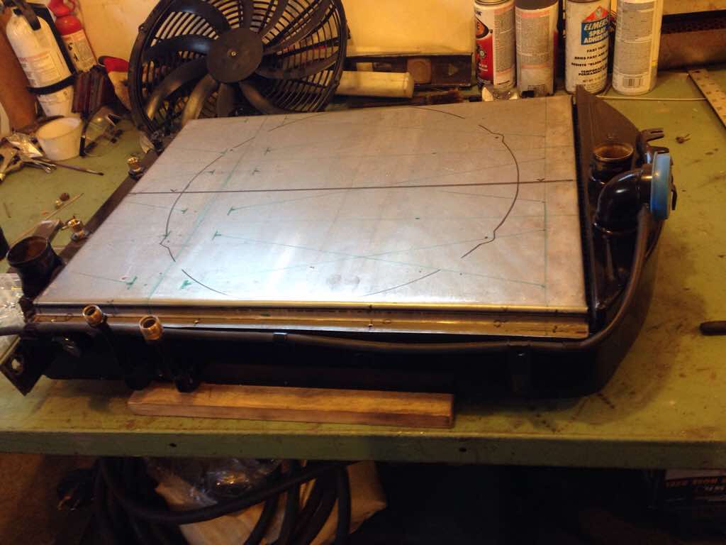

    ImageUploadedByH.A.M.B.1437877324.518131.jpg also worked on making a fan shroud today
    Used 18 gauge sheet metal
    kidcampbell71 and mgtstumpy like this.
  15. rcnut223
    Posts: 1,282
    rcnut223
    from wisconsin
    ImageUploadedByH.A.M.B.1437877509.480516.jpg ImageUploadedByH.A.M.B.1437877532.680949.jpg
    Here's 3 hours worth of work

    ImageUploadedByH.A.M.B.1437962046.929749.jpg painted up real nice and
    .., it won't fit !

  21. You're not worried that's going to block a whole lot of air from flowing through? The electric fan only operates when crawling in traffic or stopped, other than that the rad relies on flow.
    Just a thought.
  22. Some shrouds build in a flap so that the air can escape at speed
  23. rcnut223
    Posts: 1,282
    rcnut223
    from wisconsin
    Guys
    Been out of pocket for a few days
    The fan hits the water pump pulley
    Going to have to punt On the shroud all together
  24. If you can mount the fan hard against the rad, with pump clearance, you'll be fine.
  25. rcnut223
    Posts: 1,282
    rcnut223
    from wisconsin
    yes
    The depth of the shroud was the problem. I do need to move it up to the top of the radiator.

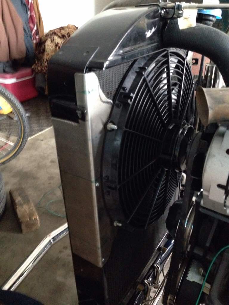

    from wisconsin
    ImageUploadedByH.A.M.B.1439160872.573105.jpg ImageUploadedByH.A.M.B.1439160887.888551.jpg
    Made some progress over the last few days
    Here's the new fan mount setup
