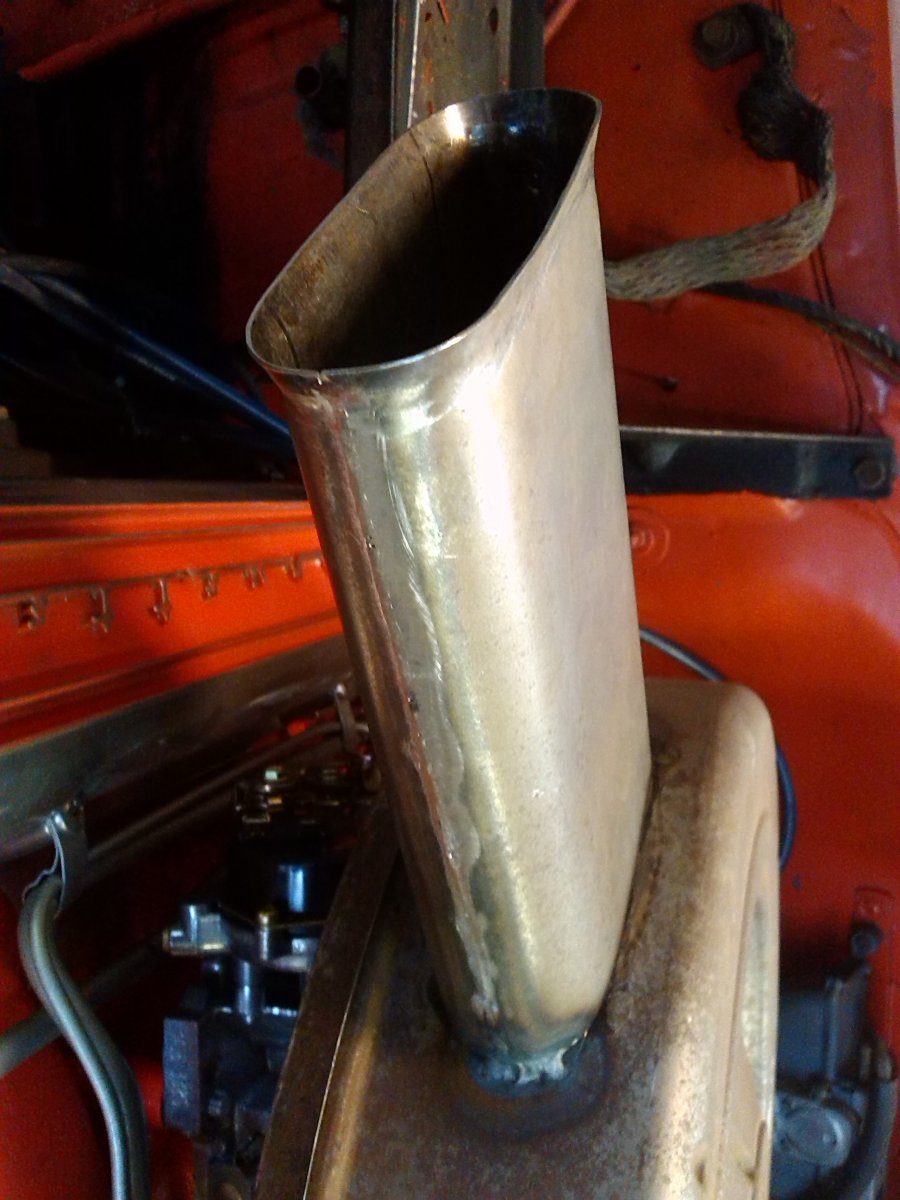

    The air cleaner snouts are simple to make. I made this into a dual snout.

    Dyce looks great , I could use one
