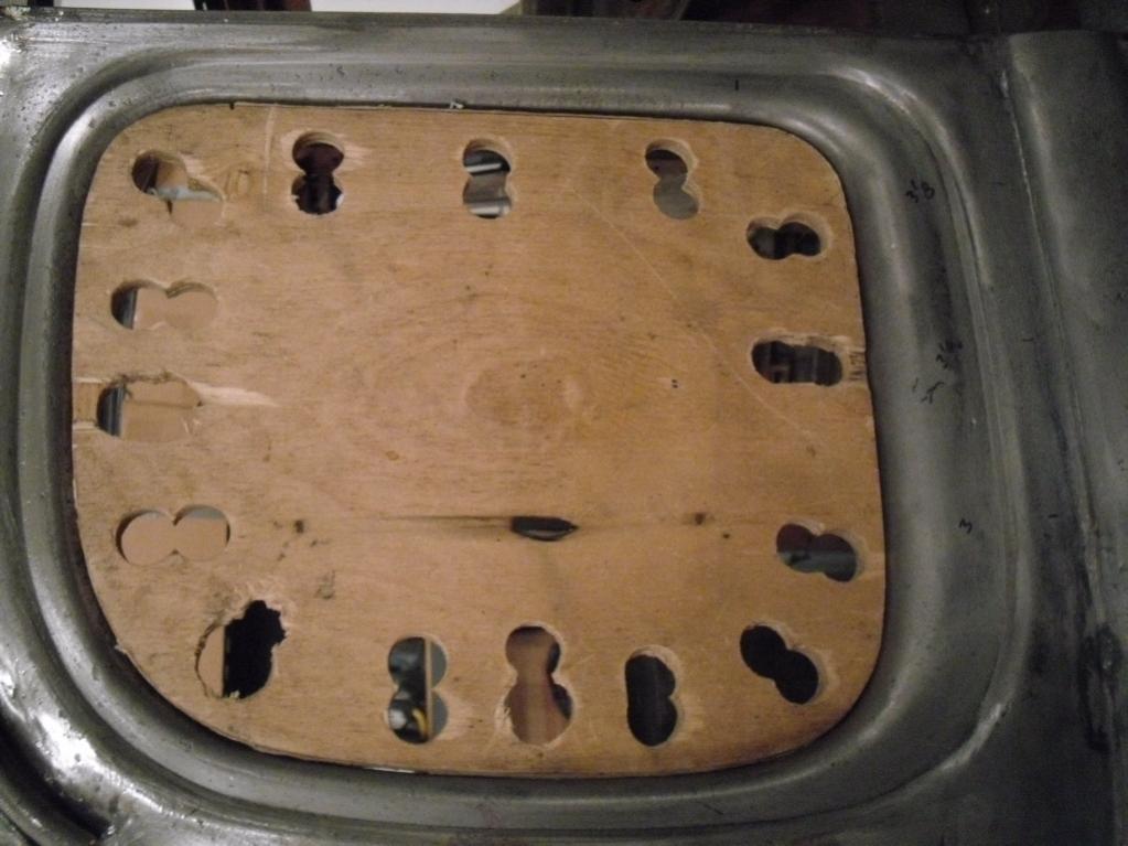

    I made a pattern for the qtr window out of plywood. the holes will allow me to use small clamps to hold the piecies of the window together.

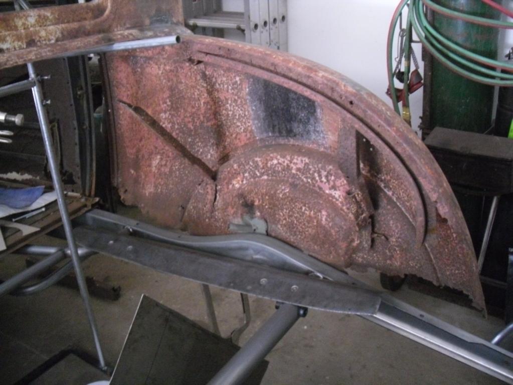

    I built a stand to hold the Qtr panel from flopping around in the wind.
    With the door posts tacked in place I have something to get some perspective on the project.
    I riveted the front of the qtr panel to the door post and overlapped the 4dr roof and qtr and help in place with a vise grip.

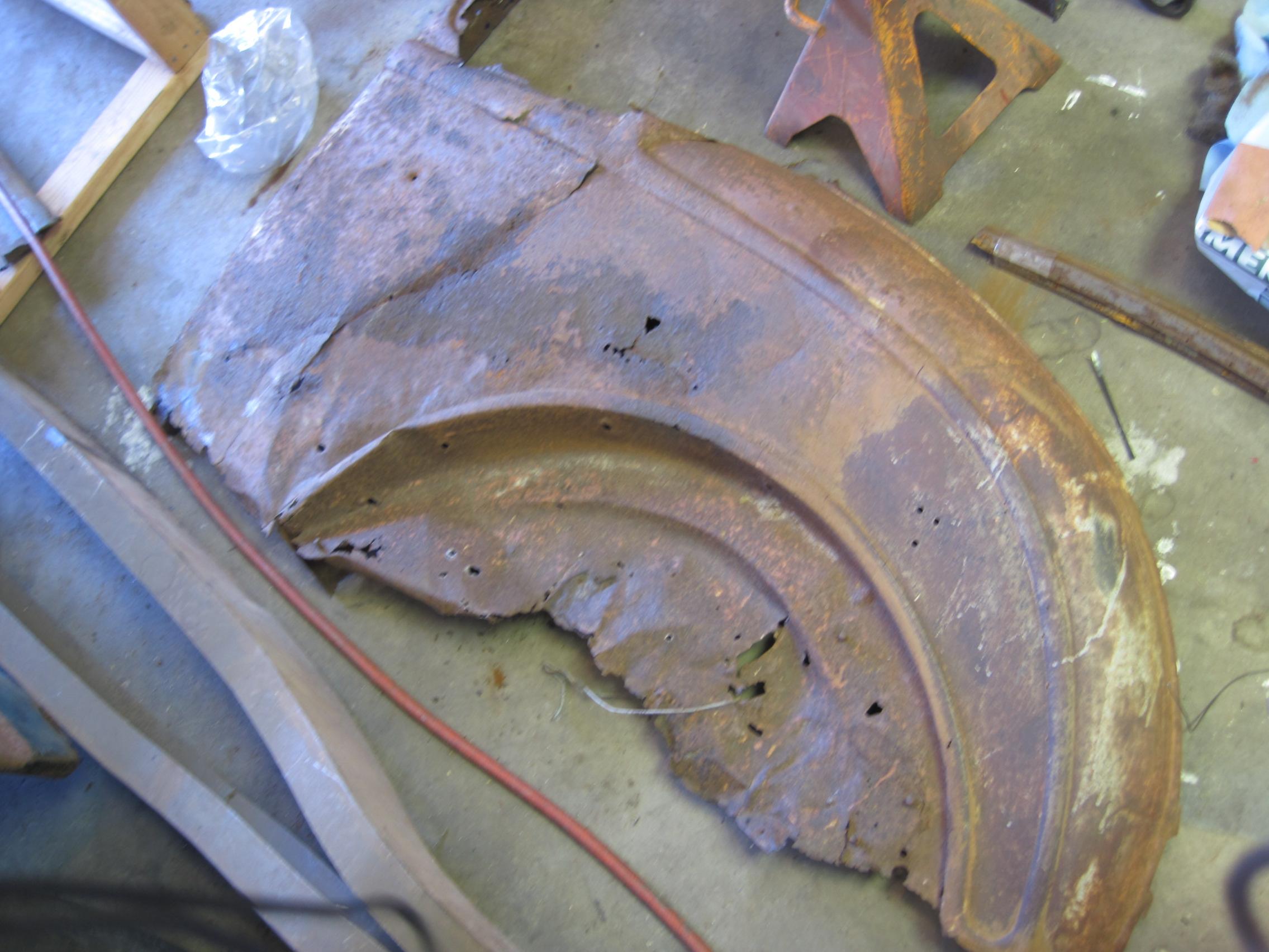

    some of you may have noticed the left qtr panel sitting on the floor. This came witht the rt qtr I purchased.
    It's very badly damaged from laying on the ground. It resembles swiss cheese, and is paper thin.
    The rear Qtr came out of TX orig****ly. story goes it was found in a pasture. Owner before me bought it and hauled home to Louisiana. No idea where the door and cowl came from, not part of the qtr orignally.
