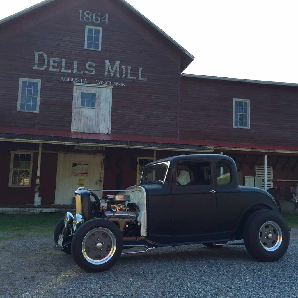

  21. rcnut223
    Joined: Oct 12, 2006
    Posts: 1,282
    rcnut223
    from wisconsin
    Hi guys
    Here's a shot of it on the road this summer
    Rear 3rd member was swapped for a new one !
    mgtstumpy, greaser, kiwijeff and 11 others like this.

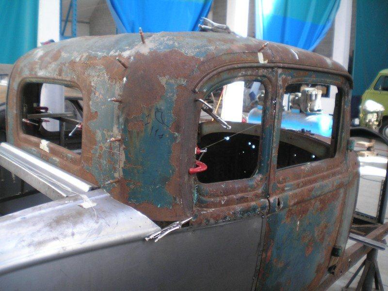

  23. rcnut223
    Posts: 1,282
    rcnut223
    from wisconsin
    Thanks Gary, glad to hear this old thread is helping you and your friends
    I learned a lot and made many friends doing this project !
    As for the roof
    Let me see if I can find a picture that shows you what I mean
    But to verbalize :
    Sedan roofs can be used on a coupe but you will need to remove some of the area behind the side windows as well as the reveal. It's Fat so to speak when you look at them from the side
    On the top behind the rear roof opening it's a little long as well, this is easy to deal with
    Mike

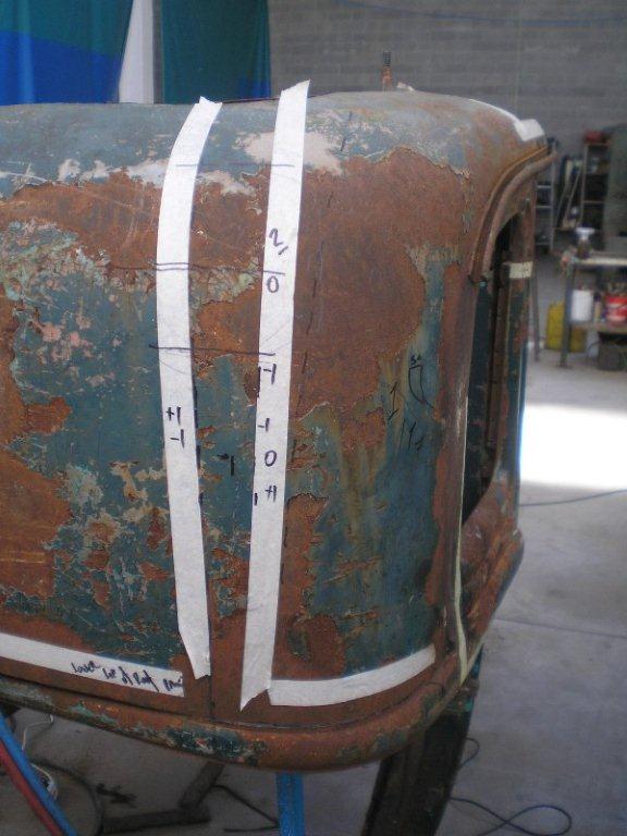

  25. rcnut223
    Posts: 1,282
    rcnut223
    from wisconsin
    Gary

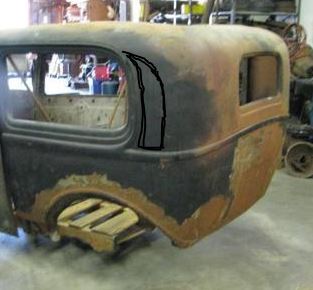

    Here are a few shots of a coupe roof and a sedan roof . This will give you a perspective on the differnce.
    The last image shows the are that will need to be removed (parden my wiggly fingers). It's not exact but it give you the idea.
    I will look for the actual images i have for this operation tomorrow evening.
    Thanks Mike

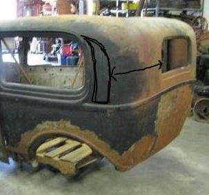

  26. rcnut223
    Posts: 1,282
    rcnut223
    from wisconsin
    Here is the key cut line shown on a coupe. I have also shown the key measurement you need off a coupe (arrow to arrow ). For what it's worth , in my opinion it would be easier to cut a fordor than a tudor sedan.
    kidcampbell71, 509garyd and loudbang like this.

  29. rcnut223
    Posts: 1,282
    rcnut223
    from wisconsin

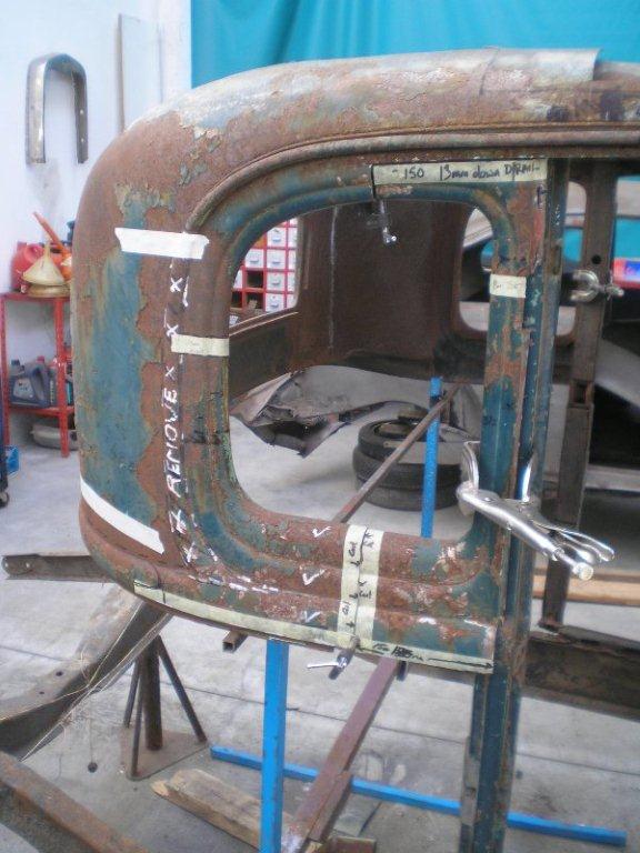

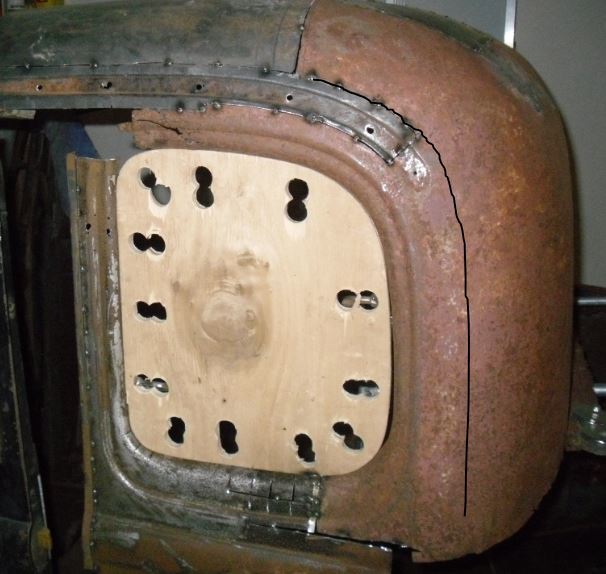

    Here are the pictures I was talking about
    I will let them speak for themselves
