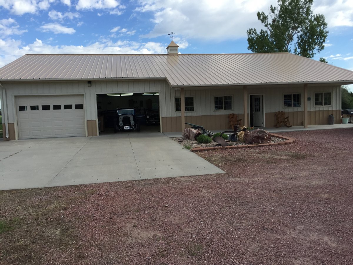

    I really like the Scottsbluff area . The drive on the other hand is too long! With a 40-50 Mile an hour cross wind it was tiring
    Thanks for the compliments on the car!

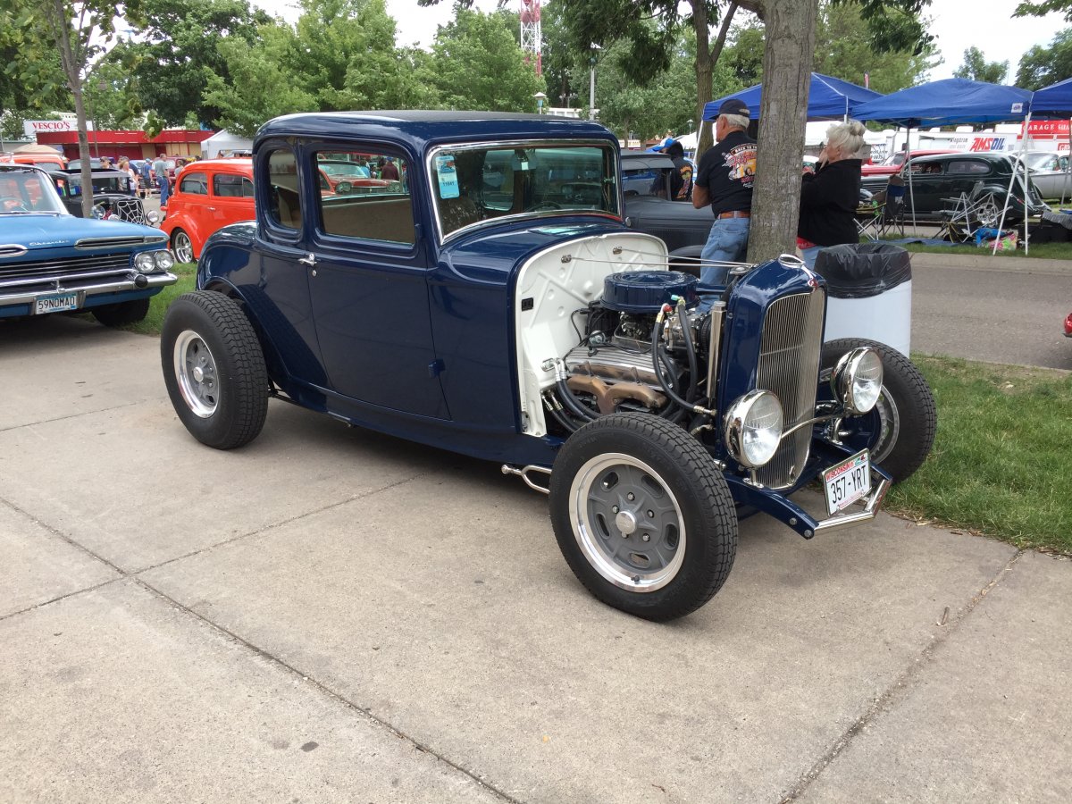

    Pictures of my car at back to the 50's in Minnesota.

    With my car parked behind you:cool:

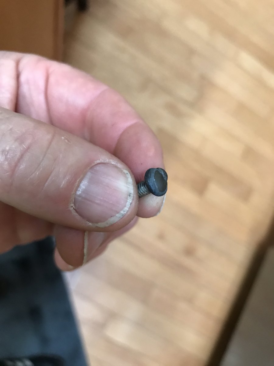

    IMG_0401.JPG IMG_0379.JPG ] Haven't put the hood on the car because I could not find threaded rivet head screws. I've spent hours trying to source these to no avail
    Saturday I decided that enough was enough . I bought #8 -32 screws in stainless both truss head and standard
    Too start I tig welded the Phillips head .

    Next I mounted the drill in the vise chucked up the screw and went to town IMG_0405.JPG IMG_0406.JPG IMG_0408.JPG

    IMG_0412.JPG IMG_0402.JPG I used 80 and 120 on the grinder and then progressed through the sand paper. I wound up leaving the sandpaper on the roll for support

    Wound up welding 12 to IMG_0383.JPG get 8 , I was happy with.
    The final product, screws with rivet heads and kep nuts on the back side
