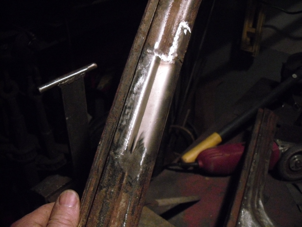

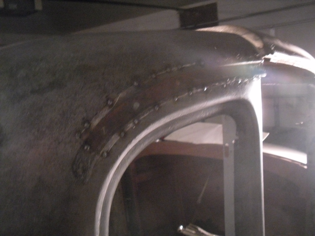

    the front of the qtr window is the front window post from a 32 ford tudor sedan. It was rusty but repairable. Here's a few pictures of part of the repair.

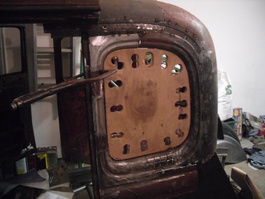

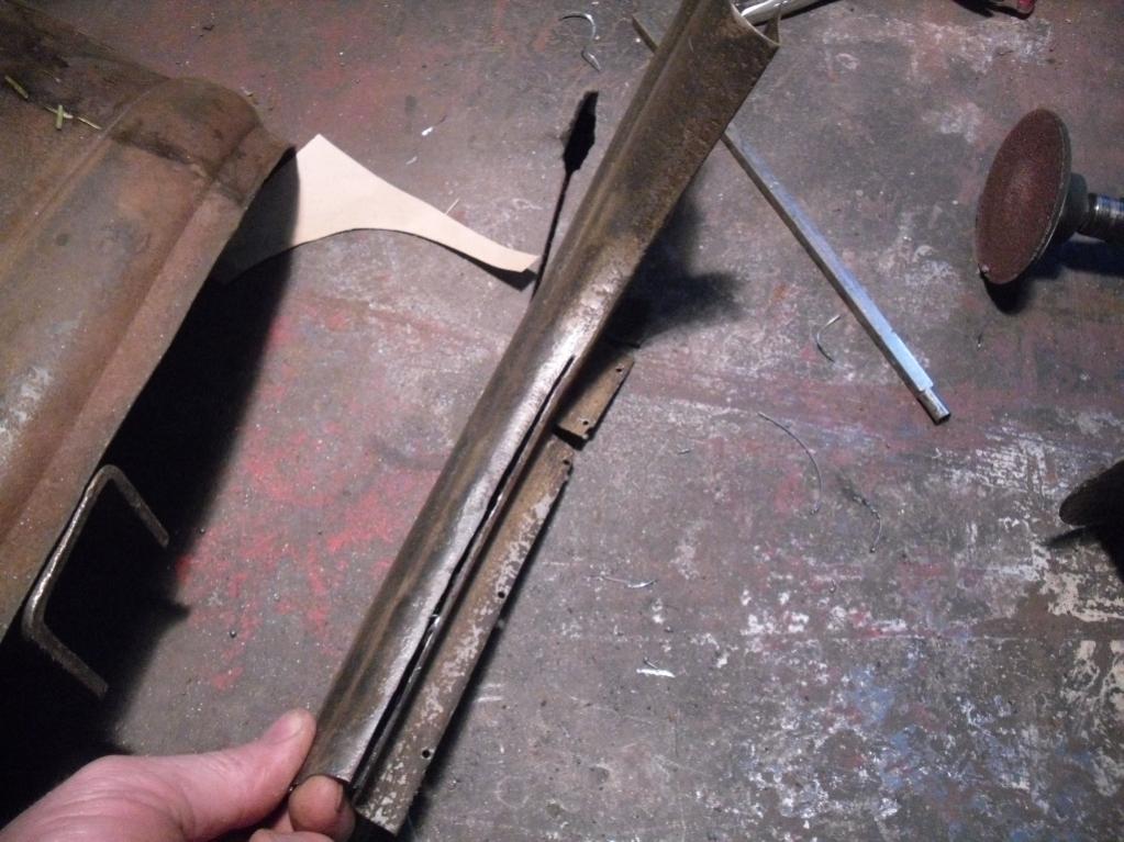

    I was fortunate enough to find a gentleman that was replacing the roof on 2 door sedan and purchase the cuthoffs fom the door posts from him. these are very close to the coupes window opening at the front. Close enough that they can be modified to fit.

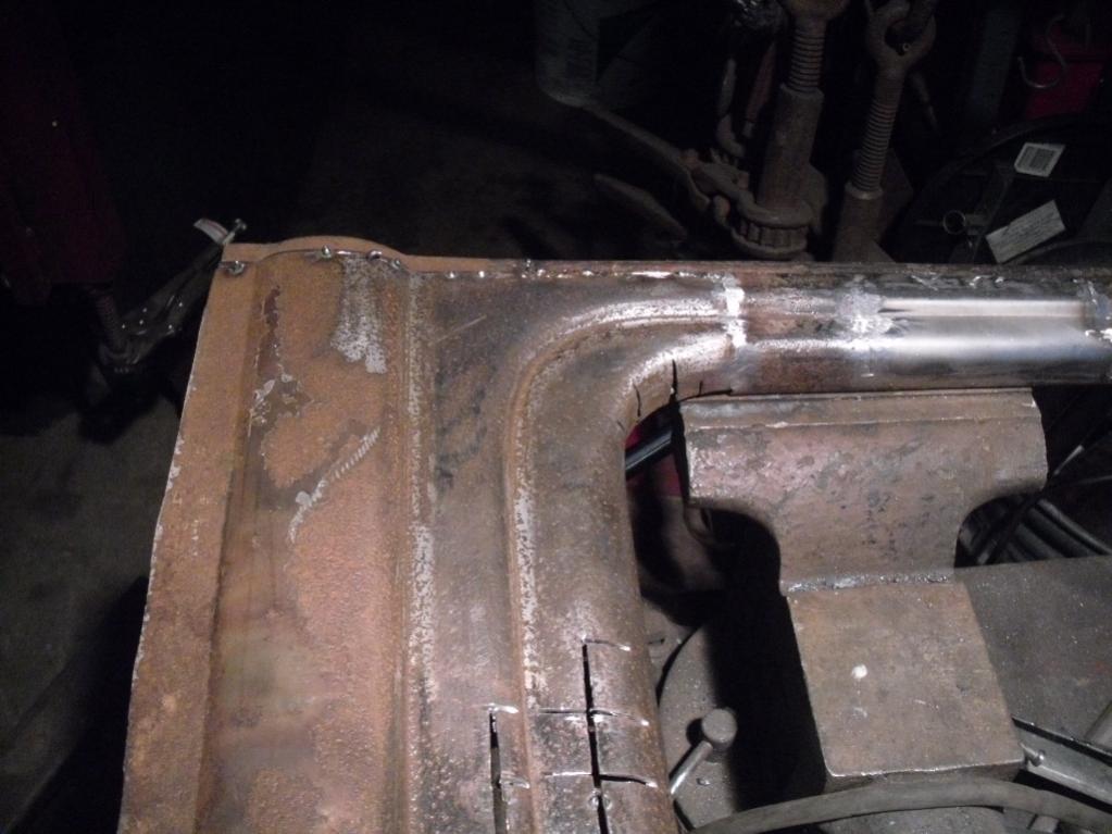

    Here's what I did to get the front of the qtr together.

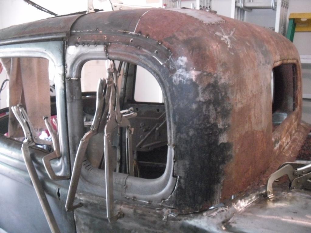

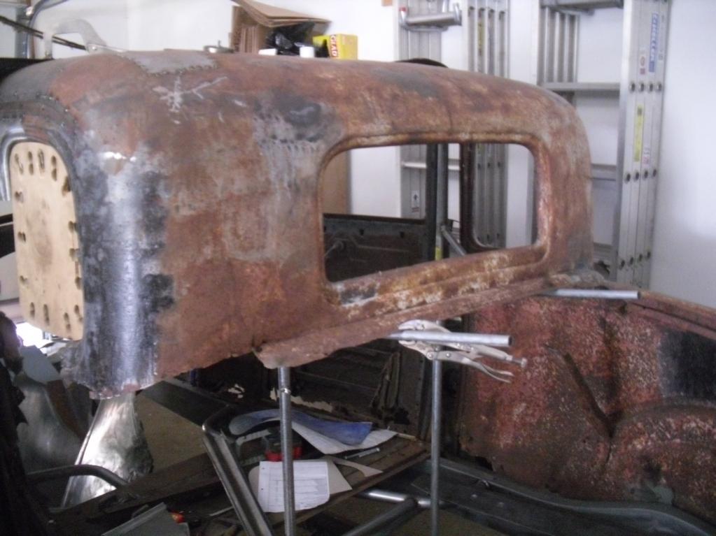

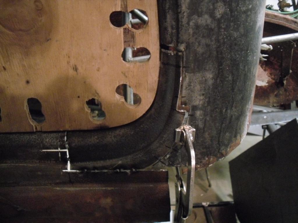

    I have tacked the pieces I repaired together to get a feel for how everything is going to fit.

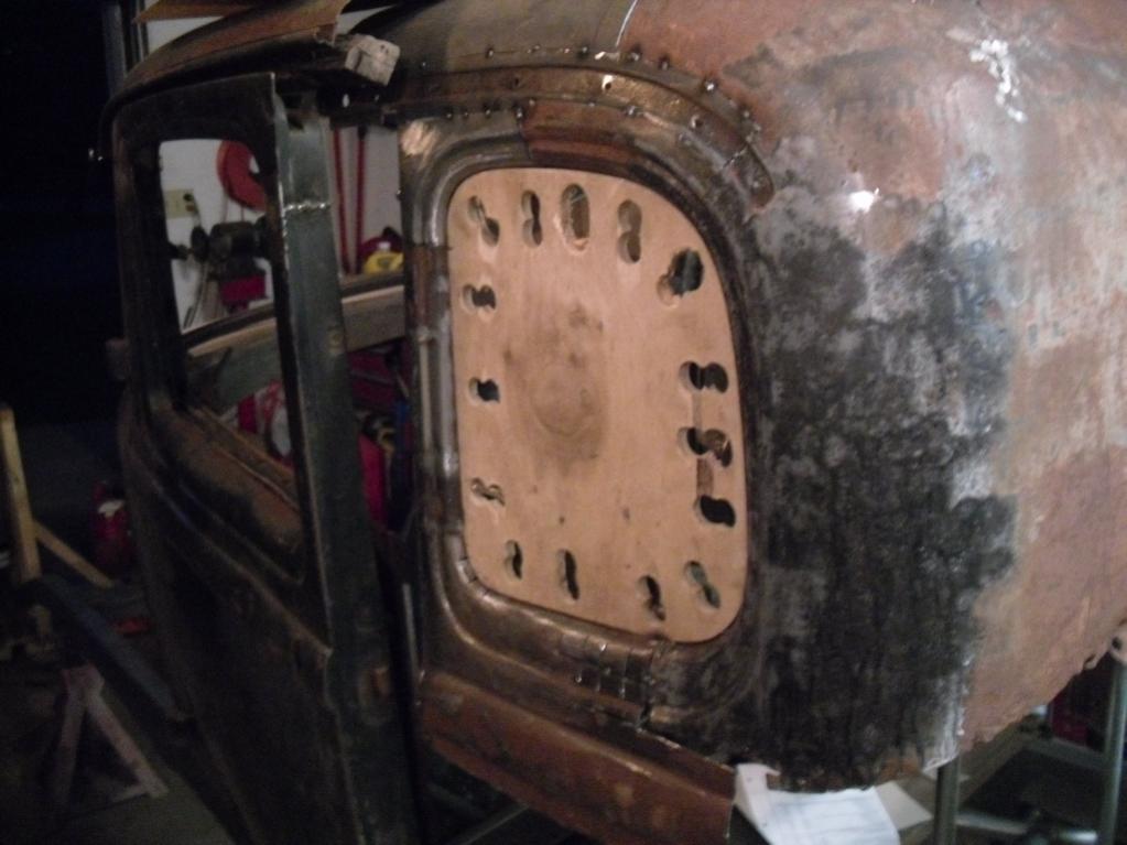

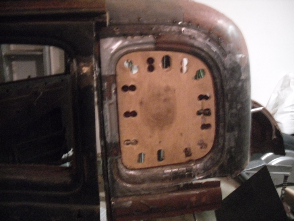

    The area at the lower right corner is really "soft". It's pitted and thin.
    I have a section form a 2 door that matches the curve and I spliced it in.
    Everything looks like it went really smooth, but truth is the window opeing changed when I cut the area out. Turns out most of this occured because of how I was holding the back secction of the quarter.
    Overcoming this took alot of #@&% time.

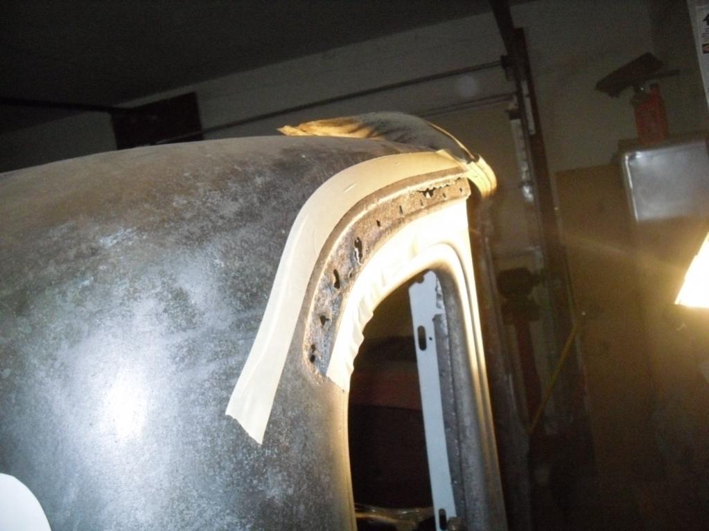

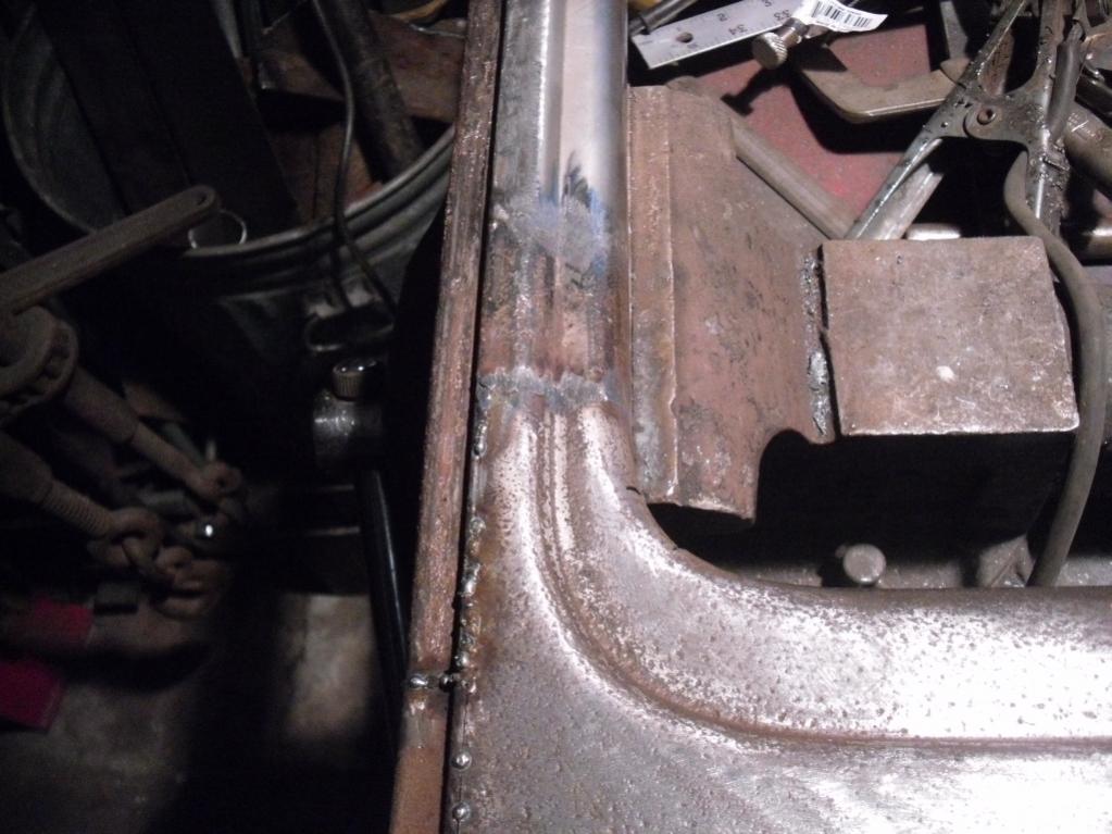

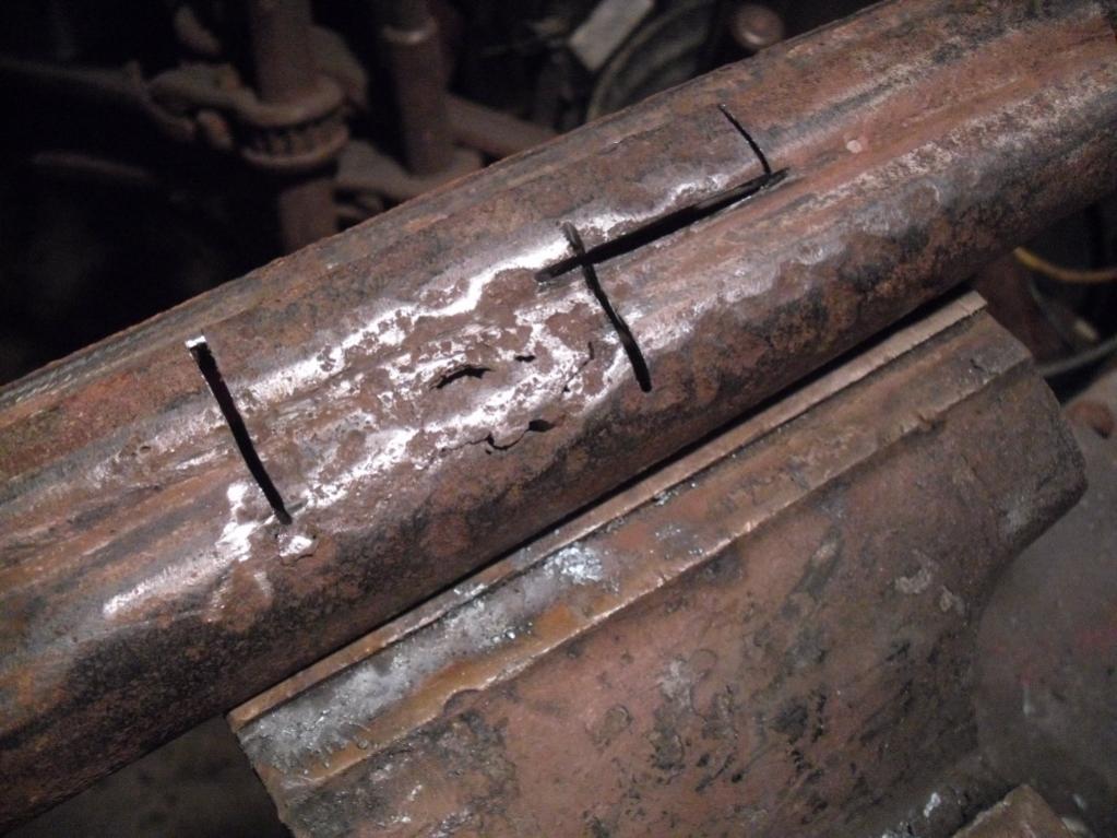

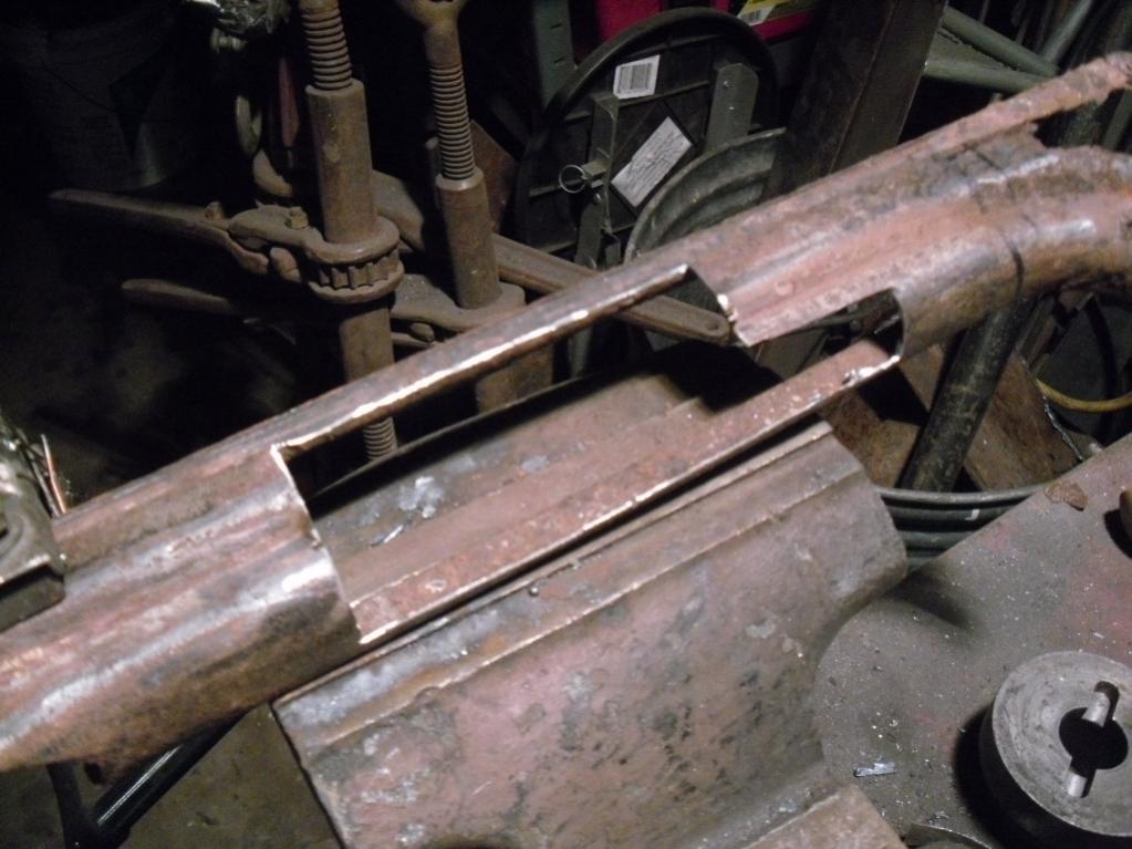

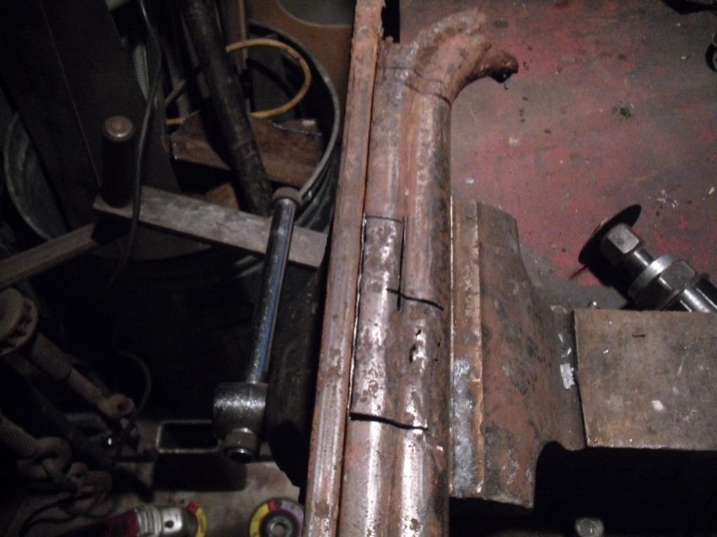

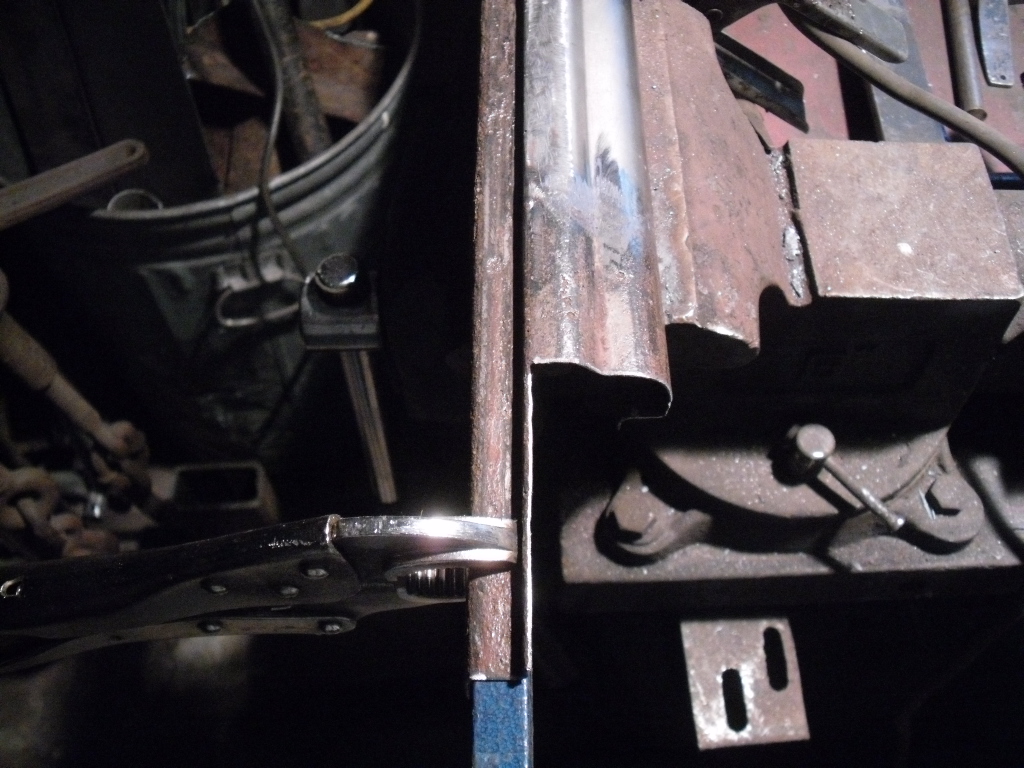

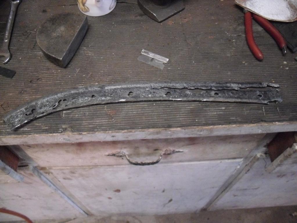

    thought i would show some shot's of the drip rail replacement process.

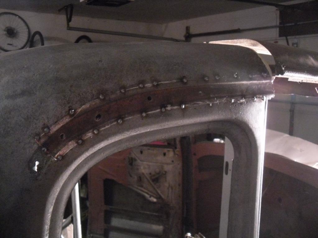

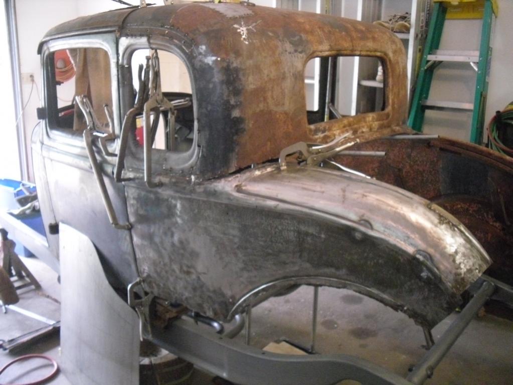

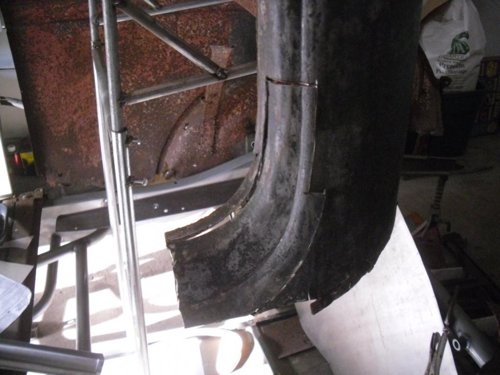

    We now the real fun begins I test fitted the old quater panel for the first time. Man do vise grips come in handy.
    You can see a panel that I wheeled leaning on the side of the body. I will use this toward the bottom of the quarter. It's just too rough to save all of it .

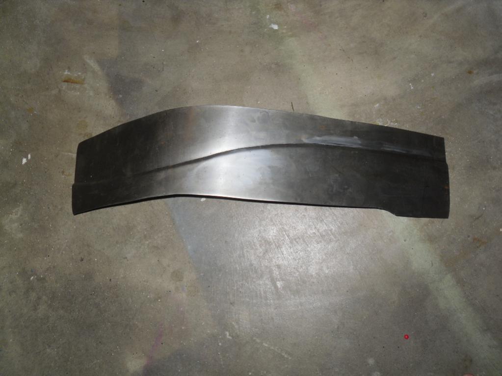

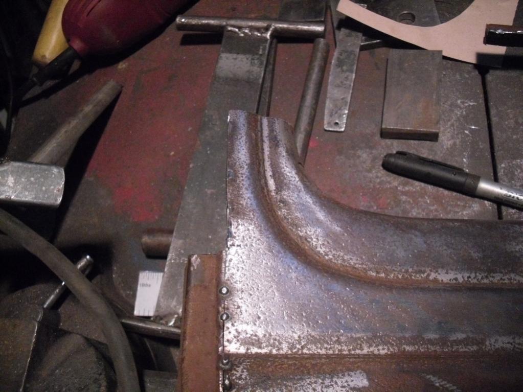

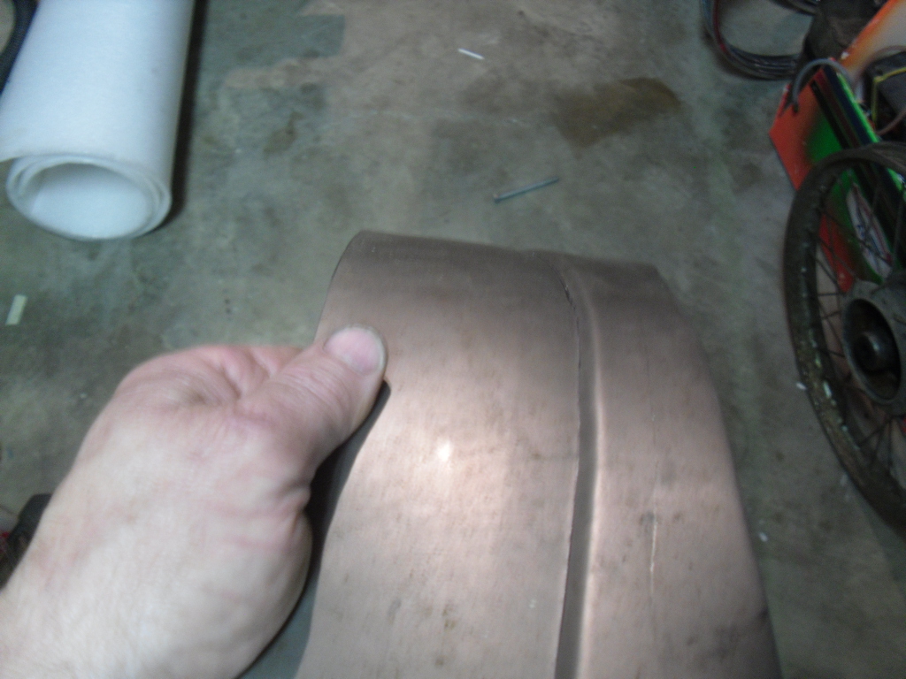

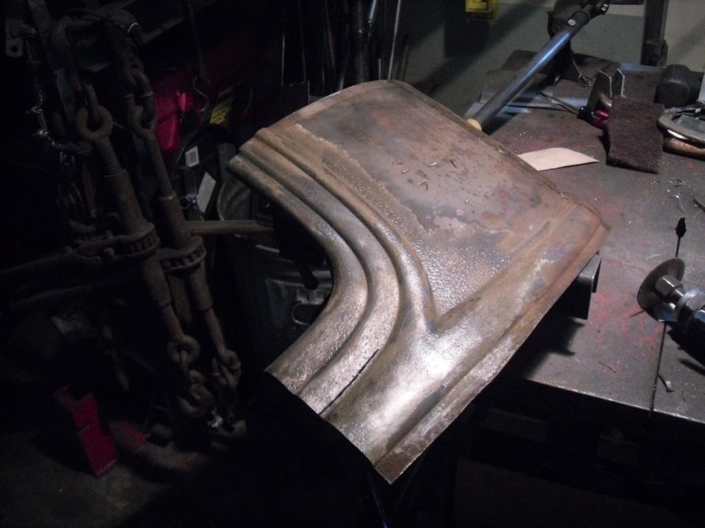

    Here' the process I used to make the panel to connect the old race car quarter to the roof and quarter window.
    I began by making a pattern of the curve from the right side , reversing it and tracing it on flat 18 guage sheet.
    I bead rolled the crease and rolled the entire panel. I't still got a long way to go , the crease is correct but the shape is not right yet.
